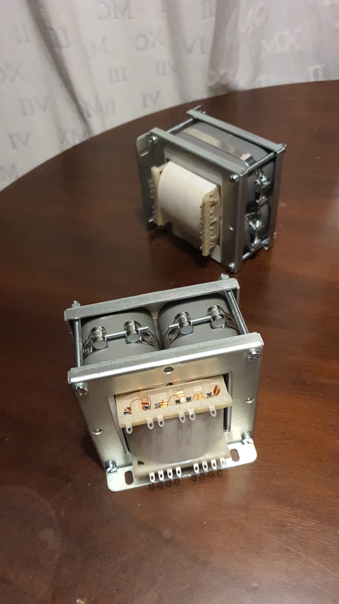

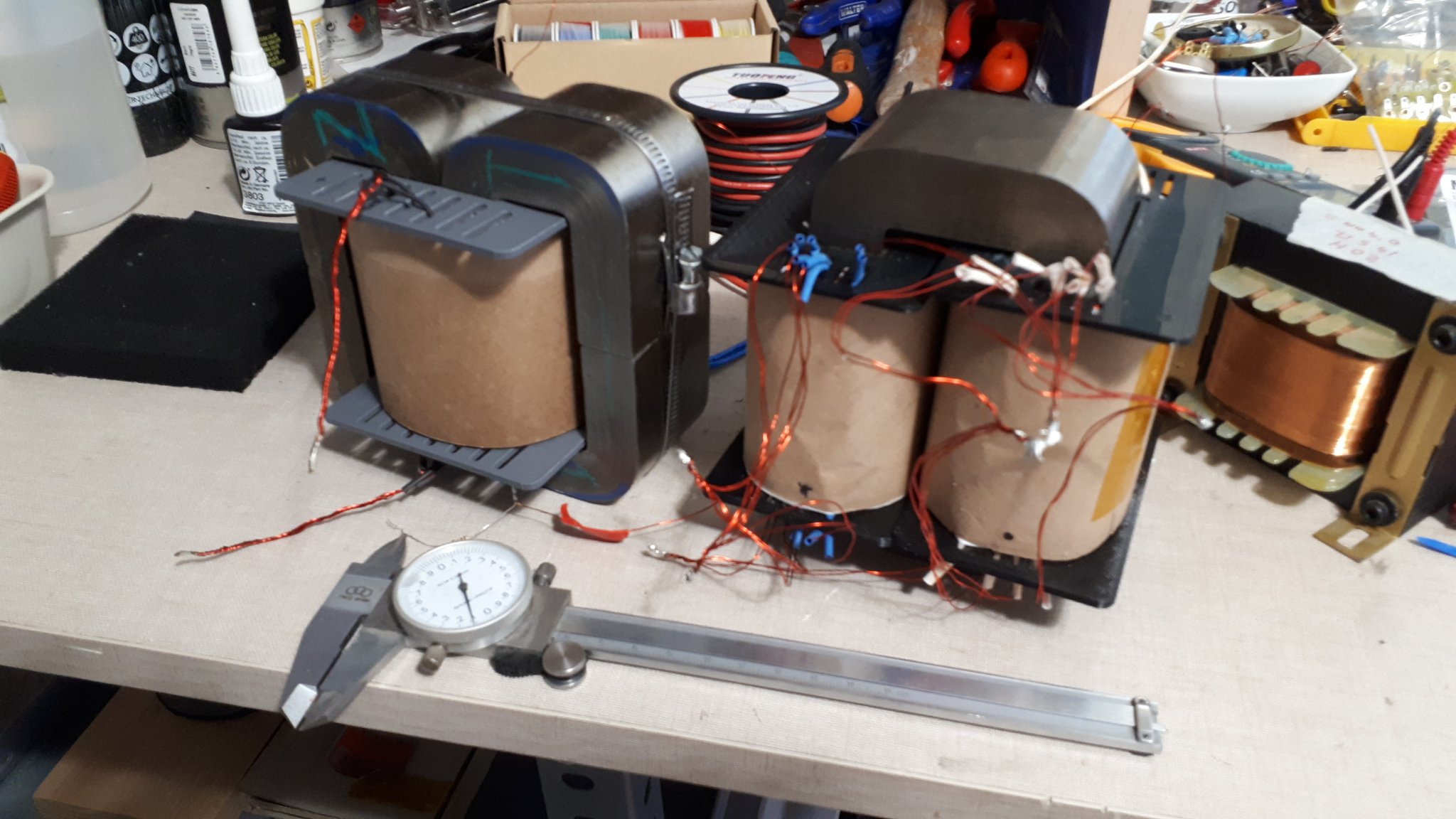

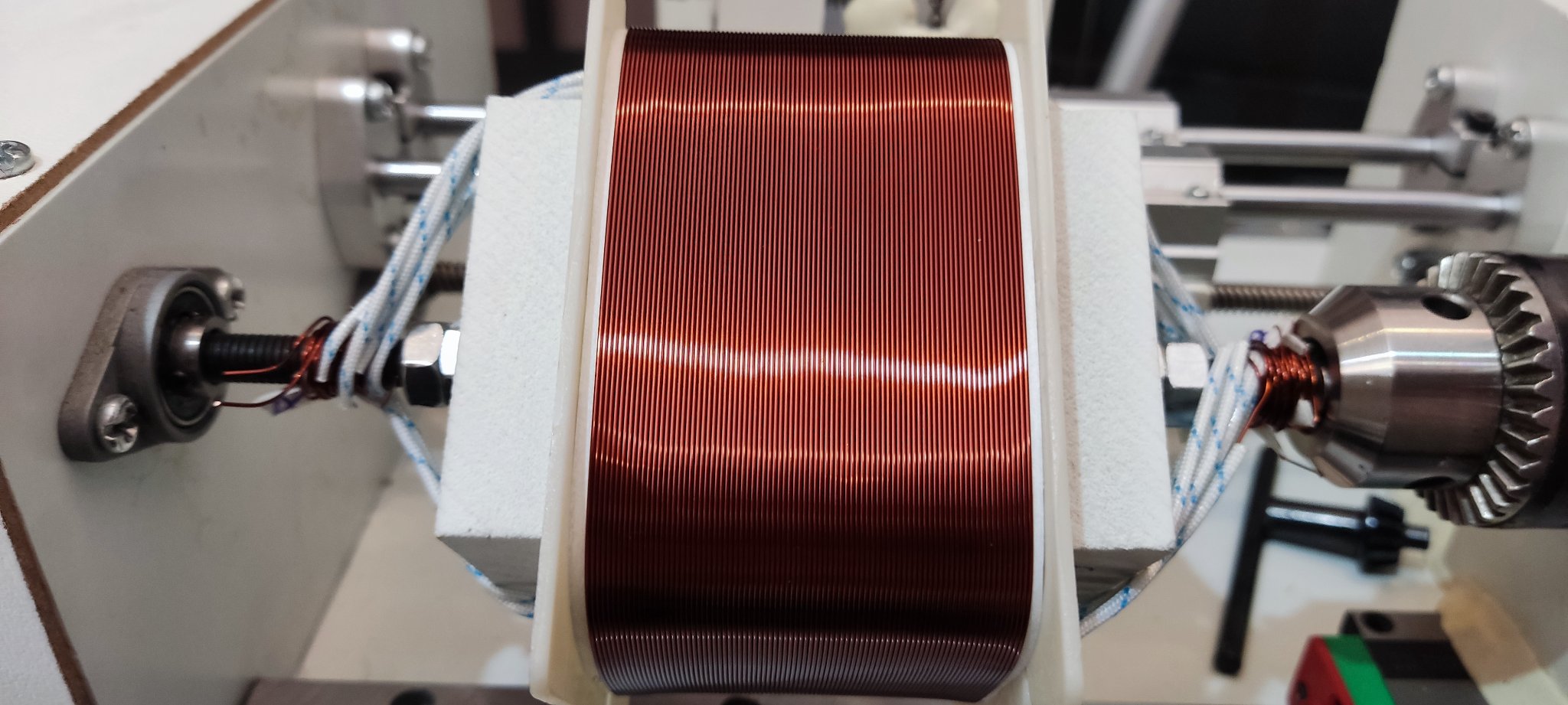

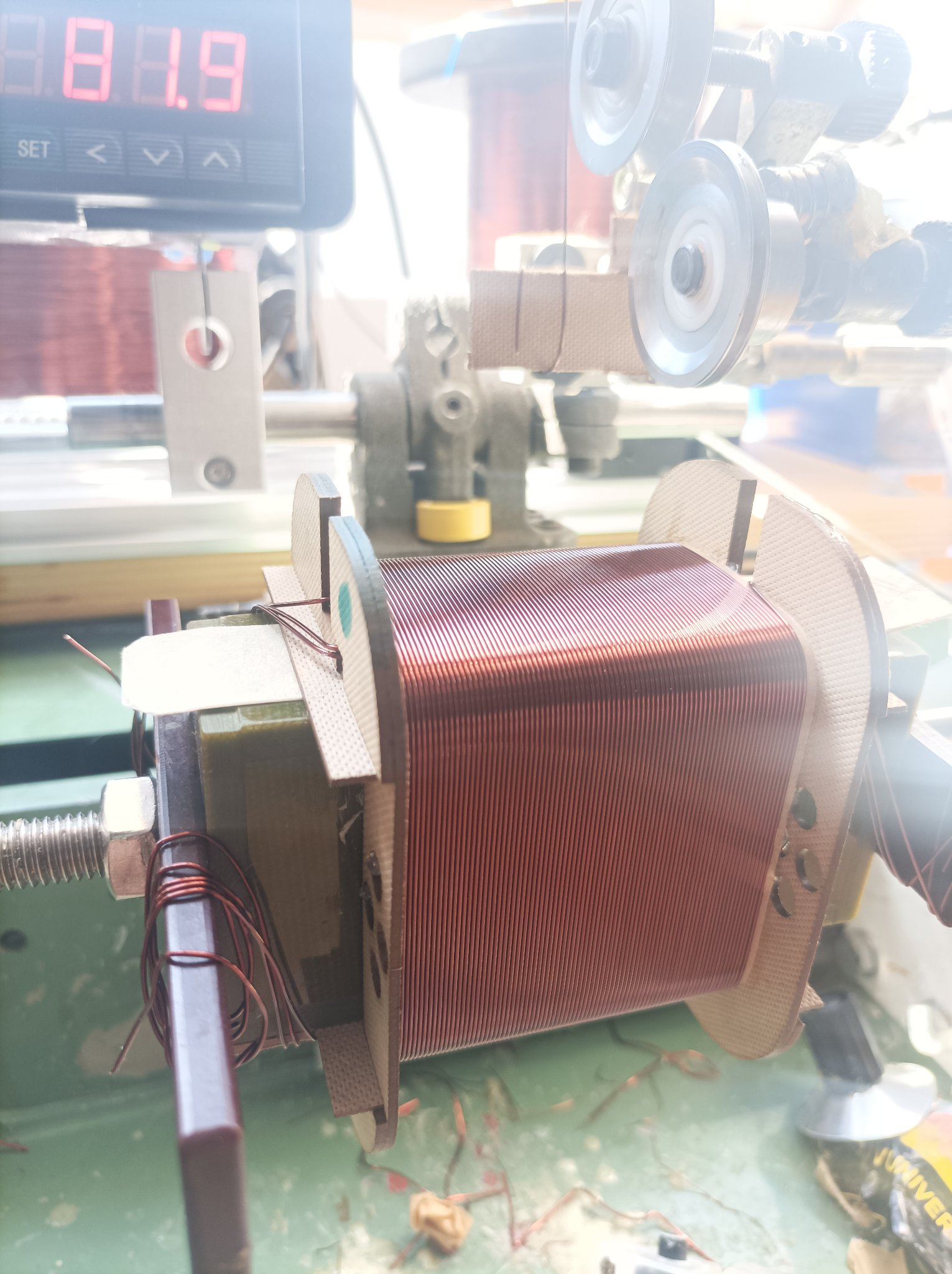

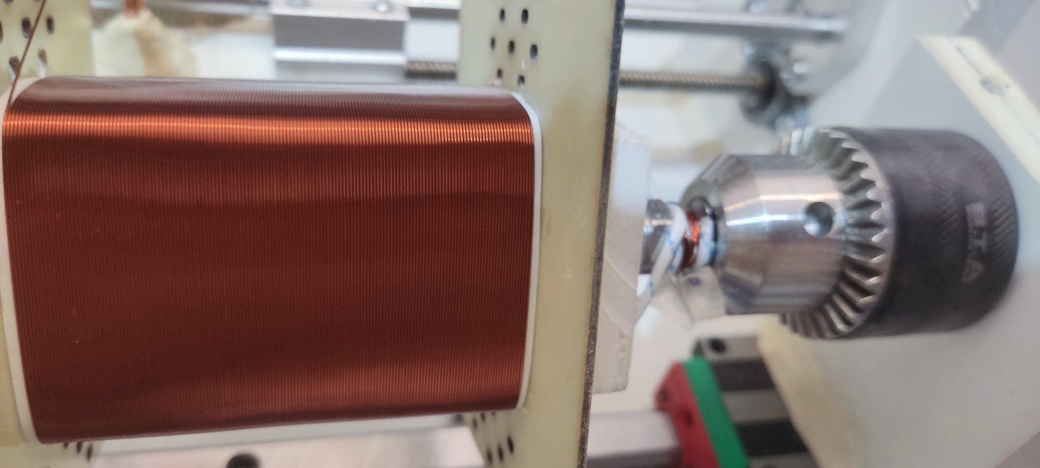

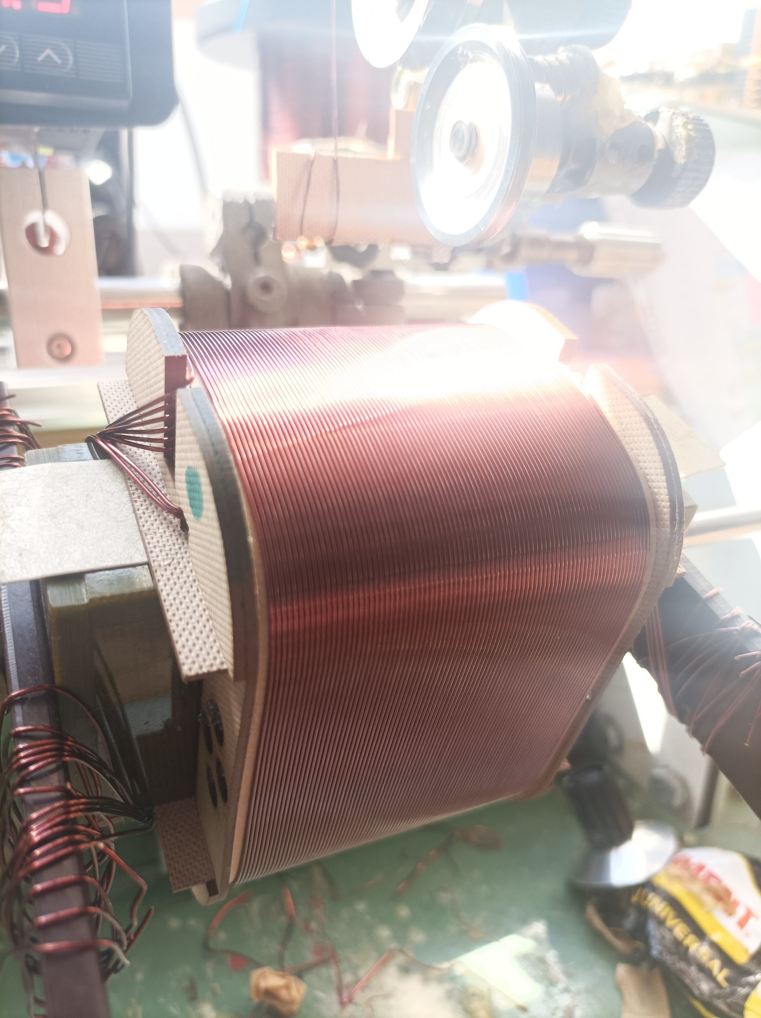

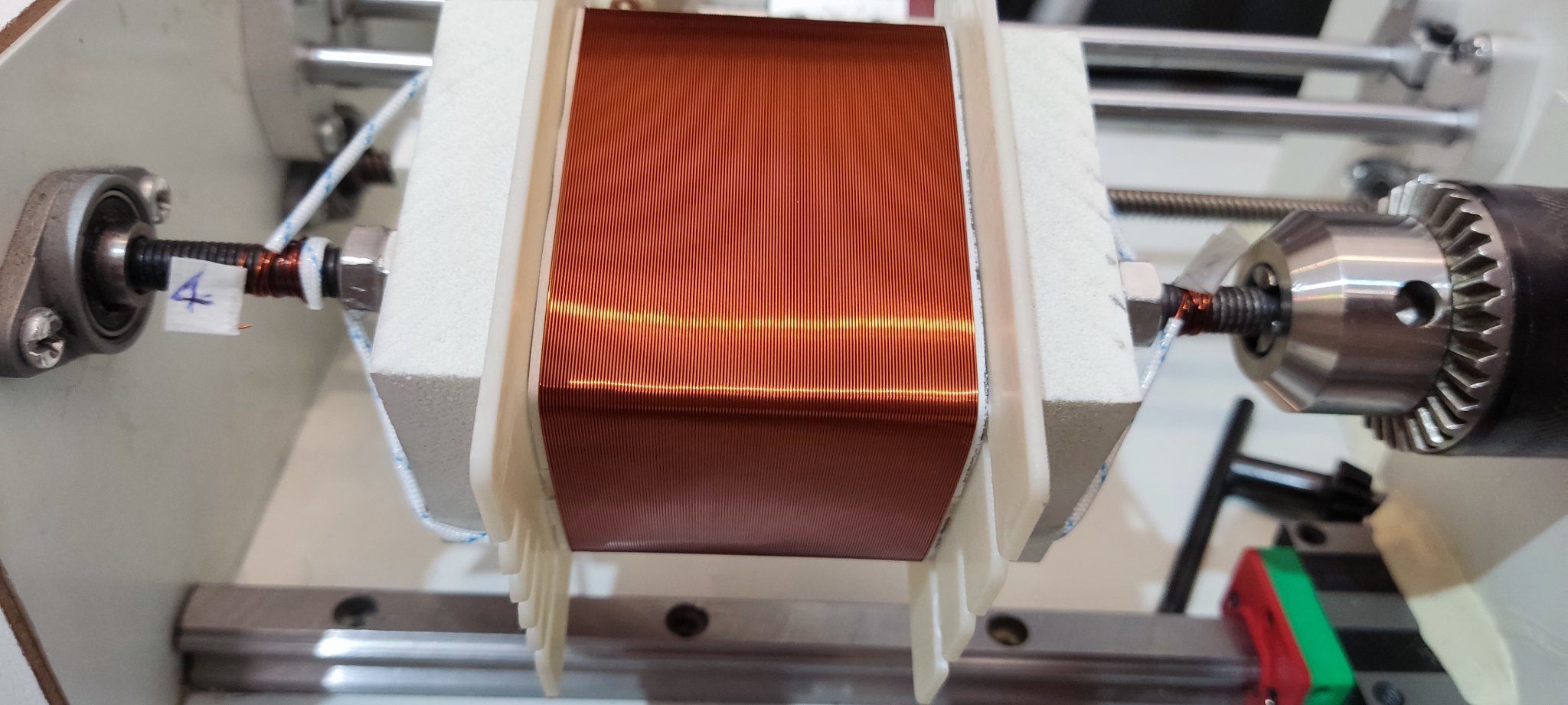

Sorry, I don’t have more pictures. When I’m working, I stay highly focused to avoid making mistakes and in any case, uglier than the ones Alexander makes.
Both have a similar construction double C-core 3100g and a single C-core 2200g. The primary is 12k, designed for a 211 tube. Well, I don’t like to talk about numbers, I prefer to talk about sound, which is the real target.
I wind with all the secondaries in parallel, but the question is if has anyone wound the secondary in series with a similar diameter as the parallel configuration, using Litz wire?

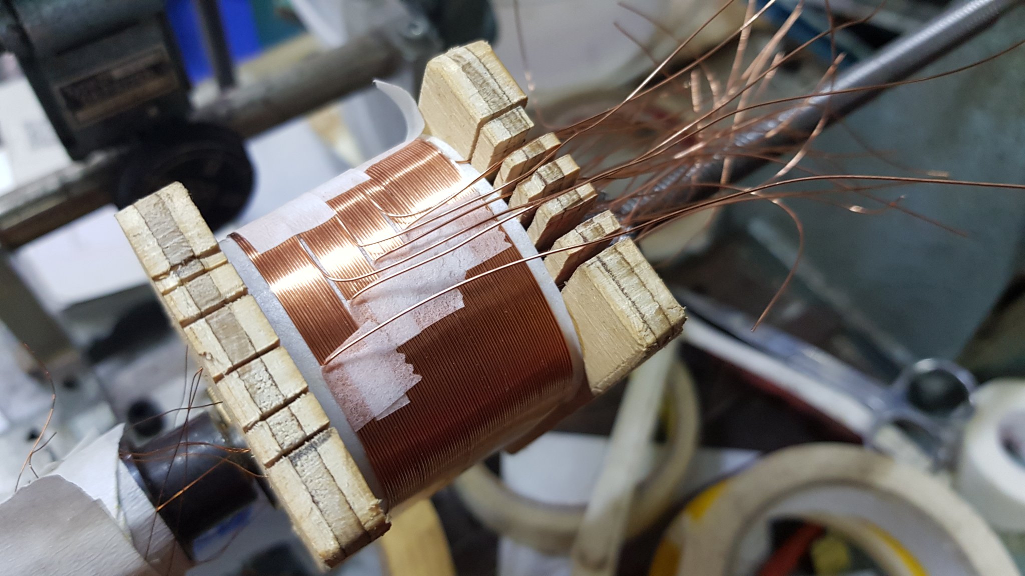

It takes an ample amount of practice, years, to avoid basic mistakes when winding. It takes a lot of concentration. I still have no idea why, probably because of the complexity of some transformers.
You must be careful with series connected secondaries. I'm preparing tutorial projects to shed more light into this, unfortunately, we're living into very busy times.

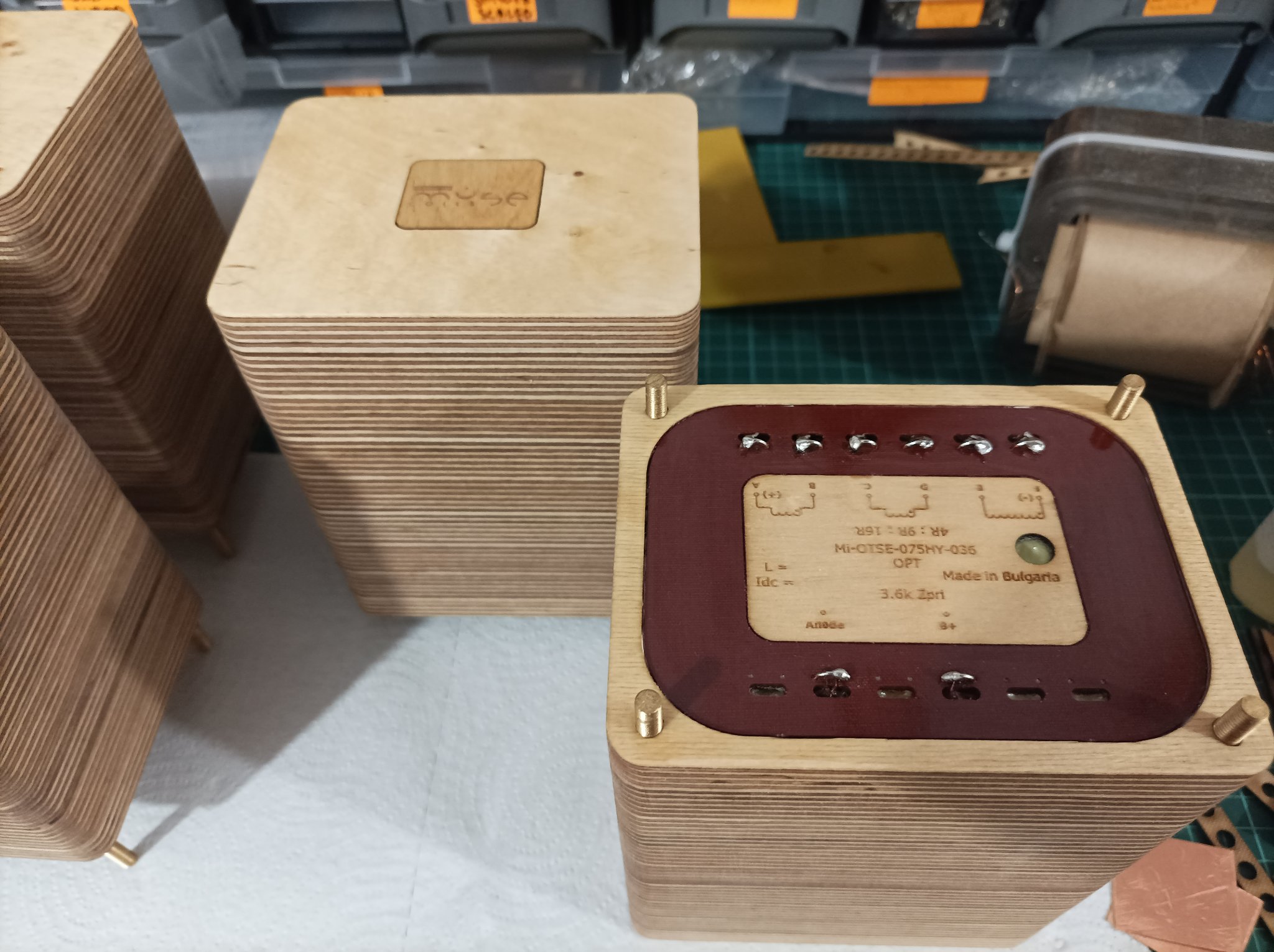

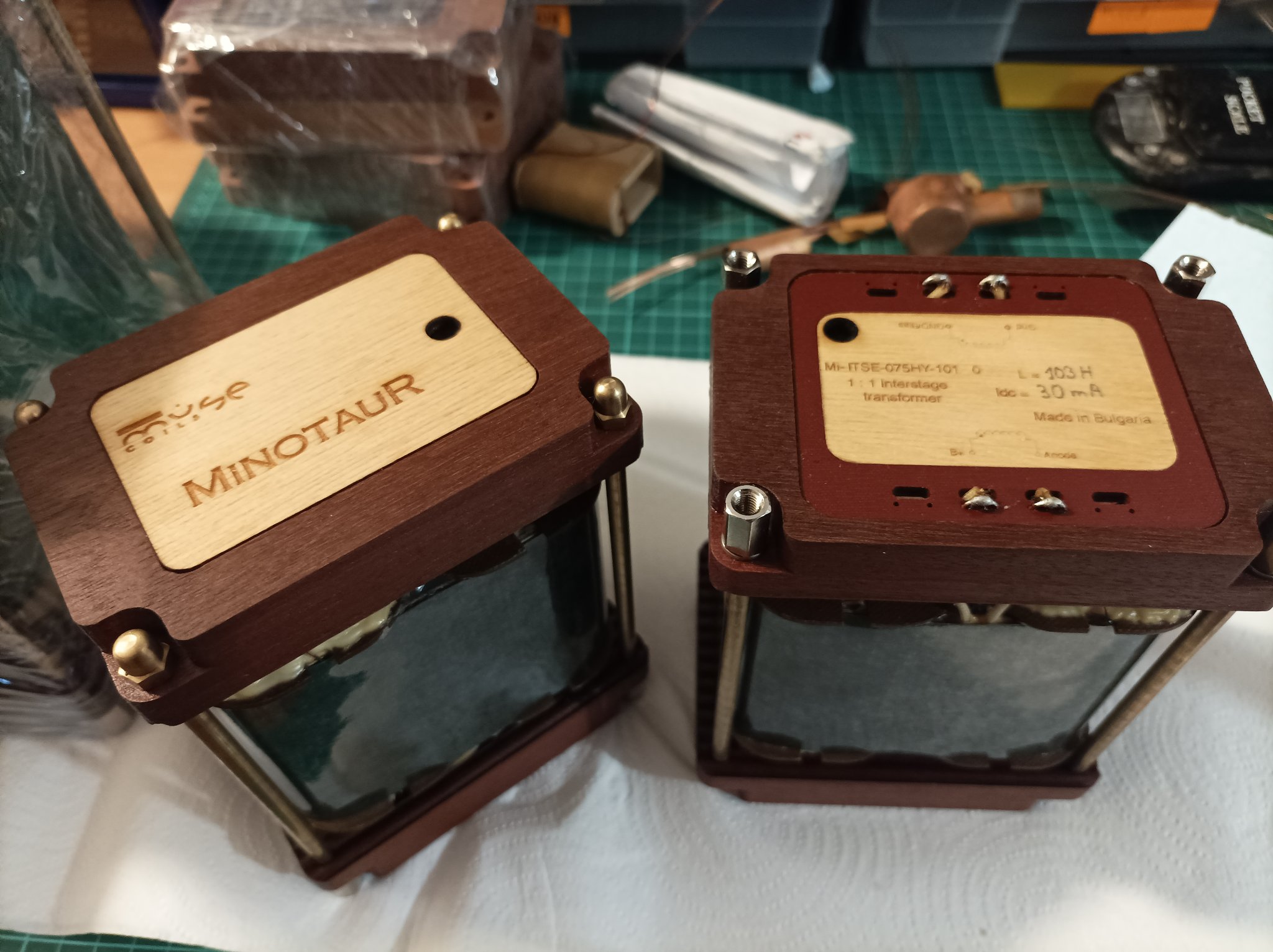

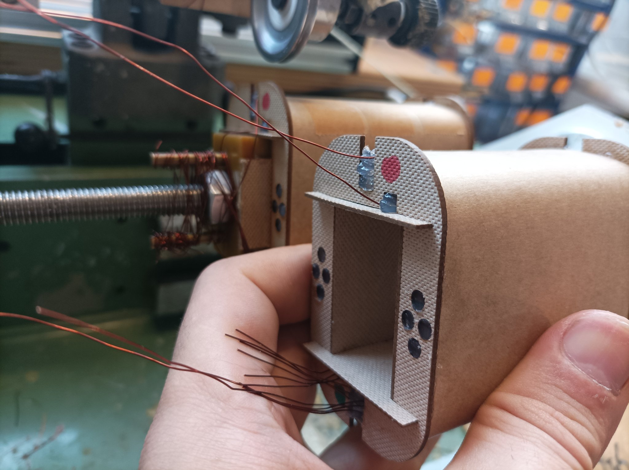

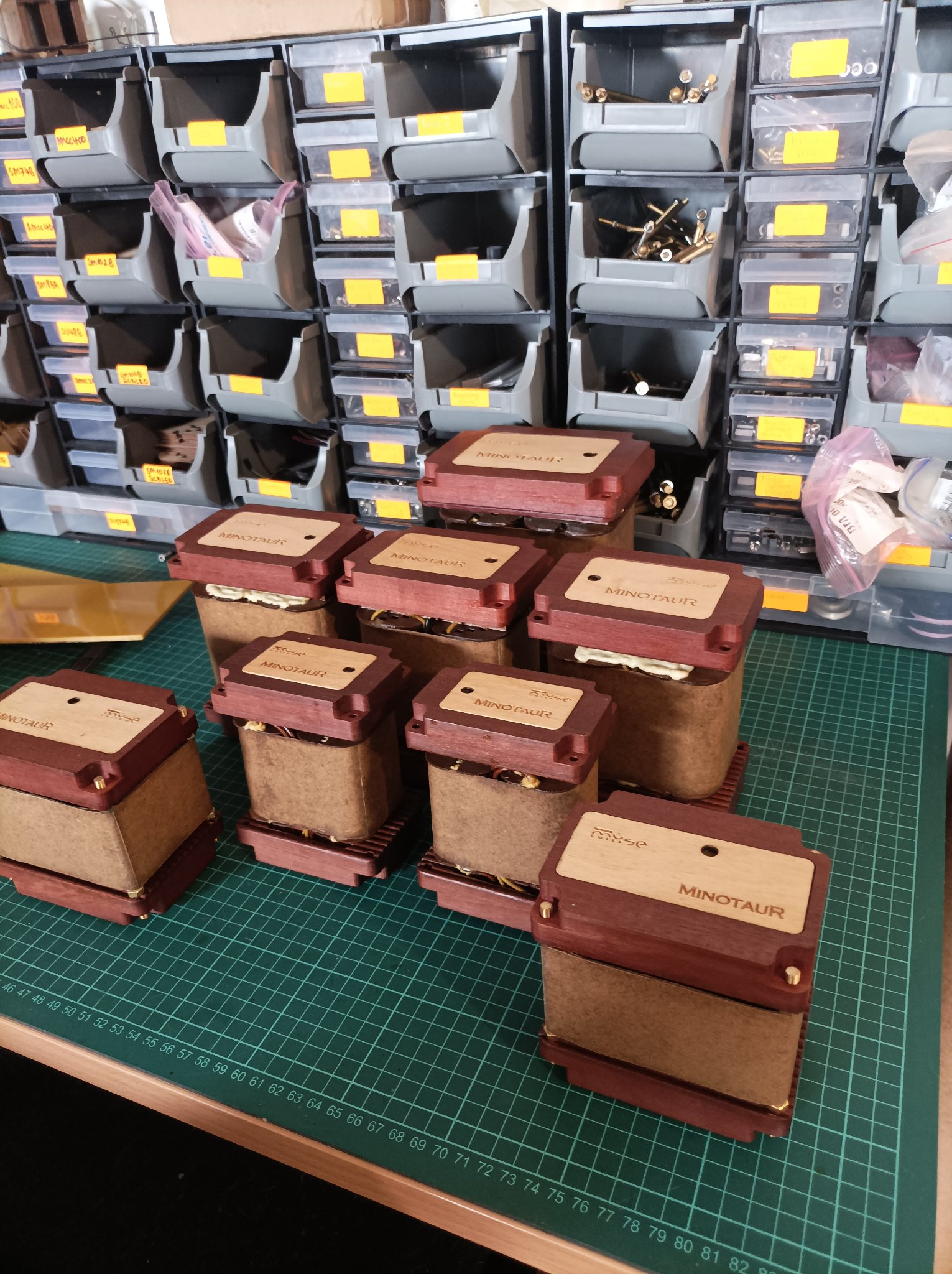

Recent pictures of a large 9.1cm2 core interstage 1:1 to be driven by a 845. And other stuff..

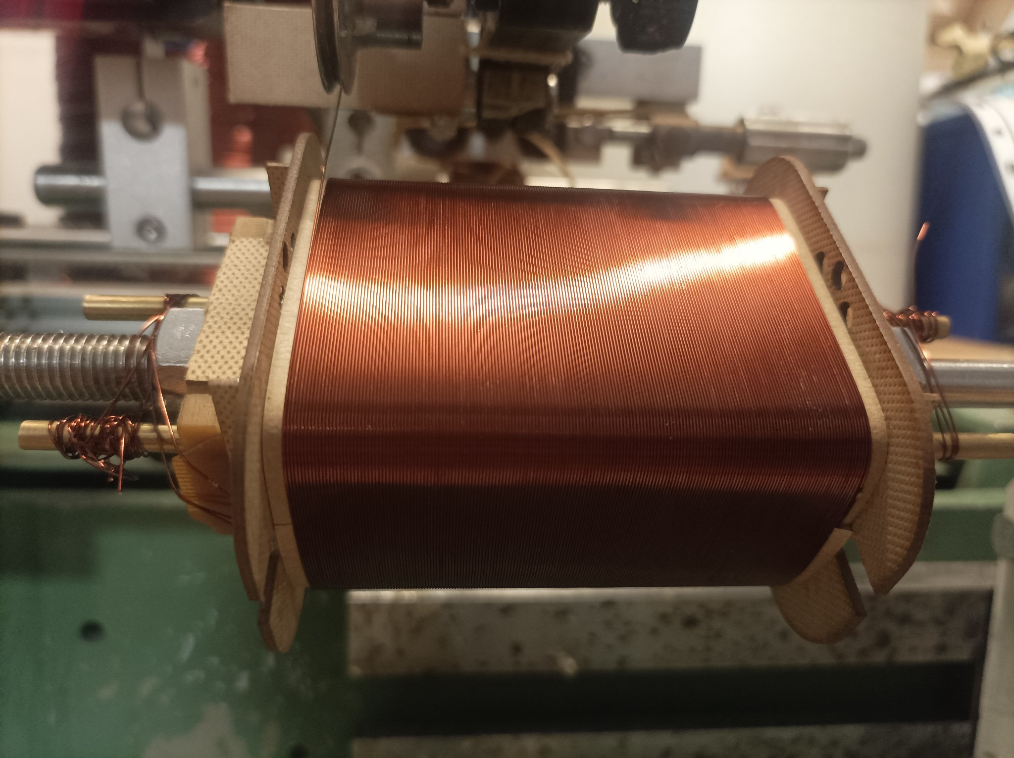

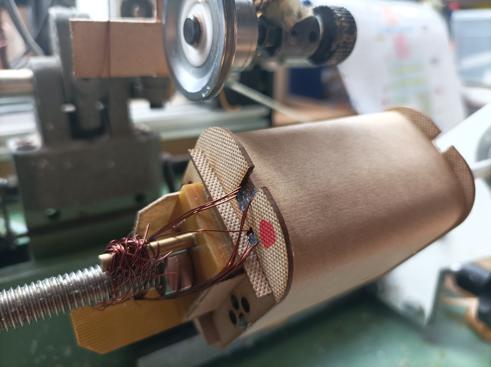

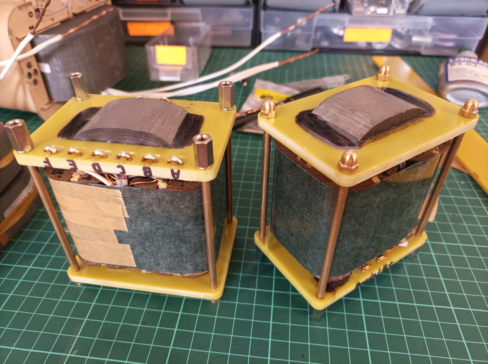

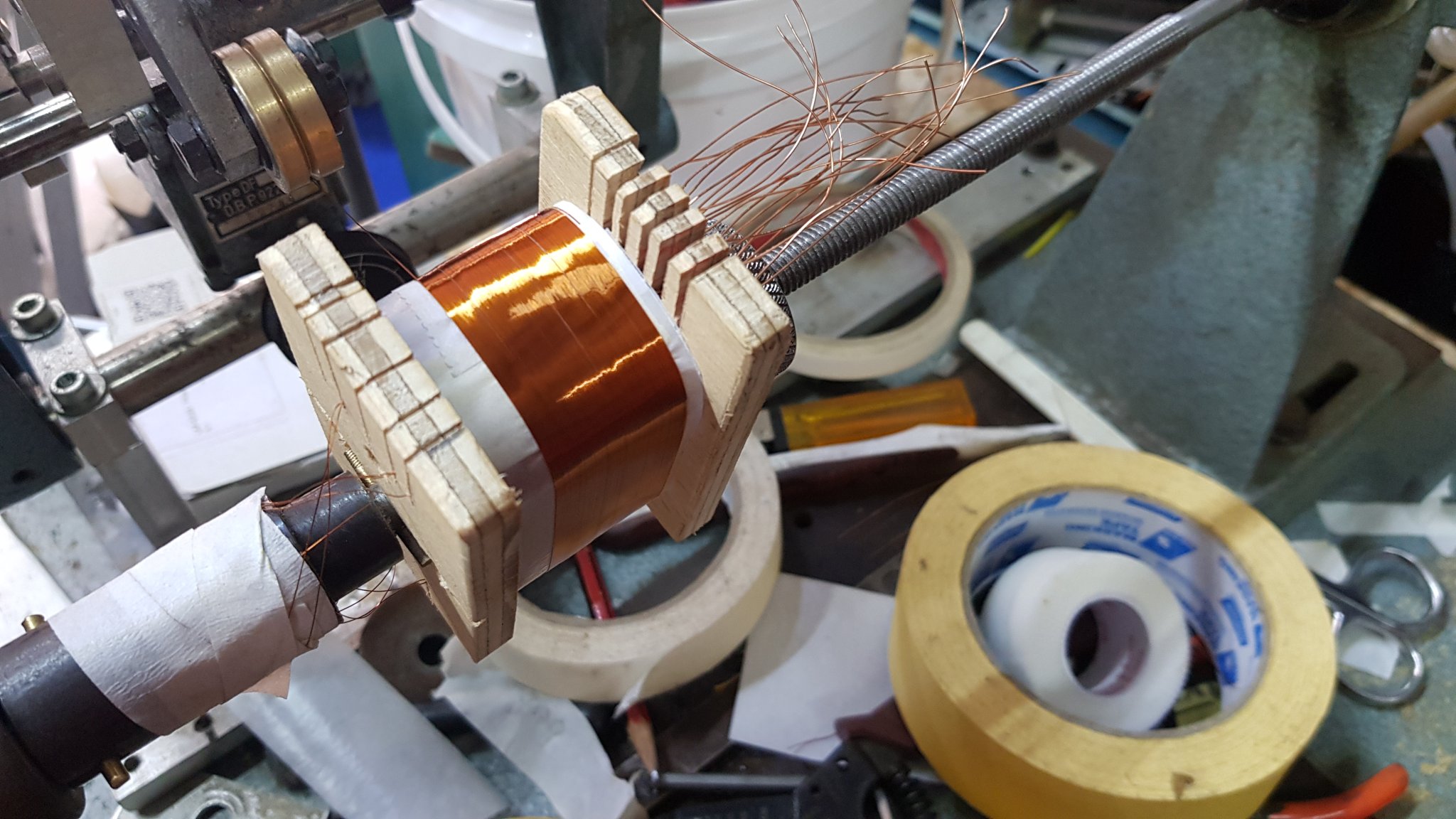

Here is some pictures from my latest build; 2.5K to 8 ohms 10W SE OPT:

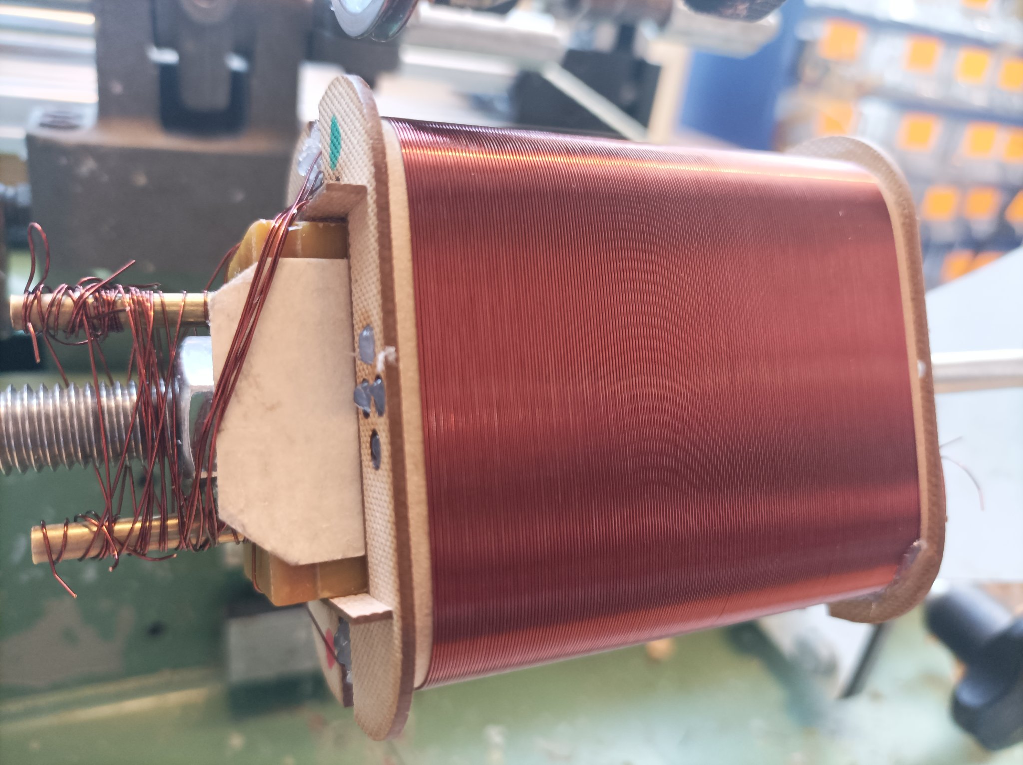

Recently rewound a Lux-kit OY15 -5 output transformer - wound on a tube/former rather than a bobbin, can't say it all went smoothly, a mistake on my part and I had to unwind and start again, but I managed in the end, was very hot hot here, over 36 deg C in the workshop, tape adhesive tended to let go - probably from the heat - this caused some problems securing taps and windings. This transformer has 5 primary and 4 parallel connected secondaries, each secondary consists of 2 layers, one layer is just straight forward full layer of 75 turns, the other layer has 4 taps bought out to the edge, this makes a total of 10 leads bought out to the edge - multiply that by 4 and one ends up with 40 leads to keep track of for the final connection.
Amazing work. Having wound a few tfmr's I know how hard it is, especially the ends of a layer. To stop the end turns of one layer on top of another layer from slipping off the insulation onto the one underneath is very tricky. I'm getting better at it but couldn't wind the OPT above in post #354.

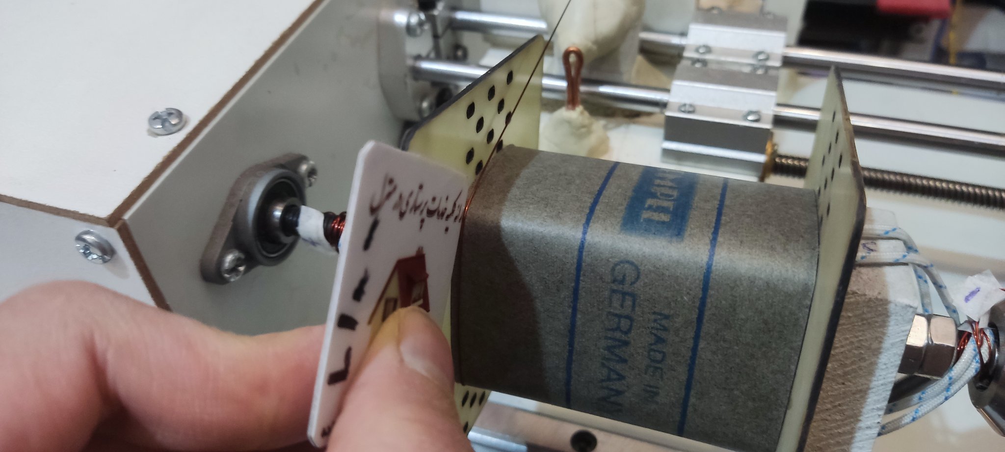

I use margins for that purpose; margin is a space from the bobbin end which wire is not wound. I cut the insulation paper exactly to the window size, an then use a credit card with 1 mm diameter between the bobbin flange and first two or three turns and then start the motor for the rest of turns:To stop the end turns of one layer on top of another layer from slipping off the insulation onto the one underneath is very tricky.
Another method for this is to wind the whole window space without any margin, but cut the insulation paper a little longer than the window. This method is described by Turner in the "Practical Transformer Winding" article. Some people also make little cuts at the paper ends to prevent paper from foldindg in this method.
