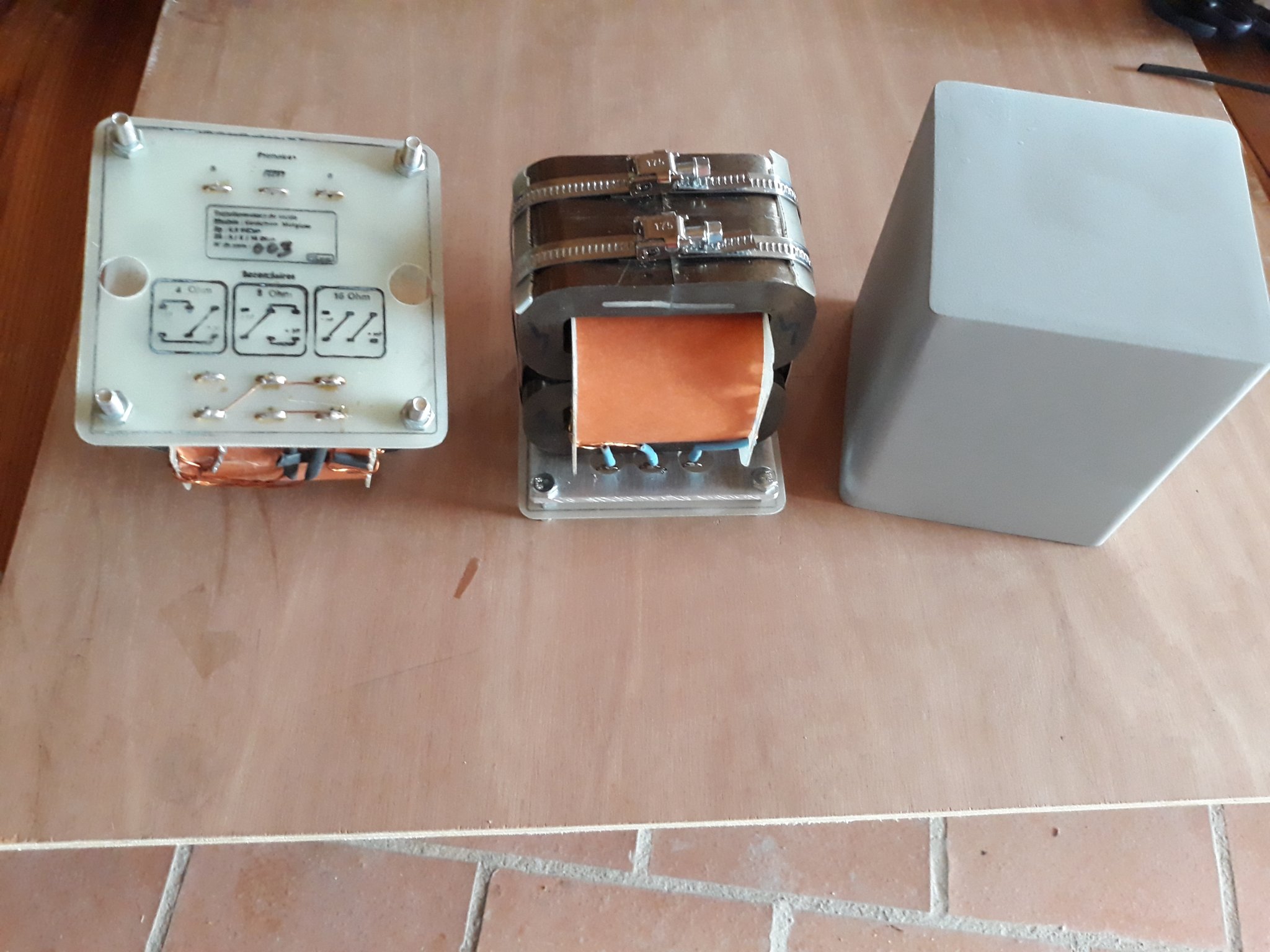

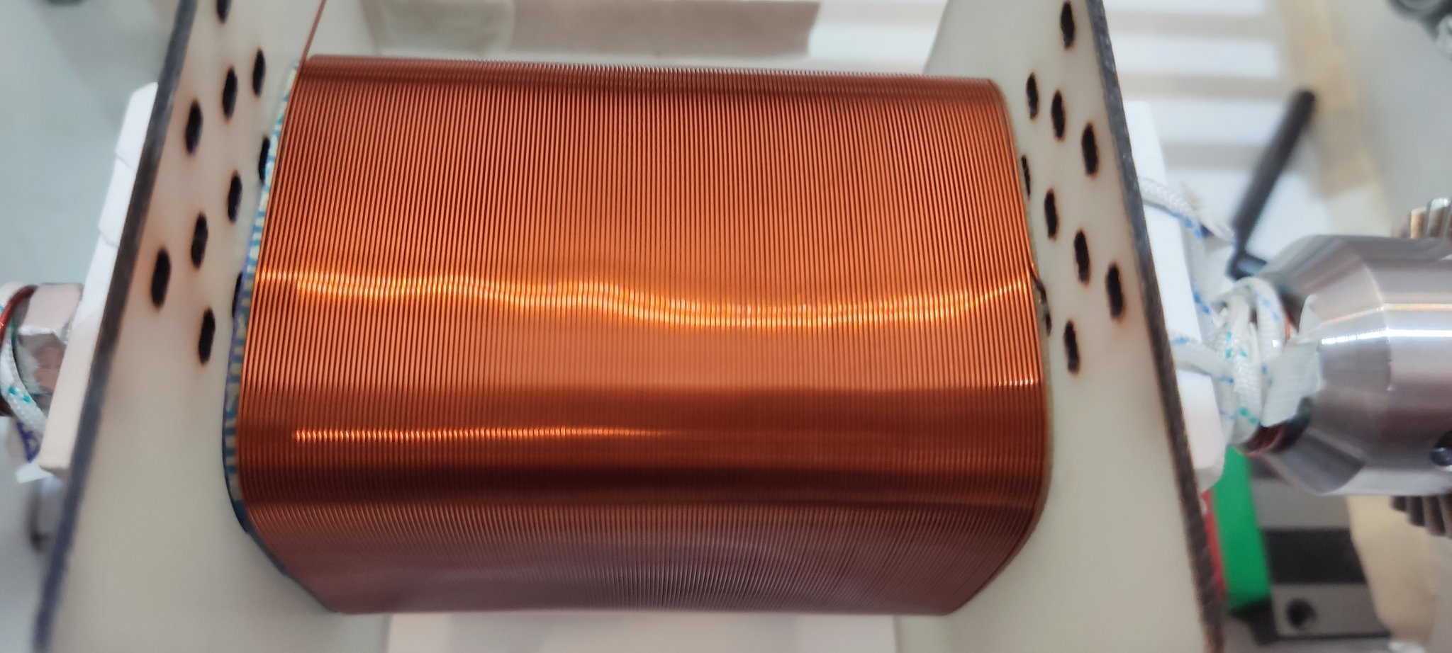

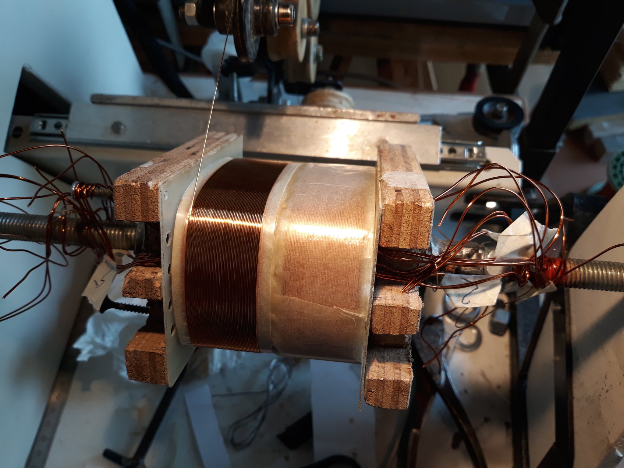

Some pics
what dielectric material are you using between layers ? Kellogs paper ? Yell insulating tape ? These can have a large influence on parasitics.
I use Kremple Presspahn as insulation. Thickness is 0.1 mm between the same windings and two layer of 0.2 mm as wrapping between different windings. Dielectric constant of this material is close to Nomex and maybe a little less, but this stuff need varnish which I use vacuum impregnation at the end with around 30 percent increase in overall shunt capacitance.
Partridge /Williamson of 1950/60 days famous for their complex output transformer designs used kelloggs paper and end dip seal only. Wax those days. Sowter til they were Carnhill did sim but used yellow tape and polyurethane varnish. Vacuum impregnation increases the dielectric properties/capacitance which one is desperately trying to avoid....Great for mains trafos as full impregnation reduces lamination buzz.
Good stuff,.... Keep at it;
The amount of capacitance increase will highly depend on the degree of porosity of the dielectric. The lower it is density, for example some papers, meaning a higher air pocket quantity vs solid amount, the more detrimental the impregnation effect. On solid dielectrics where there's nothing to impregnate except space between turns, no big deal.
Reactions: sajadho1988
Indeed vacuum impregnation increases the capacitance depending on the varnish. I use electrical varnish and it always increases the total shunt capacitance by about 30 percent which I take into account in the design.
I found that vacuum impregnation of the OPT has some advantages; it reduces the 'singing' and also I found that after impregnation the turn ratio always increases which I assume is due to insulation effect of varnish on some shorted wires with defected enamel. Also I found that without impregnation turn ratio decreases in time, which I also assume is as a result of wires rattling and robbing against each other and causing the enamel to disappear in time.

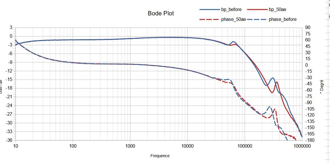

I promised it, I finally did the test of parallel serial connections of the secondaries in your way 50AE.
As I was using REW and a 24/192 external sound card, the measurements were limited (about 100kHz) to see the differences and
square response still similar in both cases.
I acquired a powerful digital scope Tiepie hs5.
Here is the phase frequency answer showing the difference between the two arrangement
I'll keep this good method
Many thanks 50AE to share your knowledge

Hi Yan,
Thank you for contributing towards the experiment.
Now we can observe that the differences in this case are tiny.
Did you try the reverse-winding capacitance dumping techniques in your project? Usually, better benefits come from combining the two.
There is a third technique I'm using, especially valid for SE transformers, is the attempt to maximally equalize P/S capacitance by combining capacitance dump + dielectric epsilon and thickness.
Usually, the less amount of P/S interfaces, resulting into higher layer amount primary packages there are, the more benefits you'll acquire from these techniques.
