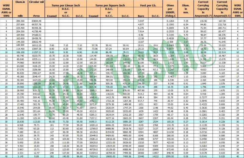

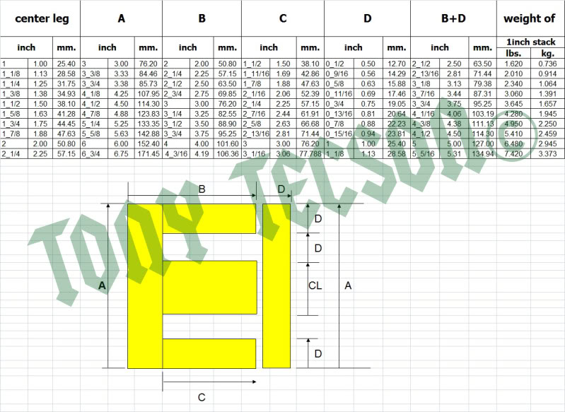

Hi everyone, recently I've been updating a little spreadsheet for designing power and output transformers and filter chokes for tube amplifiers.
The early version of this was designed by myself around 2015 and it was mostly based on Patrick Turner design method, but it was far too complicated that Patrick himself didn't like it at all!
so I decided to update it so everyone interested in winding his own transformers can use it.
So here it is; a little spreadsheet for designing power transformer, single ended and push pull output transformers, and also power supply filter chokes.
The spreadsheet is pretty much self explainatory and someone needs only to follow the steps and fill the green cells using cell comments, but if there is any questions I'll be glad to help.

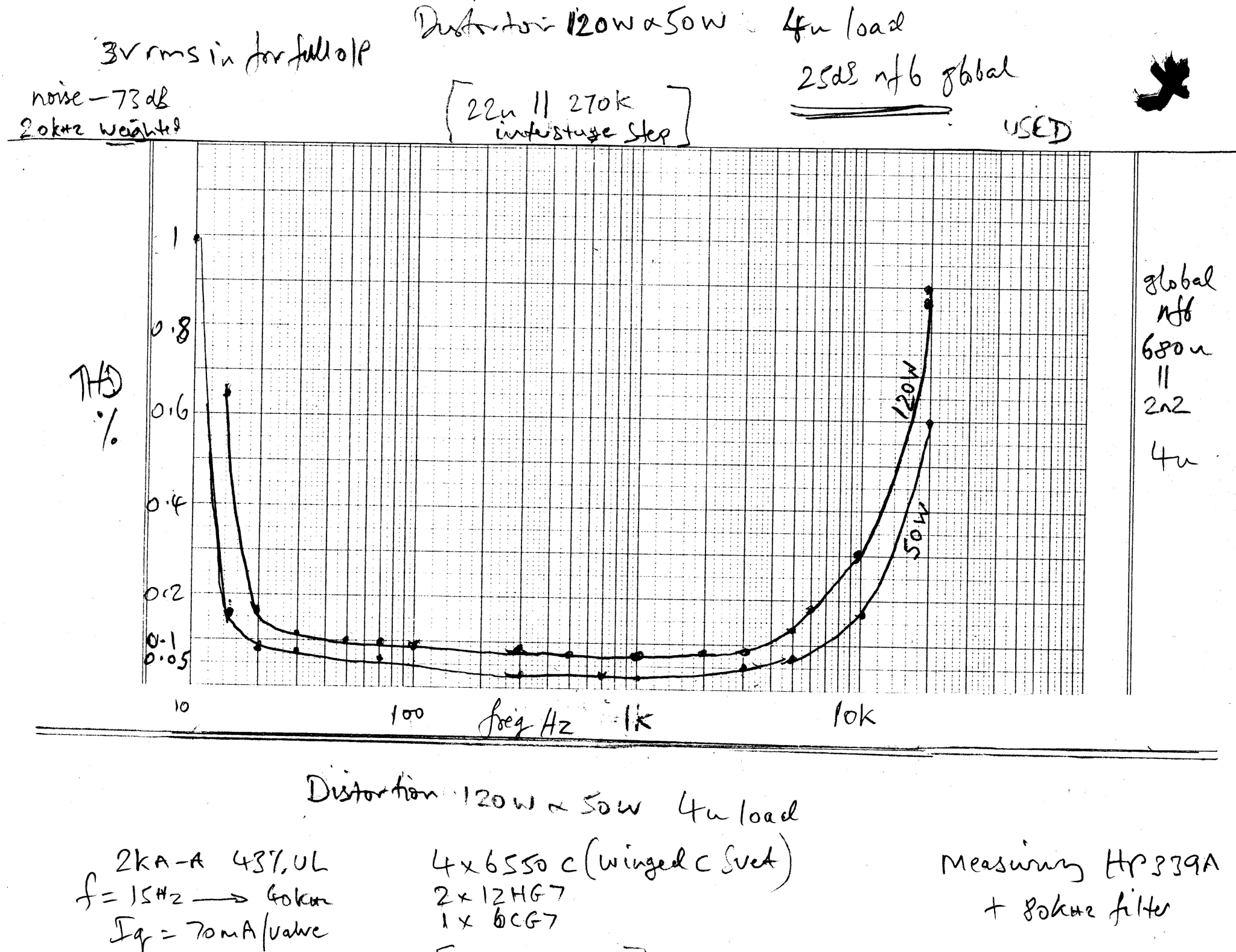

By chance, I am in the finishing stages of a dual traditional 3 stage 120W power amp each using parallel pp 6550C 2K A-A, 40%UL with 4 identical secondaries, so configuration can be changed to 1-4-8ísh-16 Ohm loads to my own Williamson design, which was wound by a winding house.
Enclosed is the typical distortion bathtub curve diagram at 25dB upper graph (lower graph gnfb at 19dB); note of the low end thd that extends well into single frequency range before sat troubles start. The transformer spec was designed around the 1.4% criteria with Bmax 1T; primary resistance each half 20 ohms with UL tap 13 ohms. Fixed bias operation with 450V B+. Each Tube quies 70mA # 125mA full output. 25dB. I ignored the 1W level specifications as here I am dealing with power response.
It was expected the HF end is a little compromised considering the higher frequency advantages of parallel push pull, but neverless the midrange and squarewave performance is exemplary. The initial calculated transformer spec at f-3dB cutoff was 15Hz and 40Khz. In reality the distortion curve at the top end response indictates fairly high leakage parasitics, typical of such large designs.
Many of us have different approaches on this tricky topic, though when I worked on tube amps in the 1960´s, the Williamson & Partridge 1.4% f3 LF cutoff standard may seem very generous by today´s standards. However these were the best designs of the day.
On hindsight, the low frequency power performance is excellent, but a smaller transformer would have improved the top end. There is a case for even higher amounts of gnfb which would reduce the distortion and signal to noise further, though 25dB was used in my design, equating to hum and noise of -75dB down below full output. The circuit can accept another 25dB gnfb increase before top end stability issues become noticeable.
On a cautious note; the output stage tubes cannot be expected to handle frequencies below transformer cutoff as with a low primary resistance and unforgiving overload situation can arise. In this amplifer, a Chebychev high slope HP filter was added to the front end.
Bench Baron
