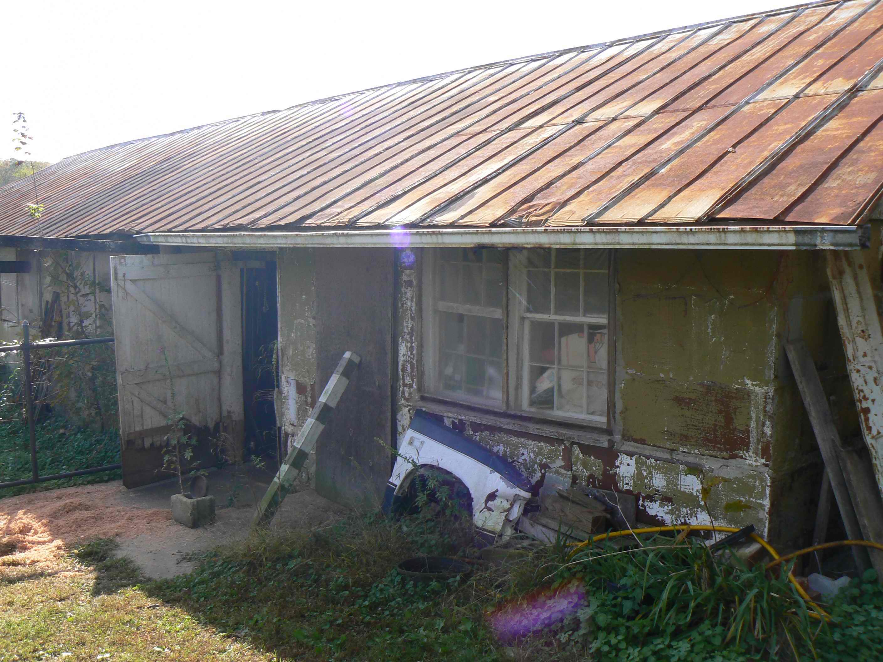

This is the hospital where they were born.
cleaning the mess in the garage and make up with my wife, then maybe time to resort the furniture......
Anyhow heres a shot or two.

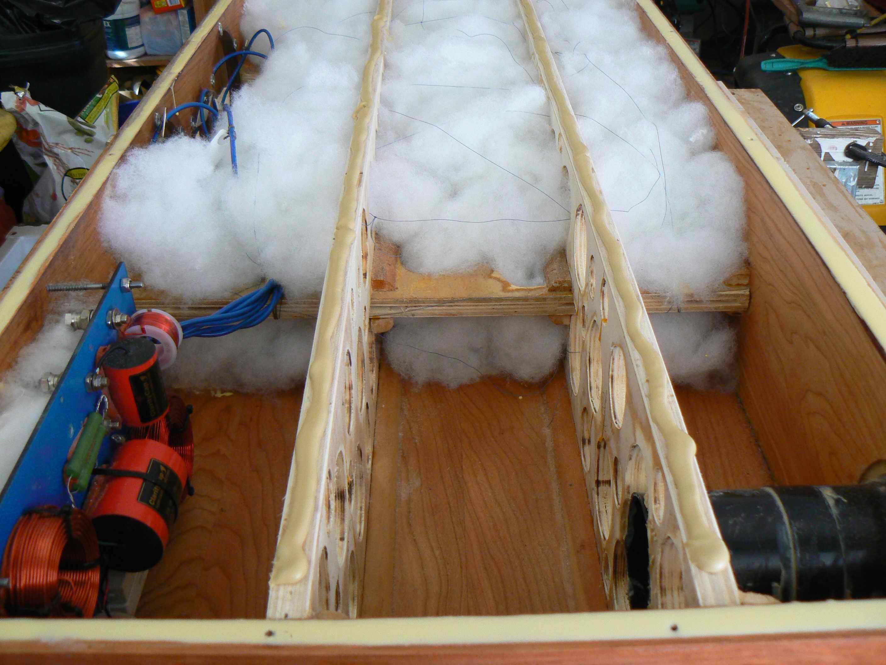

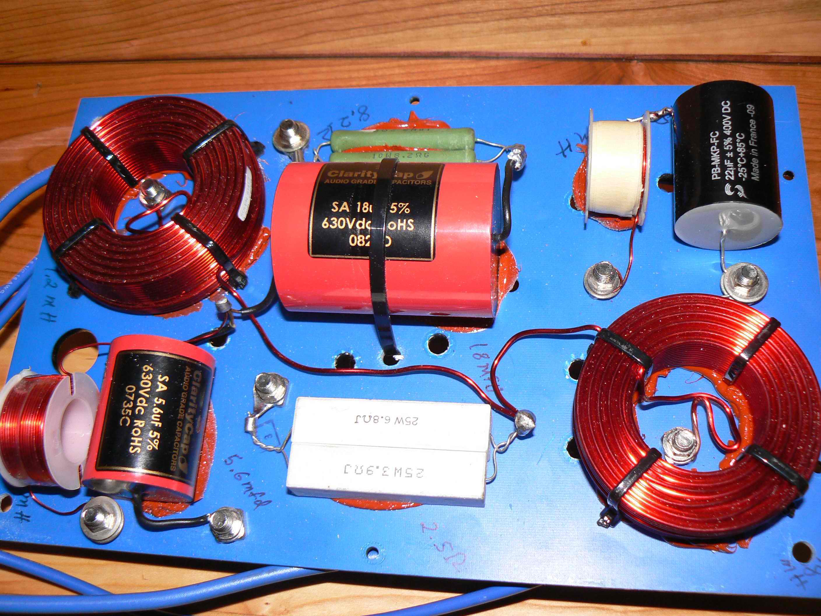

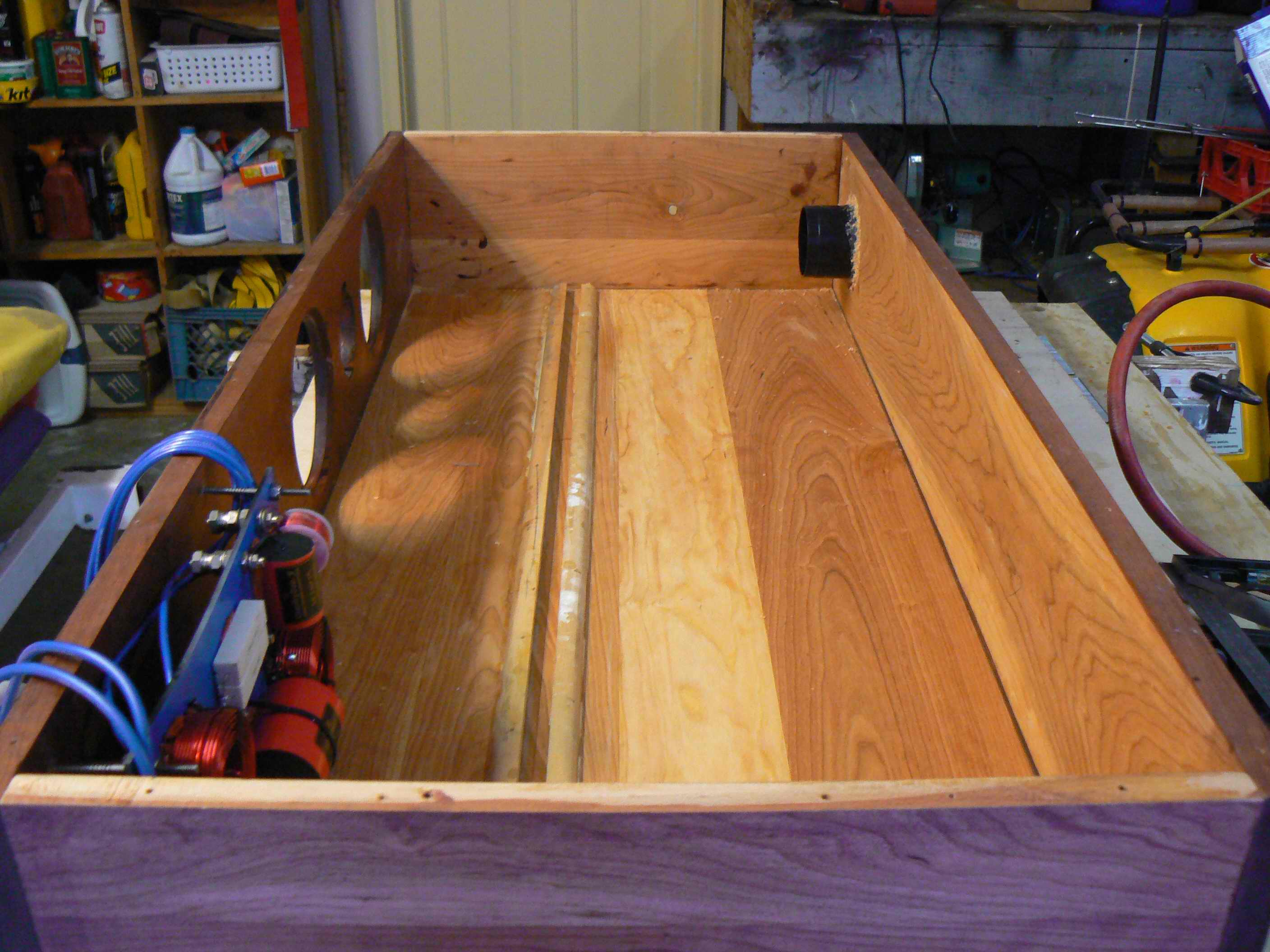

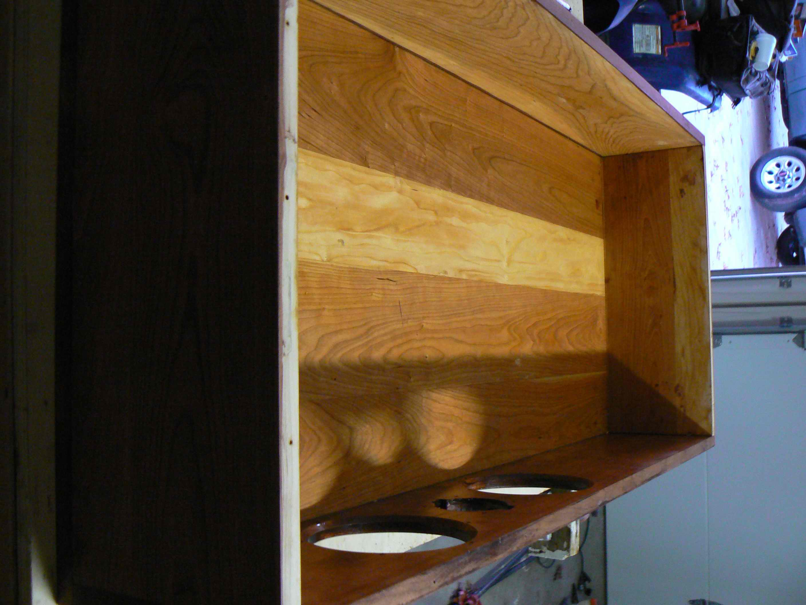

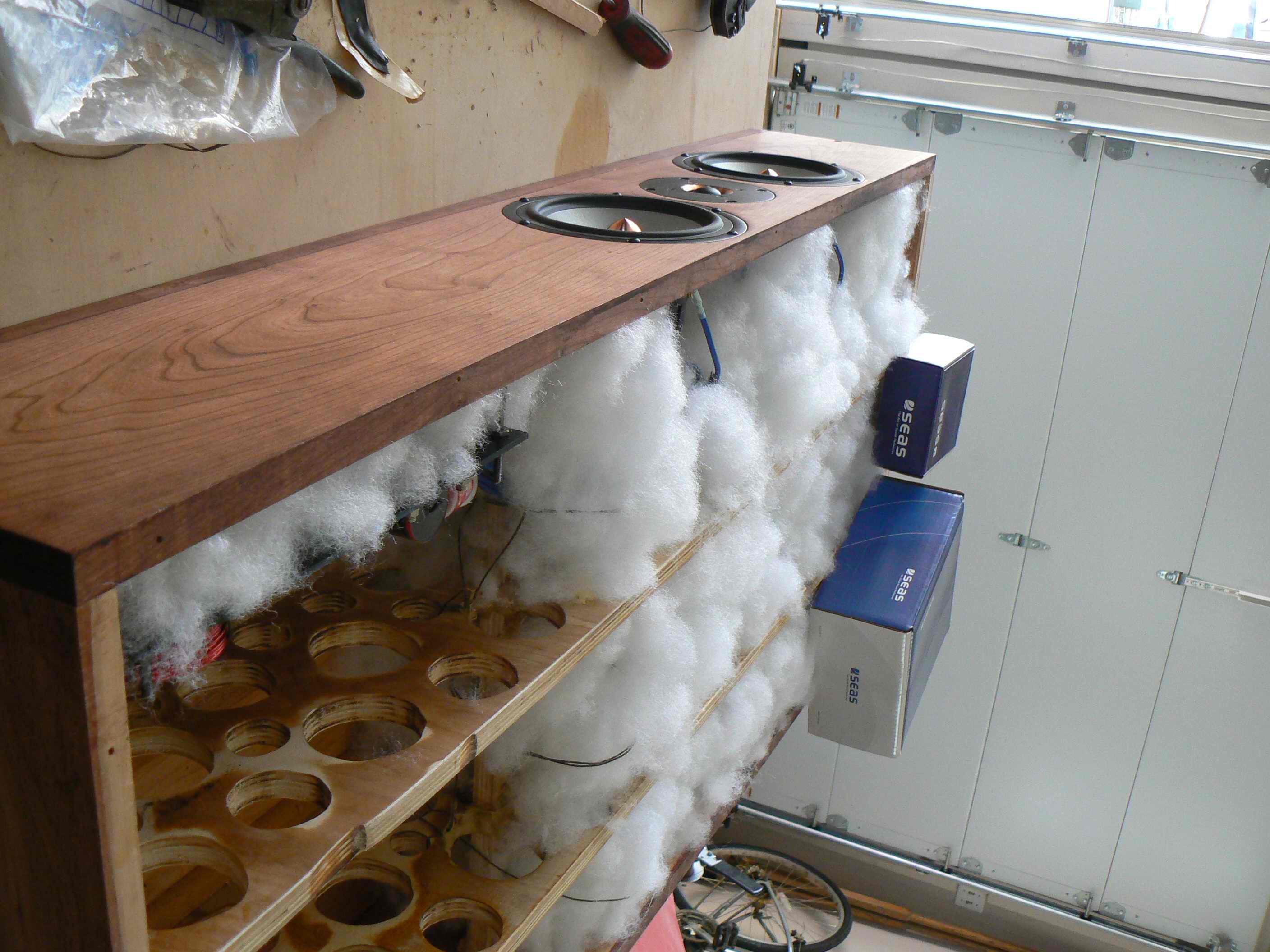

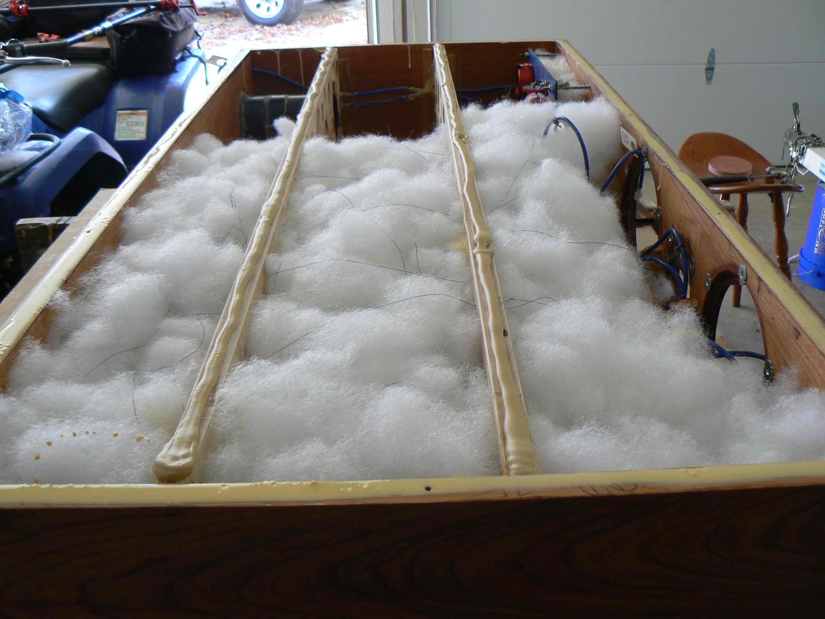

Here are 3 cabinet build up shots. Note the quarter round bracing to the sides and the thread to support the loose pack fiber. The drivers are temporarily installed for electrical/operational testing.

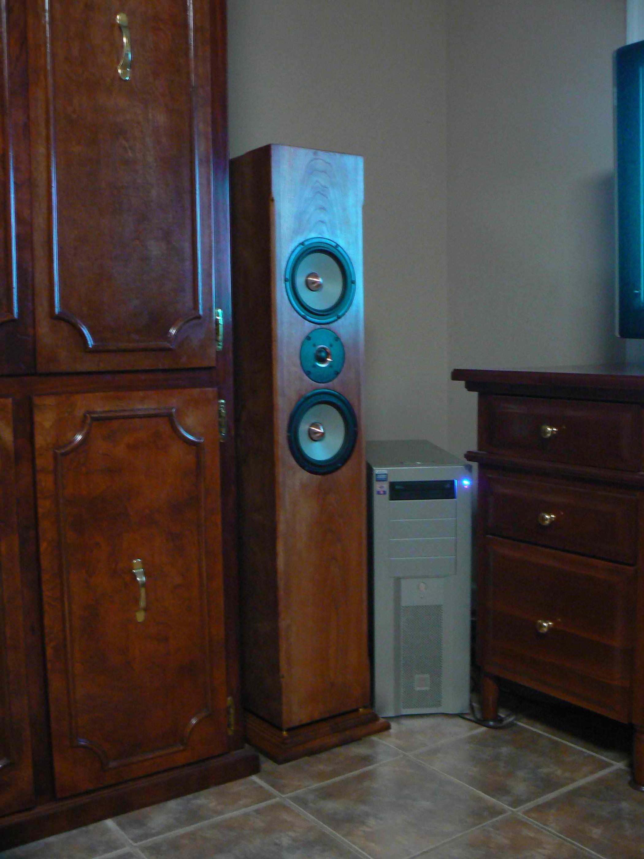

Well here ya go. Be gentle.
Look much too nice to be DIY -- and where's the beer bottle which seems to be de rigueur in DIY photos?
Those look fantastic. I love the cherry. Always interesting to see how others handled the building challenges too.
All Cherry, now that's cherry.
Looks good and I'll bet a "lunch at a drive up window" that they really dig deep and loud.

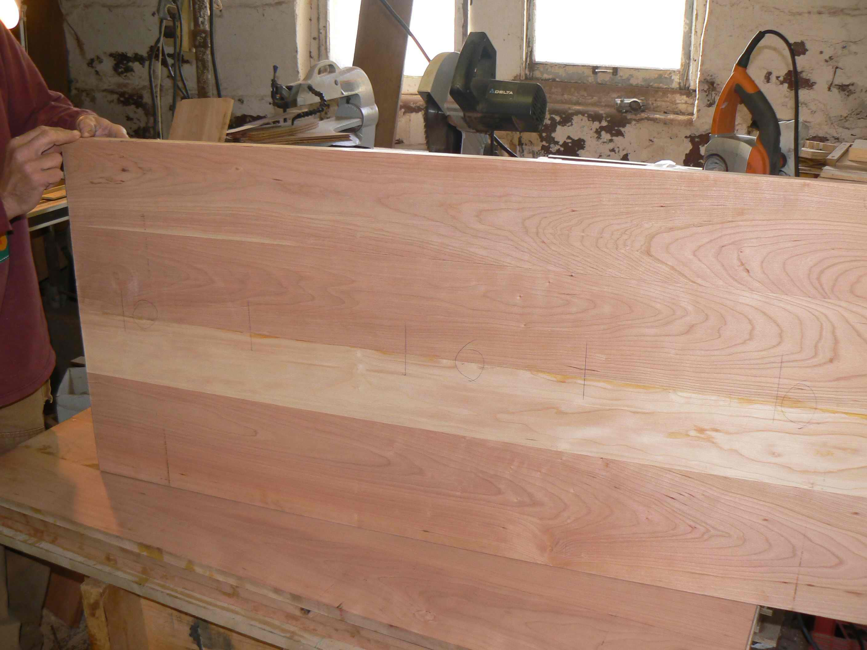

Couple of questions though,
Why did you make the sides overlap the baffle? and is there any way to update the Xovers in the future?
Not a dig, just wondering.
I love the color of 'em.

Ron,
It had to do with the width of the lumber. I had 4 peices that i could get
7-1/2". Each of them were exceptional quality. After screwing and glueing
I doubt it made much performance difference. FWIW i like the looks better as well. You know what the sound is like.
The xovers can be dug out from the bottom. Unless they fail they wil never be seen by me again. I would have to take the bases off and unless i rent a crane i ain't gonna pick these up no more. They weigh 92 lbs each.
