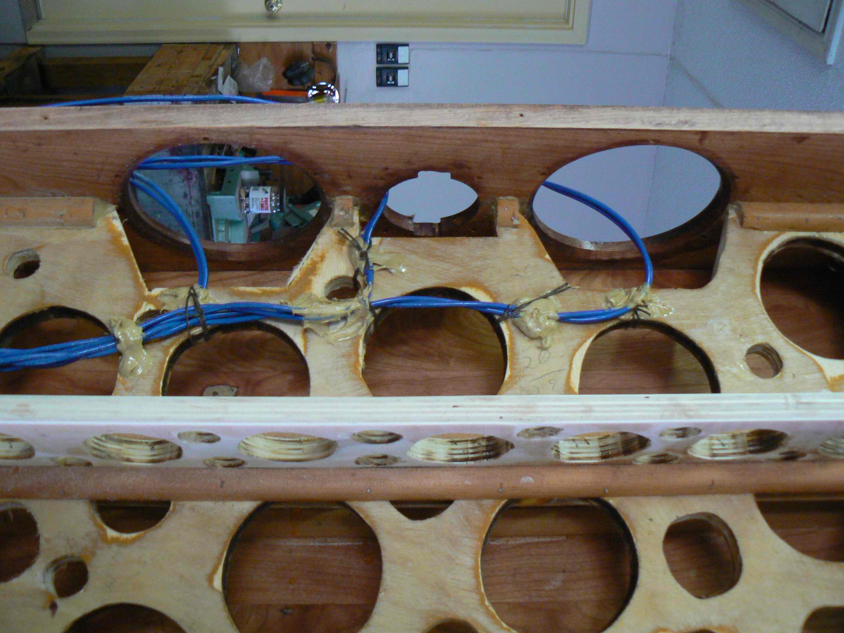

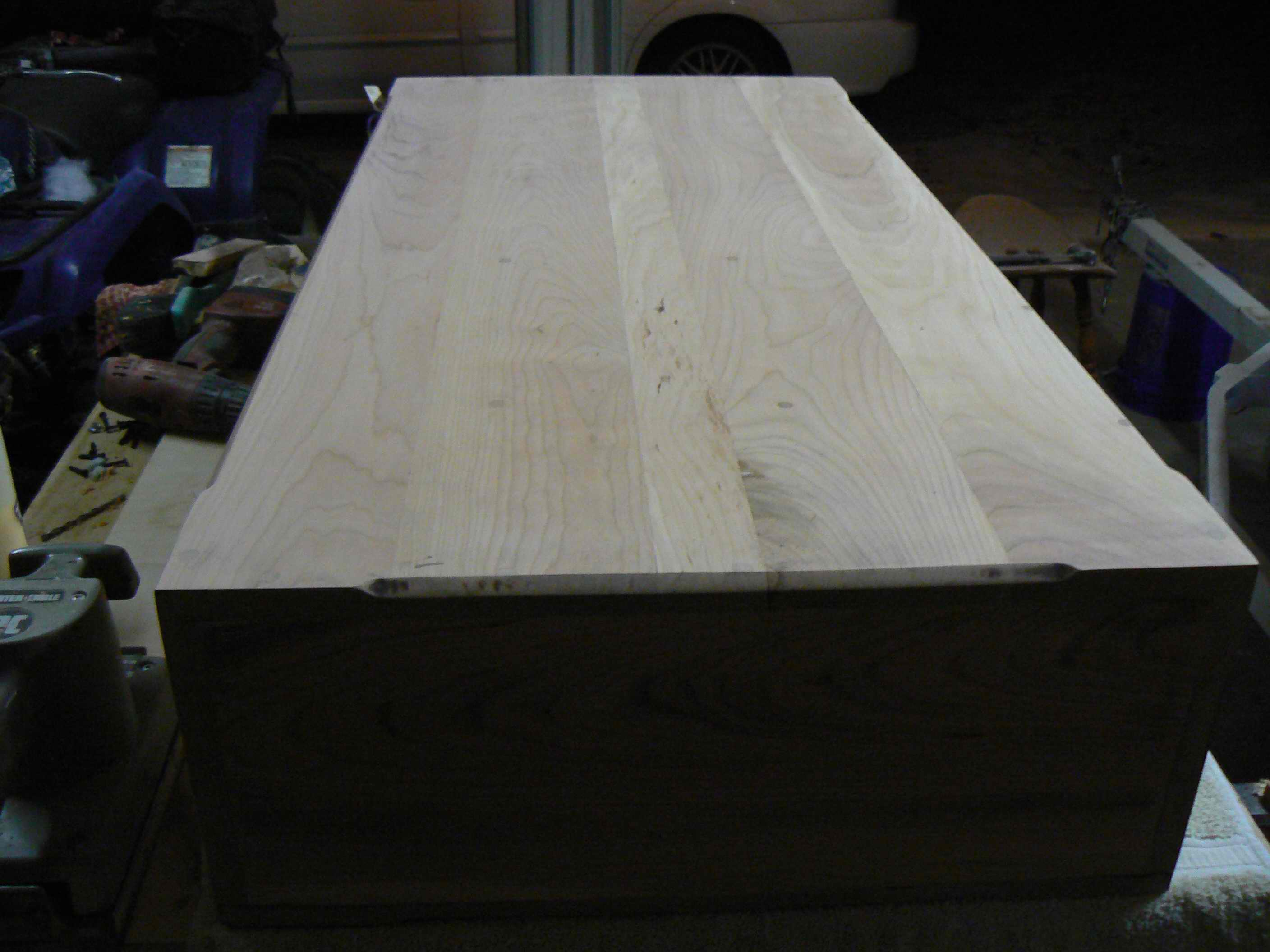

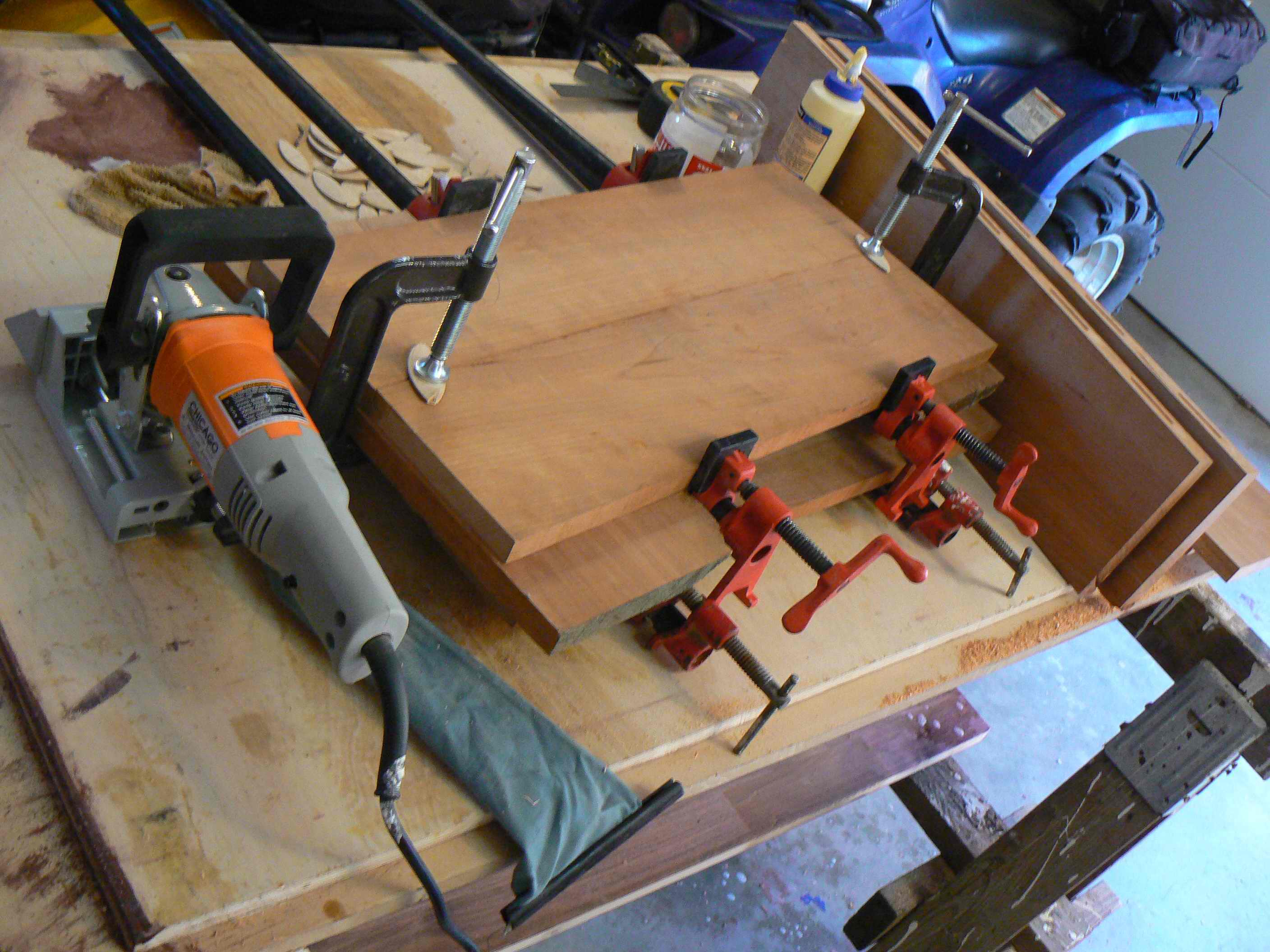

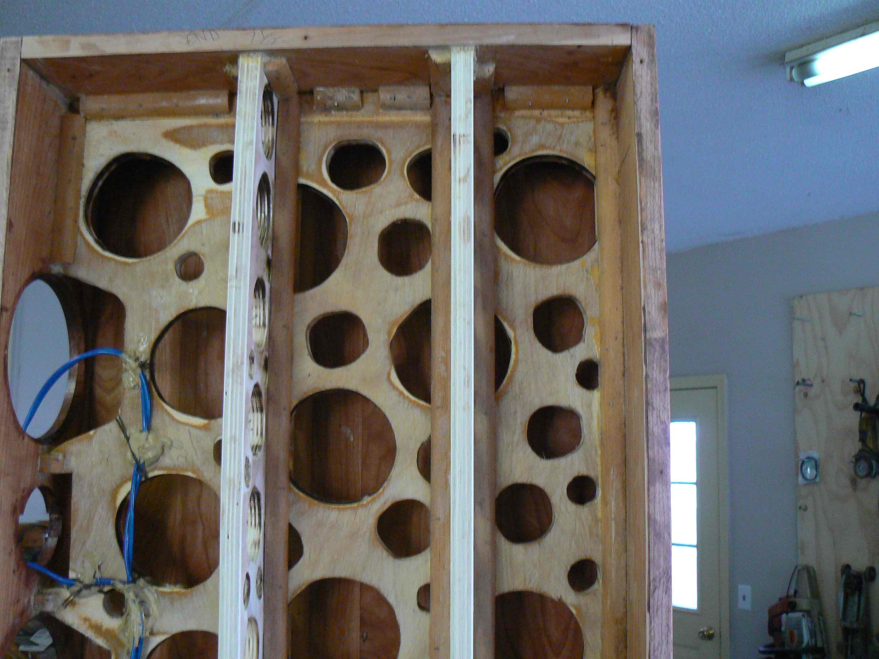

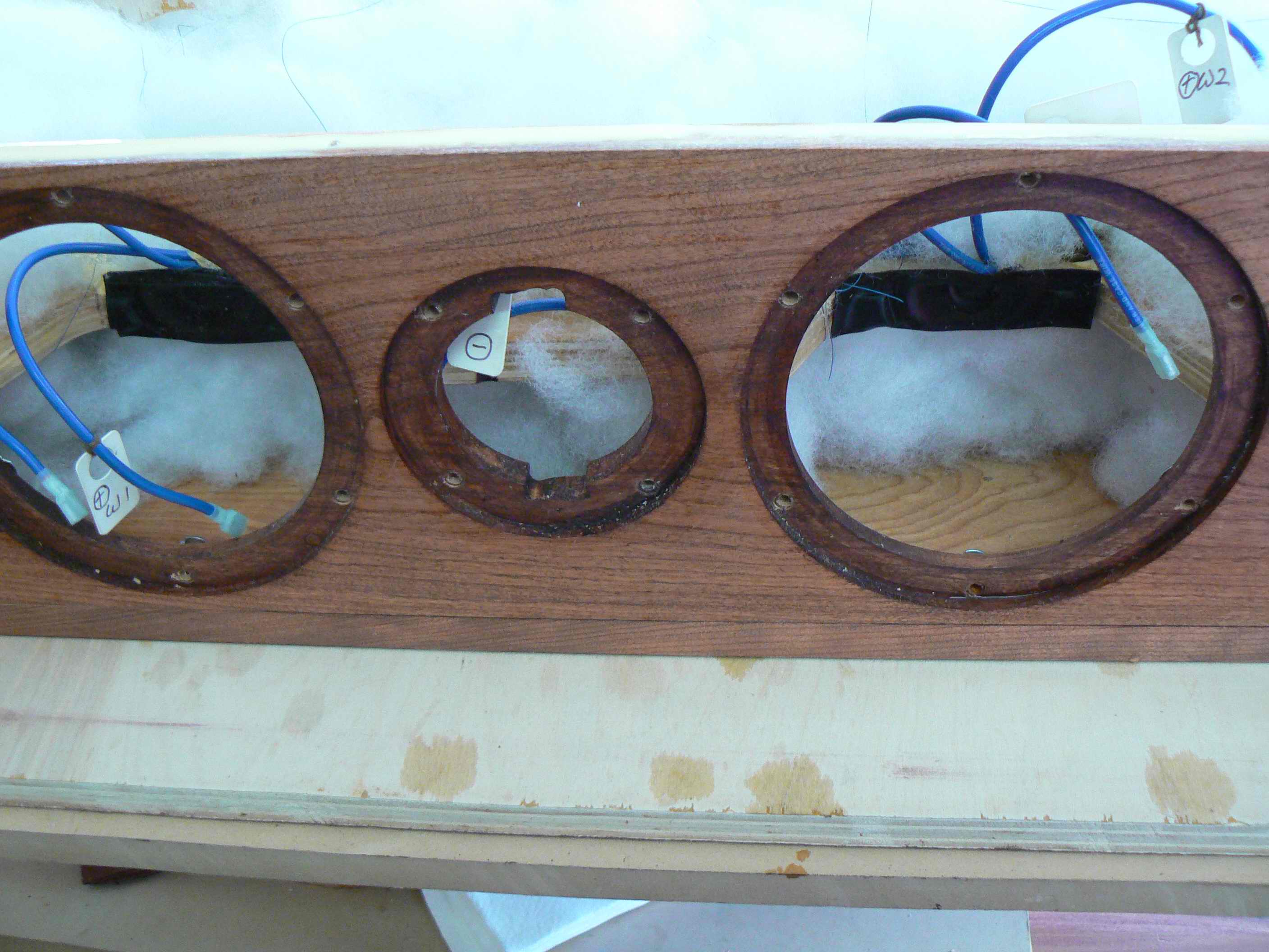

Here are some rough in shots that are just that -rough-. 2 things i liked.
the quarter round when glued and brad-nailed was like a weld job. These babys are like a brick once they are built up. Note the use of high voltage <HV> tape at the contact point of the drivers. i used 2 laps and the drivers just molded into it. Nice!

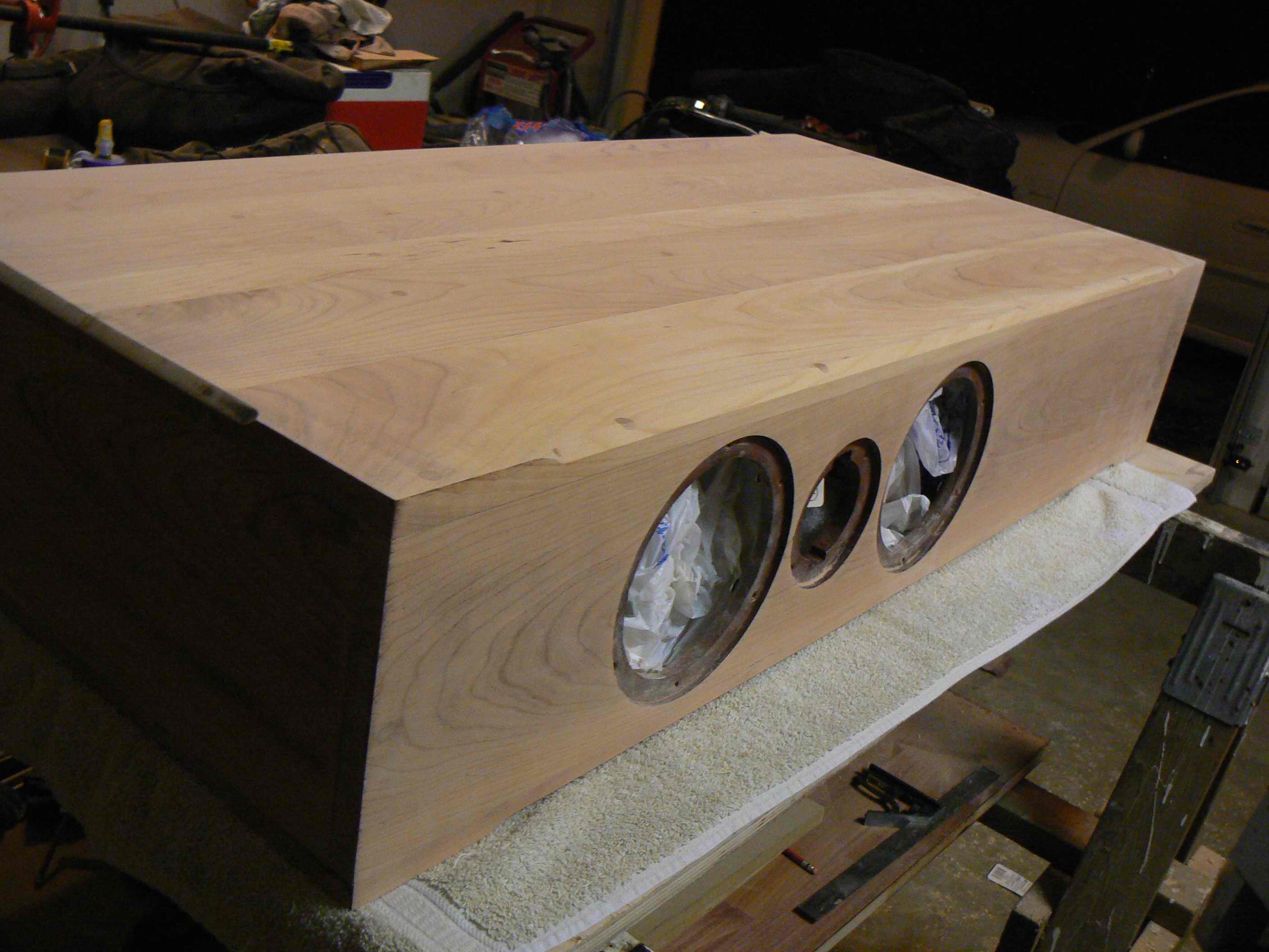

All for today... more tomorrow. Thanks for the kindness. More thanks for the questions.
All i did was follow instructions and learn from mistakes. I can tell what i did. The gurus here love the "why" questions. Truly i made choices for form over function. I look at them more than i hear them.

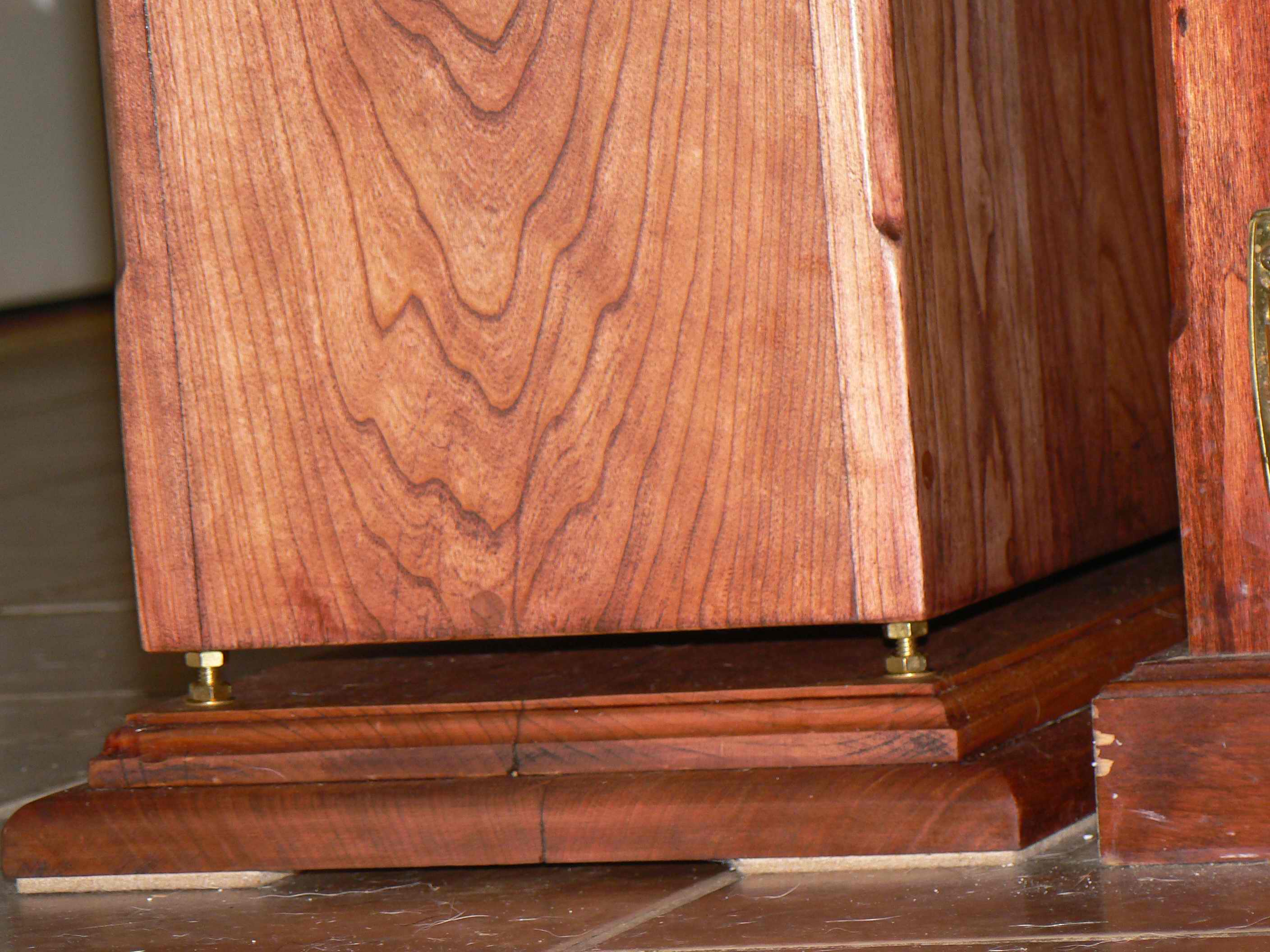

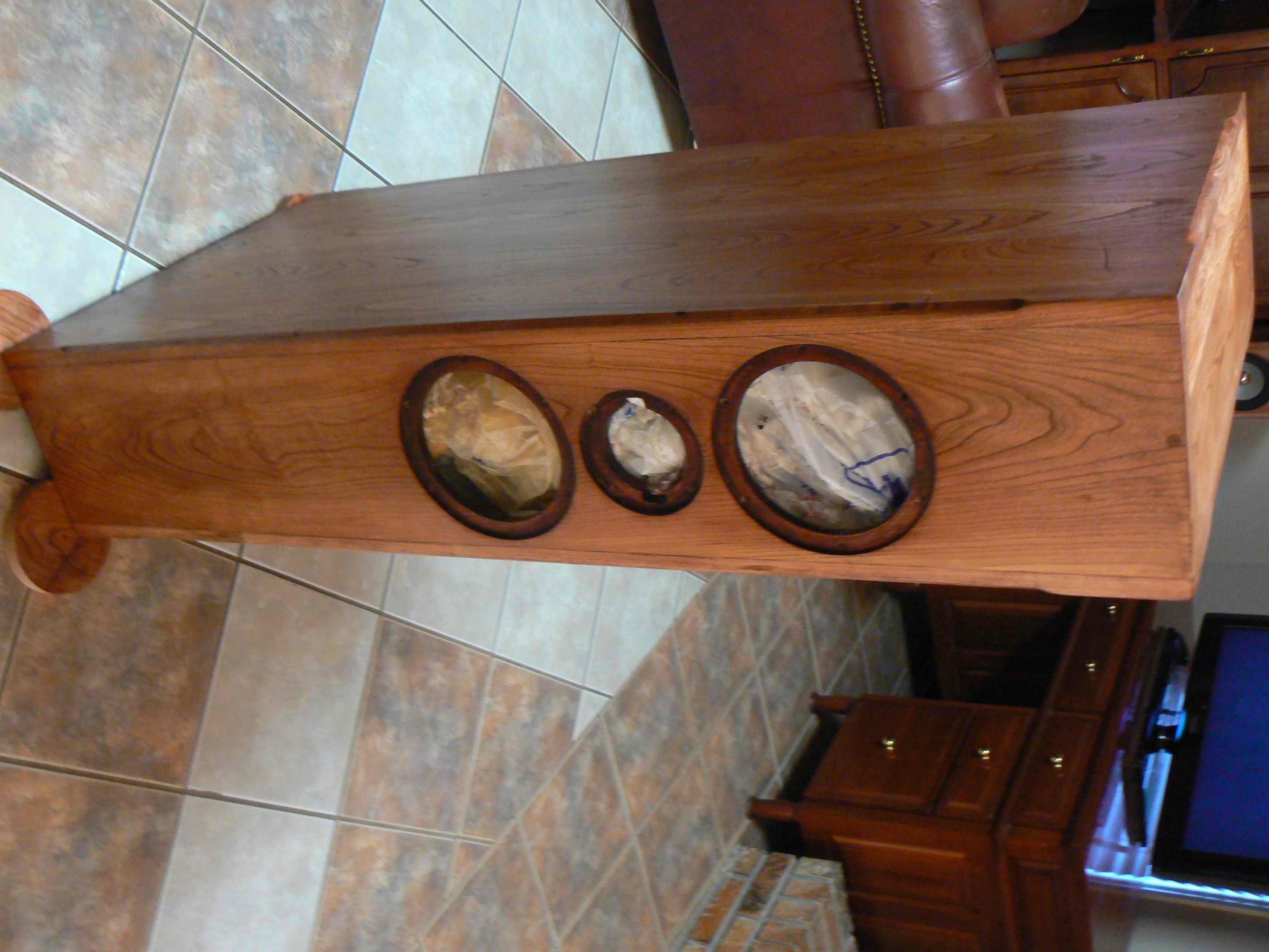

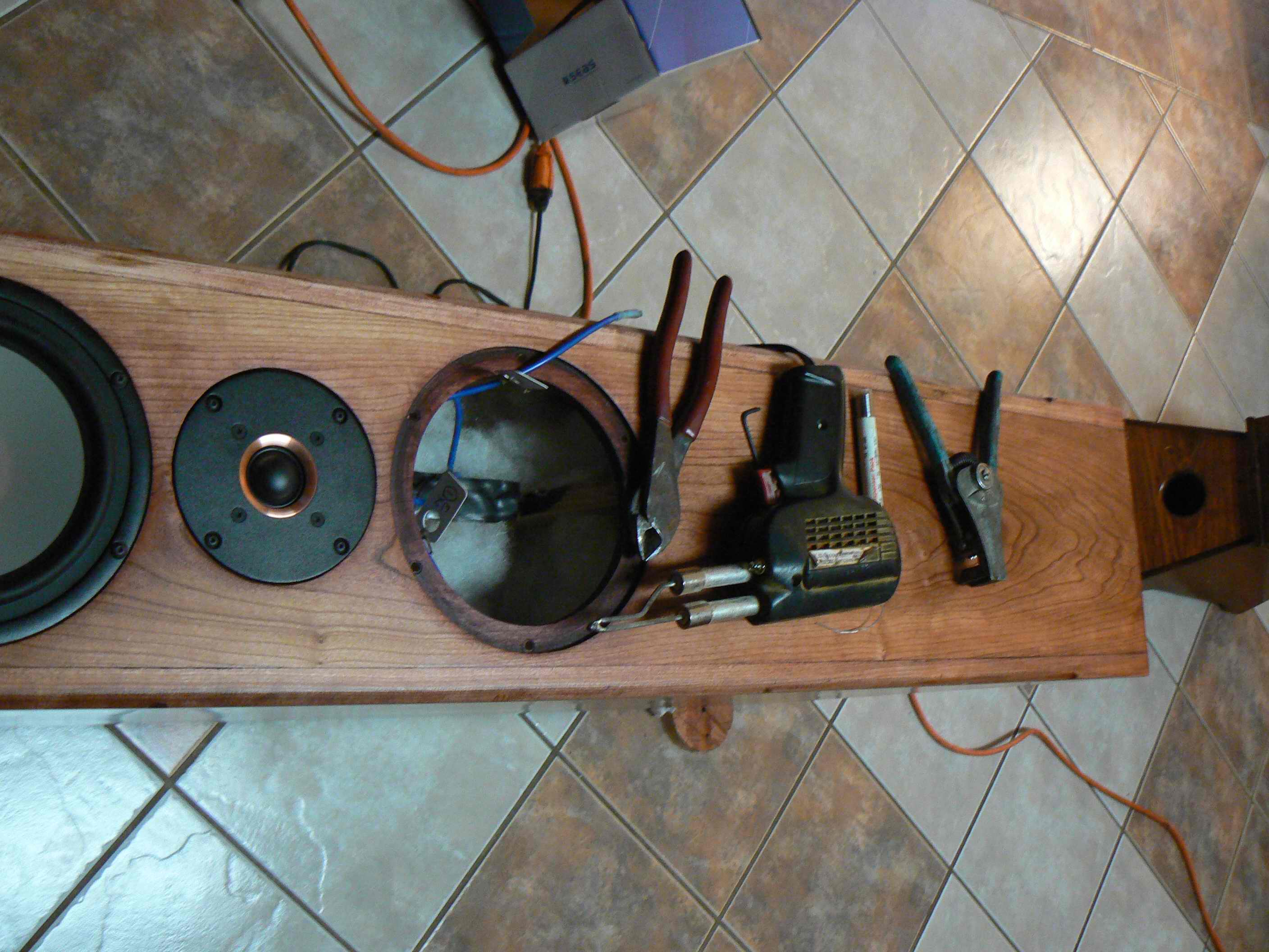

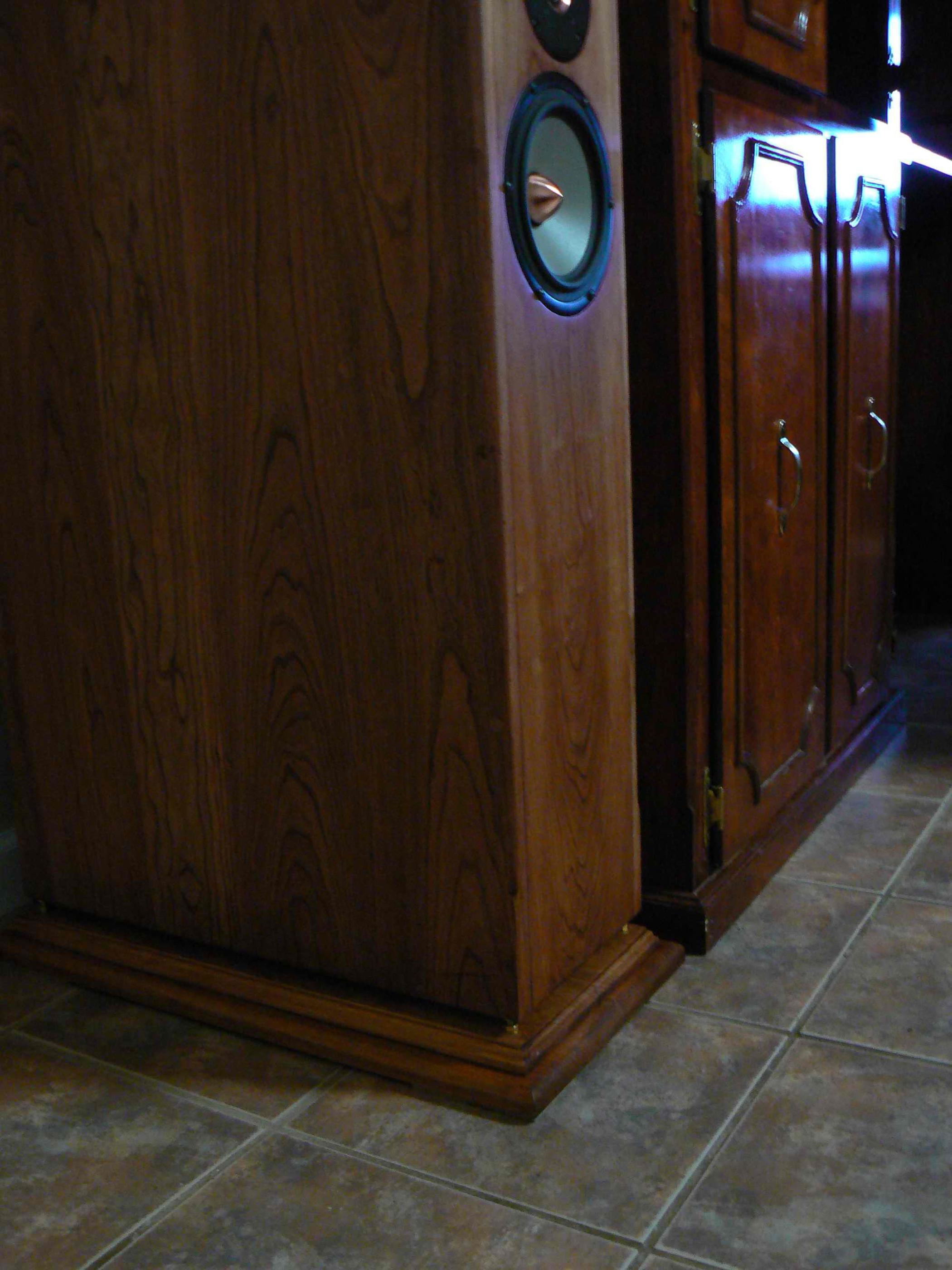

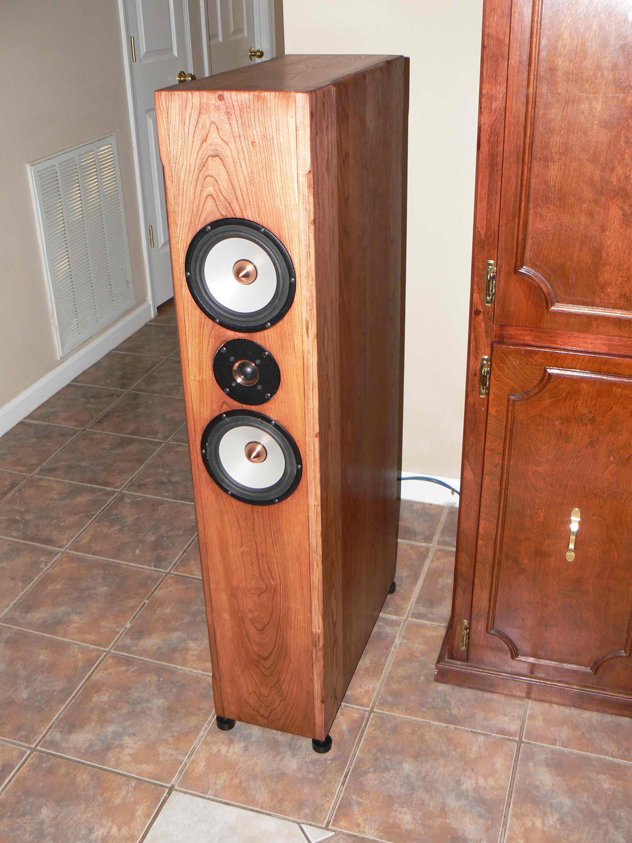

Tonight will end all this. The first is early in the test/orgasm phase. the drivers are now soldered in and pew😱 These bases SUCK! so back to the old biscuit joiner. I have a base in my mind... Just take it to form.
The first is the base detail, followed by a general base closeup, lastly a full shot of the left speaker. This will end the short thor (from me) photo shootout. Thank you for not flaming me for overloading the hd. For any who wish, I have tons more i will share via PM.

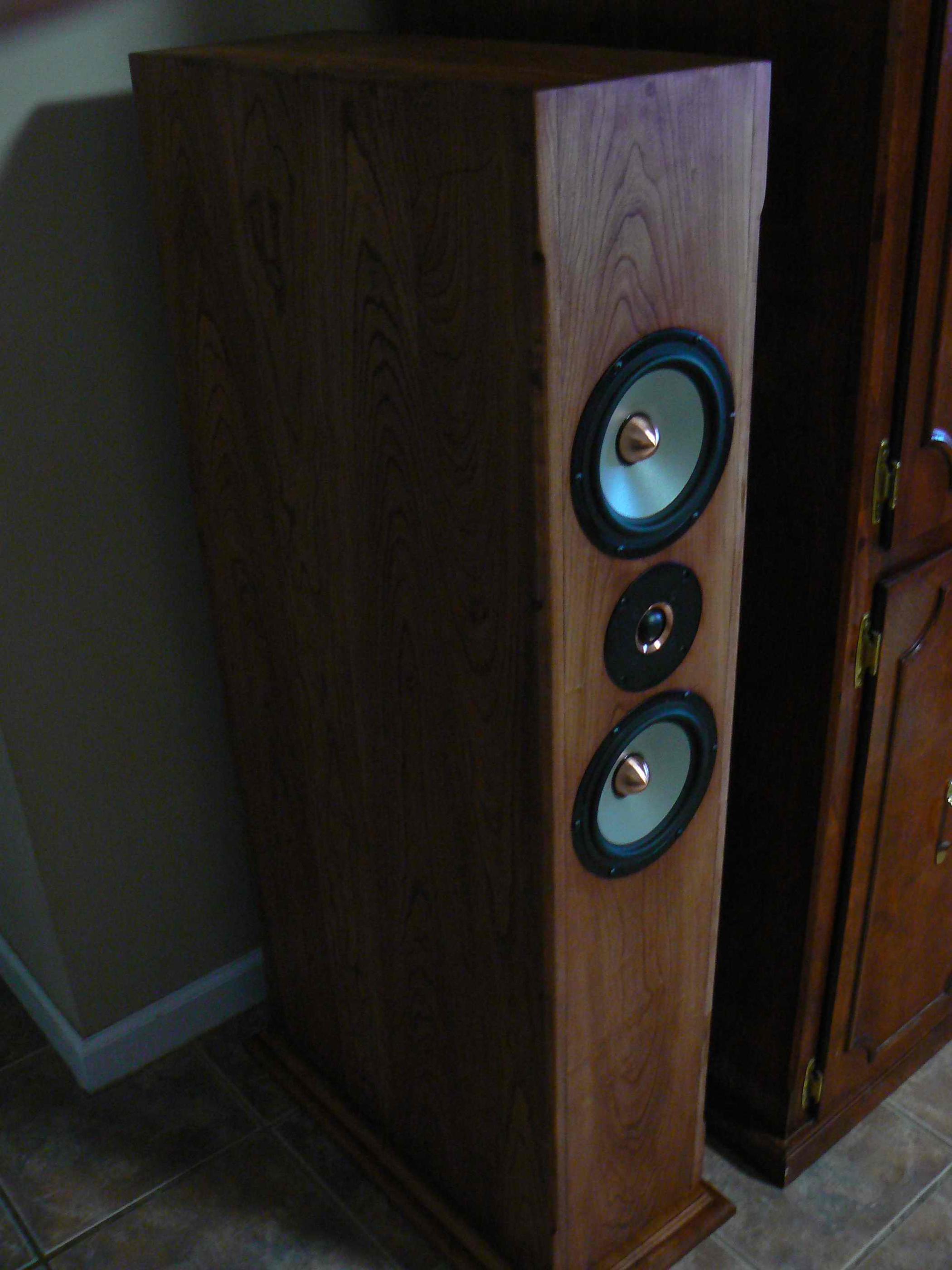

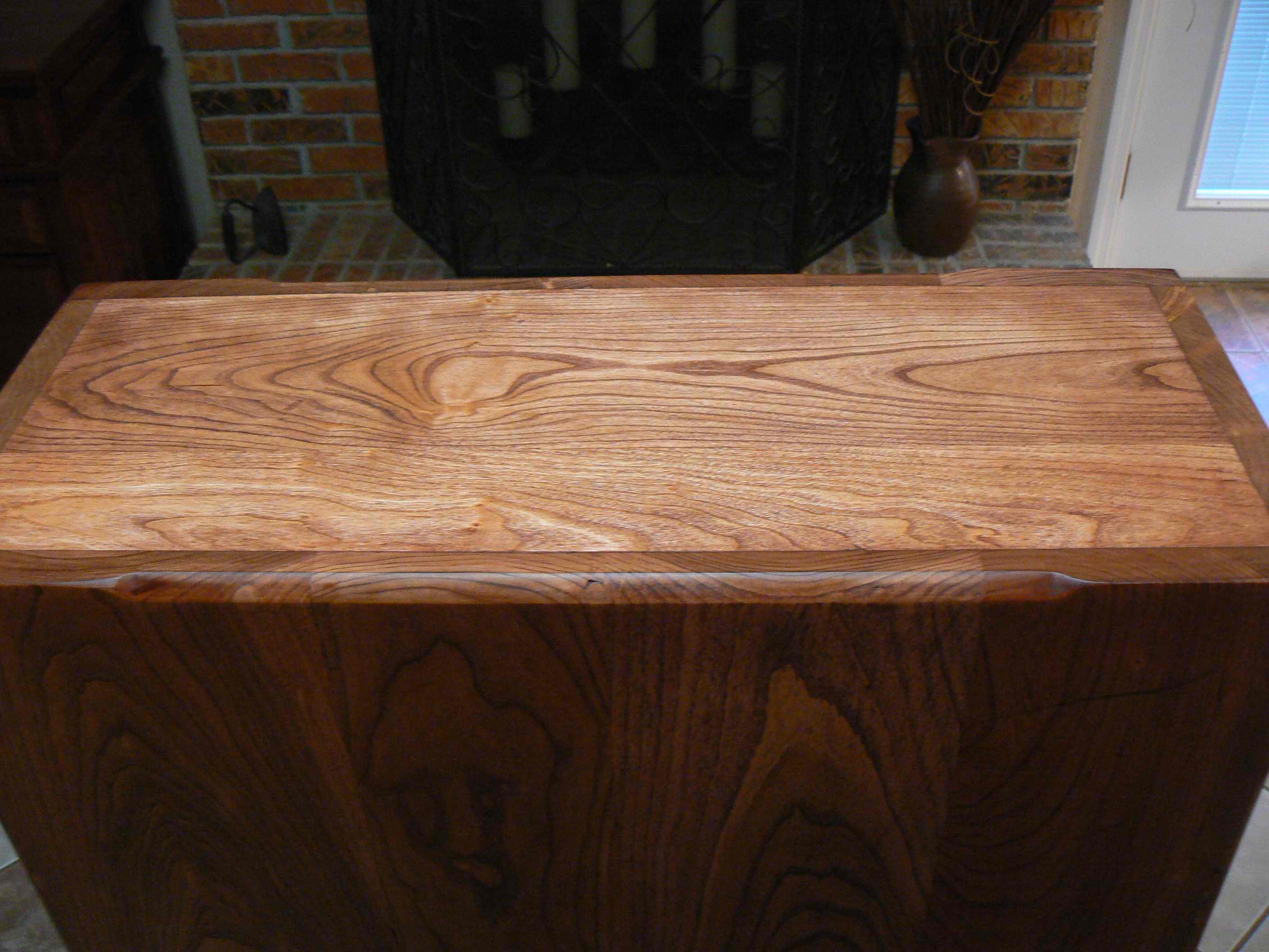

I really like the stop detail of the roundover bit on the baffle area. I use this detail often as well.
Glad you enjoy your Thors, the club grows by another member, Welcome.
I can't believe you let them on the leather couch!!! (kids) ;D
