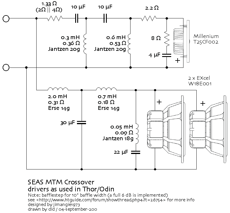

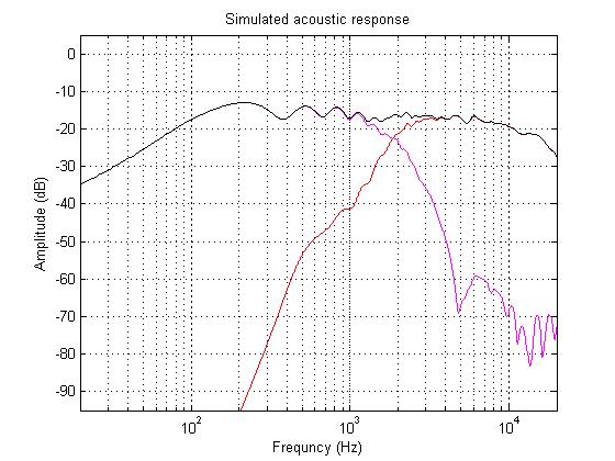

crossover problem discovered
I discovered the problem with Jim's crossovers. I had the .05 and the .45 inductors swapped. All my fault. 😱
Now that I have them assembled correctly they are a definite improvement over the originals. Bass is much improved, as is the upper midrange. They also sound more dynamic, probably because of the different tonal balance. They have a mellower, more natural sound than the originals which had a very etched harsh upper midrange. The sound is now more "analogue" but still very revealing.
I have a 2.7 ohm resistor in the woofer circuit and I have tried putting an 8 ohm in parallel, which drops it to about 2 ohms total. This reduces the baffle step a bit; maybe too much. I have also played with adding a .47 uf capacitor in parallel with the 5.7 uf cap. This gives vocals a little more texture. Whether that is a good thing seems to depend on the music being played. My inclination right now is to leave it off.
Thanks to Jim for designing this new crossover. I hope no one shies away from it because I assembled it wrong the first time. It is far better than the original.

Hello jimangie1973,
Hope you don't mind answering this but how critical are the guage / resistence values of the inductors in your latest crossover design? How would going from 14 guage to 12 guage change things on the woofer circuit? And how would going from a .45mH inductor to a .50 mH inductor on the tweeter side affect things?
I ask because I want to try out your latest design but I need to possibly order some more parts. I am currently using your first design and think it is far superior to the original design. Considering the improvement your first design made, I have to try your latest design out!
Thanks!
Ken
Well the 12 gauge inductors will give you a little extra bass boost. I actually run mine with a 12 gauge for the 1.2 mH. Try it and see how you like it.
The .50 inductor on the tweeter circuit will lower the cutoff frequency of the tweeter. It will add presence in the 2 kHz range. Small variations in this have an obvious effect on the sound. What you could do is start out with the .50 mH inductor as is, and unwind 1 or 2 windings at a time until you have the sound you like. It doesn't take many unwindings to go from 0.5 mH to 0.45 mH.
Jim
Thanks!
Thanks for the quick response Jim! I've ordered the parts I need. It will be interesting to compare the new x-over with your original. Tweaking is a huge part of the fun with the Thors (and audio in general).
Out of curiosity, what is it that you like better between the two x-overs?
Also, I don't know a thing about electronics but I was wondering how exactly does changing the guages of the inductors affect the sound? Is it simply the fact that the bigger inductors (larger guage) have lower resistence therefore they let more of the signal get through? Would this not affect the upper band (of the low pass) as well?
And what about the inductor in the hi pass circuit. Does increasing the value (larger inductor) block more of the high frequency from travelling between the + and - sides before the tweeter therefore more of the high frequency signal gets to the tweeter? Conversly, would a smaller inductor allow more of the high frequencies to be shunted to the "-" side before it gets to the tweeter?

I am building a fat thor. I would like to use one of the revised X-O's instead of my old one from Madisound. Am I correct to believe that the latest revised X-O is for all of the redesigned Thor's. Or better yet the Fat Thor?
Uhm. Sorry Boom Boom for interupting.
I have a question related to the subject first stated in this thread.

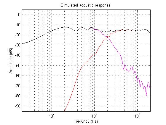

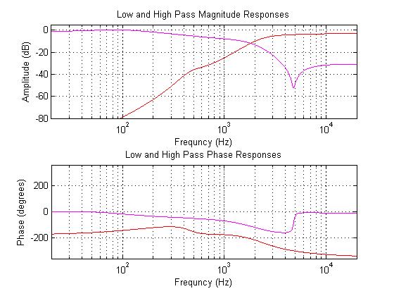

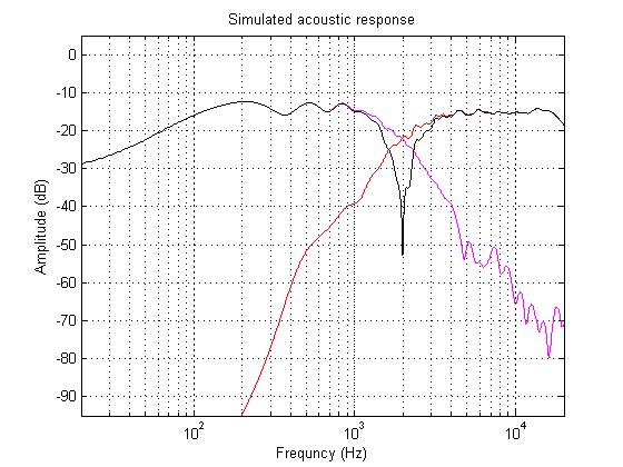

That's correct. As long as the baffle width is 9-10 inches with MTM driver configuration. The schematic is shown in the linked thread. It's LR4 crossed at 1950 Hz.
http://www.diyaudio.com/forums/multi-way/155887-seas-thor-index-threads.html
I've been messing with an LR4 crossed at 1500 Hz. I decided to do this to determine whether the 3rd order nonlinear distortion peak of the W18 at about 1600 Hz was at all audible. I've played around with it quite a bit and I really can't get the 1500 Hz version to sound any better. The 1500 Hz crossover sounds slightly different but whether that's because of the W18 distortion peak, who knows. It's also got more components because the Millenium resonance peak needs to be handled with a parallel RLC notch circuit.
