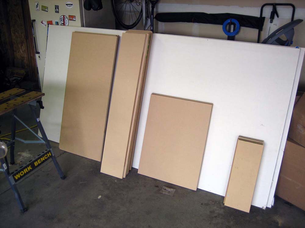

I picked up the rest of the cabinet materials today:
Hole cutting bits: 12.97
2 4X8 3/4" MDF: 56.68
45deg router bit: 35.97
Titebond III: 8.17
Rubber feet: 5.38
Silicone caulk: 5.97
2 square yards 1/2" carpet padding: 10.44
12" 3" PVC pipe: 5.33
Laminate roller: 12.98
Contact cement: 9.98
Total for cabinet materials: $357.51
Not bad, I budgeted $300, but a lot of this is for tools, which don't really count, right?

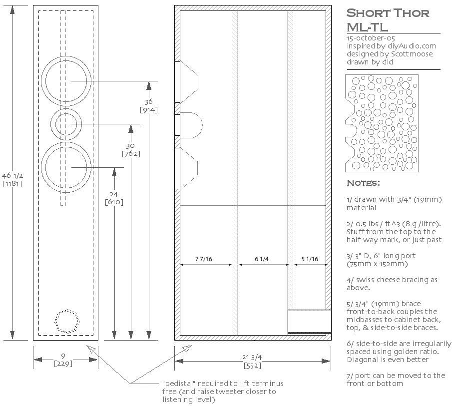

Golden ratio help?
I'm trying to calculate the positions of the two side-to-side braces using the golden ratio.
I figured the internal depth of the enclosure to be 20.25" (overall depth of 21.75" minus thickness of front and back MDF panels 1.5"). So I want to divide the remaining space into three spaces using the golden ratio. The internal braces will be .75" thick, so will occupy 1.5" of the 20.25".
So here is my math:
20.25-1.5=18.75
18.75/3=6.25
6.25X1.618=10.1125
6.25X.618=3.8625
Now, when I go to double check (6.25+10.1125+3.8625) I get 20.225, when I would expect to get 18.75.
What am I doing wrong?

Re: Golden ratio help?
6.25 + 6.25x1.618 + 6.25x0.618 = 6.25 (1 + 1.618 + 0.618) = 6.25 x 3.236
dave

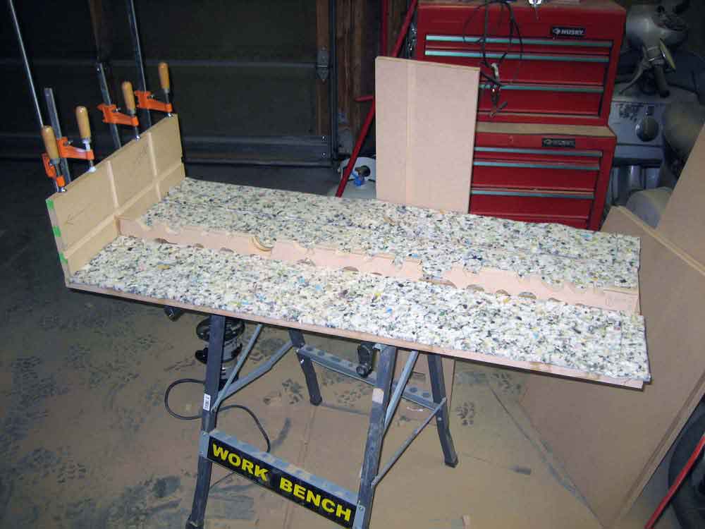

More construction pics. The interior braces all fit into dadoes, and the sides are attached with glue and biscuits. The tricky part is figuring out the order of assembly. I want the bottom to be removable, so the crossovers will go there, but I also have to figure on the port running through the top to bottom braces, and cutting the main brace to fit the drivers perfectly.
I tried using hole bits on the braces, but they take FOREVER to drill, and I just have a cordless, no drill press. So for the side to side braces, I just routed random holes, which is much quicker.
