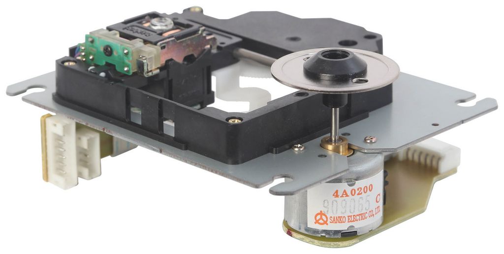

1. Check if lens can be moved freely and there magnets are not in friction with lens coil.
2. Make sure your optical ribbon cable make contact. I suggest you to replace this cable.
3. If above do not solve, replace LA6541
Tibi
OK, the lens cannot move freely. There's something blocking them, but I can't see the magnets.
I'm using the model in the picture below, with which I'm not as familiar as with the standard model.
I have never tried to open the cartridge. I believe there's some sort of alignment between laser and photo detector that would be lost if I get them apart, damaging the whole thing... no?
I can see the magnets touching the magnets now. But how to fix this?
