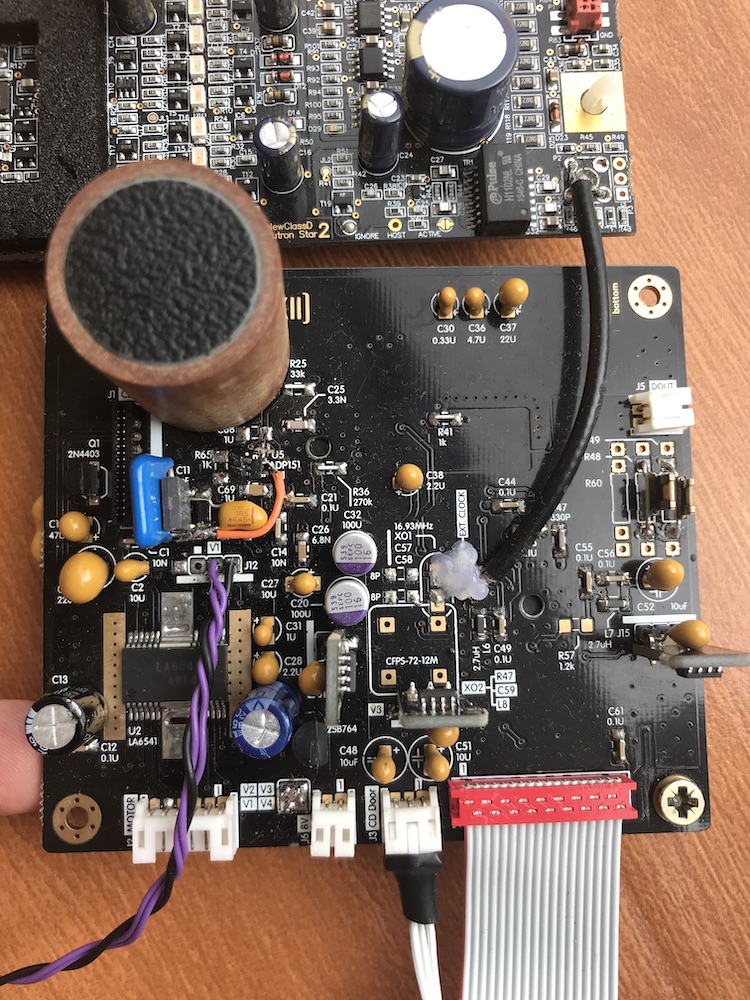

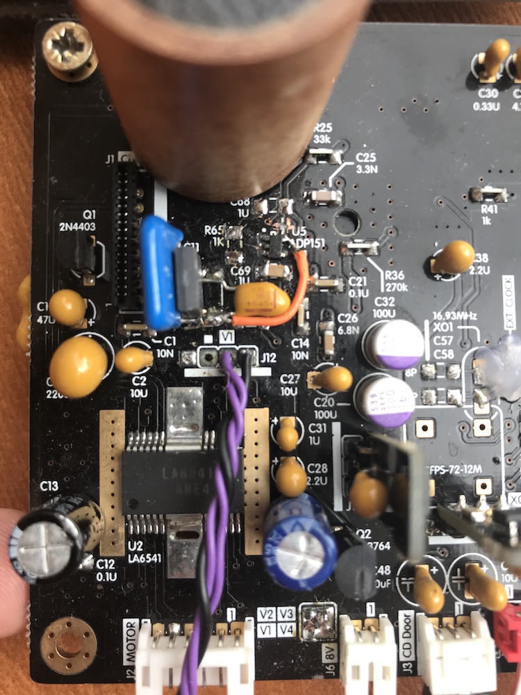

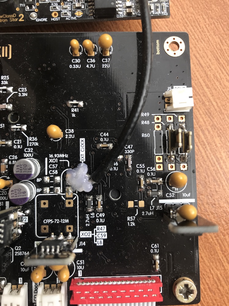

Been very busy here - no time to play with my toys. Finally got a bit of time so here are some pics of my lovely mess. As you can see because of all the work around V1 and ADP151 is looking messy. Embarrassing to have it displayed here for all to see 🙂
I am currently powering V1 from Zeno 5V. The extra green wire on the rear is link to GND because I broke that pad with too many install/uninstall procedures.
V2,3,4 all Vicol miniregs powered by Zeno 8V.
I have tried all the different implementations of ADP151 as per post#1819 (but not option 3). Both when using Zeno and when using LF50 reg. All combinations return the same result so I am of the opinion my fault does not reside around V1 and ADP151 implementation. I have not gone back to vanilla here ie. no ADP151.
From ADP151 I read 2.54v and at other side of L1 I read 2.51v
As previous I read TOC and play for 1-2 seconds before returning to index.

I need some detailed pictures, to see what you have down and how you have implemented.
Tibi
Thanks for pictures !
I suggest you to add ADP151 input capacitor, 1uF ceramic and also add 1K resistor.
Other straps are not needed.
Tibi
Tibi
Do you mean C69? input capacitor? it is there
Do you mean C68? R65?
But with trace cut above U5 these no longer have electrical connection to U5?
I have 10uf tant and 1k parallel through hole on C11

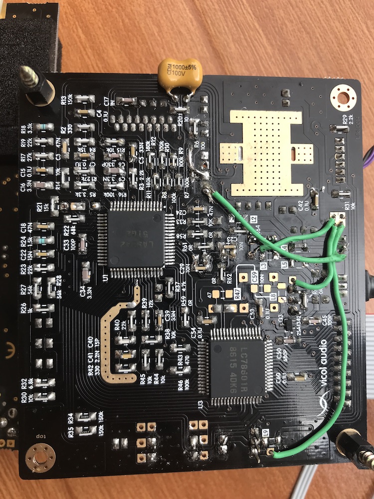

Ok still no joy here!
Have removed all ADP151 components etc. Replaced L1
Gone back to using original Shiga psu and trafo
V1,2,3,4 all in range from 5.01v - 5.04v
Steady 2.54v across L1 and at pin58
Using a new vanilla mechanism and laser and new ribbon connector
Using Tentlabs XO
Laser pops up and down tracks across CD but DOES NOT READ TOC
Done everything that I have done in the past when I have had problems but cannot get this to work. I don't have a scope so can't give any readings like that. Just working with DMM. I get the feeling that I am missing something simple but what?.....

I suggest you to clean the board with isopropylic alcohol and check if there is no pcb trace damaged.
Another issue may be that due excesive solder/desolder main IC's get one pin or more desoldered as well.
Resoldering main IC's may solve the problem.

Hi Tibi
Followed your most recent suggestions but no luck yet.
Traced continuity from each pin on ICs to nearest component (using Mk1 schematic as reference - I know there are some differences especially with labelling). All seem to check out fine.
So must have fried an IC? Otherwise I am all set to pull the mini regs etc. and go back to as close to zero mods as I can.

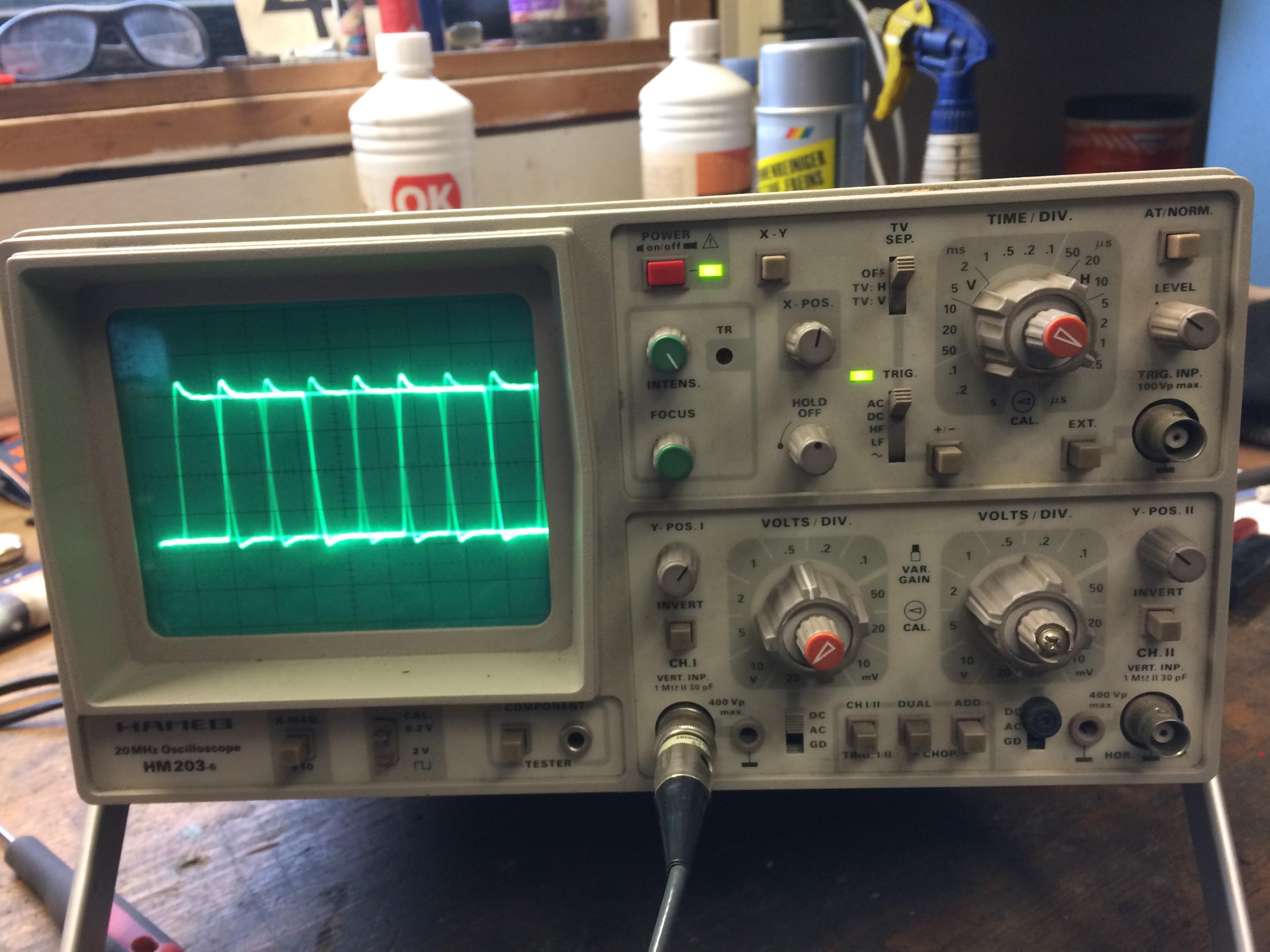

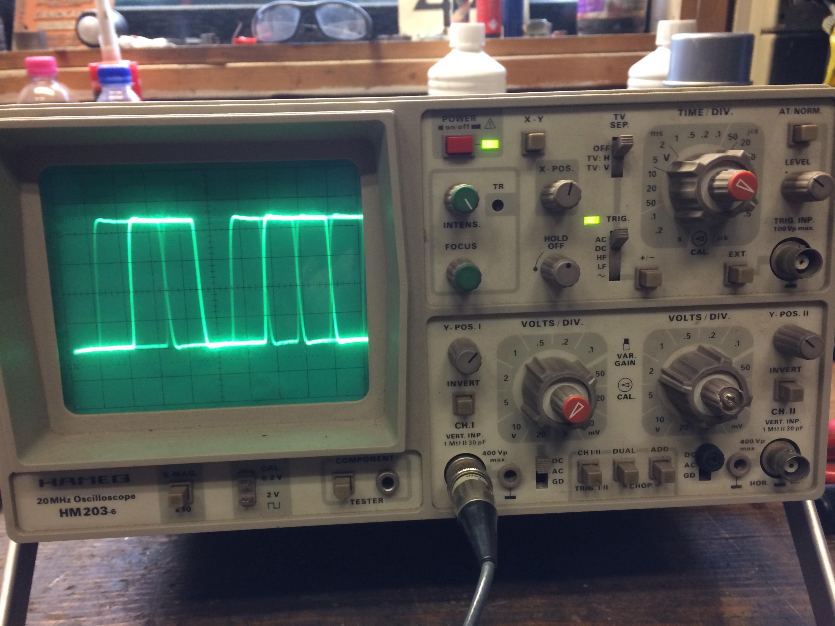

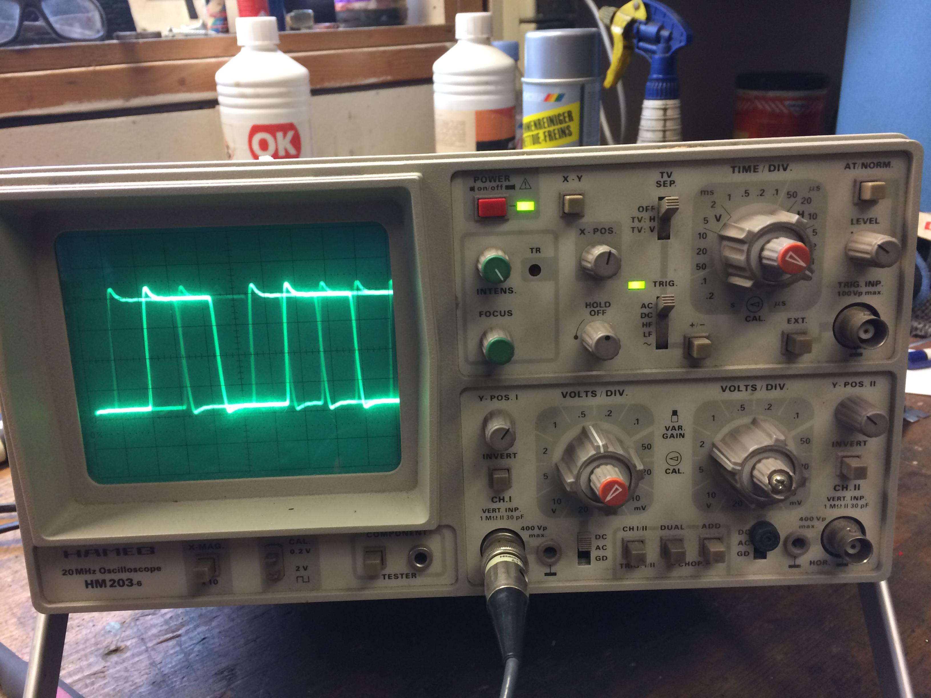

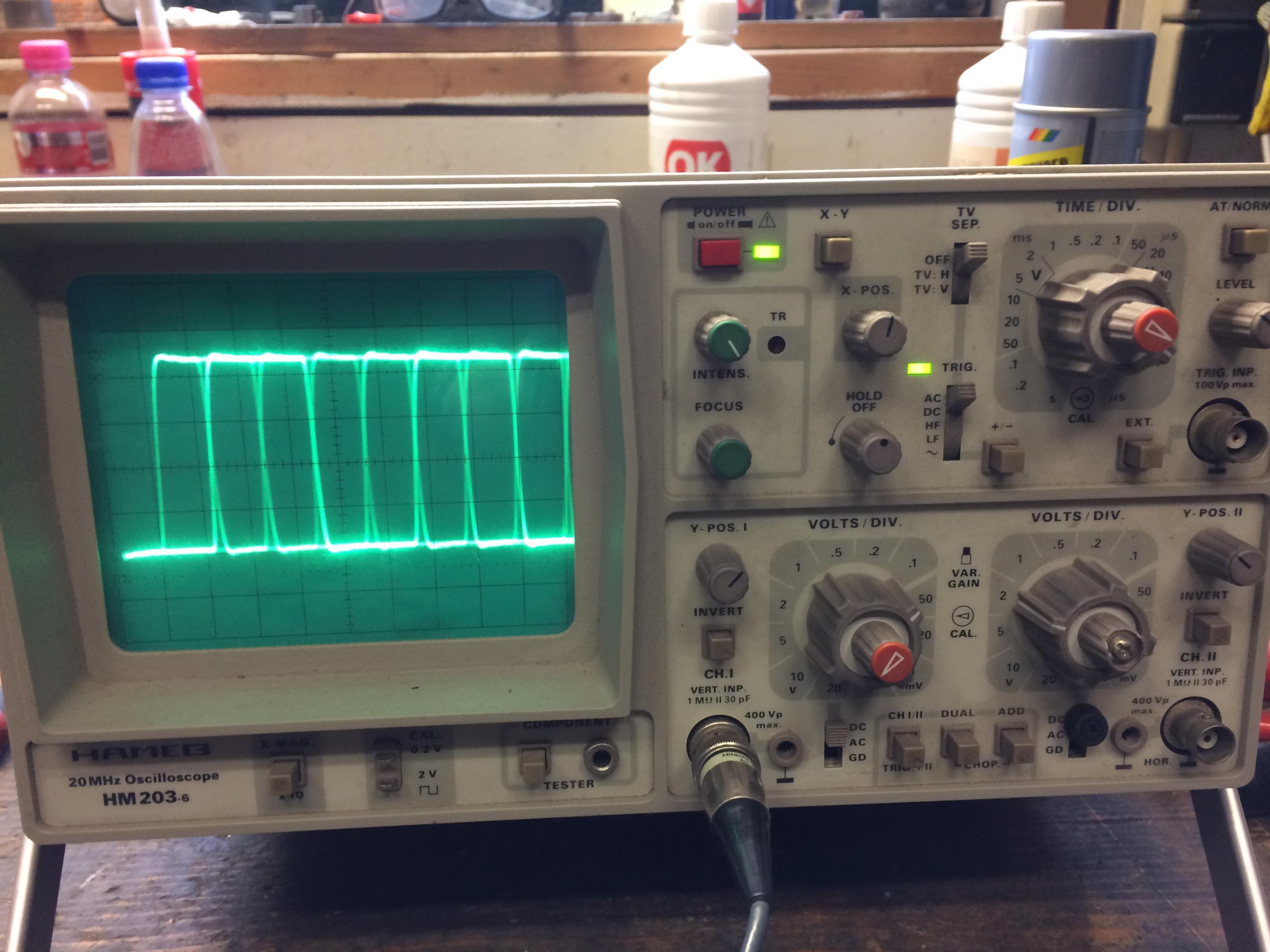

Hi Tibi,
I managed to borrow a (very old) scope.
I dont really know what i am doing, but i got a signal.
pic1 at spdif out no music playing
pic2 at spdif out music playing
pic3 at pin 29 no music playing
pic4 at pin 29 music playing
regards,
John
regards,
John
After a closer look, I see that at pin 29 you have on Chan1 0.5V/div while on connector output you have 50mV/div which is far too low. So this is obvious to me that there is a connector issue or something wrong with resistor divider.
Tibi
