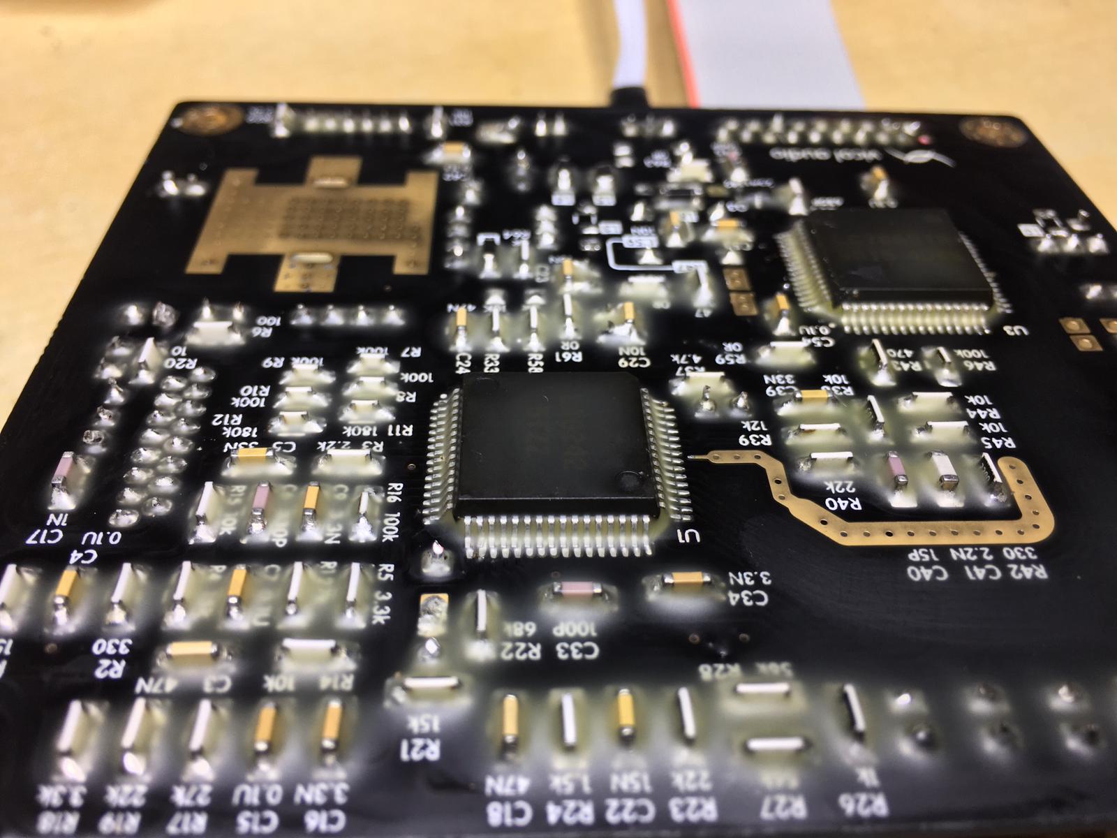

Cover your Shiga MKII with beeswax to protect against humidity and oxidation.
Drop beeswax on the board and use your hotgun to uniform the wax over entire board. make sure that you avoid connectors and LA6541 dissipation layout - unless this have a small heatsink.
