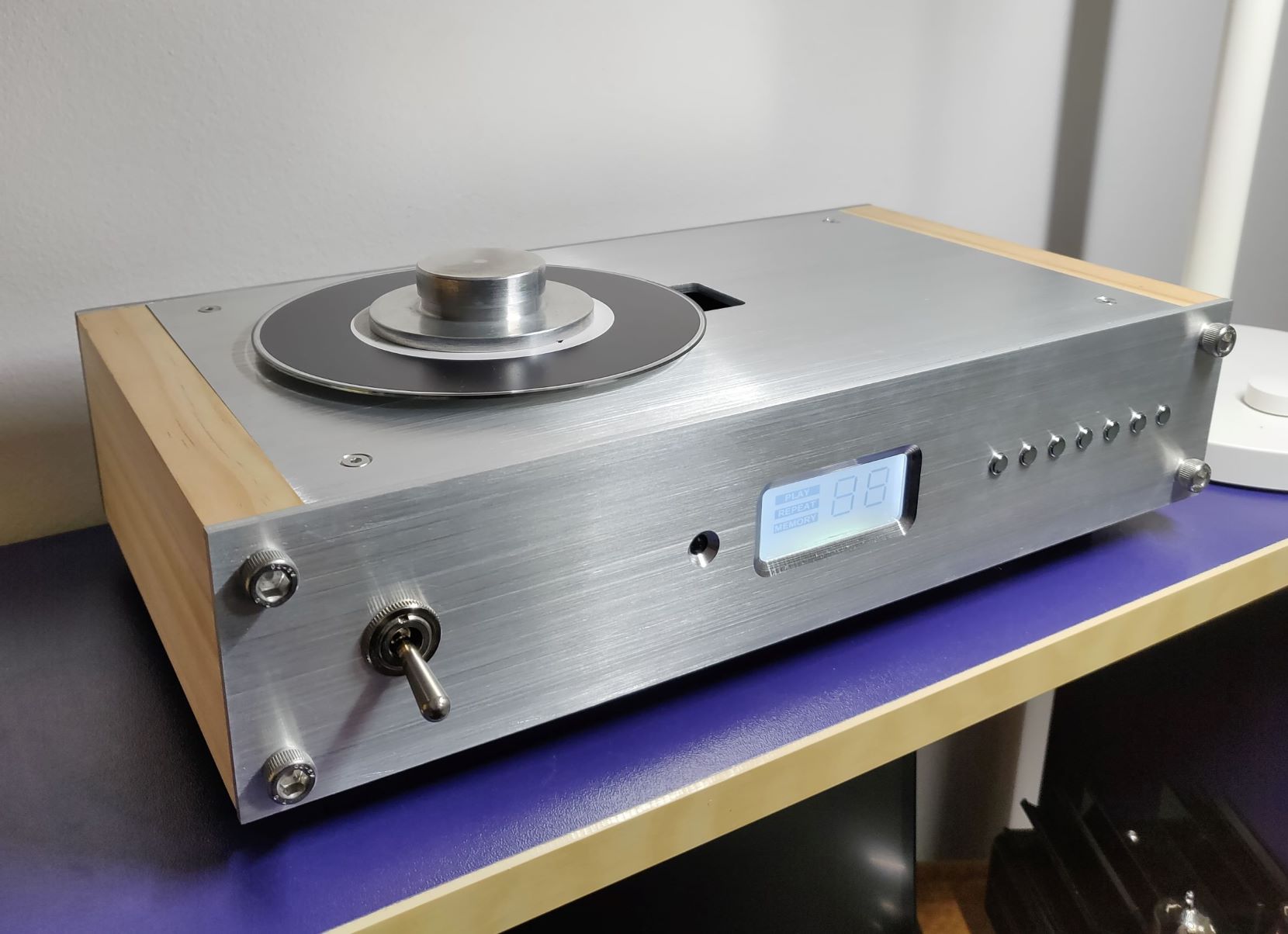

After two years I've finally completed my build. While I've had it playing for nearly a year now, it's great to have the enclosure finished too. Thanks for your help in the beginning stages, Tibi.
Remote control is by an Apple remote with the IR signals decoded by an Arduino Nano. The Arduino outputs are linked to the button PCB through optocouplers.
Like very much your idea to decode trough arduino ! Gorgeous implementation !

I can find you are using another clock placed under the CD turnable
Very Nice Work, The small chassis is what the reason I love 47labs product too
Thanks for your Sharing indeed
That "other clock" is an arduino nano used to "translate" Apple remote.
