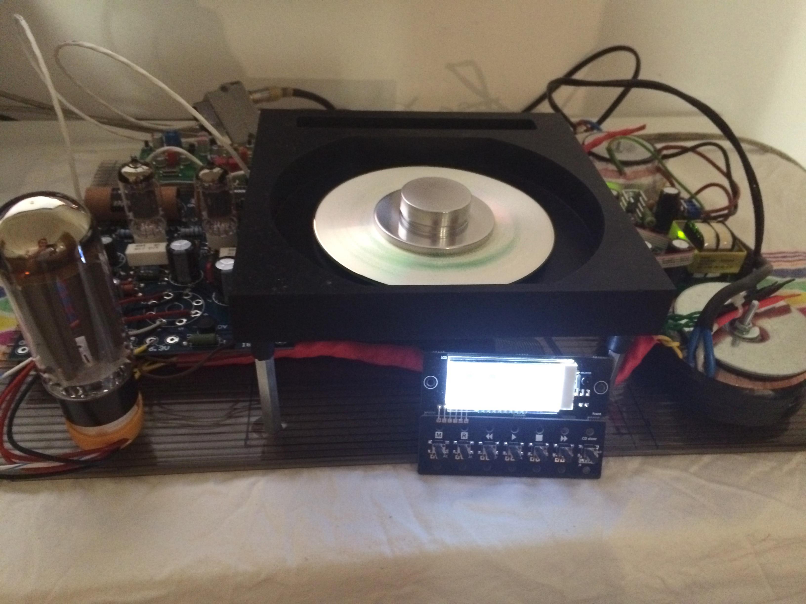

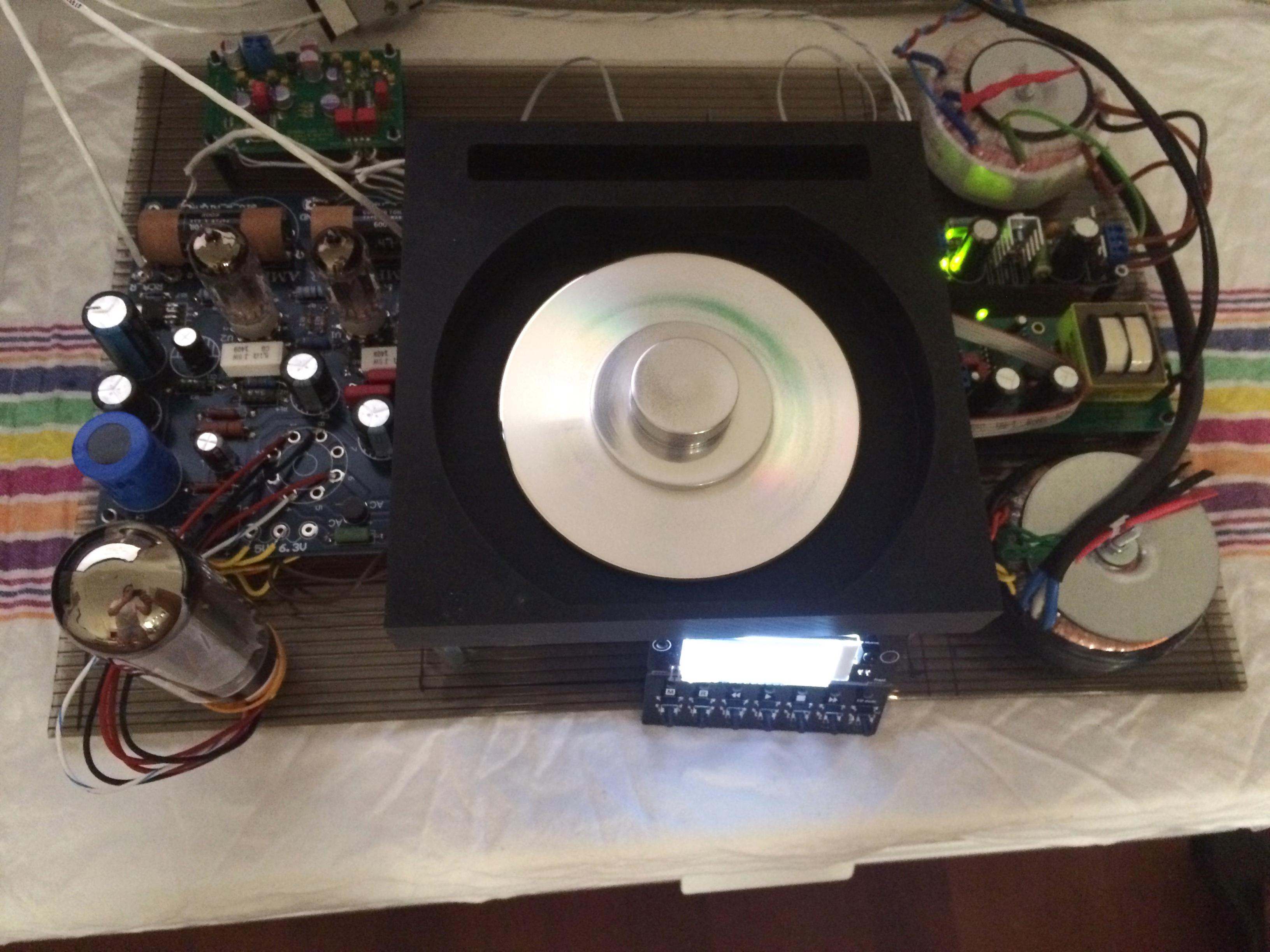

...working progress with my CD player project:
- SHIGA MKII High Grade
- Subbu DAC V3 SE
- Lampizator AMBER DAC with JJ ECC802 and 5U4
Many thanks Tiberiu V., Philippe M. for the kits, support and guidance on this!
I will come back with the enclose chassis.
You are very welcome, Madalin !
Can't wait to see and hear final setup. 🙂
Tibi

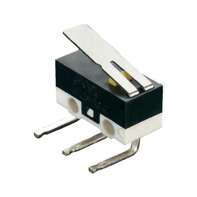

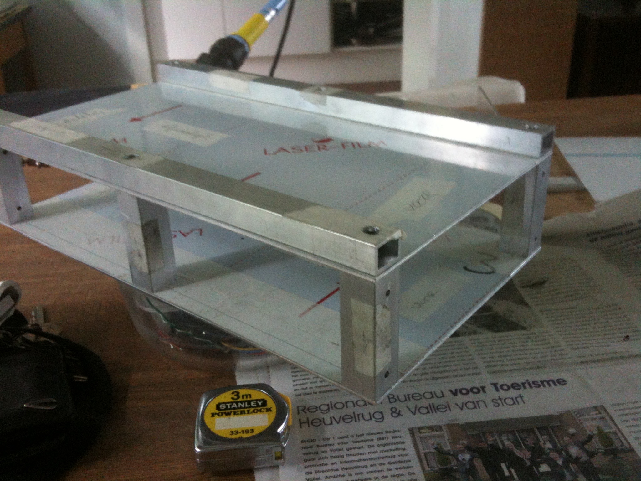

design question..
I am going to build a Shigaclone for another member. I have designed a nice cabinet with a sliding door.
With this sliding door I want to activate/deactivate the "Door button". I want to order de right switch but I am a bit confused by the enormous number of different switches. on/on, on/off, on(on), on(off) etc... And the "problem" that if the door is shut the button stays pressed (this can undone by a different design)
I was thinking of this kind of switch...
I would like to know if this is a good idea and if yes which kind of switch I need...
R.
R.
For Shiga MKII you need to use a normal open switch.
In other words, switch closes the circuit only when is pressed.
Tibi
Tibi
ah thanks and it is not a problem that the stays pressed if the sliding door is closed?
Will not work if is stays pressed.
You can test this on the Cloontje unit.
Tibi

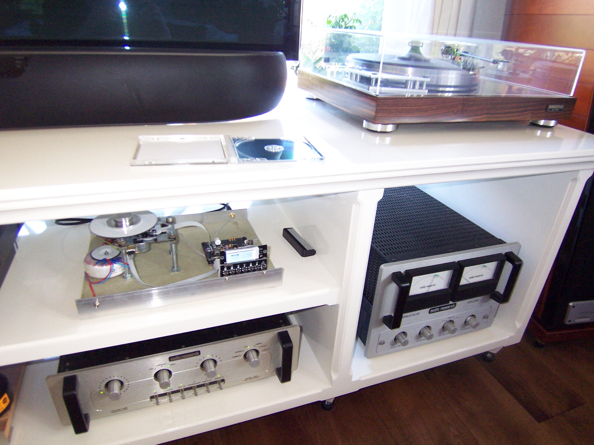

🙂It's for me that XerXes is building the Shigaclone.
Here's the first picture:
Looking to see final result. 🙂
Tibi
You need a single pole double throw switch if you can get one. This can be configured as normally open or closed and will suit whatever door switching method you use. Your switch could be pressed with the door open or closed with this switch and you would wire the switch accordingly.
Tibi
You need to position the switch so that as you slide the door shut, a round Protrusion slides over the switch, momentarily pressing it down, and releasing it as it passes by. It has to be able to do this both ways. I have seen switch's with rollers on the end. That might help.

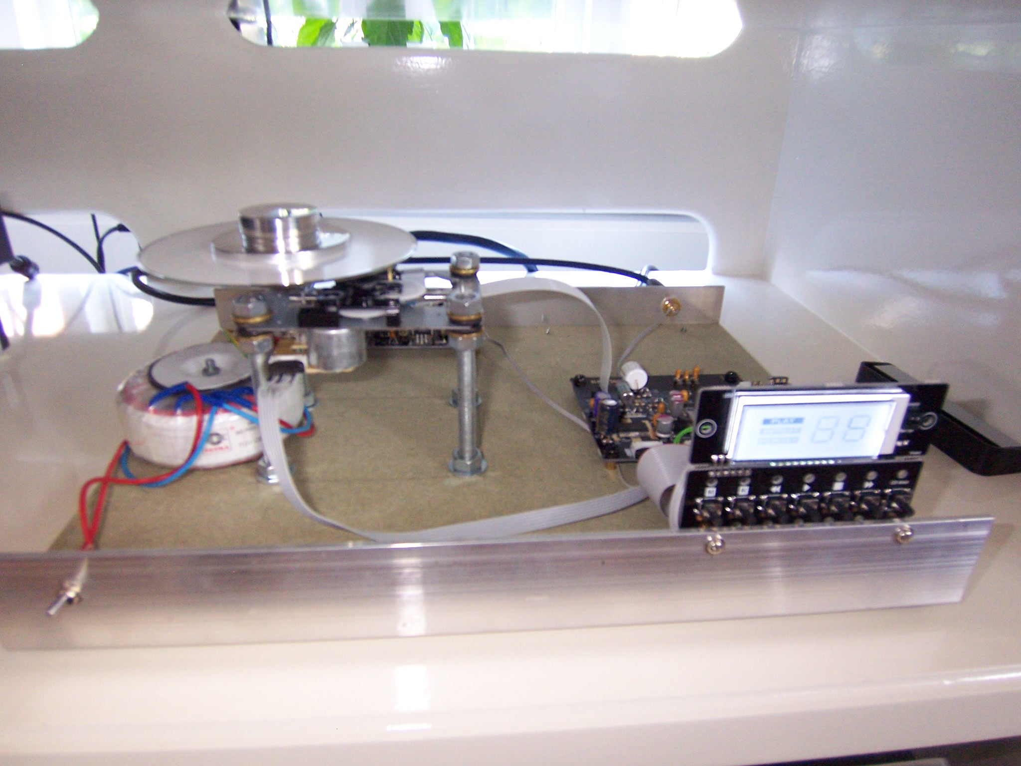

Hi all,
I have got the shiga up and running, on a very specially selected base.😀
The sound is still changing as time passes.
I can say it is very detailed and very good in placing instruments.
Sadly it doesn't beat my teac vrds 10 when it comes to bass reproduction, maybe it needs more time.
regards, John
