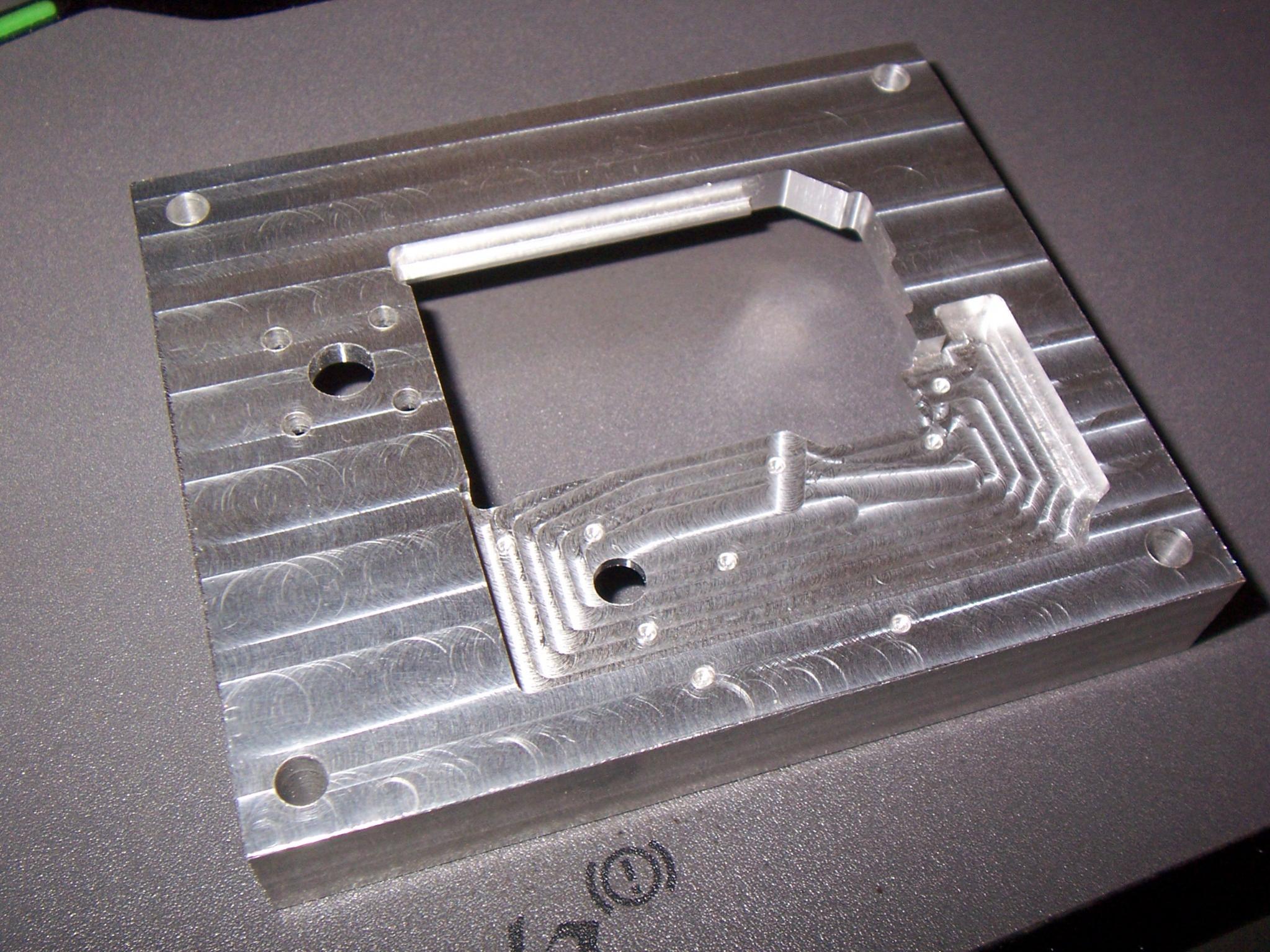

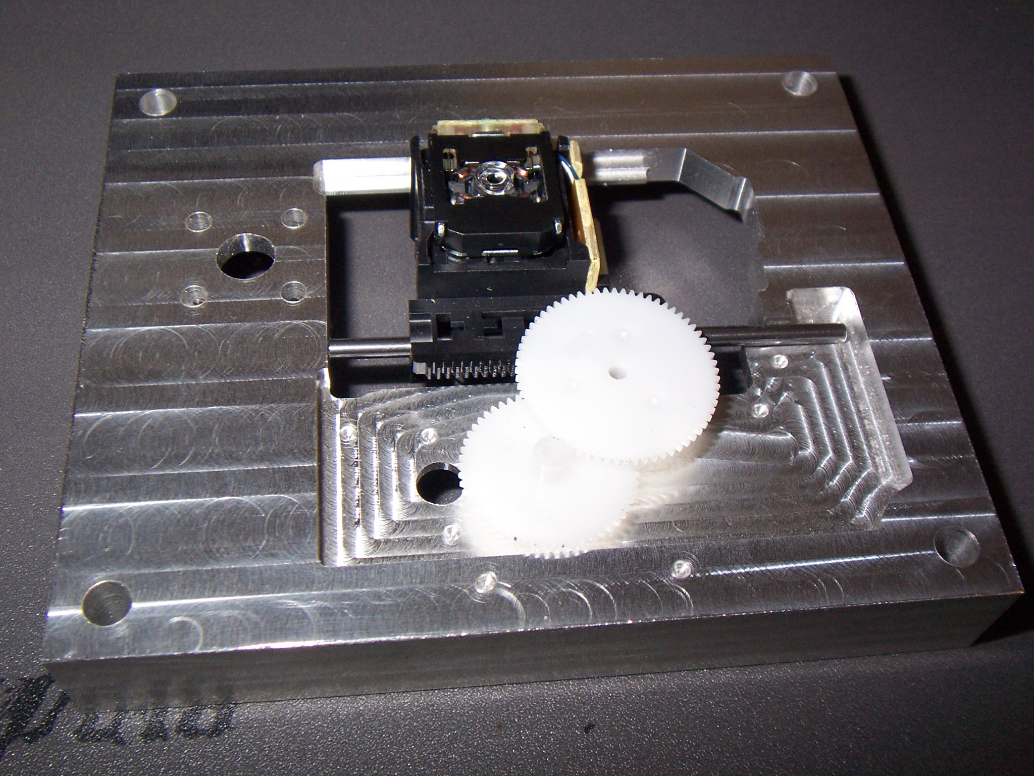

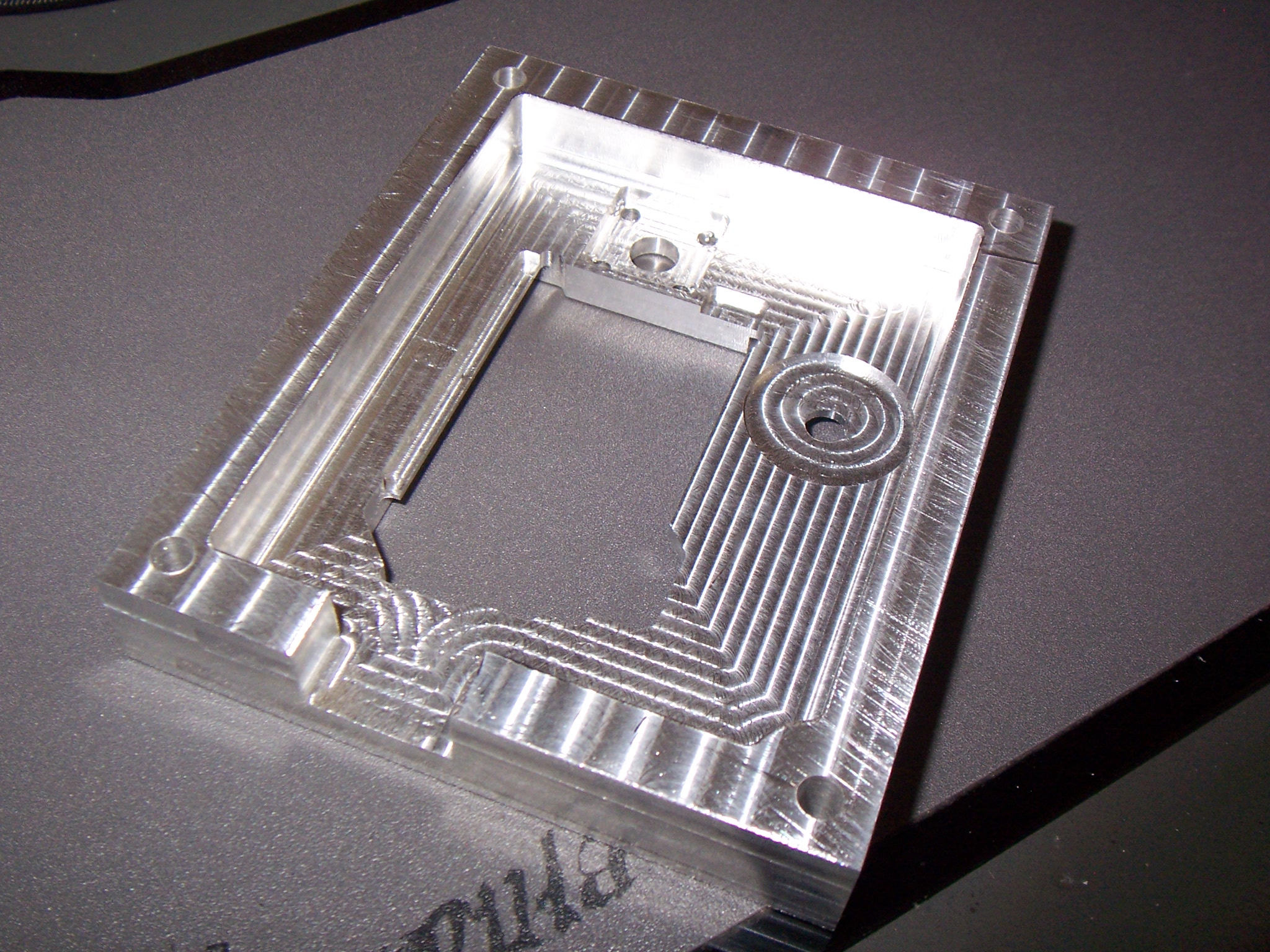

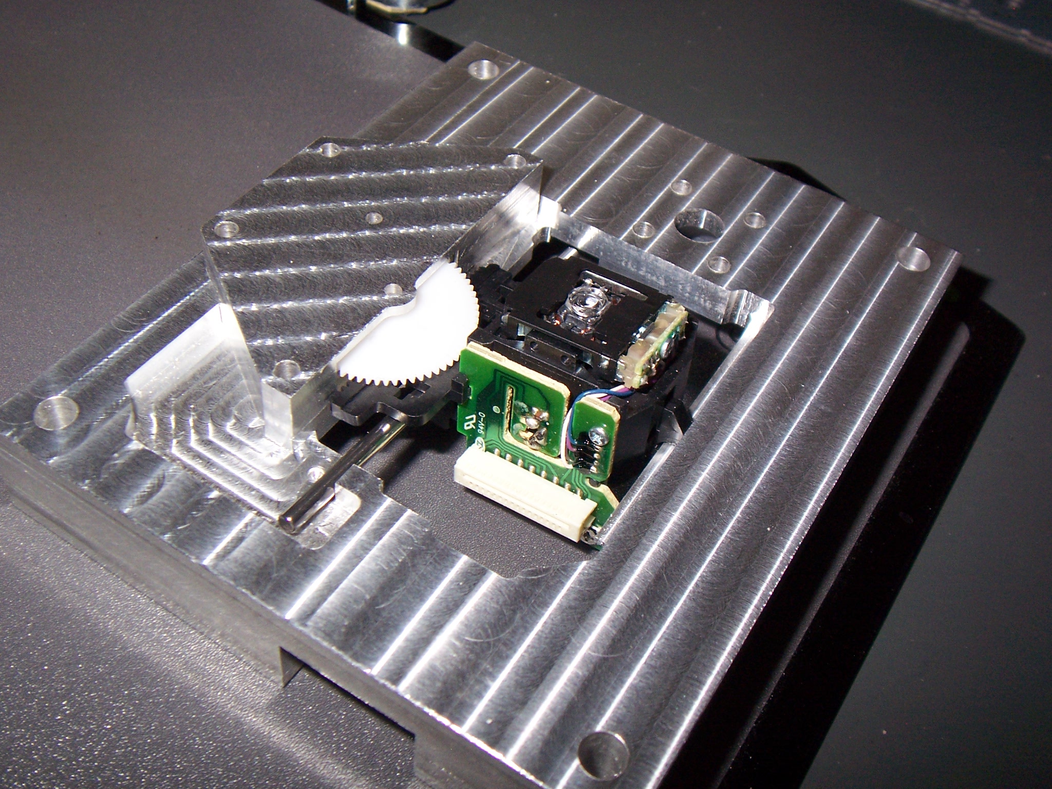

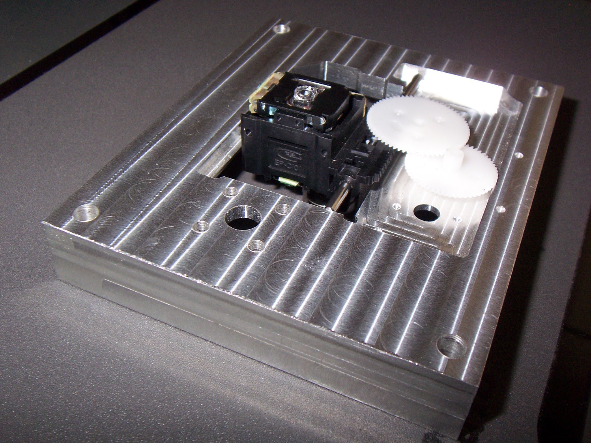

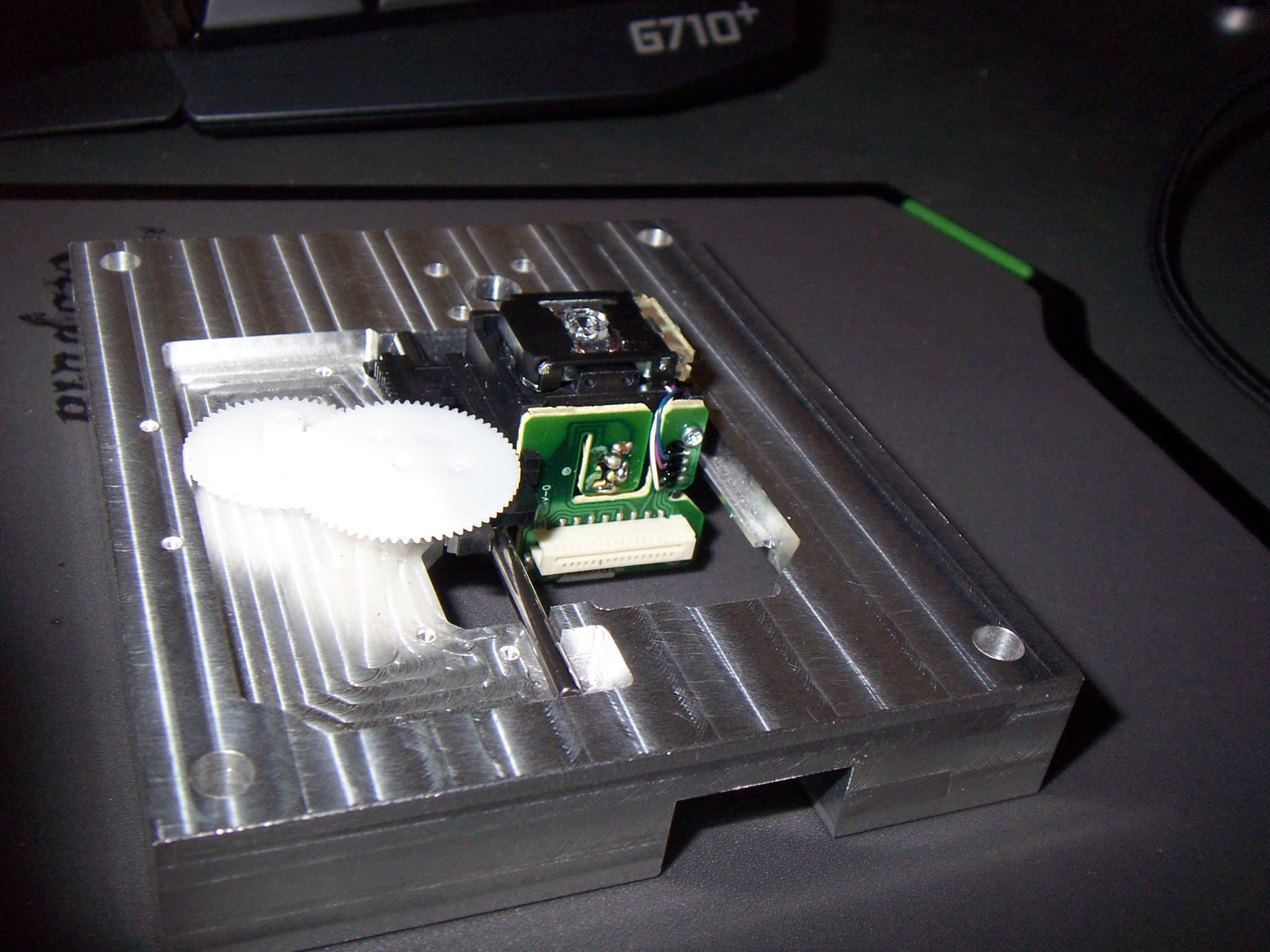

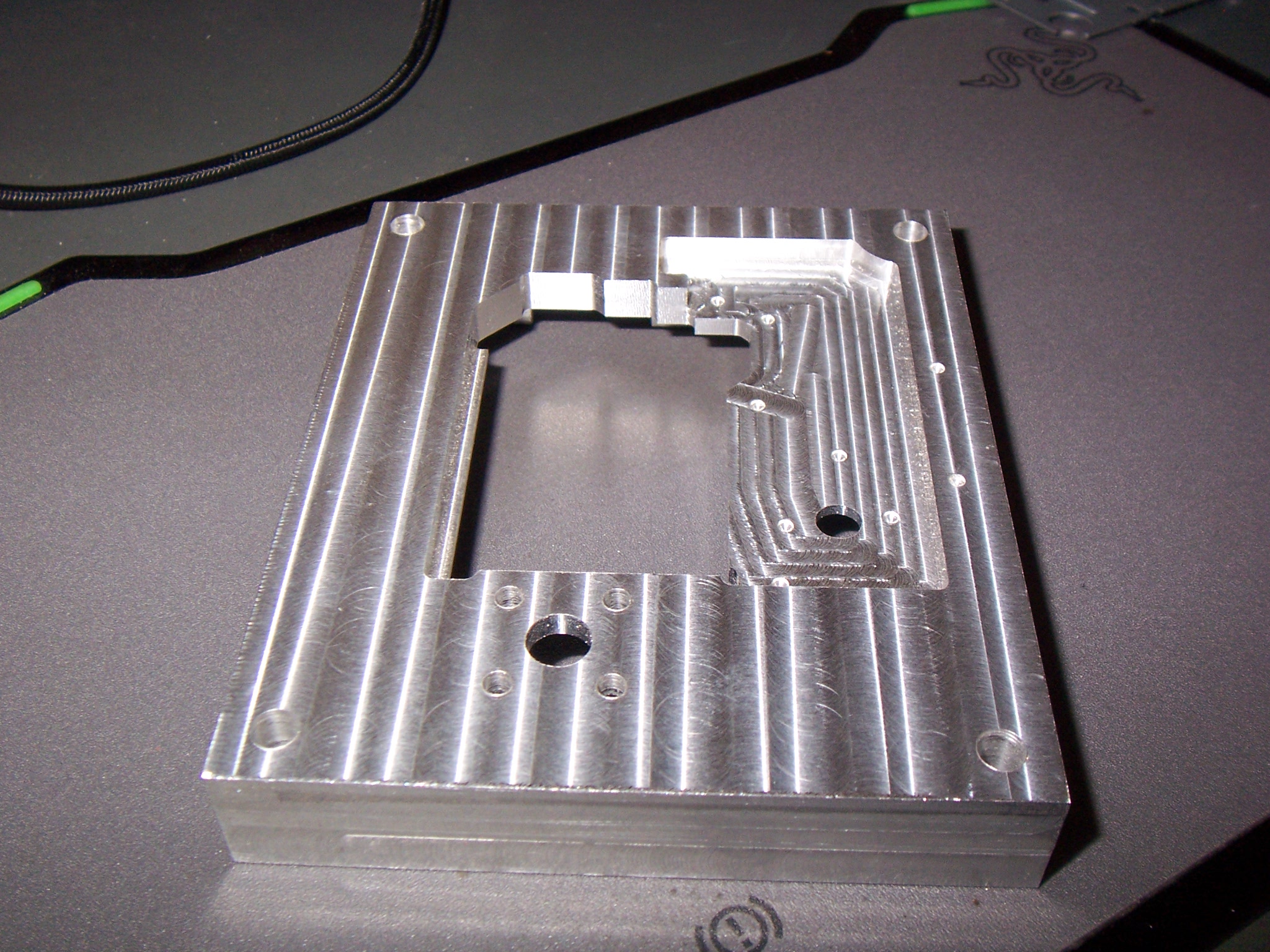

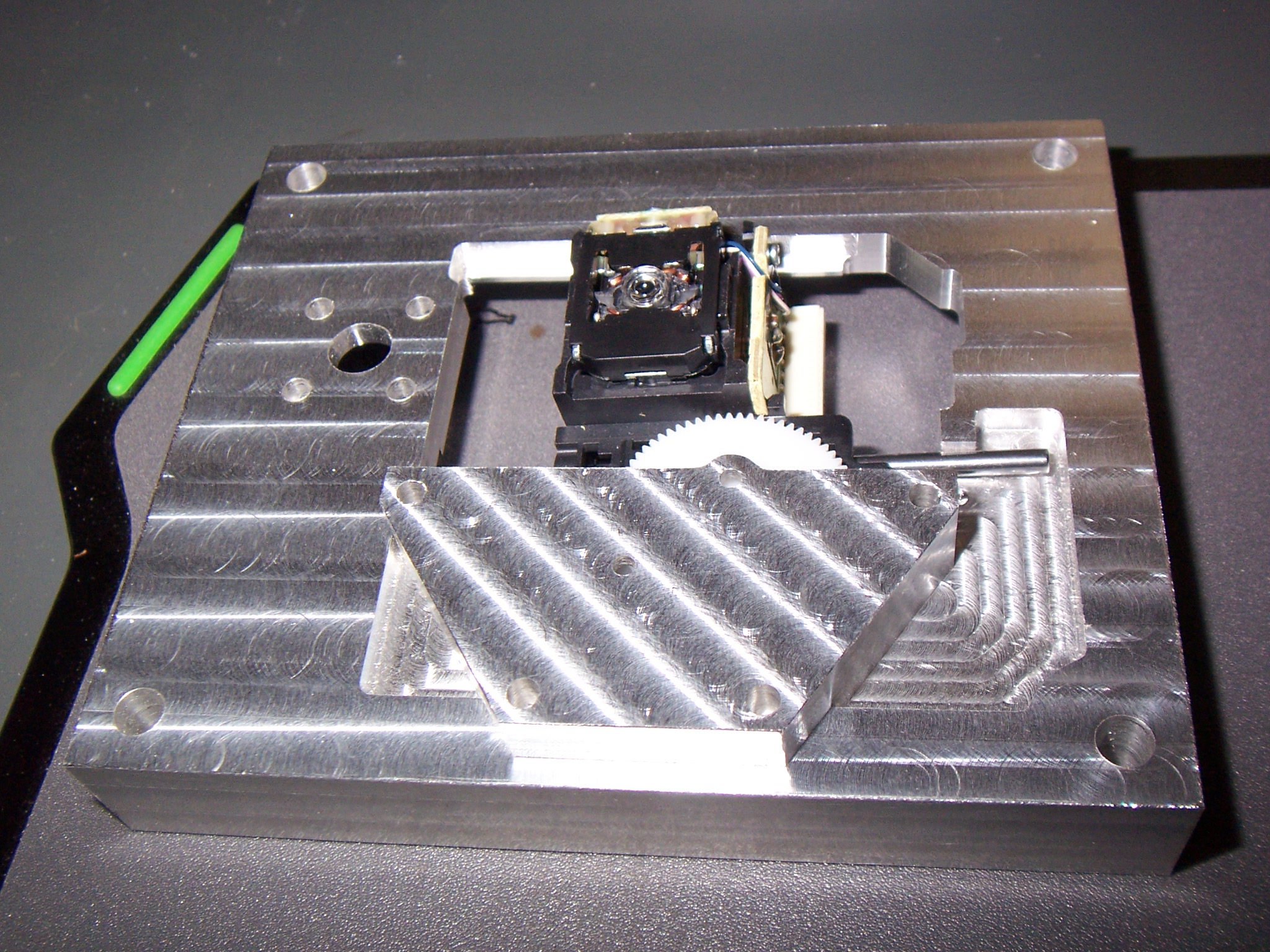

I made a prototype for my new base to mount everything to.
I still need to get some parts and tools to finish the prototype, this is just a first revision to see if it will work.
i also plan to get rid of most of the play of the sled by decresing tolerances.
prototype is made out of aluminium, 19mm thick, but i plan on making the final part out of bronze? or brass?.
the spindel will be belt driven, with a more substantial spindel, 4mm or even 6mm, and will be made out of titanium to lower the mass.
i already scored some high precision (p5 class) stainless steel bearings.
let me know what you think and if there is an area that i can improve.
This is a work in progress 😀
regards, John

Nice to see Shiga MKII evolving in skillfull hands !🙂
John, I bet your Shiga will leave behind Teac VRDS10 after 300 hours burn-in.
A good chassis and proper dampening of mechanism can make a huge difference.

What do you recommend as "proper dampening of mechanism" ?
Basic suggestions are:
Add soft springs under and above mechanism Super Soft Springs – Stinkyboard
Make sure that mechanic is mounted in a non-resonant enclosure - fill the enclosure with damping_soundcoat

I understood that a rigid mounting of the mechanism was suggested????
Only for testing purpose.

Oh my..! Somewhere in the previous century I studied mechanical engineering, but my life took a different turn so I did not put it to practice. Every time I see some fine engineering I am in awe.
I am very much looking forward to see your progress.
R.
R.
Hi Xerxes,
I am also looking forward to see my progress.😀
Still waiting for some parts before i can try if it brings something.
Some say to mount flexible, others say mount it as rigit as you can.
mounting flexible is easy, buy springs or rubber, mount, done.
mounting very ridgit, that is not easy done, the existing base is not solid enough to do so, easy to put torsion in the base plate.
This is all theory ofcourse, so i cobbled something up and pushed the startbutton on my cnc mill.
It looks nice for shure, non magnetic, but does it work??
