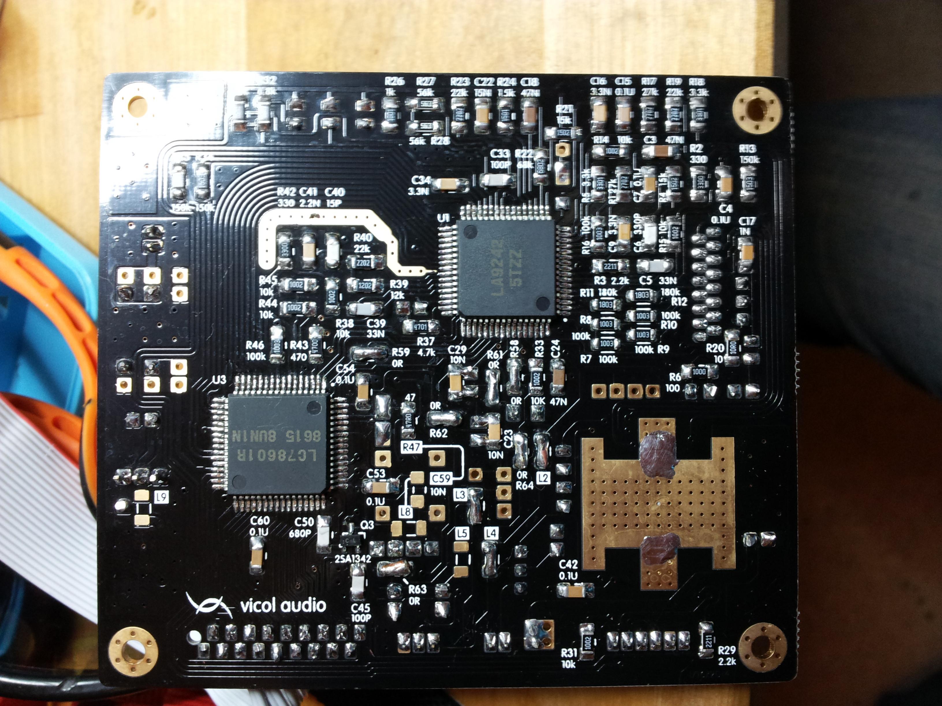

Some high resolution pictures may help me to figure out what you have done.
Tibi
Tibi,
I don't have a good camera for high res photo's. I have sent you a PM. Thank you.
Tony G
Tibi,
Tony G
Hi Tony,
You have pm.
Tibi

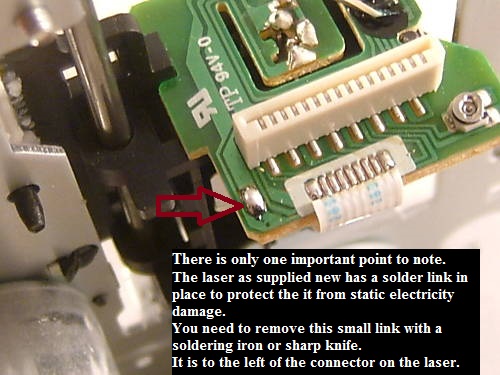

Hi Tibi,
Need abit of help here. I hook up everything except:
1) digital out cable
2) remote control battery
Issue:
1) the LED on the Psu board is not working but measure 8v.
2) no reading from the mechanism. The screen shows 00. I pressed the Door button the disc start spinning and shows ' -- ' then back to '00' again. I was using proper bought cd. When the cd spins, I can hear and see the lens move in mm few times then stop. Anything I missed out?

Laser protection solder blob ?
Tibi

Ya I recalled I read it once but cant find it. Where is the protection thingy? I have to de solder it or cut it? The Psu lead don't really bother me anyway.
thanks Tibi.
thanks Tibi.
Use a soldering iron to remove the static protection blob.
Here http://www.diyaudio.com/forums/digi...kii-black-builders-thread-37.html#post3960386
Tibi

Any grounded soldering iron will work if your power line have ground, otherwise ...
Before removing the blob, take care to discharge yourself. No joke.
Tibi
ahhh...... I'd just removed it and start reading. does that sound good? I have not connect to dac yet. One more thing Tibi, I see the track number while playing. Tell me it is true that is don't show the time while reading? hihi
Tq so much... damn fun. Man I got a transport!!
