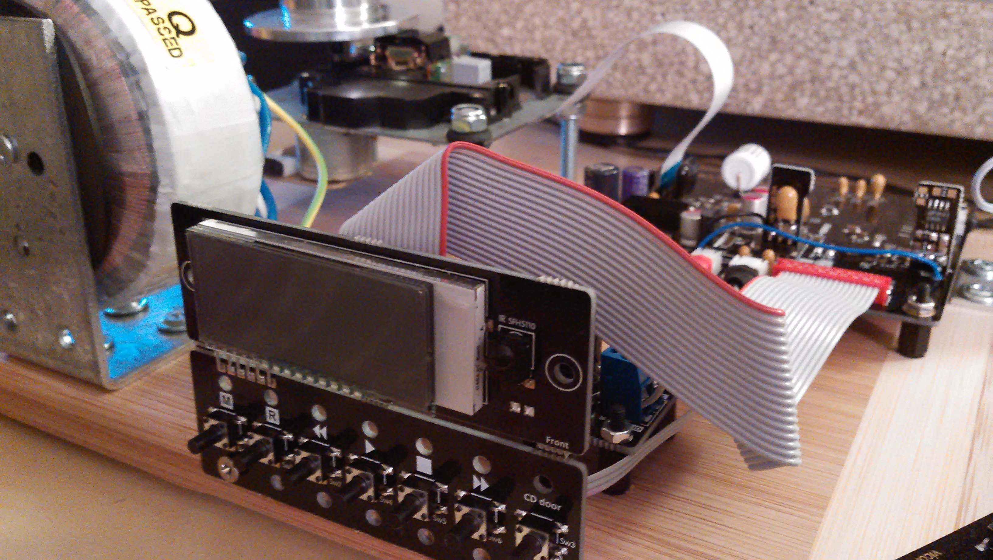

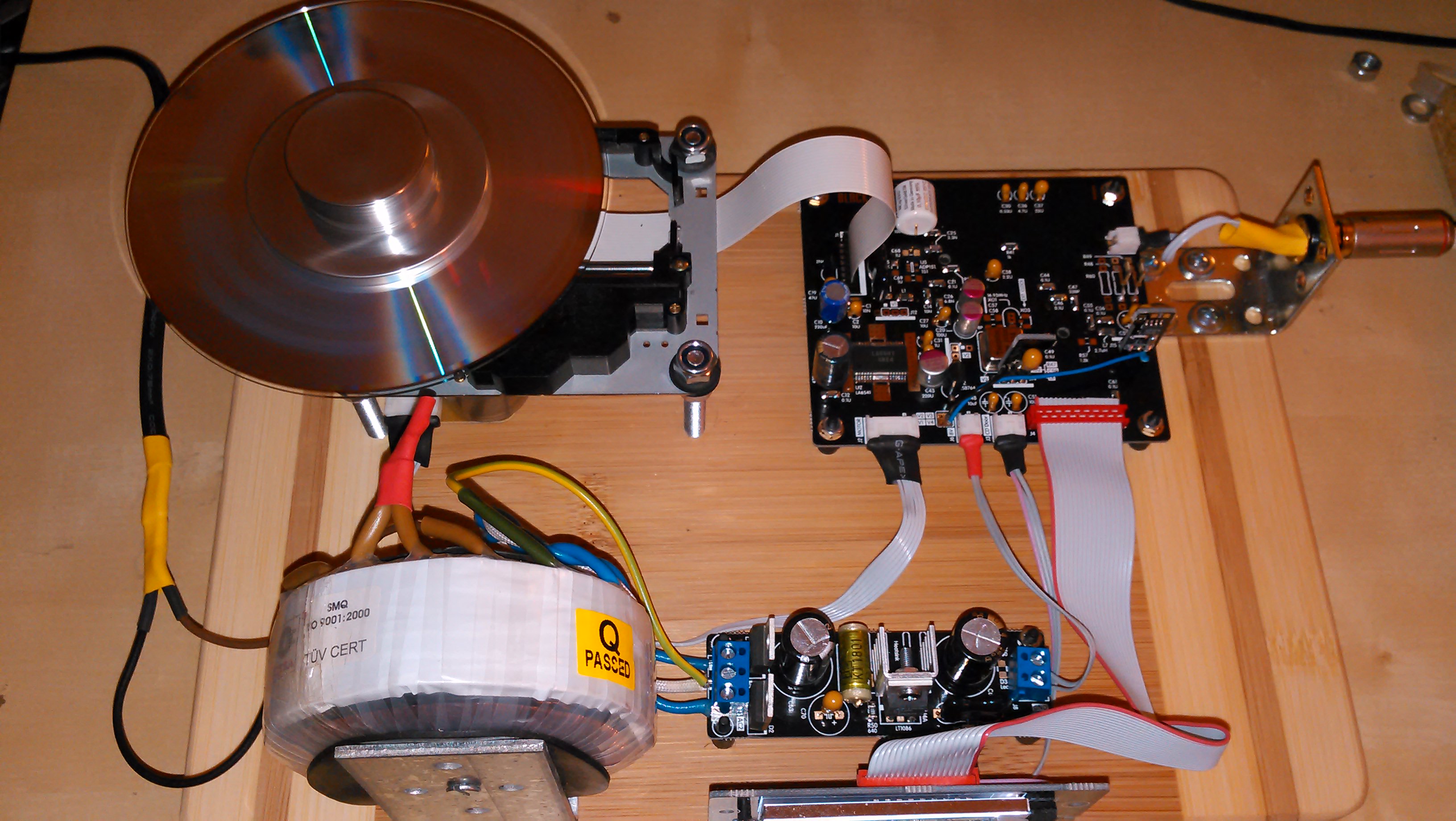

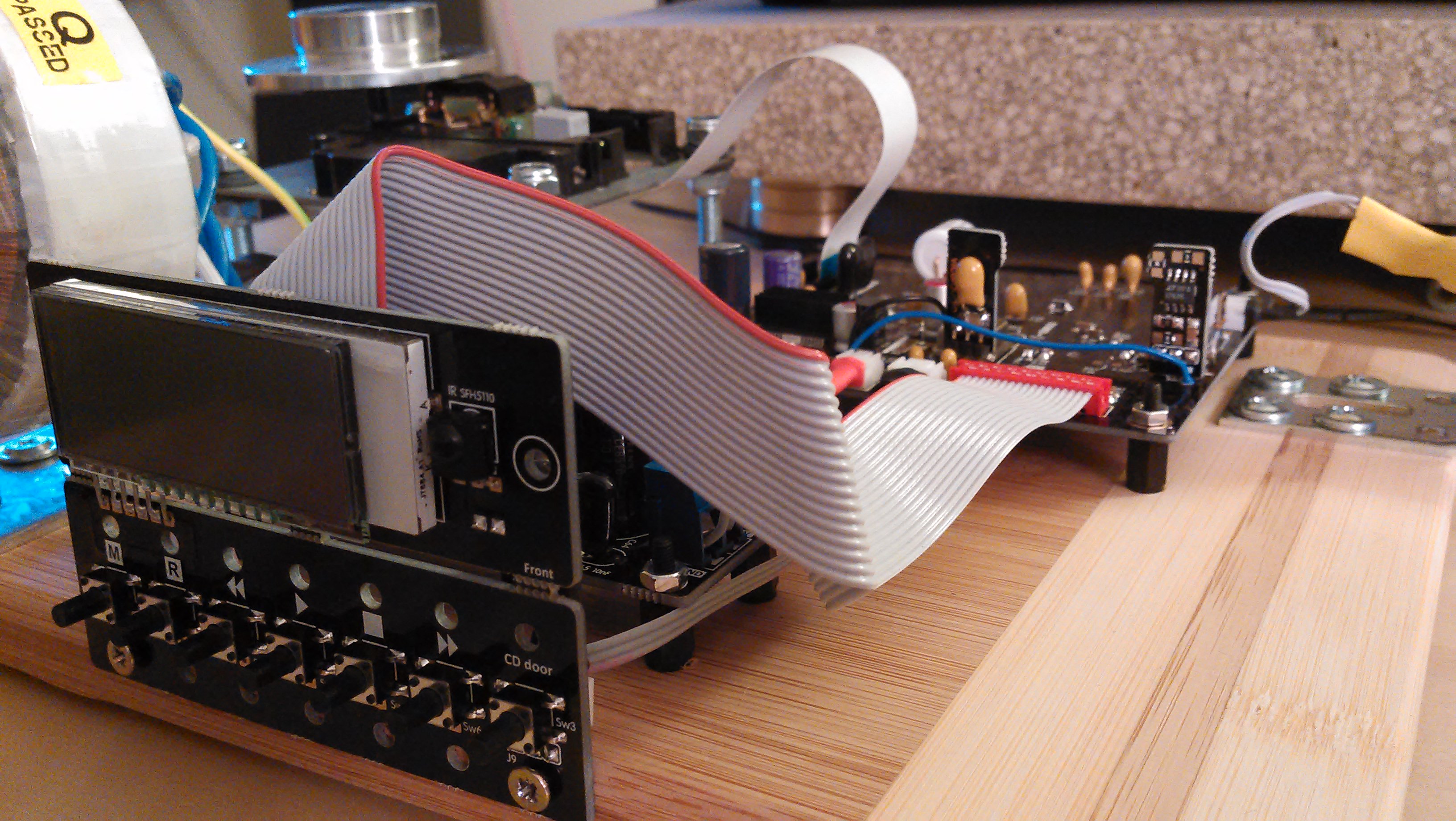

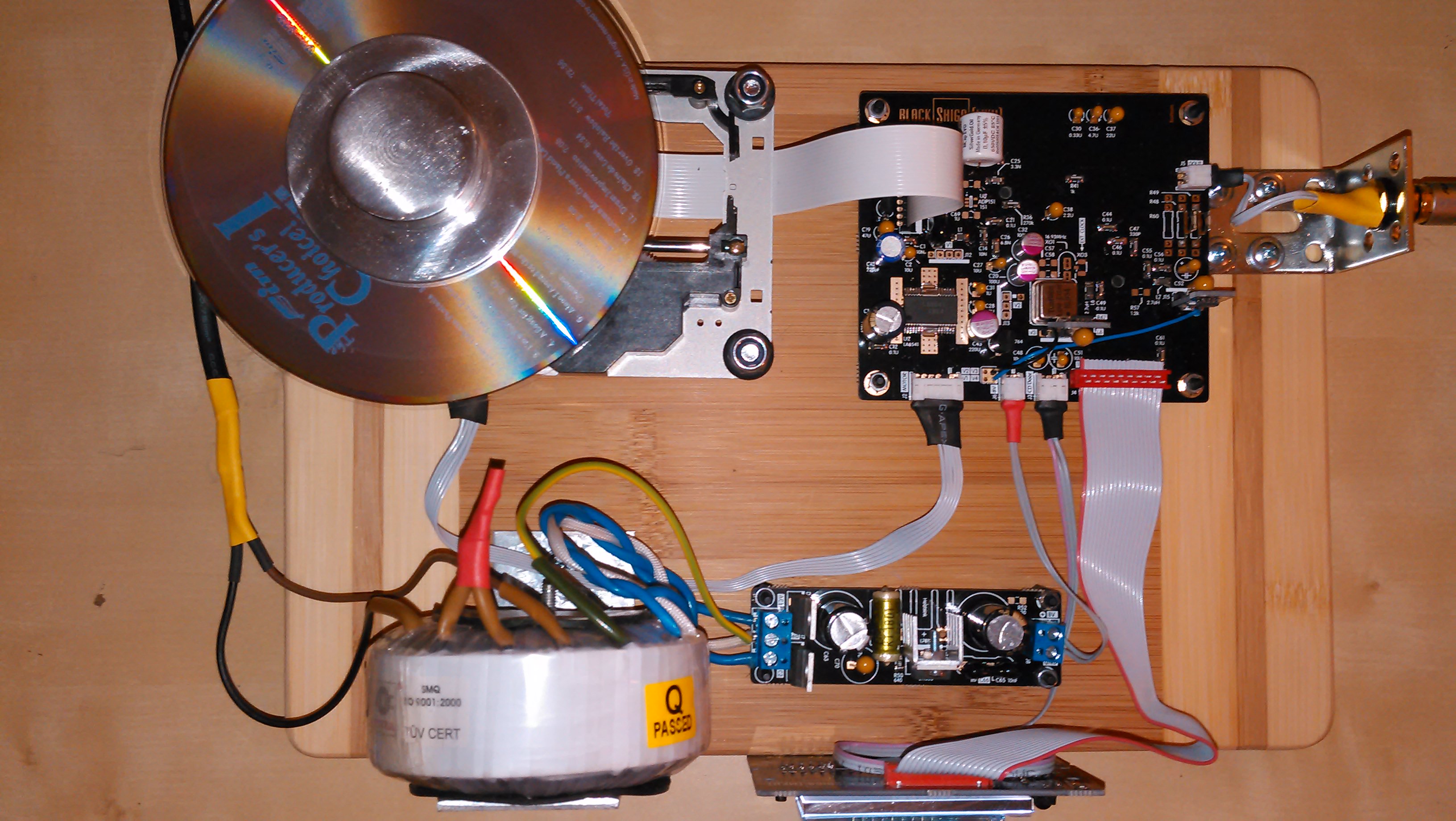

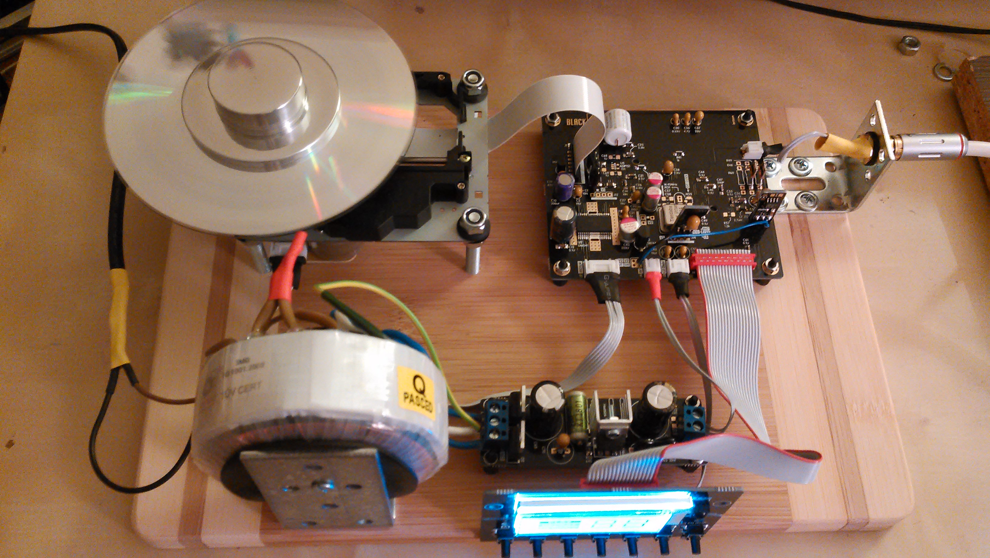

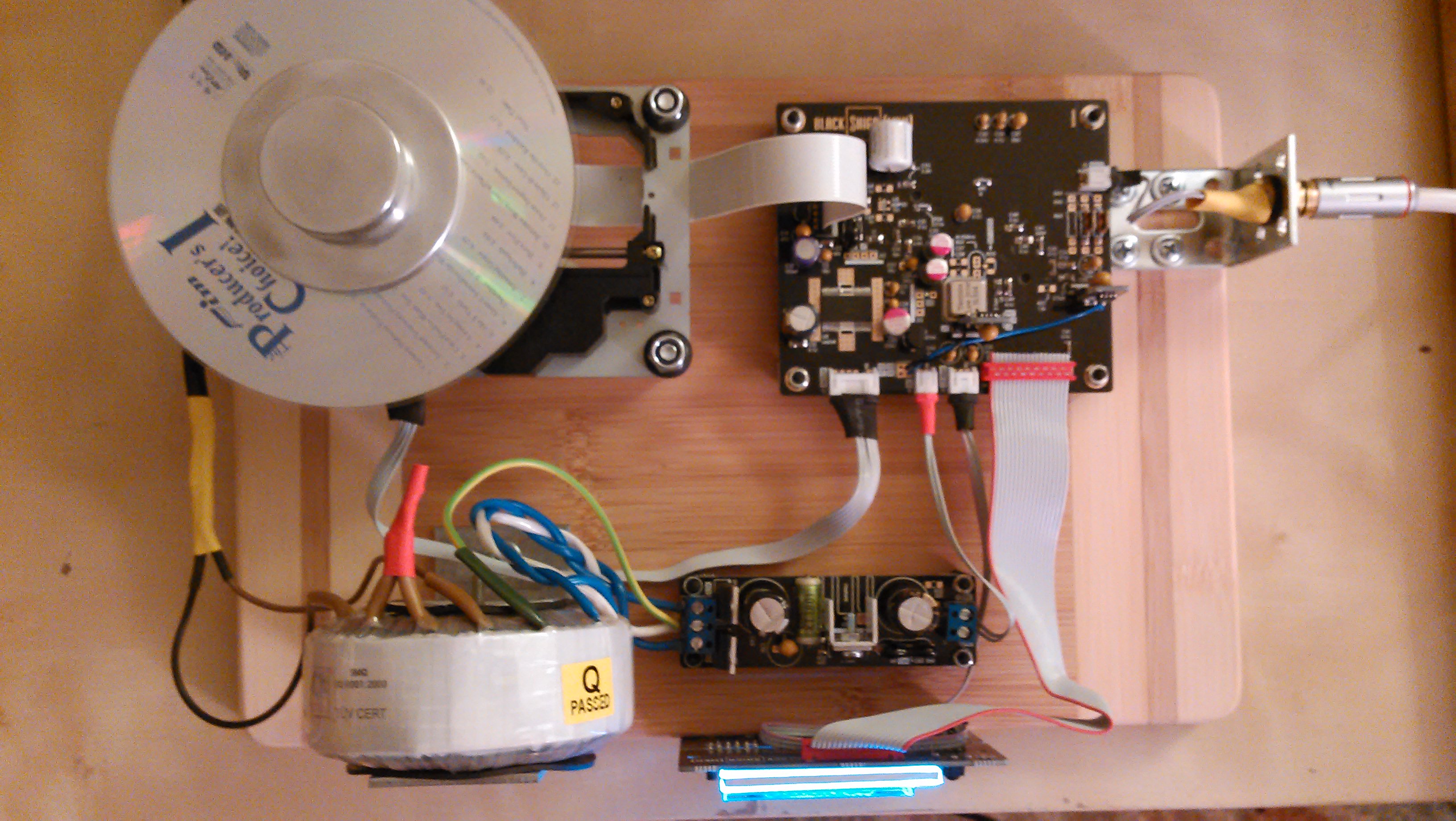

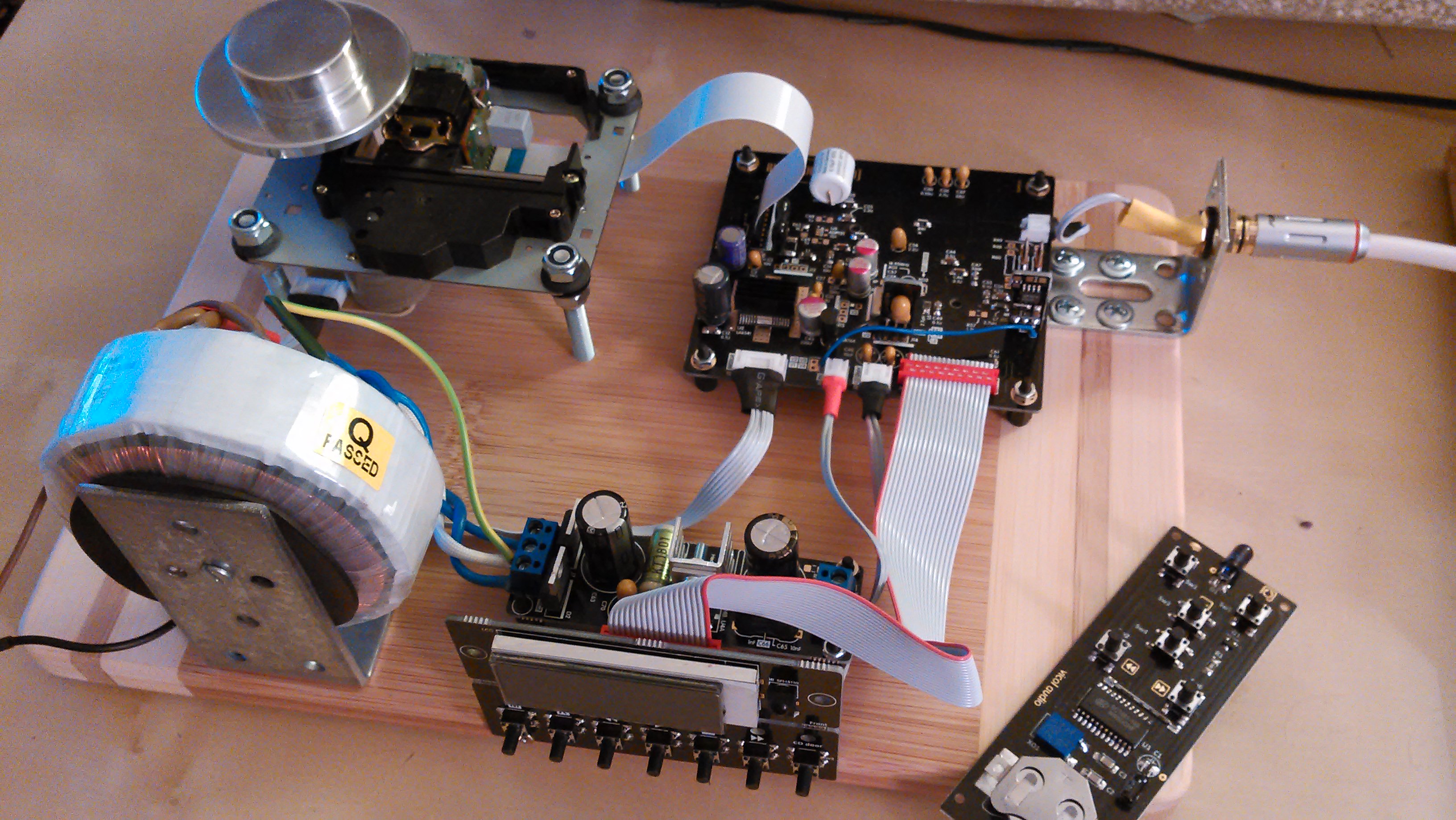

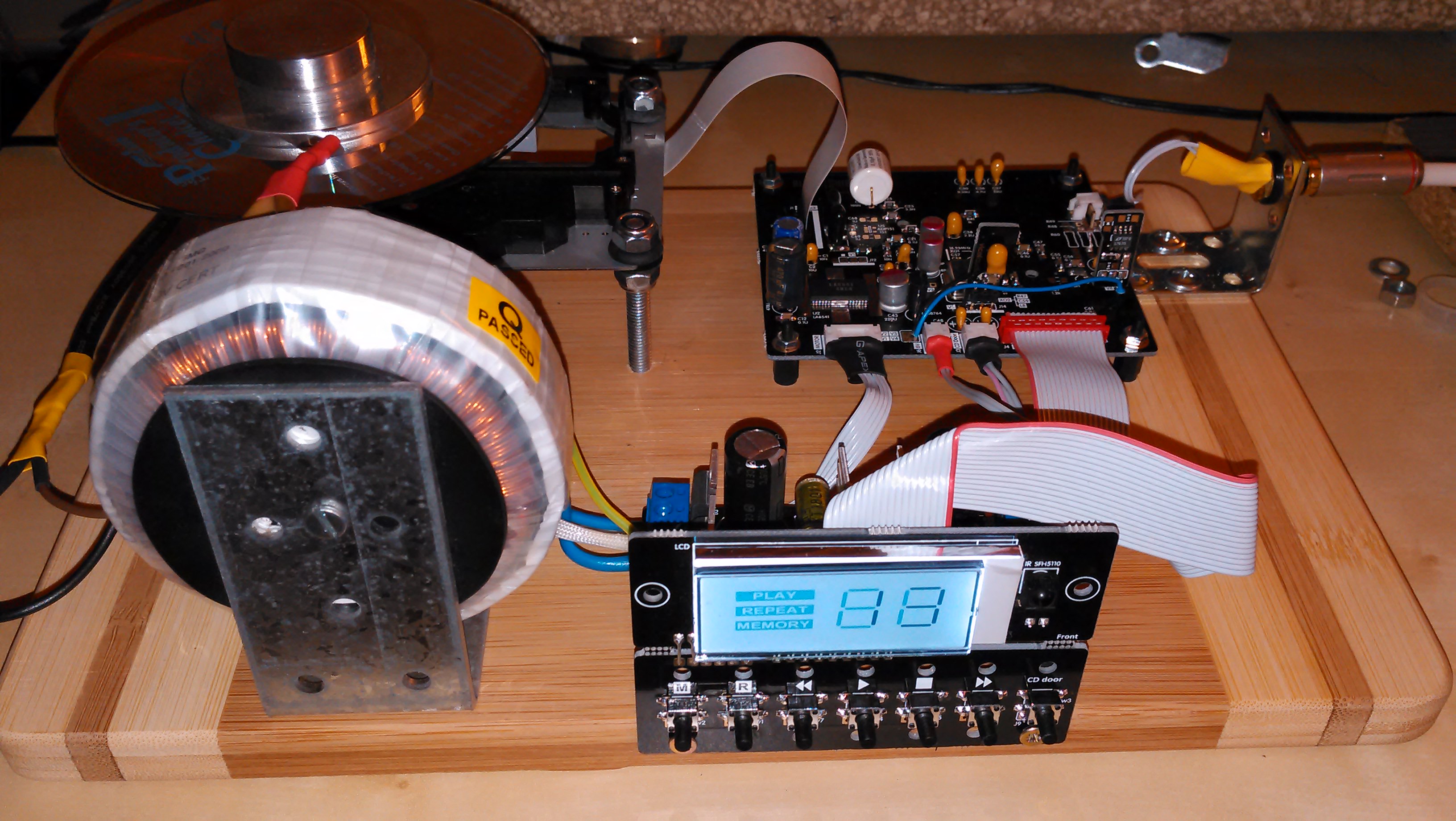

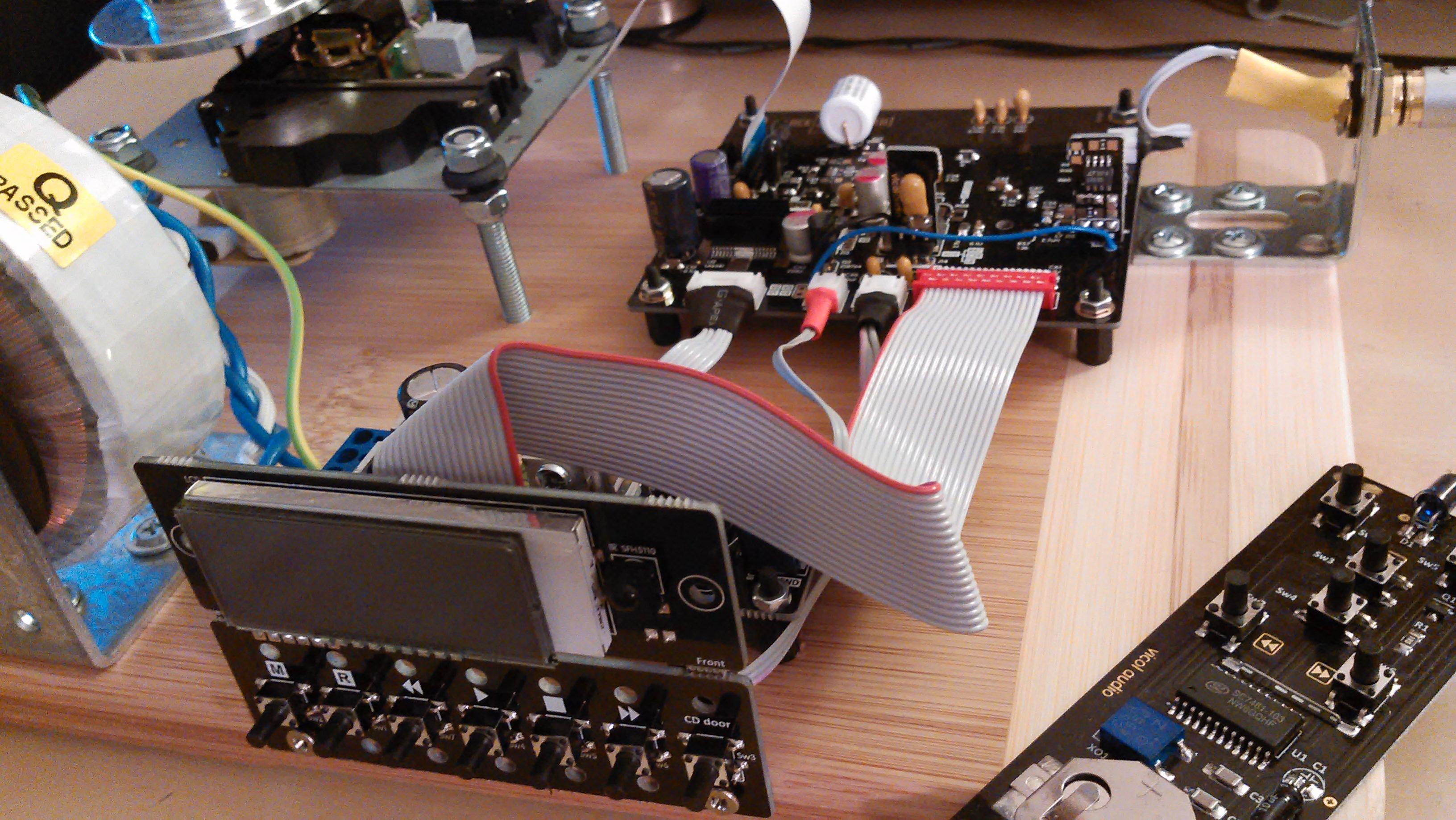

Quick mounting on a bamboo chopper board. 😀
Tibi

Hello Tibi, very nice set up you built there.Quick mounting on a bamboo chopper board. 😀
Tibi
A question, What is this drive you are using here? Made with plastic?
Hi Tvicol.
Finally got to look into where the package is. Tqvm for the mini reg and it looks cute. A few question:
1) how to short the main trans of AC input? Here is 220v - 240v. I see 2 black and 2 brown color.
2) Is it possible to remove the screne?
Tq!
Best regards,
Alfred.
Hi Alfred,
1. Please see here http://www.diyaudio.com/forums/digi...kii-black-builders-thread-82.html#post4070335
2. You may not connect, but may I ask why ?
Tibi
Thanks !
It's an old Sanyo SFP101N-16P bought from ebay.
From time to time you may catch such goodies. 🙂
I wrote about them here http://www.diyaudio.com/forums/digi...kii-black-builders-thread-74.html#post4005319
Tibi
