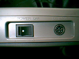

Right side input detail.

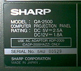

Id tag.
Look earlier in this thread and you will find a picture of a power supply which shows the pinouts and model number ADP-2009, which is the model number of the power supply indicated on the tag.
You may actually have a QA-1700 as well... There's several QAs that end in '00'.
Hope this helps
- Dave

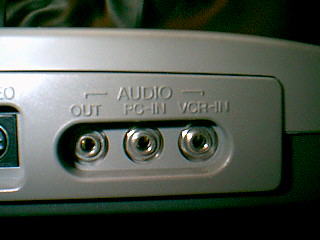

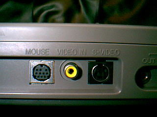

Thank you very much dnarby. That should help a lot. The side inputs are quite a contrast with the pics that I posted and the back sticker helps as well.
I did see the pics in the previous posts that had the manual excerpts and a pic of the label on the power brick. If it's alright with you, I'd like to use these pics to show the seller what the actual panel inputs and such should look like. I'll remove the serial number from the pic of the sticker too (in case that's of any importance).
Edit: I'd venture that this panel is not a 1700. Checking partsolver, It looks like all the panels between 1500-1800 use the adp-2004 adapter. All the ones 1200 and below seem to use adp-0042. It looks like the one I have in my possesion is a QA-xx00 (judging the spacing between the zeros and the QA) and Negative said it didn't look like his 1200 so, it is either a 1100 or 1000.
Edit again: Actually on closer inspection I gues maybe there is only room for QA-x00 not xx00 (I could be wrong), but I don't know of any model that's 3 digits and ands with 00; at least none I can find on parts solver.

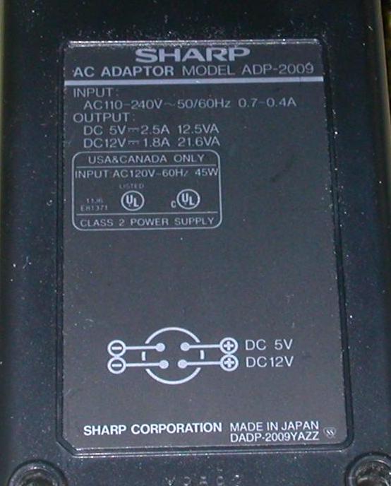

I found this pic of the adapter from earlier in this thread, it seems to show the pin polarities. Is this what you need or did you want some actual multimeter test to verify?
Edit: I noticed that the power adapter shows 2.5A on the 5V rail, while the power supply you mentioned is 2.8A. Could the .3A over the spec potentially cause a problem?

I doubt that 0.3A over will screw things up. In fact, I think that even having an amperage that's WAY over (like 10000x or more) won't cause problems. This is because you can run something that normally takes 12V from AA batteries and run it off a car battery no problem. It'll just run a LOT longer off the car battery. Going way over *voltage* would cook it for sure though... (a bit over, probably not - way over, definately yes). To be sure I have to check w/my electronics sensei though.
The other thing that would for sure cook it is getting the polarities reversed... SO...!
The question I have about that power supply pinout is:
When the plug is FACING you, is the +5V on the top right and the +12V on the bottom right? I'm 99% sure this is the case, but I don't want to take a $300.00 chance on 1%...

Homeade PS for 2500
Hey guys,
Don't know if anyone needs a power supply, but I just made one from an old PC supply. It put out 5V and 12V, so I wired up a homeade plug, jumpered it in, and presto! I got the start up screen, and an image from the S-video input.
Kind of a scary way to find out that the plug diagram on the power supply and the pinout diagram from the manual is indeed set up to show you the voltages as you are looking at the business end of the plug. So the voltages are, left to right, top to bottom,
.(ground)................+5V
......(ground)....+12V
fun fun fun. Now I need a VGA cable, unless someone wants to buy this one off me, it's eventually going on Ebay (I need the money more than I need a big screen right now).
Dave
