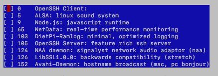

Hmm, I get soft clicks/pops with DSD 256 using NAA, I think I narrowed it down to a connection issue as with direct connection between NAA, and upsampling server I only get soft clicks/pops while a connection through the modem/switch has dropouts galore, can easily see it on CPU usage of HQplayer as it doesn't go higher than 4%,
I'm Gonna try switching the modem/router tomorrow but as there's still soft pops even on direct connection I'm starting to wonder if it's maybe either the Ethernet NIC in the upsampling server, or the usbridge Sig that is the issue, I do have the older usbridge that I will check tomorrow if the same issue happens with it also.
If the clicks/pops is actually due to usb Sig do I just contact Allo for support?
I was getting pops at 256 running dietpi, then loaded the newest version of dietpi that allo put up last week and it fixed my problem. But don't update it, run as is.
I also removed programs I wasn't using, and set arm frequency to 800 Mhz
Hmm I do have the latest update then, will check today if it happens with new switch, but I have ruled out insufficient CPU usage of upsampling server HQplayer as the reason, as it still softly clicks, and pops with settings that where perfect with old usbridge.
Ok, so i fixed the network switch + got myself a new pcie network card incase it was the mobo ethernet, this fixed the packet drop, but i still get soft click pops from the usb sig, i did the above recommendations as mentioned in the previous post, but i still seem to get these pops, clicks.

OK, here's exactly what I remember doing:
cd /DietPi
sudo nano config.txt
Add these lines to config.txt
force_turbo=1
arm_freq=800
exit and save.
I also did this, but not sure if it makes a difference
wget https://github.com/dynobot/Linux-Audio-Adjustments/raw/master/basic-install.sh
chmod 755 basic-install.sh
sudo ./basic-install.sh
Then reboot
Then remove whatever programs not in use.
Screenshot shows what I did not remove
Reboot
Pretty sure that was it. I don't hear clicks anymore, but had before doing this.
BTW, even when I had clicks, pi was not running anywhere near max, at most a core would hit 20%. So that doesn't seem to matter.

Thanks will try it out.
OK i think spoke to soon, i got some small pops clicks again but your settings greatly reduced them from many times each song to around 3-4 clicks per two songs.
Glad it helped and good to confirm I wasn't crazy lol.
No idea why you need to do this either, based on processor load, but real time systems are complicated so there must be more than just load at play here.
You might try raising the arm frequency higher, maybe 1000 or 1200, see it it can kill those last remaining pops.
I only hear pops now when I changes songs before the last one is over. So its when things are in transition anyway and it doesn't bother me.
