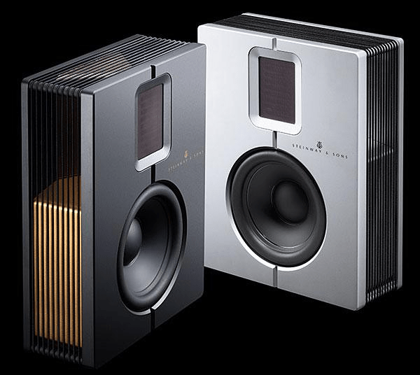

Steinway Lyngdorf
https://www.soundandvision.com/content/steinway-lyngdorf-s-15-speaker-system
"it’s 10 inches tall, 8 inches wide, and only 3 inches thick"

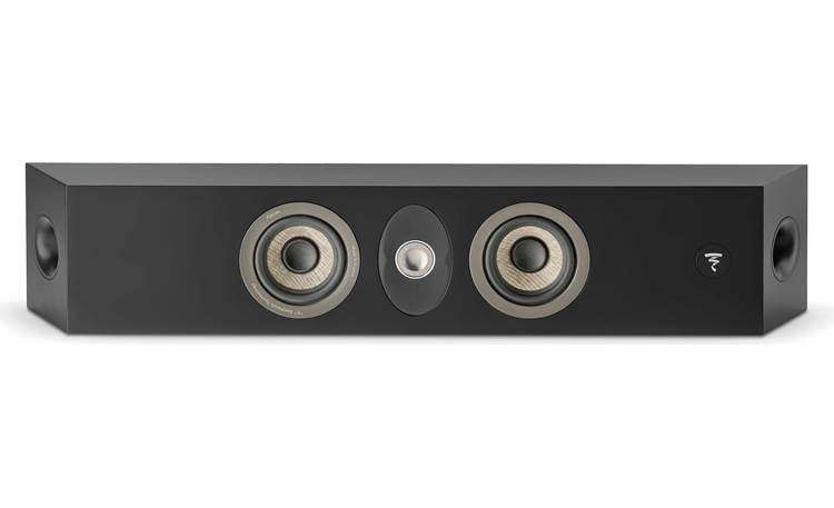

Focal
https://www.crutchfield.com/S-RcCdwSf2B6O/p_091OW301BK/Focal-On-Wall-301-Black-Satin.html
"6-1/8"W x 31-1/2"H x 4"D"

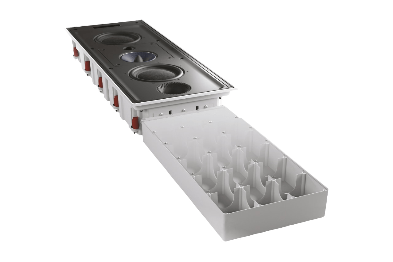

B&W
https://www.bowers-wilkins-custom-id.com/info/ci700-series-in-wall/
29 inches x 11 inches x 4 inches
