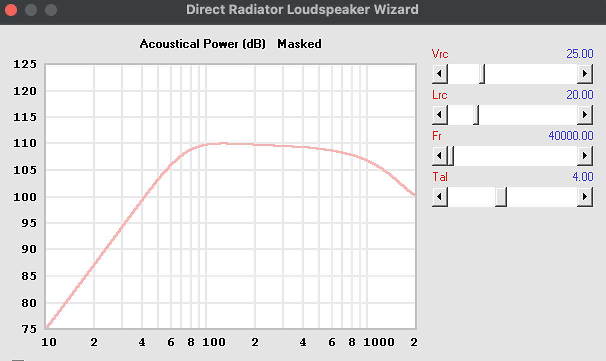

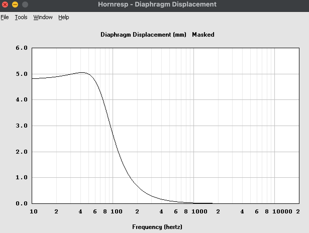

Plugged in the SB20 into HornResp. I have nothing against WinISD, it was great, but it is getting a bit outdated. The same physics apply, of course, but the tools and simulation packages have improved since then.
HornResp is very well supported and upgraded all the time. Very worth having a look at it.
Here is a sealed 25-liter SB20 running at 13W, reaching displacement of about 5mm at about 50Hz, and 110dB. F3 at about 65Hz.
I seriously doubt you will listen to movies at 95dB for an extended period of time, yet alone 110dB!
Plus, since you will have subs starting to fill in at 80Hz, you can cut the SB20 before it reaches Xmax, rendering this issue non-existent.

Wow that is very different than what winisd provides... 🙂Here is a sealed 25-liter SB20 running at 13W, reaching displacement of about 5mm at about 50Hz, and 110dB. F3 at about 65Hz.
I assume those are at 1m right?
Absolutely! The goal is to aim for average 75-80db at listening position (so between 3m and 4m for LCR), with peaks at 95db. This is where the 95db comes from. I have no interest in premature hearing loss.I seriously doubt you will listen to movies at 95dB for an extended period of time, yet alone 110dB!
Yes, this is definitely the plan and was already ignoring going past xmax below 80Hz.Plus, since you will have subs starting to fill in at 80Hz, you can cut the SB20 before it reaches Xmax, rendering this issue non-existent.

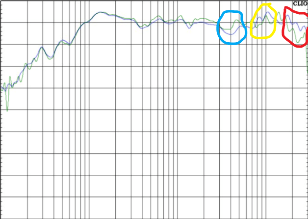

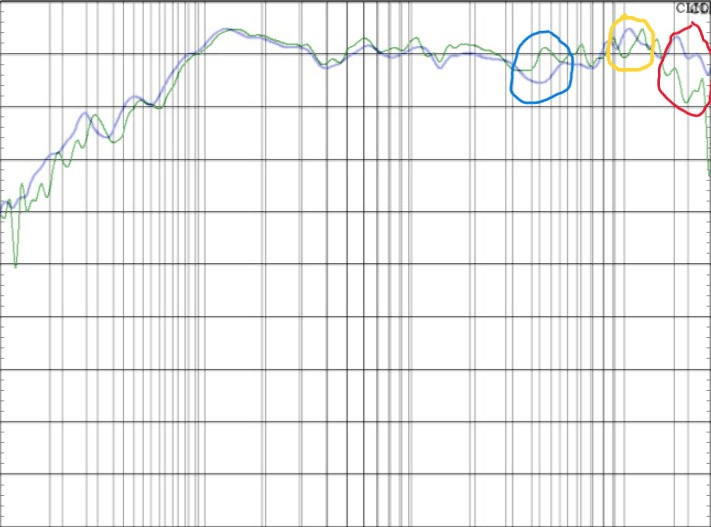

It is interesting to see that CHP-90 users seem to pick up a tonality difference with CHR-90 when their on-axis published FR are so similar (attached overlay of FR, green is CHP-90, blue is CHR-90). What makes the CHP-90 to be preferred by a number of members of the forum? Is it:
- the dip at 3-4K on the CHR-90 (blue "circle")?
- the CHR-90 bump at 10K (yellow)?
- or is it the above 15K drop of the CHP-90 (red circle) ?
- or are there other differences between the two (e.g. off-axis response, resonances, ...)?
Frequency response plots are a false trail. They will tell you the basic Eq settings, but sometimes the importance is inversely proportional to what you see and it's like reading tea leaves.
Take a metallic resonance as an example. The longer it rings and basically the worse it is, the smaller it looks because it takes up almost no pixels in screen width! The height only gives you the average energy level, and says nothing about when it when it occurs, which could be a factor in how prominent the ringing is.
The CHR and CHP look like they have different cone profiles. The CHR cone looks a bit flatter with a longer voice coil tube, while the CHP cone looks a bit deeper. That, and I just wanted a paper cone for a change, and now you know everything.
If you ruffle a piece of thin cardboard in the air, and do the same with metal foil, the 'crinkling' will just sound different in both cases. Very low-tech, but maybe some of those differences can carry over to the end product.
I was going to say that he is obsessing over them far too much.
They are on-axis plots in an anechoic chamber.
You almost always listen to them off-axis.
I agree, I tend to overthink things 🙂. Maybe it is just time for me to build something and give it a listen to at least have a starting point.
Definitely agree with that. There will be no listener on axis with any speaker. I guess I am looking for two things in the data:
- off-axis behavior of those drivers. There is very little data on that, so I am trying to understand what to expect
- I am trying to correlate other peoples comments to data. This is mostly to help guide me in driver selection. I will then build/listen a prototype, and from there I hope I can correlate things I like/dislike in a speaker to a characteristic in data. I hope this makes sense.
