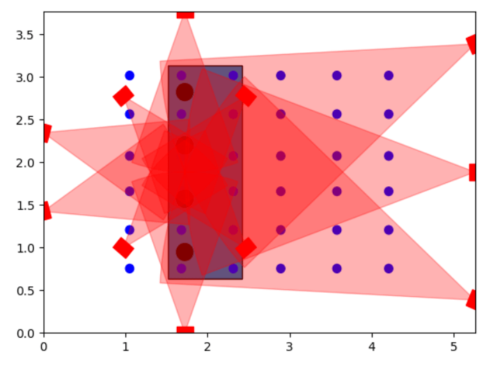

I am planning on building a dedicated Media room in my basement. Mostly it will be 80% watching movies and 20% gaming.your anticipated use case
I fully plan to use room EQ (this is one criteria for AVR selection). Initially, I was thinking of buying the speakers, but in the process of designing the room, I rat-holed into going all-in in the DIY route and now want to build the speakers 🙂 .
For the configuration, I was planning to get to 7.2.4, and if 2 subs is not enough to fight room modes, might add two others (thinking of subs configurations documents in Todd Welti's study). Here is a drawing (x/y axis are in meters, blue rectangle is couch, black dots are human heads 🙂 , red boxes are speakers, the cones are 40 degrees angles) of the 5.2m x 3.7m x 2m room:
Ideally, I would love to have all speakers the same (or at least with close enough tonality), as from my past Infinity/Klipsch mixed configuration, the difference in tonality was big enough to be noticed when sounds were moving from front to back.
I’d certainly agree about retaining as consistent a timbral balance across as many channels as possible, as well as the multiple sub approach - of course there’s only one way to answer the question as to how many are too much for any given room.
I did review the earlier floor plan drawing, and this new one still looks to be a rather smallish room - approx 1/3 less than the area of my own - in which multiple channels of fullrange drivers such as any of the Mark Audio series could easily suffice for many listeners. I wouldn’t however get too exercised over attempting to attain “ideally” flat, smooth FR via PEQ.
The trickiest challenge I think you’d encounter would be the overhead channels; with a room height of only 2meters, unless the ceiling can be opened up to allow for angled boxes / mounting think they’d be well off axis. Dave did produce a series of such enclosure designs some year ago that could probably be revisited for new driver specs.

Definitely agree these are my biggest concern too. There is no way to open up unfortunately (the ceiling is concrete, and there is heated floor above 🙂).The trickiest challenge I think you’d encounter would be the overhead channels; with a room height of only 2meters, unless the ceiling can be opened up to allow for angled boxes / mounting think they’d be well off axis.
I am planning to build boxes with an angled baffle to minimize angles. Should be fine for middle seats, but with the current plan the closest side seats will be about 50-60 degrees off-axis so above 6-7KHz, I think there would be a huge dB loss. I am more and more thinking of doing 2 shorter rows to avoid seats close to the sides.

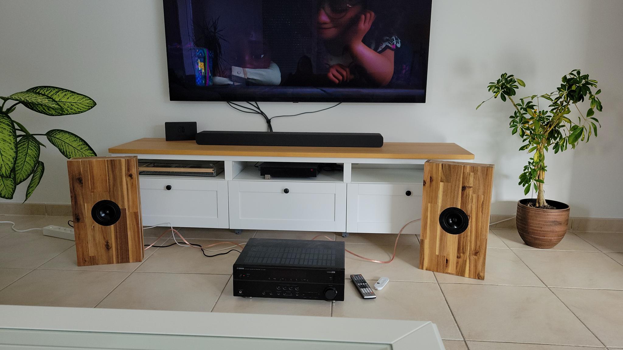

Finally got some time to build something.
The cabinets are made of 18mm acacia boards (had some leftovers from a shelving project), with one long vertical brace, and filled with 45mm denim insulation. I did not chamfer/round off the baffle yet.
I allowed ~50 hours of break-in time in a separate room (without listening to avoid bias). For the amp, I borrowed an older AVR for testing (but have no mic for calibration :/).
I listened to some jazz music (cowboy bebop ost for those who know). It sounded better than I thought it would: could really pick up separate instruments much better than with my soundbar. The spatial cues are also quite good.
Next I played some scenes from a couple of movies (Encanto and Dunkirk). Of course there is no bass (to be expected), but spatial cues are really nice. Voices are also very clear. Biggest downside is highs during movies can be ear piercing at times, so much that I had to lower the volume.
At any rate, thanks for the recommendations guys, it really helped me take that first step!

Great to see them completed. How long do you think you’ll be living with this new rig before you develop 2 foot-itis, and do you have an upgrade path in mind?
Did you put a BSC circuit?Biggest downside is highs during movies can be ear piercing at times, so much that I had to lower the volume.
Haha I have absolutely no desire to go for big speakers (at least not yet 😀).
I actually like the idea of small speakers that blend with the decor, and use subs for the low end.
Speaker-wise, next step is to build the sub. I don't know if I will build the room first though, since the more speakers I build, the more space I will need to put them to use 🙂
No BSC circuit since I will EQ them using an AVR.
