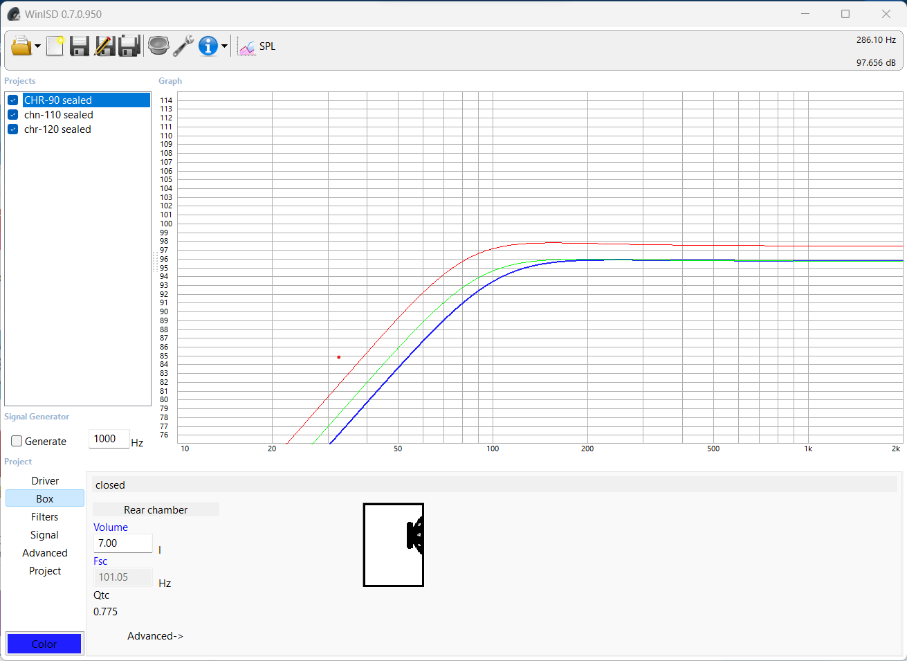

Now what brings me here. I would like to setup a home theater in the coming year, and would love to have shallow speakers, that can play nicely above 80Hz (I will use subwoofers below that).
My requirements for the speakers:
1. shallow speakers, ideally 10cm or less. I don't care about height/width though.
2. wide enough dispersion for all listeners to comfortably enjoy the movies.
3. SPL wise, I am targeting around 80-75 dB average for each speaker at each seat, and some headroom of ~15 dB SPL.
4. All speakers will be eq-ed (if that is a word) using dirac/audyssey. So I am not necessarily looking for a specific frequency response profile out of the box, just enough distortion-free output and eq-ability.
5. Easy enough to build for a first set of speakers. I am a decent woodworker, but have no experience with speaker building (e.g. no knowledge of crossovers).
6. I am looking at building 11 speakers and 4 subwoofers. So cost wise, would be nice to keep it under 150 per speaker.
7. All speakers will be on-wall.
I looked at commercially available options, and it seems they are all out of reach pricewise (e.g. Grimani systems Rixos-S and Ascendo 6).
Looking around the forum, it seems there are quite a few positive review of Markaudio drivers, and they seem to fit the bill, however I did not find reference builds there with a "shallow enough" design. I hence tried the following design under winISD:
None of the above is fixed (driver choice, dimension, ...) and I am open to suggestions.
Here are extra info on the room, speaker/listeners placement, and some computations I made, if that helps :
- the Room is 5.3m x 3.7m (black spots are seats, blue box is couch, red boxes are speakers, red cones cover 40 degrees angles -- ignore the surround glitch, will fix my script)
- Here is a table of speaker/listeners distances (in meters), and the associated attenuation if that helps
Sorry for the long post... and thanks in advance!

That was exactly my plan. I did a few simulations using winsid, here is what I got for CHR-90 (7L), CHR-120 (14L) and CHN-110 (9L). The signal was set to 3m, and wattage was max possible without exceeding xmax, and documented nominal power. This is what drew me to CHR-90 (even though CHN-110 is still tempting).
That was exactly my plan, but wanted some feedbacks before starting the build (especially on driver selection).
Yep looked at that thanks. It seems those are mostly for US market and shipping to France is costly. Even the parts used are more expensive here. Also I did not find much about high enough SPL, shallow speakers (mostly small desktop boxes or larger boxes/towers).
Regarding already existing builds, there are a bunch on Markaudio website and here, but non completely filled the depth requirement. The best match I found was these but WinISD simluation shows it would not be enough output for front speakers.
Could you help with a more realistic approach? For the attenuation formula I usedI think your output estimates are optimistic for the front speakers.
-20 * log(distance)
. This also seems to align with winisd simulation (see below).A 3.5 inch driver is small for typical home theater fronts unless your listening levels are modest. Displacement limited output at 80 Hz seems low to me, but I'm not sure what all your assumptions are. Given your stated output goals, I would go for the biggest drivers (volume displacement) that will fit within the depth and price requirements.

The distance calculation/attenuation table seemed OK. It's the maximum output for the volume displacement that seems optimistic. Rough calculation I ran earlier was for 94 dB at 80 Hz and 1 meter for 85 cm Sd and 7 mm one way travel. In a more involved modeler, I'm getting 100 dB at 1 meter, 30 watts (though I think that may be a full space vs. half space difference between the two). Subtracting 12 dB for your distance brings that down to 88 dB at the listening position. That's a bit short of your 90-95 dB peak level at the listening position. I don't use WinISD, so I'm not sure where the discrepancy between my estimates and yours are coming from.Could you help with a more realistic approach
Part of my opinion is also based on personal experience with similar sized drivers and how loud they can play without strain. I don't have direct experience with the Markaudio ones, so I'm not sure if they're out of gas at Xmax or if they can play cleanly beyond that. Some drivers do, some don't. I'm sure someone with more direct experience with those will join the discussion.
It really depends on how hard you are going to push things. Small drivers can do remarkably well for what they are, but for dynamic source material and higher playback levels, larger drivers often provide benefits.
Smaller drivers will typically have better off-axis behavior and high frequency extension/smoothness though.
The 40° coverage cones for the fronts seem adequate in your layout, so the larger CHR-120 may be fine for what you are doing. The directivity shown here seems good to 15 kHz at +/- 20°.

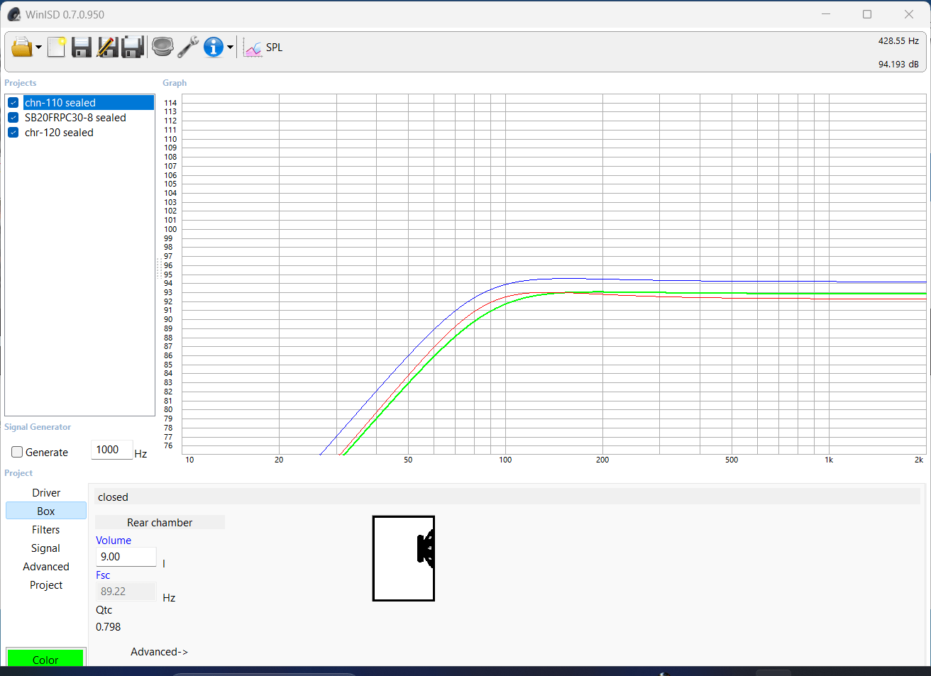

Thanks for the confirmation. The choice of driver is not limited to markaudio, I just picked those based on their popularity on this forum and because there was some measurements available. I will wait a little if other members have some feedback on driver selection, and will start building test speakers.
Other companies that offer drivers available in Europe are FaitalPro and SBAcoustics, the latter even has a French distributor.
Both of them offer a wide range of drivers, and are premium products.
Faitals are more ”pro” oriented, with driver capable of playing loudly and handling power.
SBA is more like a spin-off of ScanSpeak in Indonesia, with very well balanced drivers that are reasonably priced.
I will also second that 3” Drivers for HT is probably not the best approach. Sure, on paper, they look the part, but in real life, they lack the “meat” required. Such a small cone cannot push that much air.

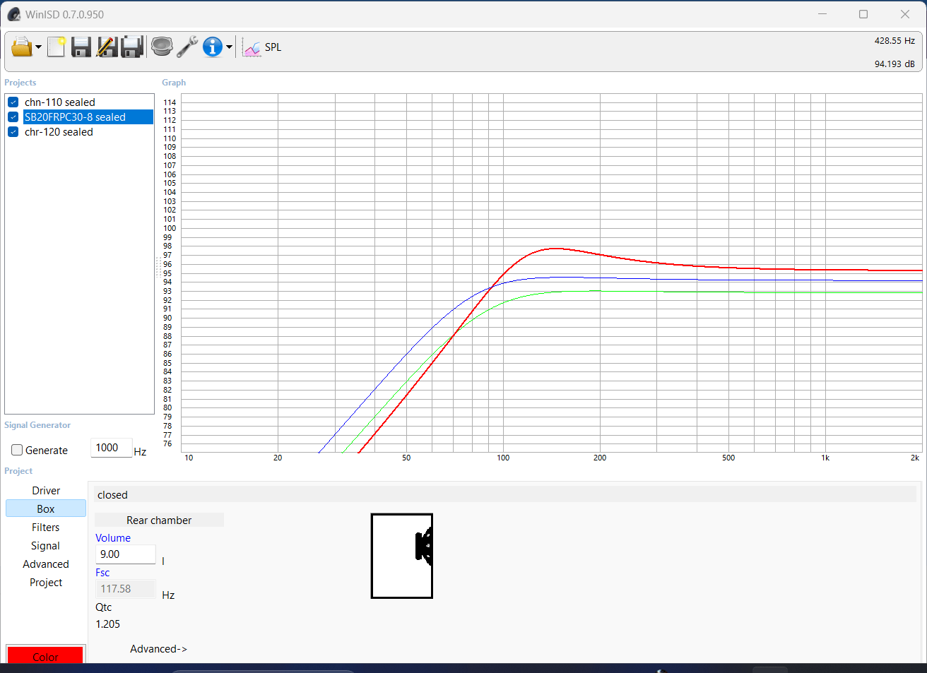

I did mention a bigger full range, the new 8” SB20FRPC30-8. It works sealed, vented and in a transmission line. Quite the feat! Being 8", it will have more punch than the small ones you are looking at. It will work in a 20-liter sealed enclosure with a Fs of about 80Hz. You can then ask the subs to fill lower. Very reasonable price on these drivers as well.

Thanks a lot for the recommendations, I will try to model those.
I actually had looked at SB20FRPC30-8 during my initial research phase (in particular this thread), but when I model it in a sealed enclosure it seems to perform similar to the Markaudio CHN-110. It seems to be due to similar Vd for both as SB20FRPC30-8 has twice Sd but half xmax. However, the reason I did not look more into SB20FRPC30-8 is:

Edit: Haven't had time to check for the CHN110, but Madisound suggest a 18 to 25 liters enclosure, while I mentioned the SB20 will need about 20 liters. Don't know where this "double the cabinet size" came from....
But the MA has a sensitivity of 88dB, as the SB20 has 92dB.
And maybe you could tell me what you liked about the data from those two sites (which are not the CHN110, by the way).
The two have shown that the data from MA and the measured ones from testers were quite different. Alright, different conditions apply, but the break ups don't show as much on MA's data.
And both exhibit close to 10dBs break up mode, yet, the tester called it smooth?
Like I said, there's no perfect drivers, and my set of ears will be different from yours, as is with expectations.

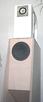

If you desperately try to stay with a 3 to 4" driver, may I suggest another route?
The TABAQ is a proven design, that offers a very satisfying reach. It can be placed on the floor, right against the wall, it can be hung on a wall, etc...
Paired with a good driver, it might be ok for you. Plenty of drivers have been tested and reviewed on the TABAQ thread.
A mini HT with TABAQs spread around could be nice for limited space.

Here is what I get for CHN-110 (9L green), SB20FRPC30-8 (20L red) and CHR-120 (14L blue). The two Markaudio boxes are limited by power, the SB20FRPC30-8 is limited by xmax.
I could push the SB20FRPC30-8 to be power limited with a 9L box, and I get the following picture (with a steeper roll-off above 100Hz).
So indeed I could get more output above 100Hz from the SB20FRPC30-8 but it seems to not extend to 80Hz as well as CHR-120 in a sealed box (maybe the solution would be a vented box of higher volume?)
