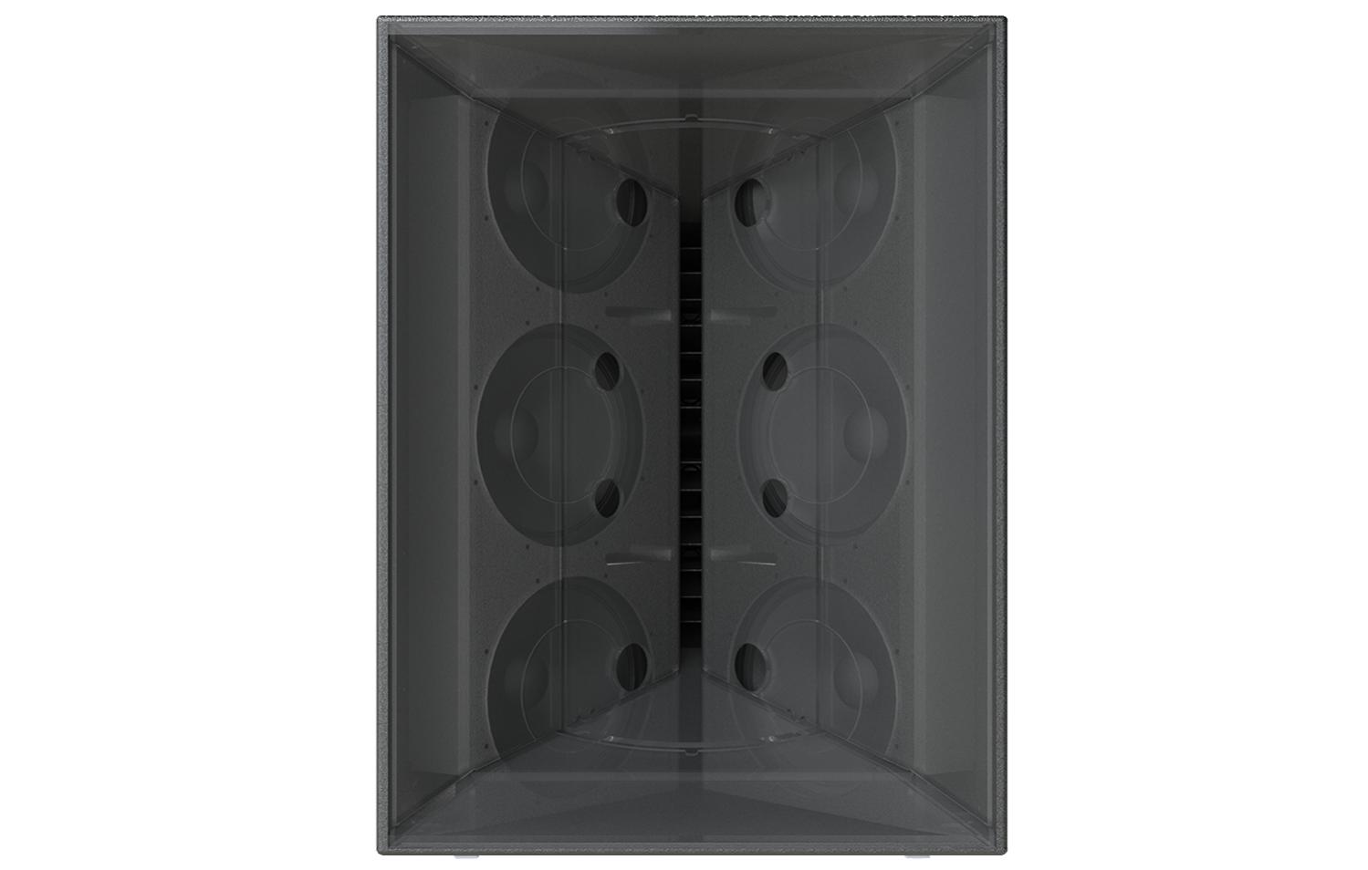

If I were to design a synergy (inspired) system, it would probably consist of a big conical waveguide/Arai type of horn mounted inside a large J3-like horn.
The outer horn could be loaded with 18" or 15" woofers and 12" or 10" mids. 2 of the latter may breath through the mid/high horn.

Definitely worth idea to fine tune. I have also played with nested horns on idea level. Colossus could also be said to be a nested design, but the wavequite of the woofers is 180deg😀 And a more brutal force "iron curtain" Sd-solution. Sd-scaling is non-elegant (and costly) but easy and it always works🙂 And the wooden parts' structural integrity is easy to achieve. With big horns similar acoustical deadness of every panel (like a thick and braced cabinet) is (also) a great challenge without them becoming unmovable objects🙂
Valid points!!
Indeed, your Colossus consists of a mid / high horn - for which controlled directivity is most important, nested in a 180° horn wall.
I like the modular design of it, and while not exactly portable, the individual cabs can be moved by 1 person.
A single Danley J3 weighs almost 200kgs. It seems quite complicated to design such a synergy horn in modular fashion.
