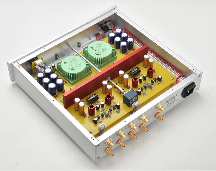

This pre amp doesn't look too bad either:

That pre is a beauty. Might be good bang for the buck.
