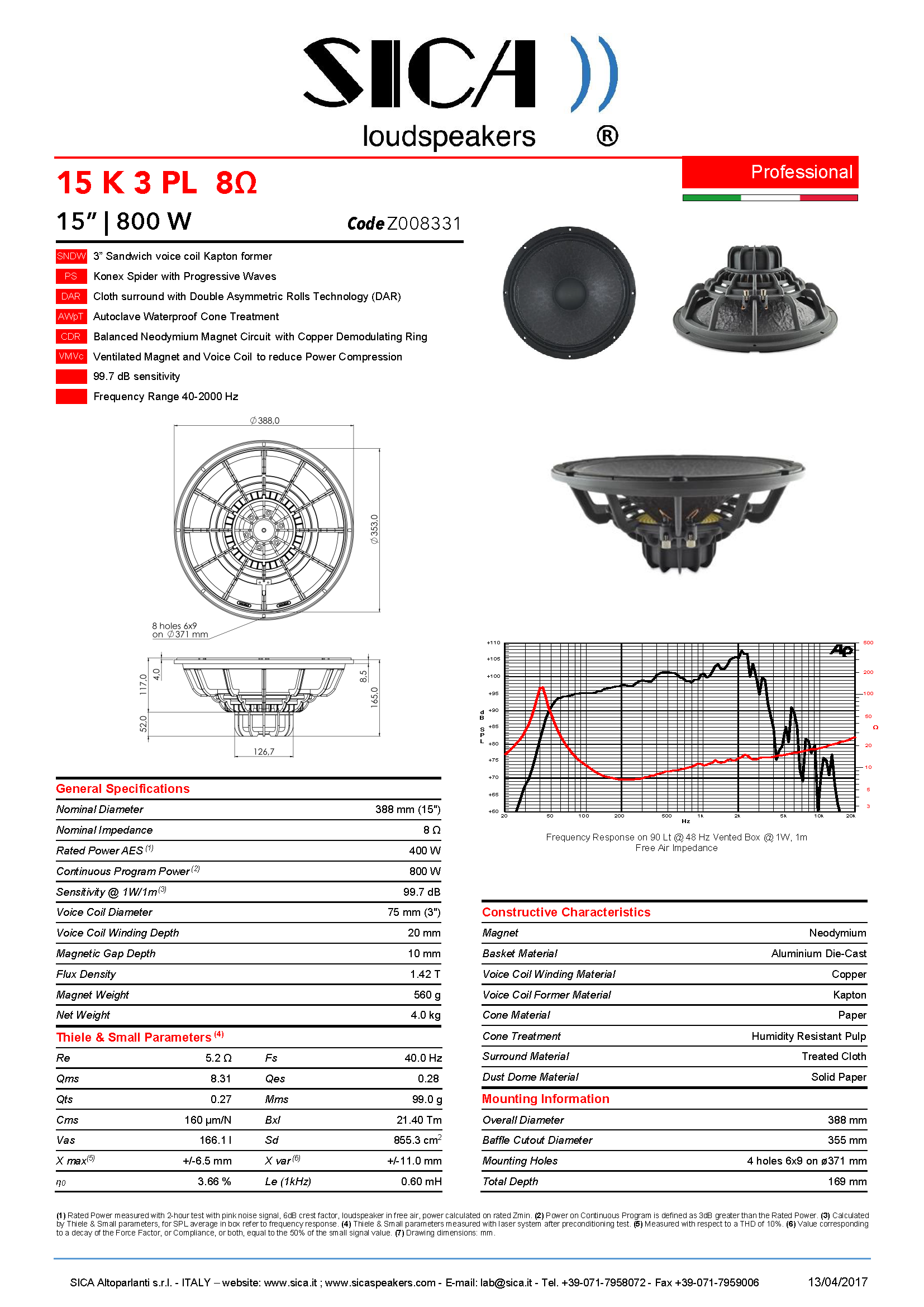

Sicas seem very nice! I like the open and vented chassis, would like to hear them one day. I also considered the 15" 3" vc "K3PL" (copper short ring) Sica when planning the woofers for the bass modules (for like 3 months😀). Eventually the Fanes came to me on a platter, both recently discontinued models (now MOQ 50pcs I presume) which still had some leftover stock. I payed ~135£ for a piece for 15" and 119£ per piece for the 12"
Yep, those kind of drivers are the magic. Low moving mass, low loss suspension, balanced sounding (preferably untreated?) paper/mixture cones (I like also the carbon fibre fane also although was sceptical at first😀) driven by a good motor and high motoric force vs. the moving mass (simplest indicator high EBP). My favourite genre of drivers, musical machines🙂. Also the "guild of the kick bass" is just a consequence of said things and the resulting ability to energize the cone on a wider bandwidth like the music, transients and harmonics need.

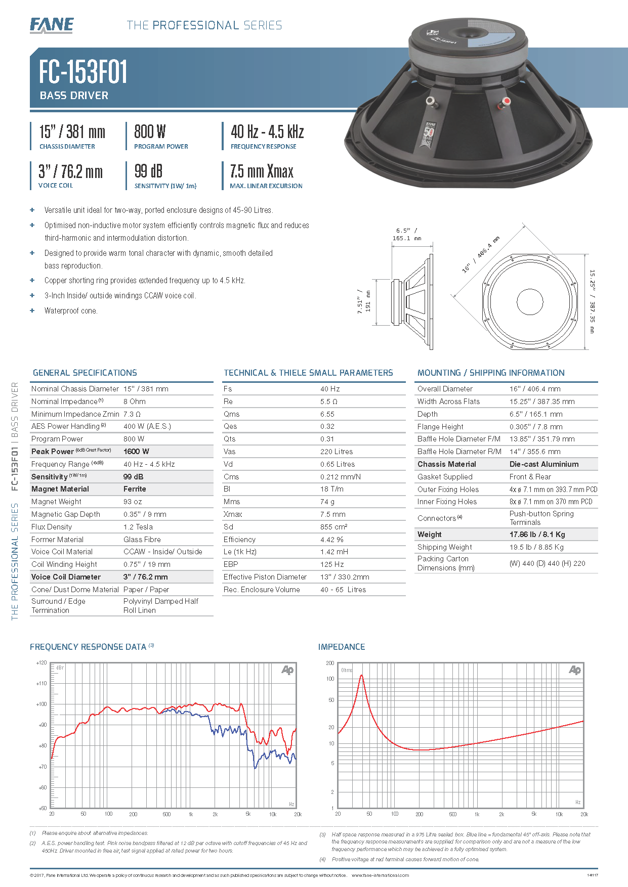

The Sica 15K3PL is indeed an interesting woofer with a rather impressive EPB of 142.86. Your Fane drivers are comparable, apart from the Ferrite magnets.
For less than half the Sica's MSRP, the Fanes are pretty much no-brainers.

Both the FC Fanes seem to have some "cheating" in their cone. The 15" has also quite stiff cone (but not fibrous like the 12"), yet very light, and has built-in water protection without coating. But it's not said to be polycellulose either like in some other models, but definitely not pure paper. Both advertise to have "state of the art" cone, and as some said on other forum, it would be unlikely that pure paper cone would receive such a statement.🙂
The 15" Fanes have only 100-110 EBP (not 125) based on my measurements, but the error is systematic and they measure very close to each other. The 12" have EBP at the spec, and also very close tolerance.
