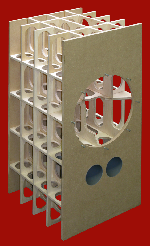

Couple pics of the raw mid modules before they start to look like something else🙂.
Material is 25mm MDF, front baffle also has 12mm plywood laminated behind it. The edges are "miter cut"/45deg except at the center hole in which the horn is mounted. The braces are quite hefty 40mm thick and 30mm wide plywood and there are plenty of them supporting the already narrow areas that need to be braced.
I wonder how does the box's standing wave spectrum look like with this geometry.
Lots of acrylic mass to glue the felts. Might damp some hf panel resonances a bit. Acrylic mass has good price to inert mass ratio, it's quite like chewed bubble gum when dried.
Thanks xrk! I also drew a synergy/unity mid modules (only a crude picture) but did not want to go that route again, too much hassle to get it right. Instead I chose this synergy/point source emulation with direct radiators with much more Sd and way less hassle.🙂 Back to basics.
Btw. does anybody know how to sim the inner air space of the box when it's not rectangular? I suppose the O-ring box shape like this dampens the systemic resonance at least somewhat. The back wave sees approx. 3m long (lined) pathway until it reaches the back of the cone again or sth like that.😱 I didnt fully realize this, but now they have the lining almost done the inner space seems very damped regarding the standing wave behaviour when speaked/beatboxed inside the cabinet. Sounds good, but I dont wanna loose too much sensitivity in the upper bass region due to very damped systemic resonnace. Hopefully this is not the case and it dampens/spreads only the standing waves but the air springs stays non-lossy at system resonance. If the impedance peak is at 80-100ohm the guild of the kick bass is happy.

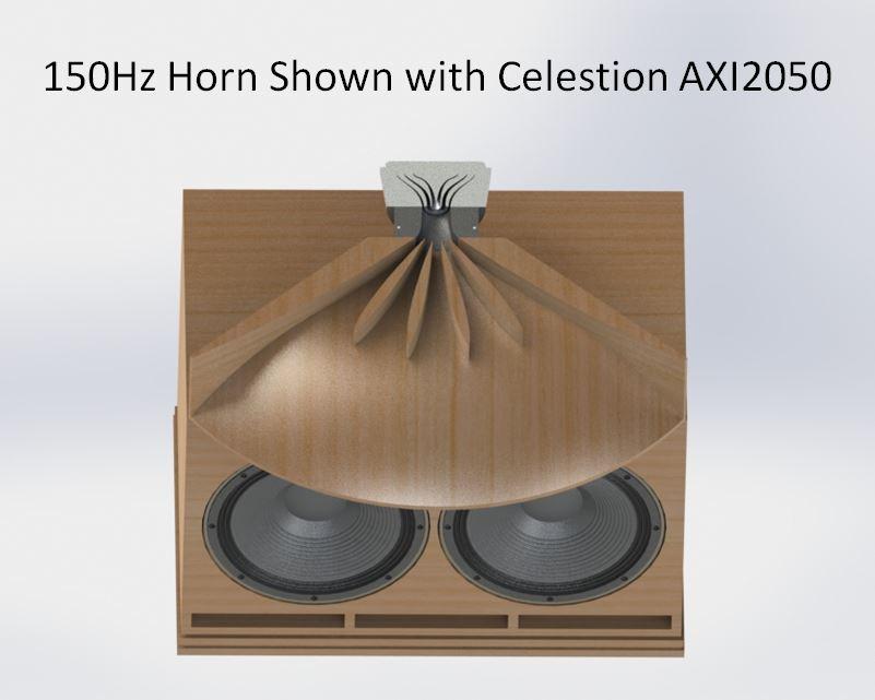

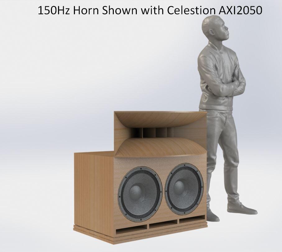

Even Joseph Crowe's 150Hz Arai horns would probably fit in your cabs.
