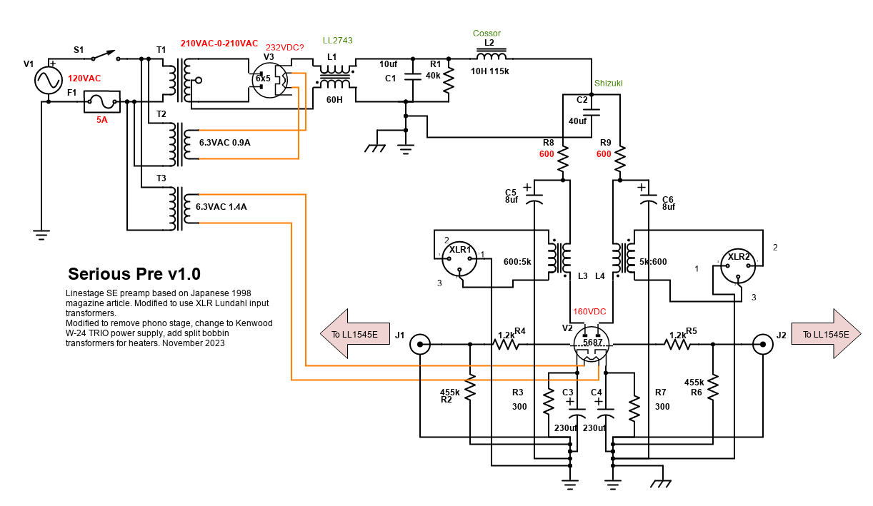

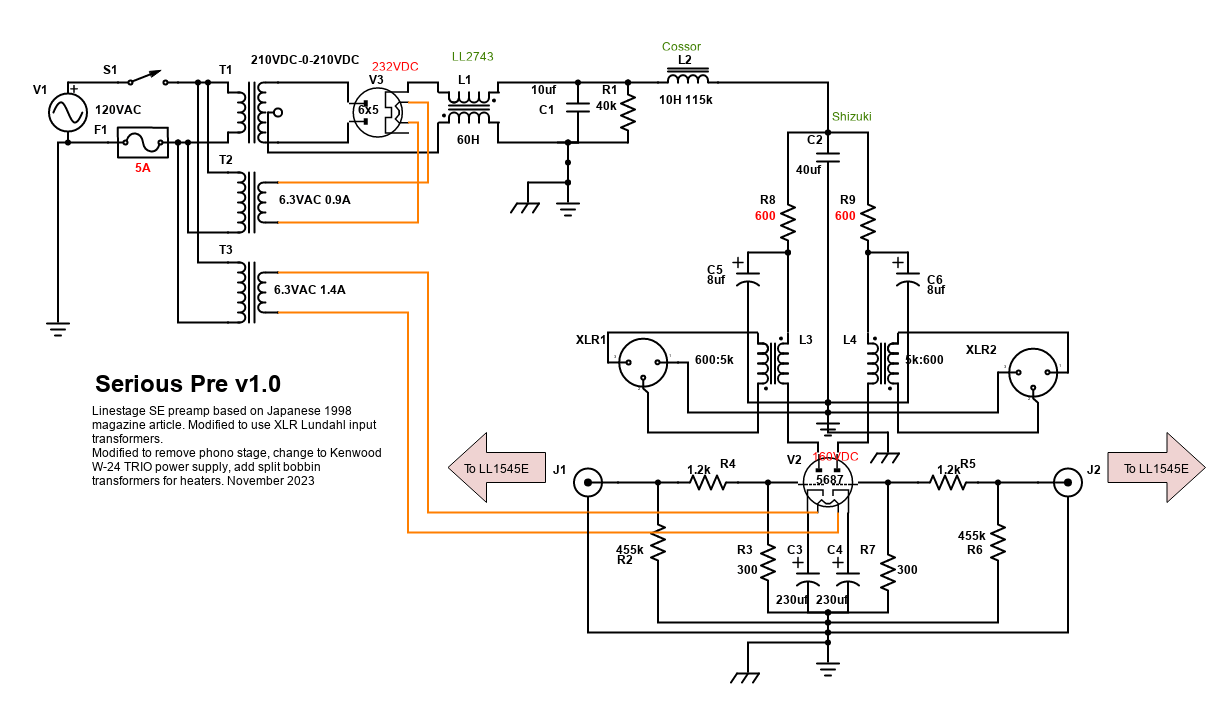

Thanks for all the help today everyone. I have modified I think per feedback. I always seem to get mistakes in. The software like to move the little connectors around. I am not sure about cap polarity for the C3/4 230ufs. I have changed the RC legs back to 600 (R8 and R9). Left in red as they may need to be adjusted. Still not sure about where and when earth goes to chasis. I think i have followed advice but I am now tired. The software tells me Im going to blow something up when joining earth to chasis grounds 😎 I have added XLRs for the first time as the ISO/Tango NP-126 (L3 and L4) are going to convert to XLR. I need to find transformer icons with the right connectors, so this will have to do for now. I've mirrored everything starting after C2....so it should be easier to read and find mistakes too!
Maybe it's getting closer to final dev version to start building.

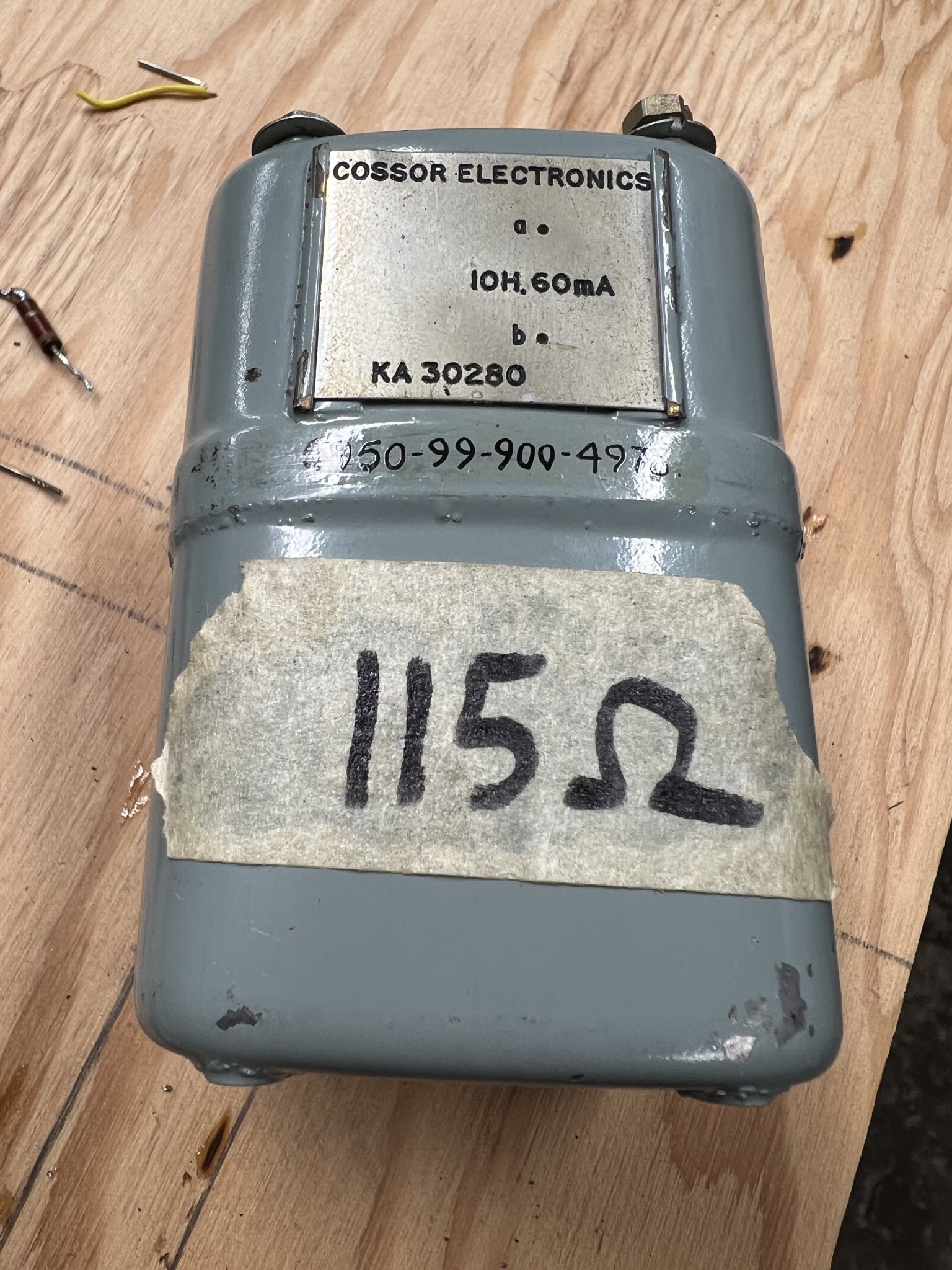

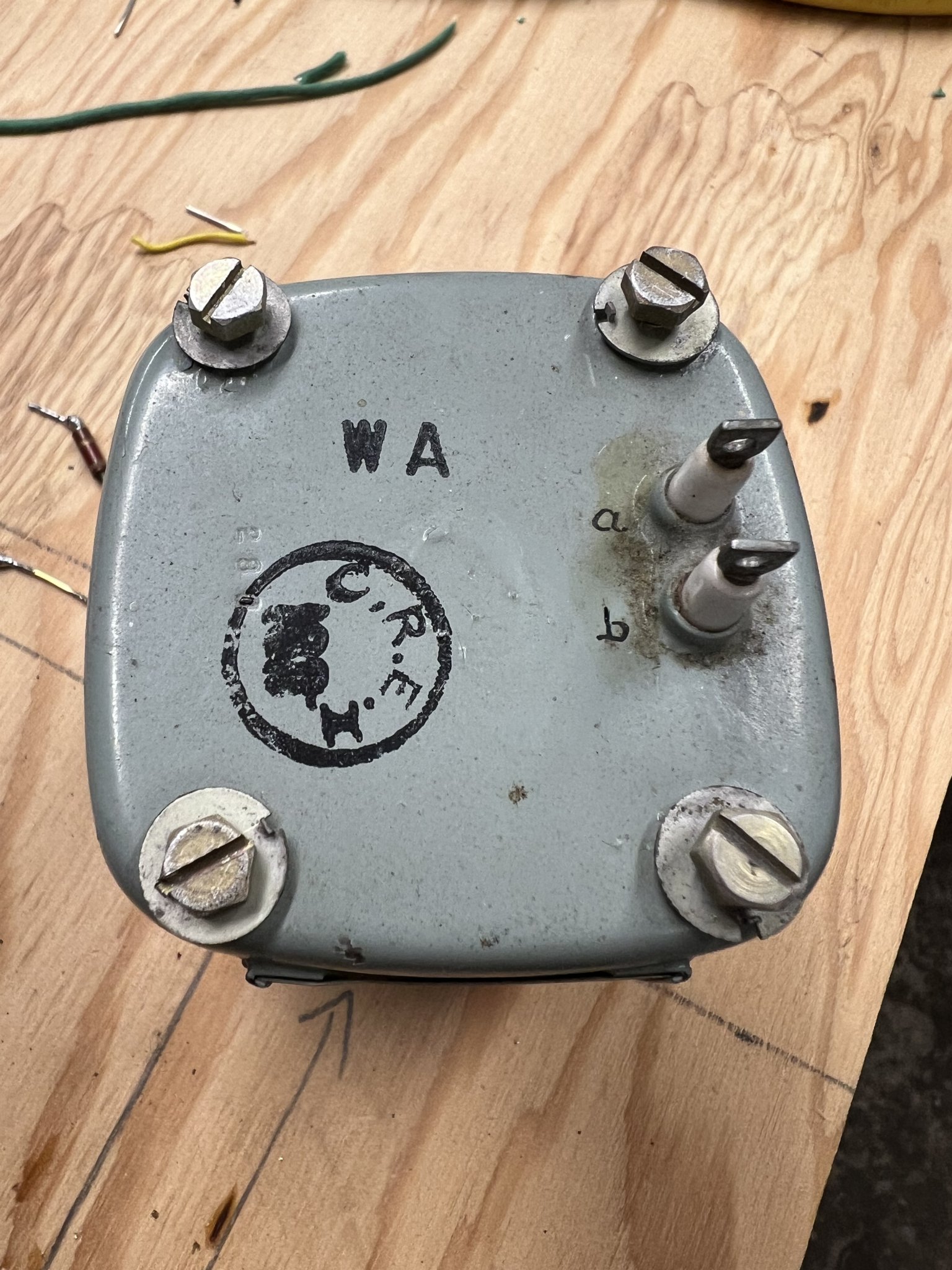

@Thekak here is the second “choke” L2 cossor. From what I have read it is acting as both and inductor to slow down current flow going in and back on the 60 cycles and smoothing out those transients.
The value I measure across is about 115ohms close to what is labeled.
So when you say ” change the resistance value” you mean add series resistance if required?

I can't comment on XLR -> OPT connections or XLR "grounding" since I have no experience with that. But you need to be connected C2 (-) terminal to C1 (-) terminal in your schematic. C3 and C4 would return to C2.
You are using an earth and a ground symbol in three locations. You should earth at one point. You can ground to chassis at multiple points if you want to try that some people do not endorse that approach. I know it's common with guitar amplifiers. There's a huge number of discussions about grounding in this forum and elsewhere, including the Valve Wizard site. I really like the grounding scheme that Eduard is suggesting and have had success with it. I would follow that.
Do you have a variac? If not, you might consider setting up a safety light bulb when you start making connections. I know you've had experience before but just throwing that out there.

Ha Ha. I guess nobody thinks I can build this thing!
The original circuit must be a pile of 💩 I guess....
Let's not talk about the 14 earth points on it....at least i've reduced it to 3.....
and fixed a B+ 265VDC rail represented as an "earth ground".

complete tube newbie. need all the safety advice I can get. was thinking of getting a variac....will the lightbulb prevent fireworks? When I worked for bell canada long time ago we use to use light bulbs to decharge circuits before replacing giant fuses - otherwise the cap charges would just blow the fuse again. Similar thing? Hook a lightbulb across the load to burn excess current if you have something hooked up wrong?
Everyone is just making sure you're thinking through exact, final connections. Grounding scheme is not necessarily explicit in a schematic (like the original). It can be accomplished in multiple ways.
Your use of the arrow "ground" and earth symbol was something I wanted to comment on. If you've got it all figured out, great!
Excited to see it come together.
Reactions: fusion360guy
I don't have it all figured out but Im getting there. ..In the app I'm using the earth ground is the three descending bars....the chassis is the "pitchfork". In the original the earth is a solid down arrow....and there are british and american icons for all kinds of things to I am realizing. I think i like the british ones better, but am using the American resistors.
I am thinking since I will have two sides to the chassis....two pitchforks....for chassis grounds....and then I will likely have a star ground point for each "tube" and bring all the grounds all back to those points. At the end of the day ground is ground and should be equal but i know about ground loops because I play guitar....and chasis grounds so we don't get electrocuted if a hot hits the chassis, and I know that how you implement grounds is important. But i've never built a tube amp..

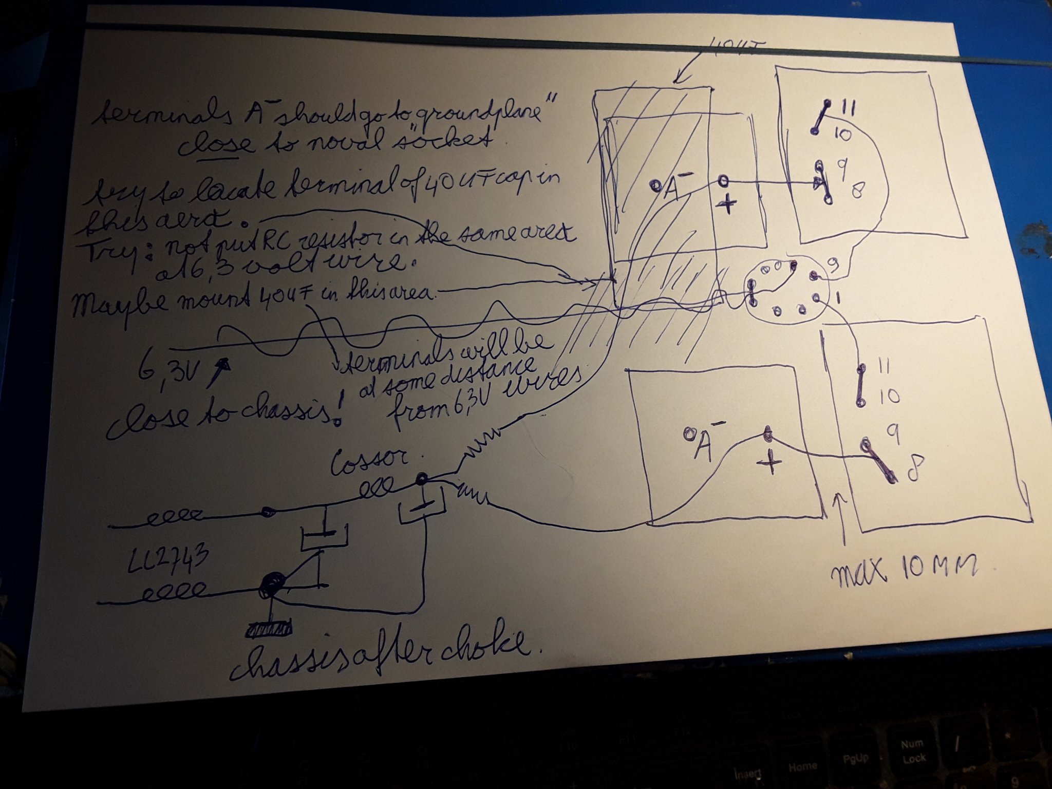

Hello,
It seems Elvis has left the building.

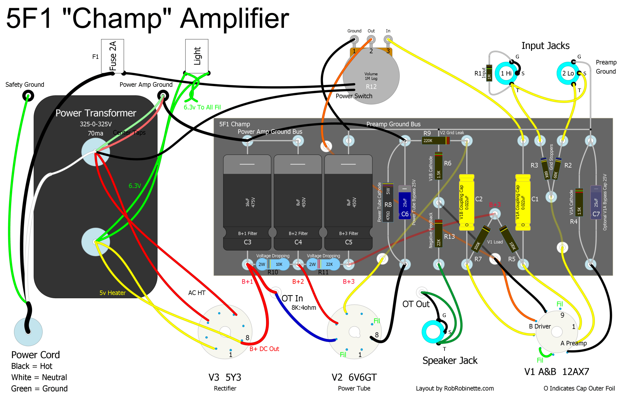

If there isn't someone with some spare time or big interest willing to make a drawing like the guitar amp one this pre amp will never work.
Even the info for correct orientation of the Cossor is there ( don't know if it will matter at all because the distance in real life is considerable. BUT i remember a riaa stage with lcr filter where the original was quiet and the one with new power transformer was noisy)
Greetings,Eduard

Thanks @eduard (Elvis). Interesting on how to arrange the magnetic field of the Cossor. This hobby is full of interesting things...
I've got some spare time and big interest....
I thought it was a simple design, but I think it will be a serious preamp....
Hmm 🤔 Always something new to ponder.

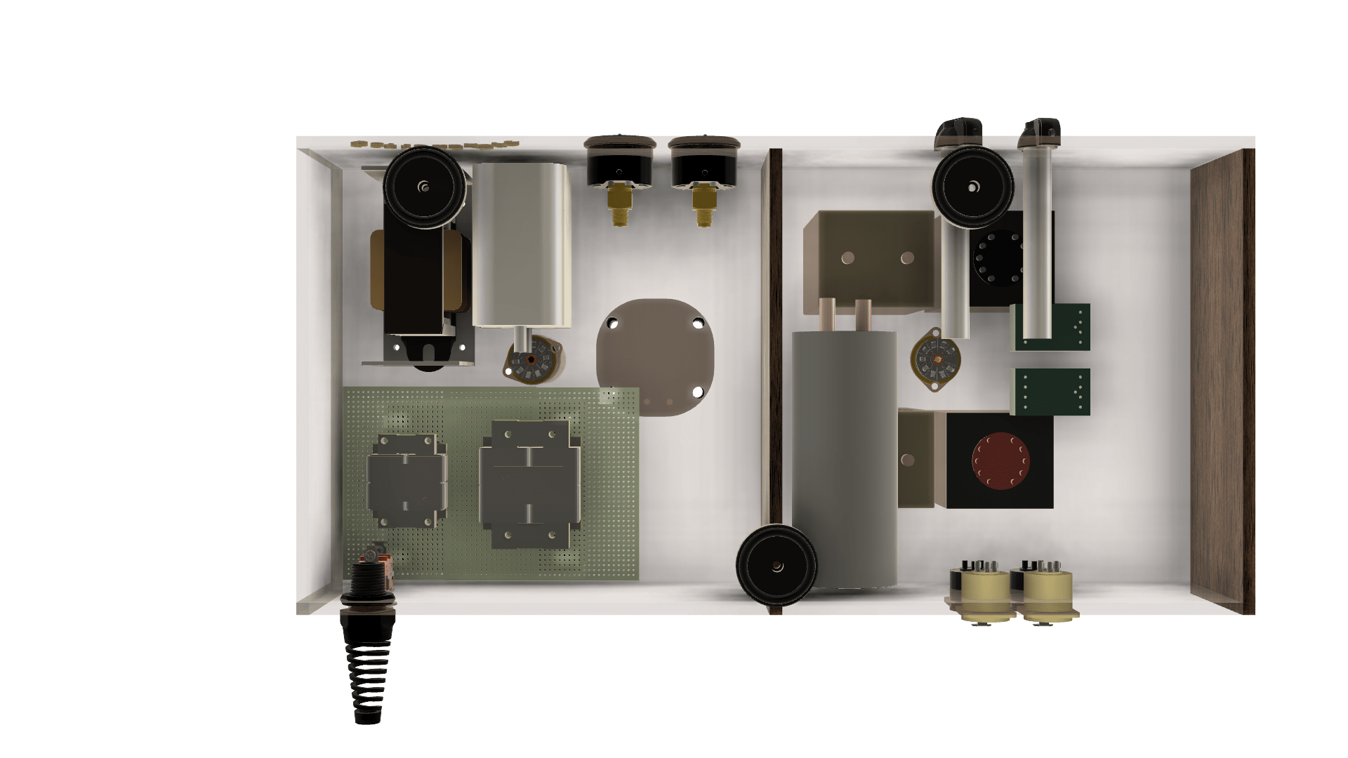

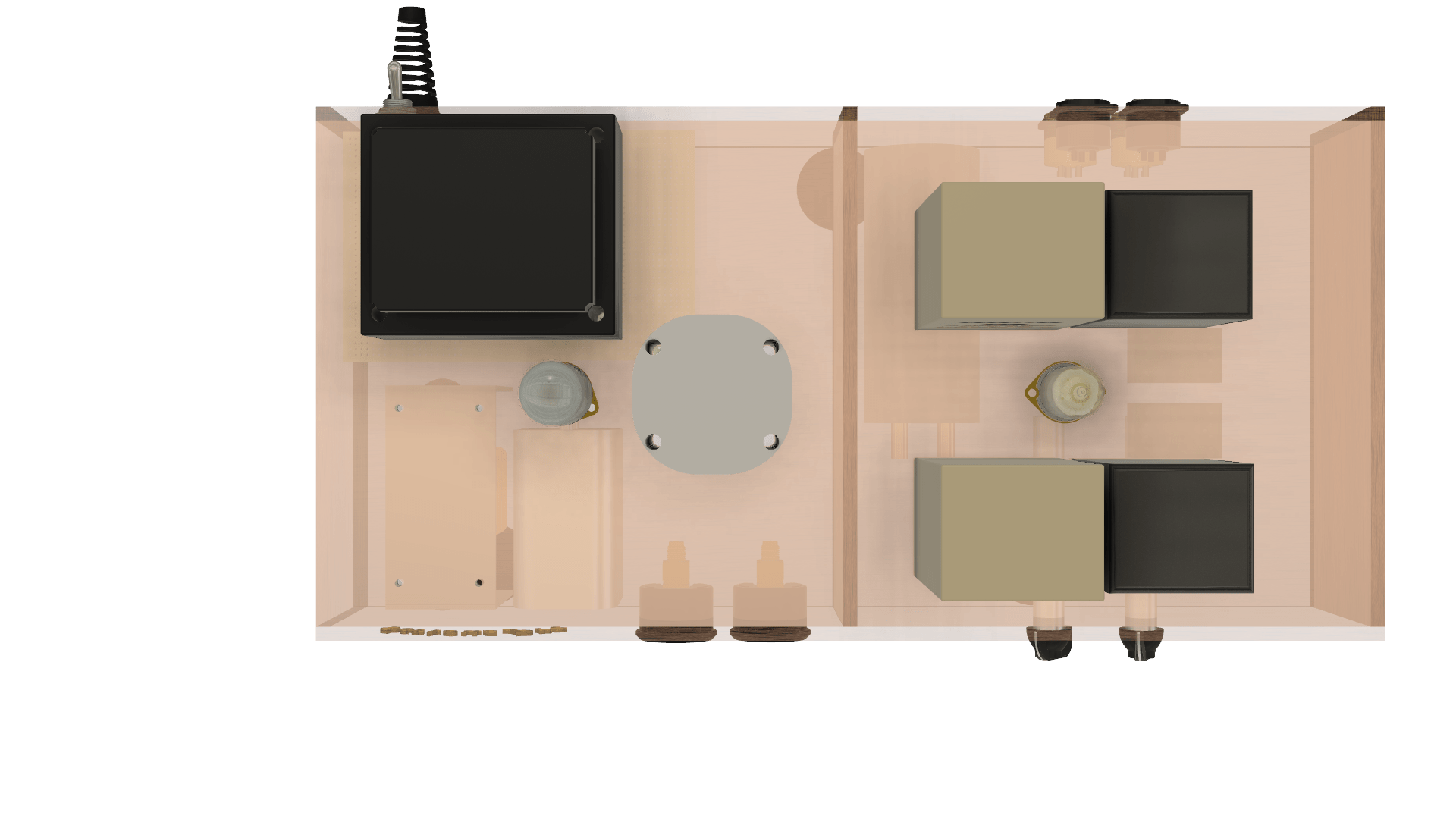

Hi all. Fixed some mistakes. Put separate star grounds for left and right half.
Did some physical layout on a physical board and then modelled it in fusion after.
Look how the software has drawn Power AC input - Live/+ and Negative/- which is then connected to Earth/Chasis - maybe this is what trips the software - it should be drawn with 3 lines for AC : Live/+, Negative/- and separate Earth.
Live and Negative goes to Fuse + Switch ( one or both, depending on what You want and the type of the Switch ) and the third line : Earth goes straight to Chasis - this is if You are using IEC connector.
If You are not using IEC connector but only two wires ( Live & Negative ) i don't think the negative AC should be connected to Earth - but this i never did.
