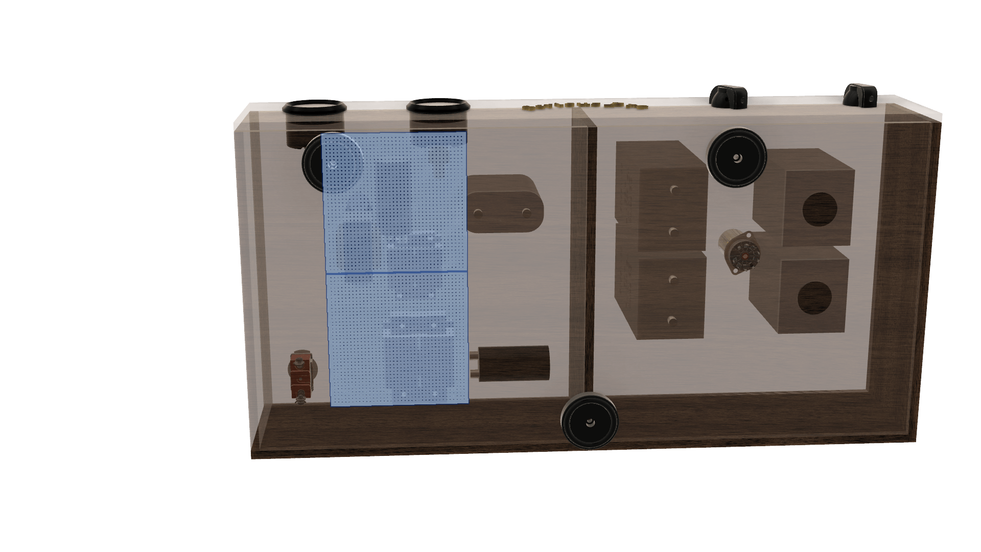

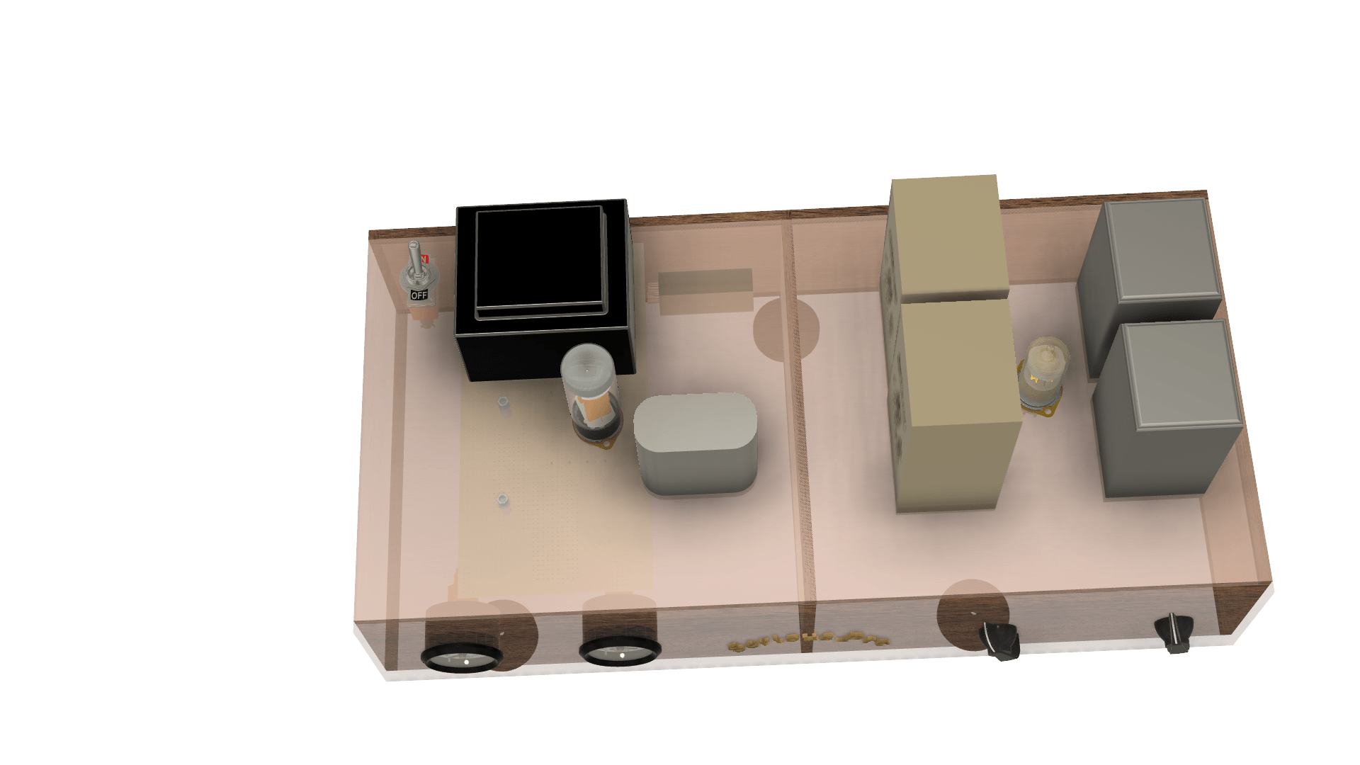

Fusion360 Mockup (not actual parts but rather conceptual right now)
Based on this April 1993 circuit with substantial? modifications provided to me by the DIY inspiration user ....no Phono stage, single 5687 for both channels, etc.

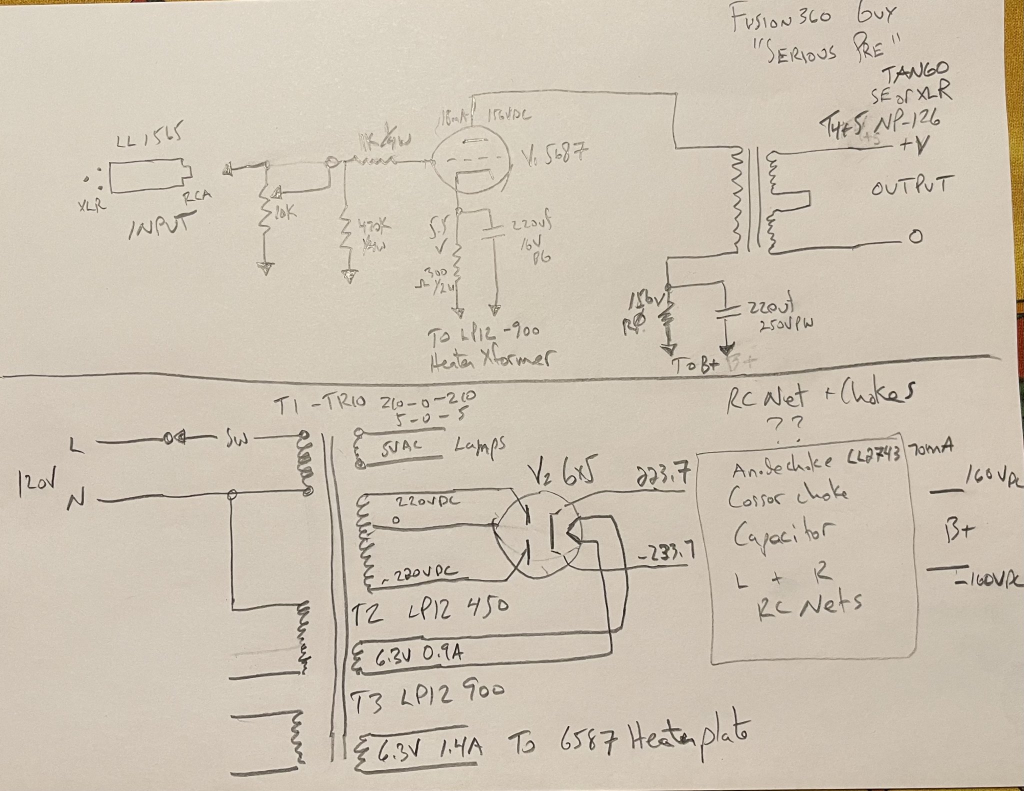

Here is a very crude schematic. The 5687 is a dual triode and can support two channels if wired correctly. That is my plan. The chokes and RC Net is a black box to me, but I'm working on figuring it out. I've put in the black box the components that will go in there. There is also rectified wiring to support two lit up Voltage and Amperage meters. I haven't shown that wiring - just the secondary tap for it.

Also use PSUD2 to design the power supply. Highly recommended. For manual calculation, you can find guidance at https://a-direct-heating-triode.blogspot.com/2018/06/lcr-phono-preamp-part-3.html
I'm seeing signs of over-fetishization of specific types/physical "sizes" of capacitors and transformers even before you understand where you are going. Maybe you and your friend have a lot of money. If so, you are free to spend as much as you want. But IMO there is no reason to go nuts about capacitors or the output transformers.
I don't know where the 10uF caps you are intending to place on top of the chassis are supposed to be in the schematic. Highly recommend that you don't go crazy and over-fetishize specific capacitors and aim for something which will fit inside the chassis and simplify your life.
Also, are you drawing a + 160V supply with a -160V supply? Why do you need a +/- supply here?
Personally, I would reconsider the usage of the Tango transformers. Just don't see why you need to go through the trouble and expense of ordering them. Hashimoto are going to be easier to acquire and less expensive. You are already considering a Lundahl choke, so why not one of theirs?
Unless you can A/B a capacitor or transformer in real-time, you will never know the difference. And if you were to build two identical preamps with differing capacitors or transformers, then switch between them as you listened, the difference would truly be minute (and perhaps even imperceptible).
Work on the fundamentals and then obsess over the %.0005 difference you will achieve in sound with capacitors/transformers.

If it were me, I would definitely use a solid state voltage regulator circuit.
Me too, and that's what I use myself. You need the 1,200V Schottky diodes. Cree and others.
PSU capacitors are important. I seriously recommend a DC Link polypropylene cap in first and last positions. I use Kemet C4A but there's also Vishay and a couple of others. Electrolytics in between is OK. This will make an audible difference - I've laboriously A-B tested PSU caps and that's my take on it.
I'd use a type 26 in filament bias but that's another kind of build. Otherwise I'd use a pair of 6AH4.
Well, it's a nice tube the 5687, some hints of 6SN7 linearity and designed for industrial use it has some balls so nicely suited for driving a transformer output. A very good cap might be better but it's a matter of taste in the end. I totally get that you want to reproduce a design that has grabbed your attention - it doesn't matter that there are many ways to skin a cat, some better than others but if the heart wants to Tango then Tango is what it wants. Nobody else will really hear the difference but you alone will know what is under the hood and why it's there and the satisfaction from that will last longer than the pain of opening your wallet.
I can see the use of a 5AR4 because it's an indirectly heated rectifier so it allows a safe warm up speed for B+, it also has a relatively low voltage drop and I like that for reduced sag. Nevertheless, a noval rectifier has been recommended above and I endorse that approach but it really depends on what heater winding you have on your power transformer which already has been mentioned as being good for a 6X5 so good idea to use that.
Overall, it's a circuit I'd build myself if I didn't just finish my own high-end pre-amp with tubes. I used an EZ80/81 rectifier as my build was all noval. And I also used SS rectified and voltage-regulated heater supply to eliminate all worries about noise coupling through the heater-cathode capacitance or from wiring dress.
My line-stage provides about 20dB of gain which is nice but these days you don't often need it. I have a -20dB attenuator I can switch-in as pre-amps really aren't necessary for gain very often. So one thing you can think about is dropping the cathode bypass capacitor (there will be an increase in effective plate resistance to think about).
Nothing particularly wrong with either the circuit or the PS imho. Had a very similar preamp, apart from a regulated B+, many years ago. Today, the amount of second harmonics such circuits generate is no longer to my taste.
I think the way I drew the modifications (hand drawn circuit) is not correct. Someone said I will blow myself up if i use that one ! The original Japanese circuit is real. I am losing the Phone stage, using a Kenwood TRIO PS and two separate heater transformers and different chokes. I will try and get my hand drawn circuit fixed. I am tube "Newbie".
