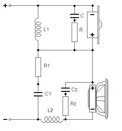

If you are keen and game you could try this AR series xo for the 15W8530 + D2010-851300. It's untried as I do not have the drivers here but have done a lot with Revelator mid woofers over the years. It would be a good starting point with a crossover around 3.2k.
L1=0.1mH 16AWG min
R1=6R8 10W
C1=20uF MKP
L2=1.2mH 18AWG
Cz=4.7uF MKP
Rz=5R6 10W
C=1.5uF
R=8R2
The CR (C+R) across the tweeter is optional but is there to tame the tweeter rising response.
R1 is for tweeter padding and for more top end reduce (no lower than 3R9) and increase for less top end. Have 4R7, 5R6 and 7R5 handy.
Cz can be changed for more or less mids. Increase for less mids and decrease for more mids. Have caps available to make up between 3.3uF to 8.2uF.
Have fun and see if it improves the current situation.

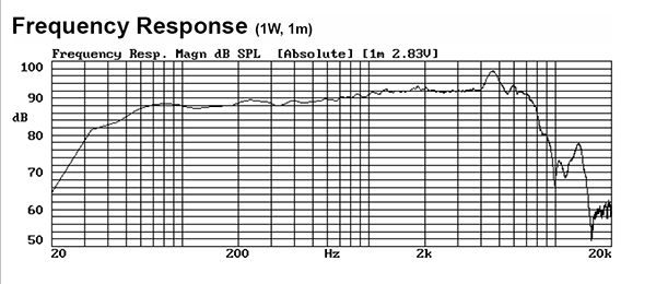

So would this crossover work with a midwoofer with smooth but rising response? Im thinking Aurasound NS6.....and maybe a Seas 27TFFC.

I think the AR is easier just because you can sim it in LspCAD and PCD pretty easy. I can't get the LC Audio version to sim properly in LspCAD and no way to double check in PCD.
In that above schematic, you can move L2 to be series between the woofer and the middle connecting wire. That way the speakers have (somewhat) of a direct connection to the amplifier. Same value coil, different location, but does the same thing.

The NS6 (FR as per the pic?) would not be the best for an AR series as it has that spike between 4k-5k and it is quite wideband. Could be done but needs some work. For AR series I look for a roll off starting about 1 octave above the crossover point.
The Peerless 830875 has a similar spike and had to cross over around 2k to minimise it but it was not completely gone. Crossing over that low does place additional load on the tweeter.
The SEAS W15LY001 was too wide band to work properly in an AR series even after several attempts.
So you get the idea.
I've used 27TFFC in series crossovers and had no issues plus was better than the 27TDFC.
Look for mid woofers with behaviours like the SS 18W8531G00 or Vifa P17WJ-00-08.
