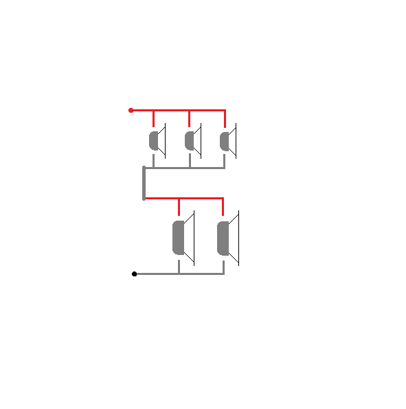

but both drivers are in series
how can I low pass xo just the one, without affecting the other
highpass xo would be the same for both
With regards to your drawing, the main xover point is at the junction of the upper drivers and lower drivers, as is seen in a standard SXO layout. Coil across the parallel 3, directly in series with the cap across the parallel 2.
This actually dictates having a 2-way philosophy.
There have been discussions I've been involved in in the past stating a cap across the 0.5 woofers in a parallel xover where the woofers were wired in series would work- and it doesn't. In theory it would work, in reality it doesn't hold water.
The easiest way to do a 1.5 way is to use a series coil on the lower units and parallel that directly with the upper units in PXO style. To do a SXO and make it 0.5 anything pretty much requires it be a 2+ way.

thats what I thought....thanks
sounds like I will have to consider PXO with series connected drivers instead
A series coil on that left graphic's woofer sector would LP those. Parallel the 3 at the input to the coil and the other end of the woofers, and then a cap in series with the whole shabang or an active HP on the channel would get you the same HP for both.
The problem with this arrangement is that you are approaching line-array types of things. What is the goal for the 5 drivers?

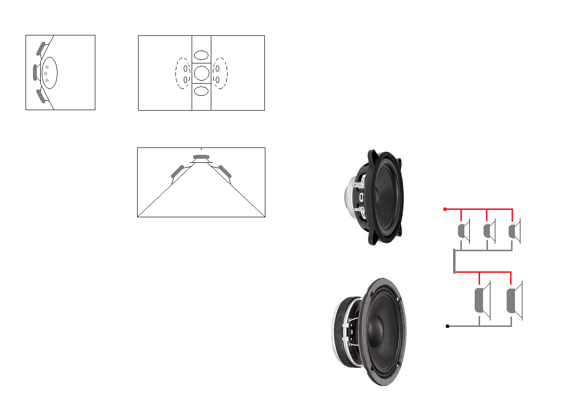

inspired unity horn
Do consider the overall loudspeaker impedance when using multiple drivers so as not to cause amp issues.

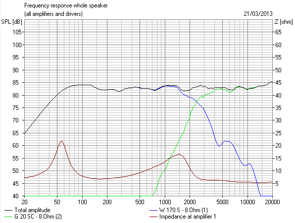

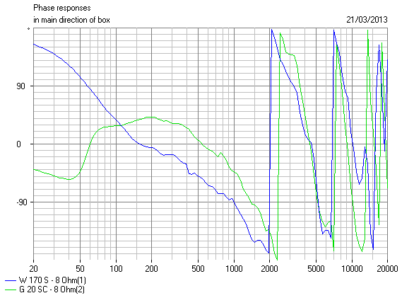

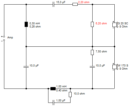

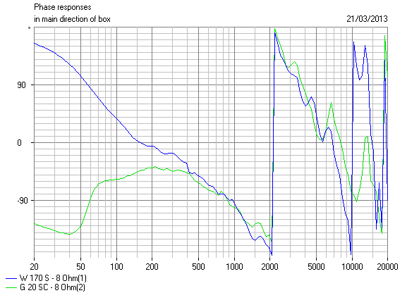

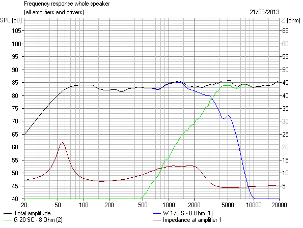

Since Jonathan (chefsinc) started his SB 8" plus 1" project, I've spent a lot of time at Tony Gee's marvellous Humble Homemade Hifi website. The Extremon (found in components/downloads) is a very nice flat baffle 6" Paper plus 1" (SEAS 22TAF/G) design using a series network.
It's quite easy to get as good as you like using Parallel or Series networks, and you can throw some nice notches in with both. The interesting thing happens when you TIME ALIGN it by setting the tweeter back and flipping the polarity.
Suddenly you find all the notches are disastrous to phase, and you must dump them! 😱
So you have to live with higher Fs resonance and 5kHz cone breakup. But the good news is 1) You get a simple fast circuit, and 2) All the resonances are PHASE ALIGNED, so may be less offensive. Series circuits become very appealing when time-aligned, but you CAN do similar stuff with parallel. Like metal cones, they are a strict discipline, but you will learn lots.
It's a matter of technique to adjust the circuits when dumping the notches, and I won't dwell on it, except to say that losing the 15uF DC-blocking capacitor was a very double-edged sword. But these are low-order circuits that make demands on drivers, and series filters tend to let a lot of low frequencies into the tweeter. So some drivers will work better than others, and SMOOTH is good. For instance, this polycone SEAS U18RNX/P looks fun.

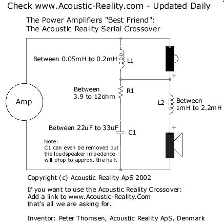

Its a bummer the Acoustic Reality site is gone now. When I discovered it, it was a pretty cool design to try on different combos of mids and tweets. I happened to make it work nice with my Audax/LCY combo in my "Invit8tions" speakers. With the right drivers its almost a magical combo and sounds fantastic with minimal parts.
I've uploaded the image of the AR SXO so others can see whats needed to impliment this crossover design, good luck and have fun with it.
http://i1151.photobucket.com/albums/o624/6thplanet/arserialxover_zps2fb8a07d.jpg
