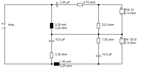

You should place a 0.1-0.22uF cap across the L2, and then a 1.5uF cap across the woofer, and you may no longer require the zobel.
It'll look like this (1.5uF cap not pictured):
Give that a shot,
Wolf

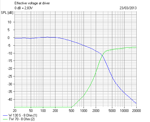

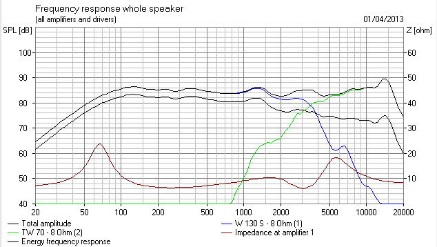

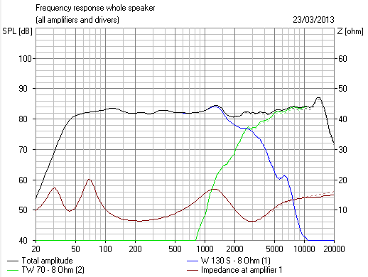

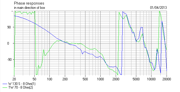

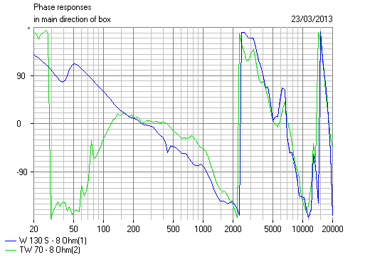

Remember samadhi's lovely Stellan speaker above? Uses a Visaton W130S 5" Woofer and a Visaton TW70 Cone Tweeter. I like the TW70, it just FITS with paper woofers very nicely. Quite how nicely, you are about to see!
I knocked up this 2nd order series crossover with the indispensable attenuator on the tweeter:
Here's the bit that made me fall off my chair in amazement. :eek:
THAT, my friends, is PERFECT phase alignment. I just can't do anything as good with a parallel circuit. It just doesn't get better than that! :D

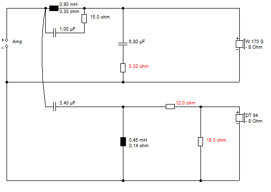

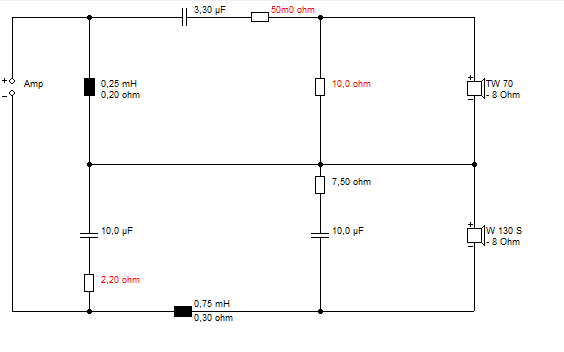

Have a look at this well behaved bookshelf design, using Visaton Drivers:
Do you notice something about the ratios of the components? Remember that crossover frequency is Root 1/LC, and impedance is Root L/C. Crossover at 3.5kHz, and phase and flatness is exemplary. It's a 2:1 ratio of course.
Now here is a well behaved 3.5 kHz Series crossover:
This has a 3:1 ratio.
See, it's adding in some bafflestep inductance and making it into a standmounter that skews the values so you can't see the pattern. BTW, you can make most stuff fit just by adjusting the red resistors. Isn't that COOL! :cool:

That tidy 3:1 ratio is not a coincidence at all! :D
The bookshelf combination above just happens to be so close to time aligned, within 12mm, that it works. It also has no bafflestep. :)
This is a whole new way of designing. No surprise to me that the Forum Wizards have moved onto time aligned. :D

What IS this gibberish? Wolfie, there are no tricks here. It's just how it works. Make one thing different and something else gets affected. But to some extent, YOU CAN HAVE IT ALL! Series circuits are FAB! They strip filters bare. :)
The Visaton W130S has a Vas of 12L and a Qts of 0.47, so unless I am losing my touch, 12L is about the optimum volume for closed box so there should be NOT A WHIFF of the HORROR that is "Transient Ripple".
A dome tweeter can be done too for better dispersion, Fs correction and a tweeter zobel do much good too. After all, we can all do this stuff, it's not hard. And phase alignment is then even better as it goes. But that would add complexity and is not my interest. There are also people who think a speaker without bafflestep is compromised. Well. think again.

You are nitpicking, my friend. There is off course 0.75mH plus 0.25mH of filter inductance. Making 1mH. Sort of bass curve you'd pull the speakers slightly away from the wall to get them sounding balanced. But we're not really interested in that. You get what you get with the component values. :)
You miss the bigger picture with the phase alignment. The +3dB bump at crossover is a FEATURE! It's constant power BUTTERWORTH rather than boring old flat LINKWITZ-RILEY, and you suddenly see what it REALLY does. :D
It's also interesting that Steen Duelund's ideas of always correcting driver impedance become crucial with series filters. These circuits thrive on Fs correction and Zobels. They work best time-aligned. The most interesting study I have ever done in filters. I think it might also explain why valve amps sound good too, but I digress now. :cool:
No- that's not 1mH on the woofer. The nodes attach differently. That still does not mean there is no BSC in the design, as you stated was the case. If that is not what you're interested in, then why did you state it as such a great thing or a feature? So the components are of a ratio- big deal.
It gives a peak at xover, wow that's cool....:rolleyes: Of course it will without spread factor. I'll keep my flat responses, whether BW, Bessel, or LR.
