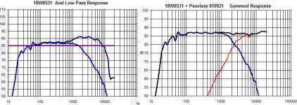

Not the same driver but a 18W8531 which has a similar bump at the roll off. As mentioned by wolf_teeth, it's handled by the crossover.
In the FR below, it's a AR series xo and look at the LH graph. The dark blue line is the raw driver and blue is after the filter is applied. Final shaping is done via the zobel cap which also helps with phase to get a deep reverse null. The RH graph just shows the completed speaker with both drivers.
I found it impossible to use this woofer in a standard series xo but easily managed in the AR series.

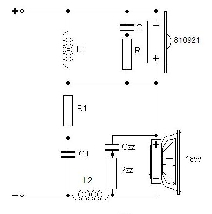

Awesome ! So would it be safe to assume the Usher could be used from say 1500hz and below ? I guess I'll have to order tweeter's from Planet - Krypton or wait till one lands in my back yard ! Could you post a schematic with part values ?
I'm not familiar with the Usher driver so can't comment. Crossing over below 1500Hz is going to require a very strong tweeter if used in an AR series xo.
FWIW, I've added the crossover for the 810921 + 18W8531G00 for reference. Note that this xo was used with a 8" 0.5 woofer so there is no BSC. It would need changes for a 2-way with BSC.
L1=0.1mH (0R05)
R1=5R6 (10W)
C1=20uF
C=3uF
R=5R6 (10W)
L2=1.2mH (0R19)
Czz=8.2uF
Rzz=8R2 (10W)
For a 2-way these changes would need to be made (approx):
R1=6R8 (10W)
L2=1.5mH-1.7mH (0R25) depending on BSC required (larger mH = more BSC)
Czz=6.8uF-5.6uF (i.e. smaller cap with larger inductor)
Rzz=6R8 (10W)

It looks like you went 2nd order (cap) on the tweeter with an added trap circuit around it. where you concerned about the Vifa surviving 1st order?
carlspeak
Yes I was. Xover being about 2.3kHz, 12dB is about the lowest I would go to prevent HD from coming in. The LCR is to tame the undamped Fs the XT25TG30 has. The resultant measured notch makes the impedance of the XT25 to be +/- 0.5 ohms over the entire audio band. Without killing the Fs, it can sound very nasal, and James Taylor sounds horrid without the notch.

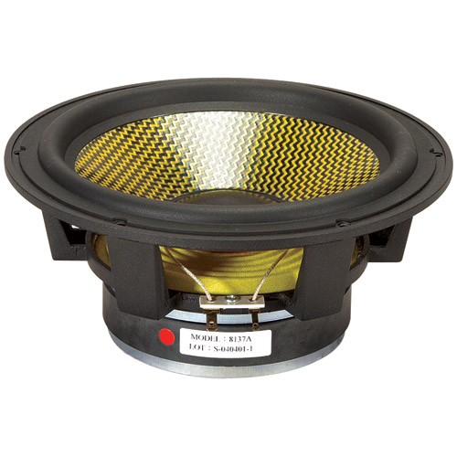

Rabbitz, What are your thoughts on the Usher woofer ?
Personally I wouldn't use it in a AR series xo as the cone breakup is very high and hard for this type of crossover to deal with (more a job for higher order parallel crossovers). Usually for series you look for smooth roll offs (including bumps) and that generally means paper or polypropylene cones.
