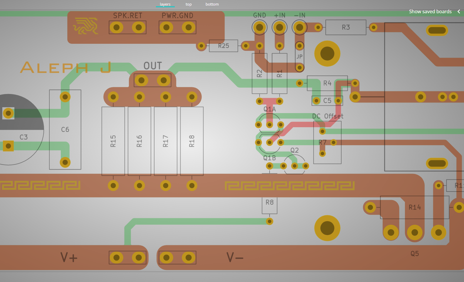

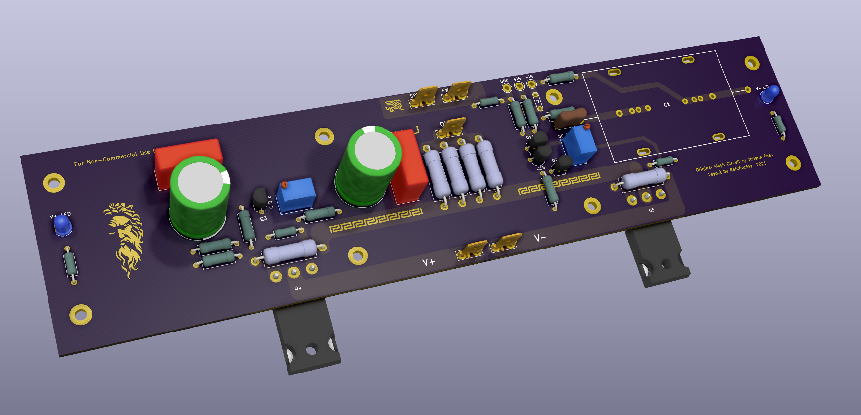

First concept of V2 board with different LTP CCS.
Finally I could double output trace and even widen it a bit.
Also could not resist to experiment with patterns. 🙂
I am not in haste. Those are just experiments.

Here it is that same V2 board.
Some thought about simulation from previous page.
Uper and lower output stages are both SJEP120R100 in those.
With AC gain trimmer set to 68.2K and uper output stage source resistor 0.47 Ohm we have 1.375A across it (across resistor).
With same AC gain 68.2K and 0.33 Ohm source resistor we have 1.955A across it.
With same AC gain 68.2K and 0.22 Ohm source resistor we have 2.925A across it!!!
For this simulation safe starting values for AC gain trimmer before solder is:
68.2K - with 0.47 uper source resistor
4.9K - with 0.33 uper source resistor
2.4K - with 0.22 uper source resistor
(for boards with only 2 output stage transistors)
I would rather agree it sounds misleading.
That resistor is Bias/AC gain.
But yes, the primary role is Bias and that's why we twist that pot.
So I think I should rename this pot on my boards to just simply Bias without mentioning Gain and that's it.
What do you think?

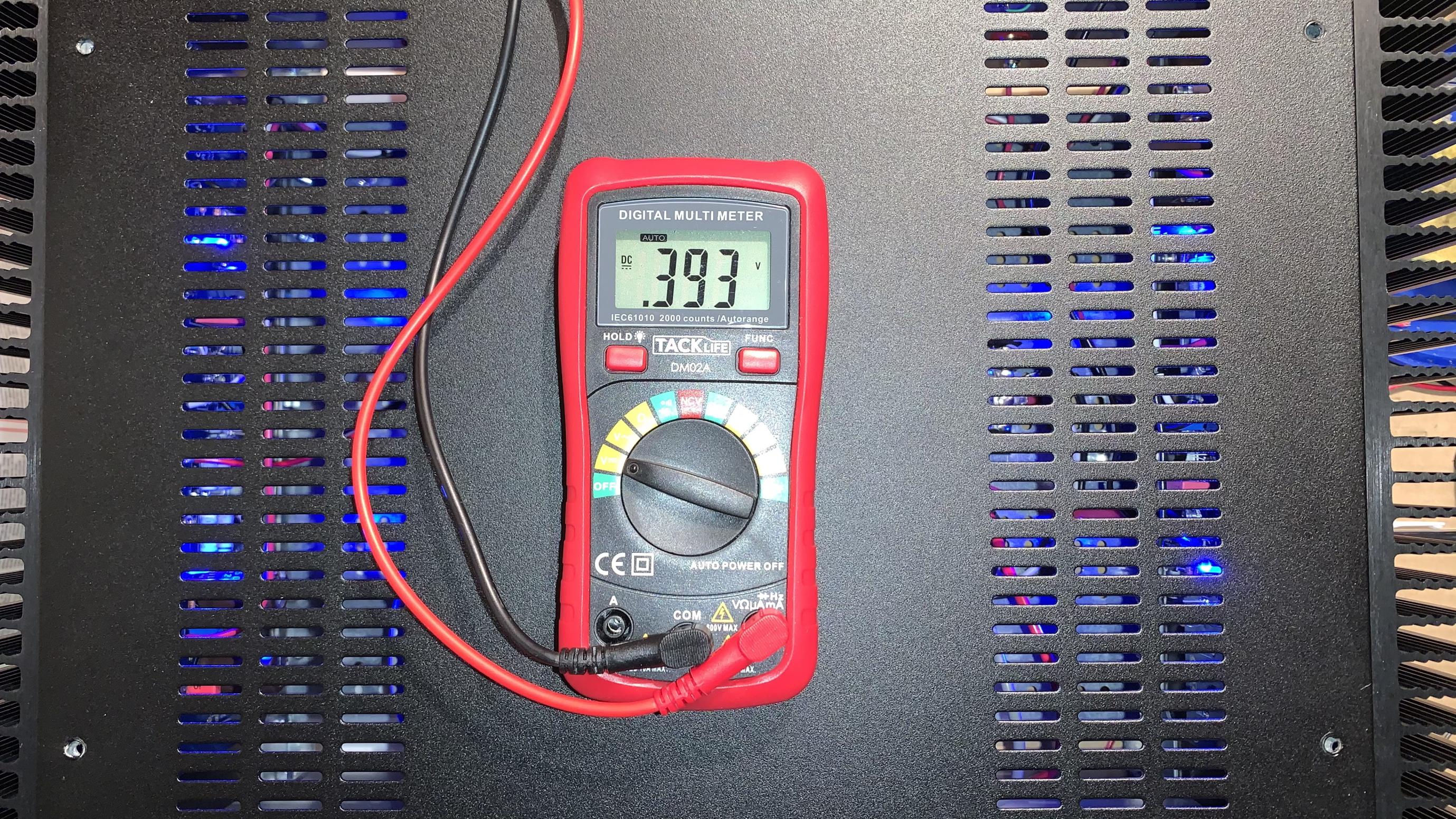

I used 0.22 ohm source resistors in the upper and lower positions and had R27 set at the recommended 68k ohms. When I powered up the amp bias was slightly over 500mv. I quickly lowered the bias to 400mv as I’m only using a 4U/300 chassis.
