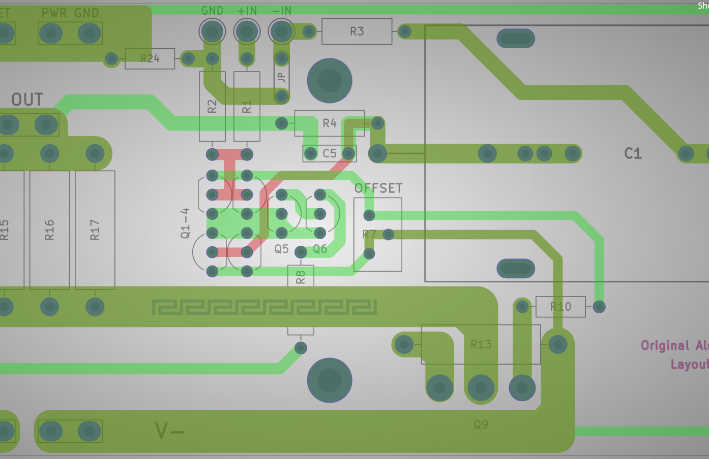

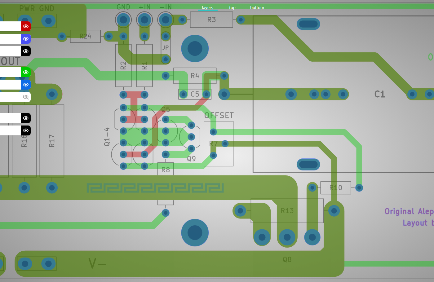

P.S.: Slightly corrected layout for more pretty symmetry.

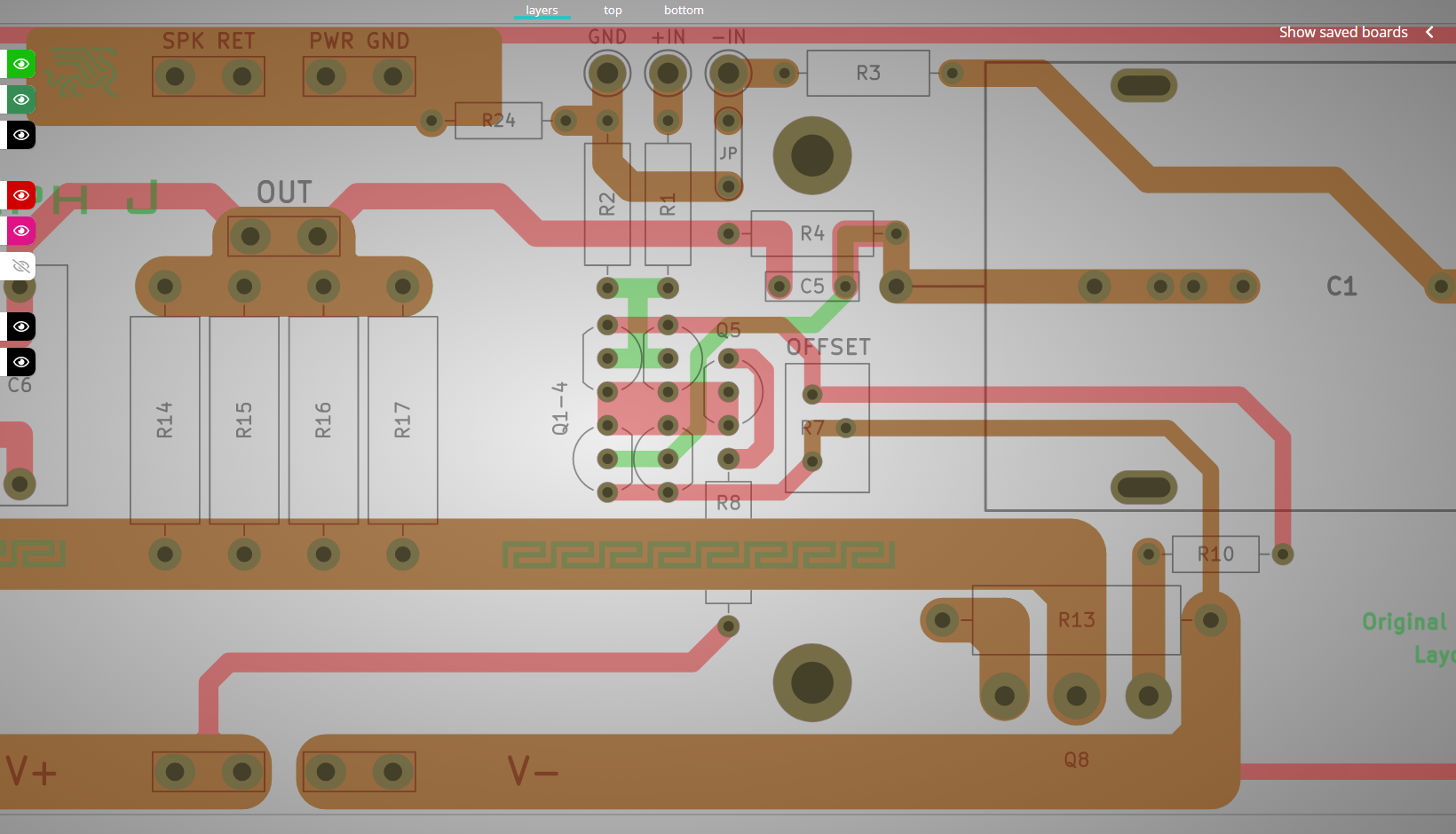

What do you think if I add JFET cascode to input JFET CCS like in the article?
I also looked what everyone tryed as JFET cascode to 2SK170 and.. Patrick also suggested J111 since about year 2008. 🙂

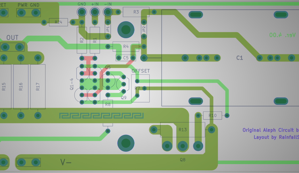

Here is a concept layout.
It may look strange right now.
R8 is a jumper/zero Ohm resistor in this one.

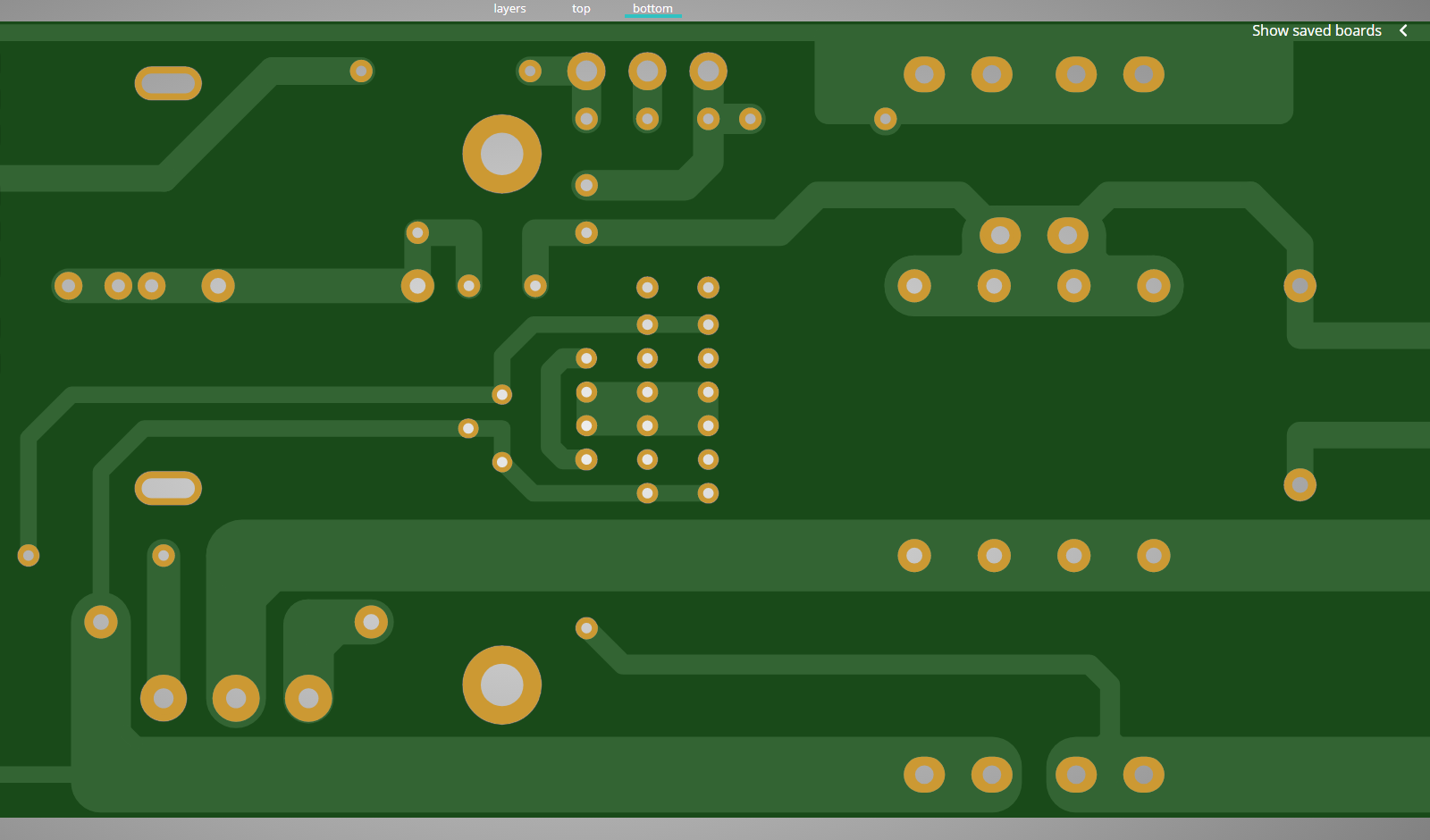

I am not sure if such long traces, allocated to input signal routing to the JEFT's, are going to pose any risk with regard to possible oscillations...? I haven't checked what the input impedance of your design (schematics) is neither...
It is very hard to know if the input section of the PCB will cause any instability due to layout; sometimes even the completely surrounded traces, with a ground fill, could cause issues. I suppose the best is to try and see..???
......quite a nice babelfish if I do say so 🙂
all of them are, by default
I'm ZM
At first I did not understand what you meant.
Then I imagine JP2 shorted and saw a very very long trace.
Well.. maybe not such a good idea.
