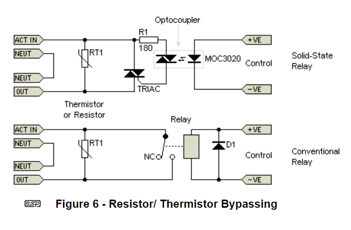

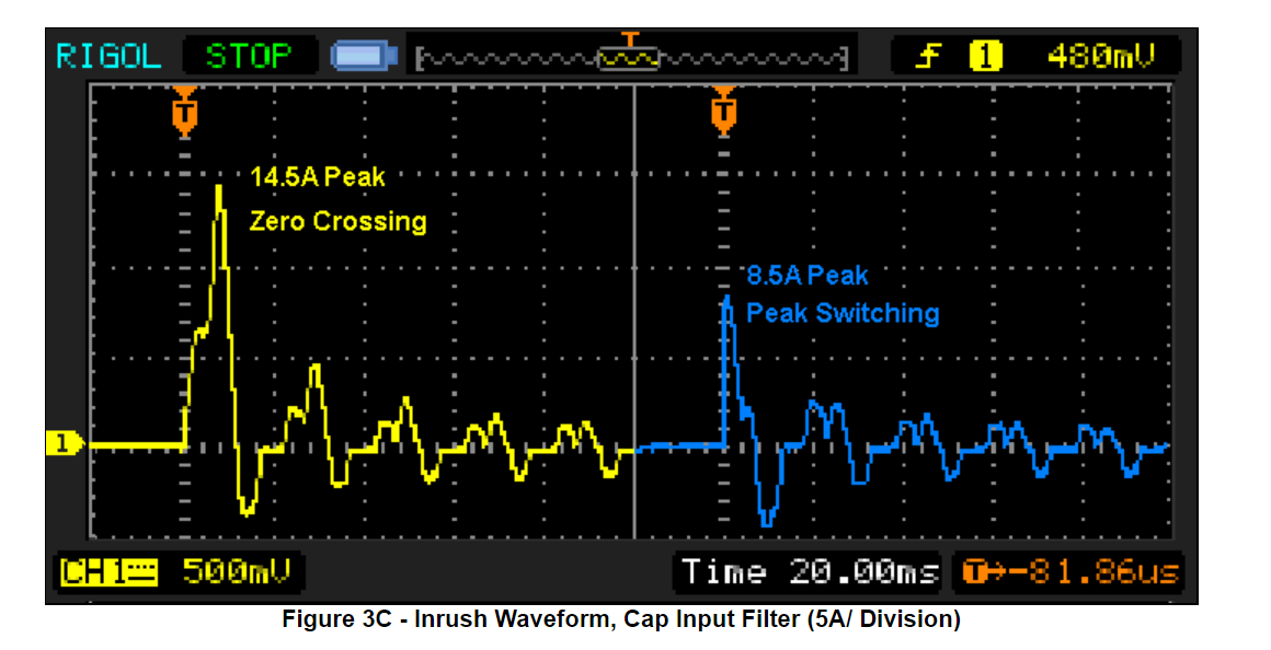

Rod Elliott's web page contains an actual oscilloscope photo of inrush current. When driving an inductive load such as the primary of a power transformer, "ELI the ICE man" prevails, just as they taught you in your university EE curriculum: the peak of the sinusoidal current corresponds to zero sinusoidal voltage. "Switch at the voltage zero crossing" is therefore the worst case scenario, and that's why Rod Elliott runs his tests & captures his scope traces with on/off at voltage zero crossings [yellow trace]. The much less difficult scenario, switching at the voltage peak, results in considerably lower inrush current [blue trace].
If you read the entire page (link), you'll find that Rod recommends bypassing the inrush current limiter a few seconds after turn on, figure 2 below. Other authors do not use or recommend bypass, perhaps most notably Nelson Pass's Class A First Watt amplifiers, many of which are sold as bare PCBs in the diyAudio store.

Triac? Semiconductors are rumored to be more reliable than electromechanical machinery: Rod Elliott Figure 6, top half. Rod doesn't care whether you use an NTC inrush current limiting thermistor, or just a big fat resistor, for the turn-on inrush.

Hi Mark,I only bypass fixed resistors with a relay. I don't bypass the surge resistors, but it might be nicer to do so.-Chris

You know what? You want the surge resistor to burn open if the relay or triac doesn't engage. The condition this is true for is shorted rectifier or outputs. This condition drops the supply rails and allows a replay to drop out. At this point you do want the surge resistor to open.
It sounds counter-intuitive. I thought so at first, but after servicing many amplifiers with burned out surge resistors, I noticed that the open resistor saved most amplifiers from more serious damage.
