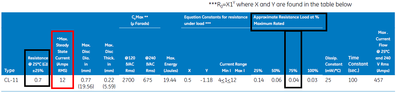

I have a feeling it's more likely you will want the DigiKey part number 495-76103-6-ND.
Its max steady state current is 1.3 amperes which, I'm guessing, is just a wee bit more than your amp draws when playing LOUD music into inefficient (low sensitivity) speakers: the worst case.
Its resistance when hot is about 1 ohm (datasheet page 4), so the voltage across the NTC ICL in steady state is (1ohm * 1.3amp) = 1.3 volts, which is about 1% of your 120VAC mains. You're not squandering huge amounts of additional power just to keep the ICL hot.
Its resistance when cold (25C) is 33 ohms, so you get a very nice 33-to-1 ratio of cold resistance to hot resistance. Even if the entire remainder of the primary circuit acts as a completely perfect dead-short at power on, the cold ICL means primary inrush current is less than 4 amps. Nice.

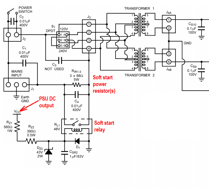

OP here. I appreciate the responses; lots of interesting discussion so far. For what it’s worth, the two amps in question are an Adcom 555II and a home built Leach SuperAmp. I used 1/2kv isolation transformers in the Leach and lots of filter capacitance. It’s a beast and provides plenty of juice for the sub. Each amp dims the lights upon turn on and I want to improve this before trying to power them on at the same time.
With respect to controlling startup current, there seems to be no real consensus here. Some of you are fine with a properly sized NTC ICL by itself, others recommend the NTC coupled with a relay, and then there is the Cadillac solution: the soft start circuit. I would be fine building a couple of these if I knew this was the best and most reliable approach, but I haven’t seen a lot of people supporting the notion so far.

In my opinion an NTC inrush current limiter is a soft start circuit.
Another type of soft start circuit is advocated in Douglas Self's power amp book, and discussed thoroughly in National Semiconductor Application Note AN-1849. It puts a high wattage power resistor in series with the transformer primary for the first several hundred milliseconds after power-up, then shorts out the resistor with a relay. NSC's scheme is shown below.
NSC drives the relay from the output (secondary side) of the transformer. Others prefer to drive the relay from the input (primary side) of the transformer.

NTCs are rude and crude, but give them some breathing room and a little goes a long way. (Doesn't too much R in the primary show up in the amp's output Z?)
If you were going to use a relay, you wouldn't use an NTC, you would use a fat resistor. I have some timer relays for when I go really big PS and actually need it, but for now, KISS.
Sniff around in that 555II and you might just find one already.

Diego Mike, if you are going to use an NTC then imho you need to try and competently size and install the NTC. As well as allowing an AC mains feed switch/circuit-breaker to better cope with all your equipment being turned on at once, the appropriate application of NTC's could allow the mains side fuse of each amp to be 'minimised' if it was initially over-rated to cope with the in-rush.
Sizing info is given in the NTC datasheets. One key sizing aspect is the in-rush joule rating of the NTC. Typically a datasheet provides an in-rush joule rating, or you need to calculate that from the generic use where mains AC voltage is rectified and directly charges a max capacitance level. You then need to assess the inrush joule heating through the NTC so as not to exceed its joule heating capability.
You appear to have two main in-rush contributors - the transformer primary winding, and the secondary side filter caps.

If the worst case scenario gives an unrealistically high inrush then it could lead to choosing the wrong NTC or using an NTC when one is not needed. Perhaps an alternative worst case is to use the primary leakage inductance and assume turn on at zero crossing - see how that compares.CharlieLaub said:I think that a worst case scenario is what you get when you only take into account the primary resistance, and turn on at the peak of the mains AC waveform. If you cover that case, you can rest assured that the turn on will be controlled for all conditions.
