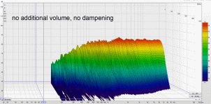

.. and here come the SPL measurements, done on a 100/50 cm baffle.
the "flush mounted" version could probably be far better, this was just a quick and rough first try, see picture!
conclusions for now:
"helmholtz-resonator" version does not work.
lowering Fs did work.
THD measurements still to be done.
I will also try other dampening experiments.
further optimizations could include a waveguide.

by the way, the original tweeters did not have any dampening material below the dome. just plain iron ...
Kind of surprised there wasn't any damping on the pole piece. Seas usually uses synthetic foam on top of the pole. It doesn't work that well compared to wool, which is what i found works best. Just donr let it touch the dome or obstruct the VC gap.
so i just installed and used REW for the first time and was suprised how easy i could get my first results!
all measurements on baffle 50/100, mic about 40 cm distance, SPL should roughly be correct. all versions flush mounted except for 2)
closing of holes was done with modeling clay.
1) hole closed flush with pole piece surface, similar to original state.
2) back hole open and dampened, no flush mounting
3) back hole open and dampened, flush mounted
4) back hole open, no dampening: "helmholtz resonator"
5) pole piece hole closed at back of tweeter (added volume), no dampening
6) pole piece hole closed at back of tweeter (added volume), dampening material in hole
7) pole piece hole closed at back of tweeter (added volume), additional dampening material behind dome, slightly touching dome
SPL and THD (open image for animated GIF):
waterfall (open image for animated GIF):
my conclusions:
  • adding a little back volume to the tweeter obviously extends lower frequency response, but barely noticeable in my case (my drilling hole with 8 mm did just add an estimated 30%).
  • the additional hole however reduces distortion and flattens frequency response generally and specially around 3,5 kHz
  • adding dampening wool in the additional volume further optimizes response and distortion
  • adding even more dampening material that slightly touches the dome raises distortion below resonance frequency.
  • keeping “port” open results in a dip in frequency response and a severe peak in distortion at helmholtz resonance. Generally high distortion.
  • keeping the port open but dampened results in a flat roll-off but in a peak of distortion at helmholtz resonance and below.
  • flush mounting the tweeter (obviously) gives a smoother frequency response above 6 kHz.
  • waterfall diagram shows no relevant changes, besides different FR.
so, would I ever do this again?
Removing dried out ferrofluid and ferrofluid in general: definitely.
Adding dampening material behind dome, if there is none: yes!
drilling the pole piece: maybe with such an old tweeter - i would certainly use a larger max drill diameter, to maximize added volume. And I would not drill through the whole pole piece!
Besides adding volume the main advantage of drilling seems to be removing the flat reflective surface behind the dome.

Can you post the graphs separately instead of a gif? I cant pause the gif to look at each graph properly.
yes, I realized the GIF was not the best solution.
I also realized that it's important not to save one new measurement over a set of measurements in REW 🙁
I just had to repeat measurements for gated SPL graphs.... see attached!
Reactions: Giallograle
