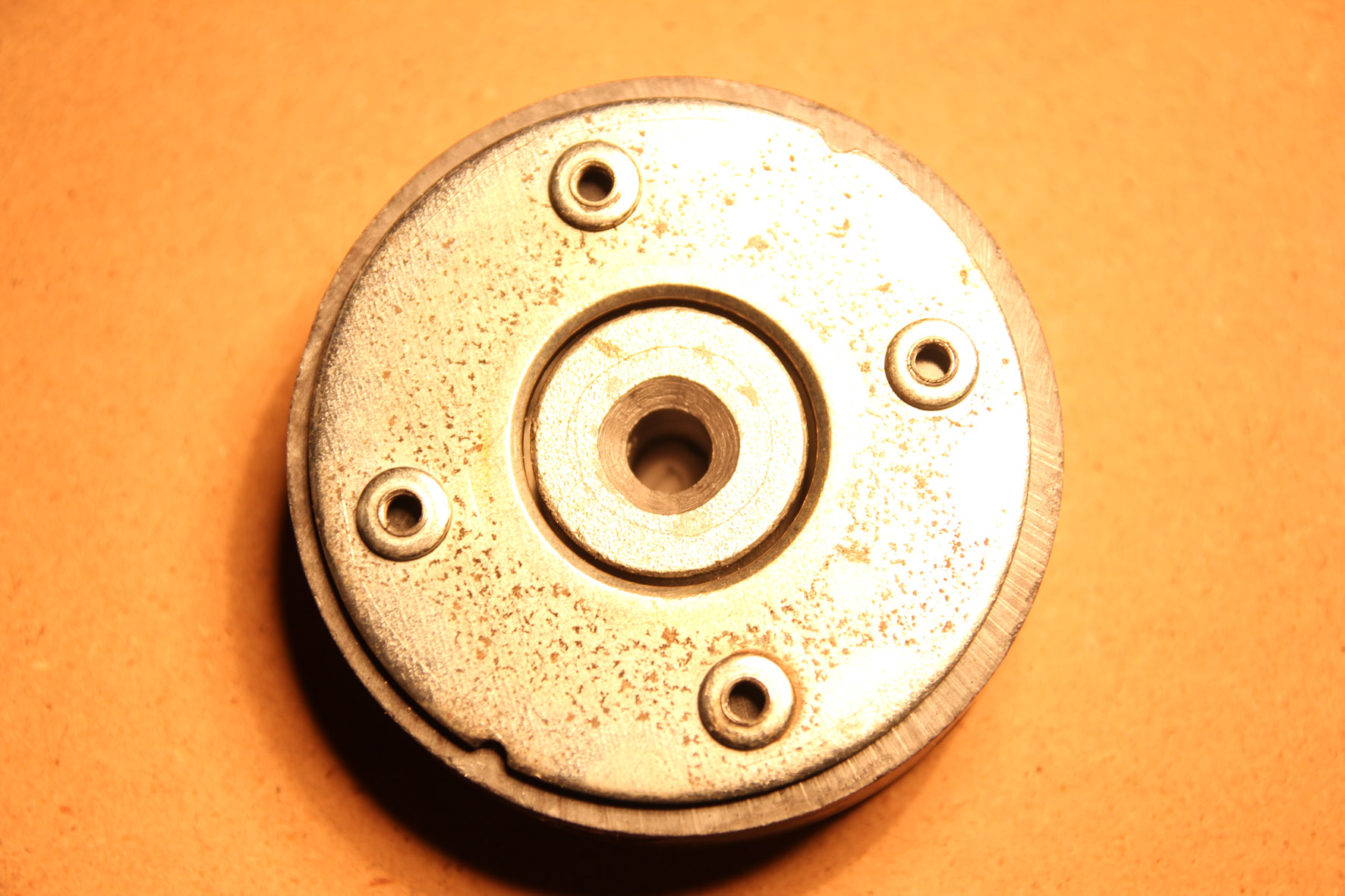

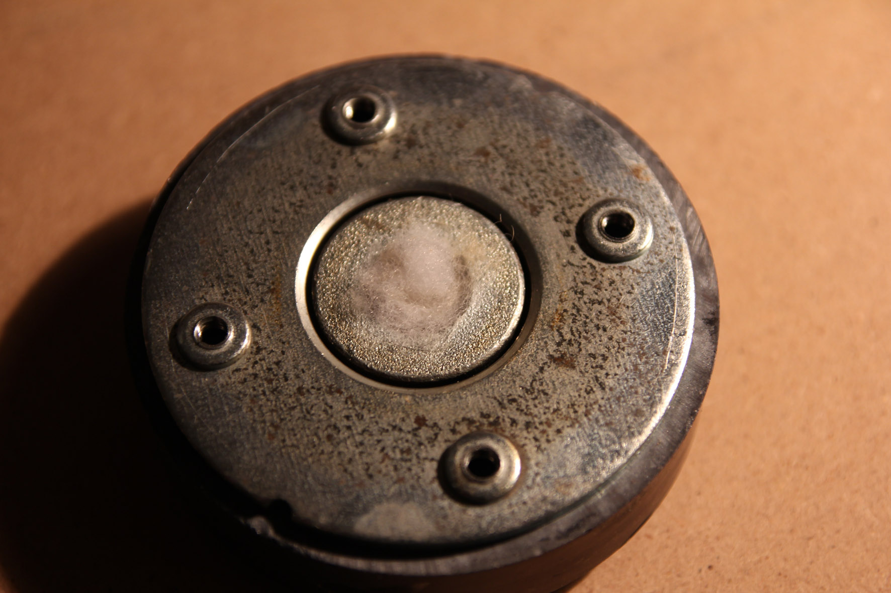

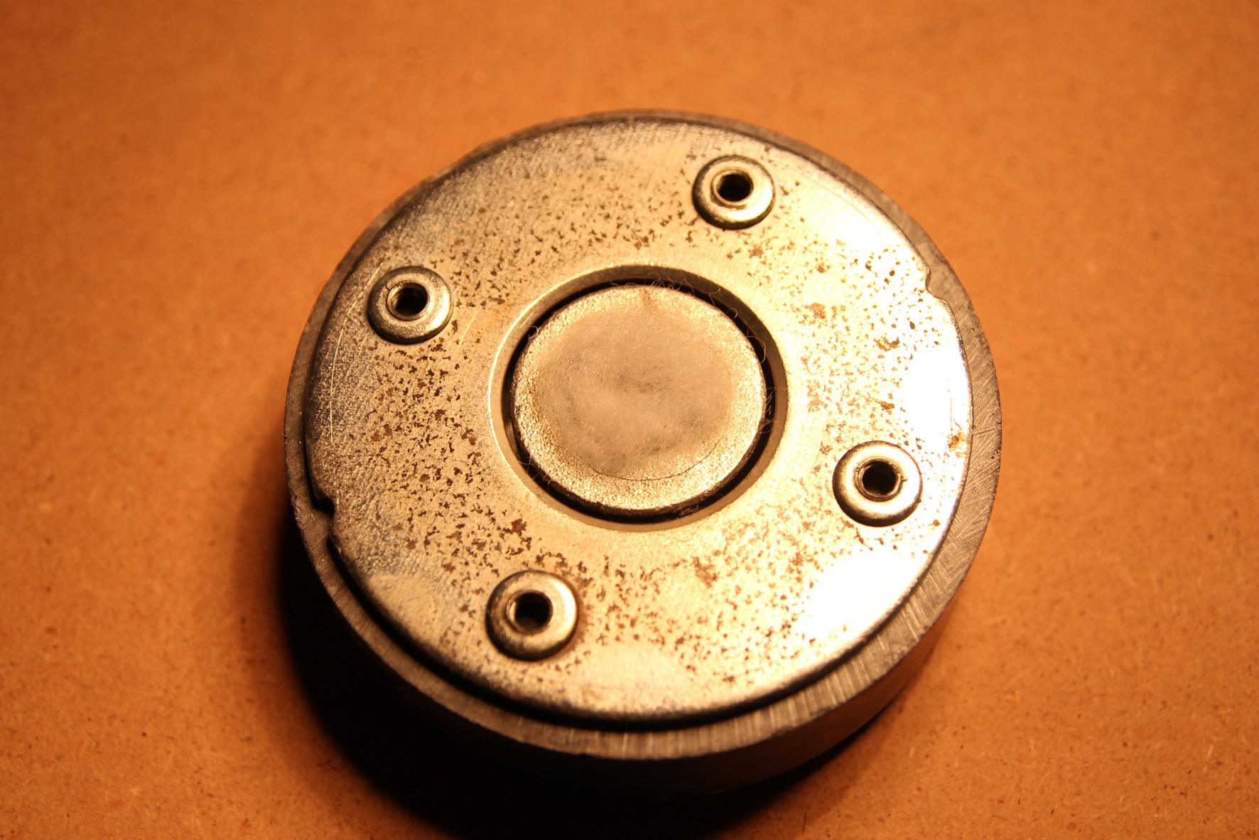

Some parts of those 035ti drivers were made by audax. Not sure who supplied the dome assembly, but the rest of tne motor was audax.I opened a failed dome tweeter from my JBL LSR32 studio monitors and found the pole piece was drilled and filled with what seemed to be a plug of memory foam that seems to fully contact the back of the dome. Those 035TI tweeters have a very flat response and very low distortion.
I can report back with great results and share my technique for magnet disassembly of the most stubborn glue to date. Polk used some sort of Polyurethane glue on these instead of regular Loctite type.
Thanks to George for the tip of not exceeding 180 deg C. to prevent any gauss loss. I brought them up to temp for 20 min.
I just had to lightly tap them with a hammer and punch to dislodge.
I'm hearing smooth, non-fatiguing sound with no sign of resonance at higher volumes on the inexpensive silk domes...

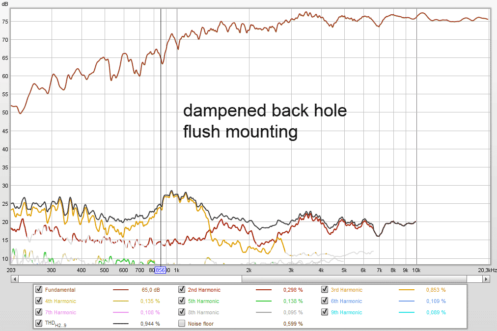

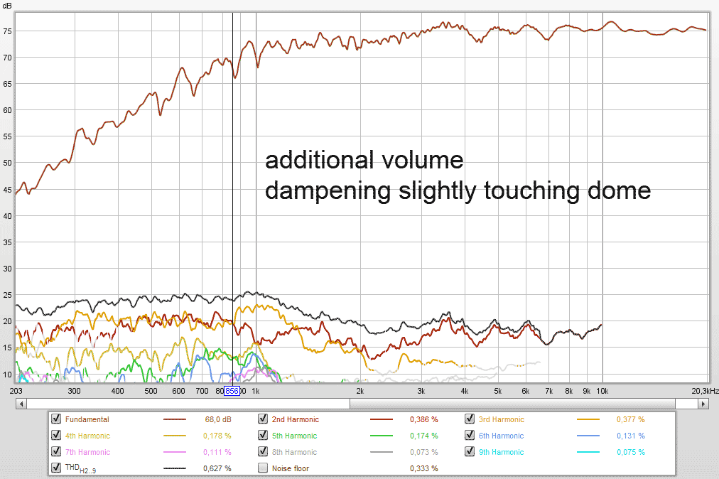

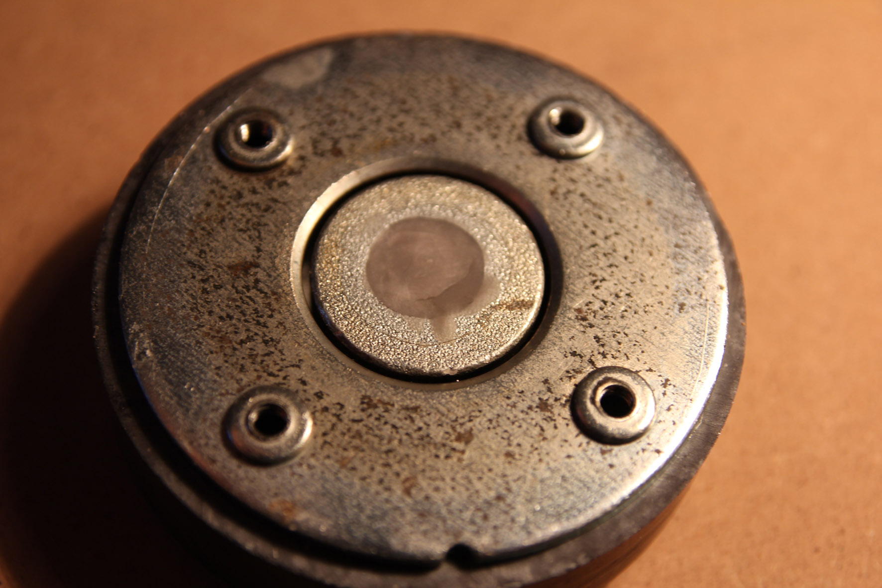

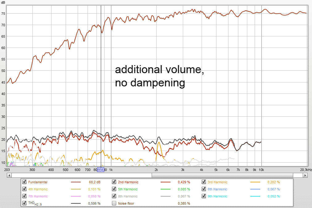

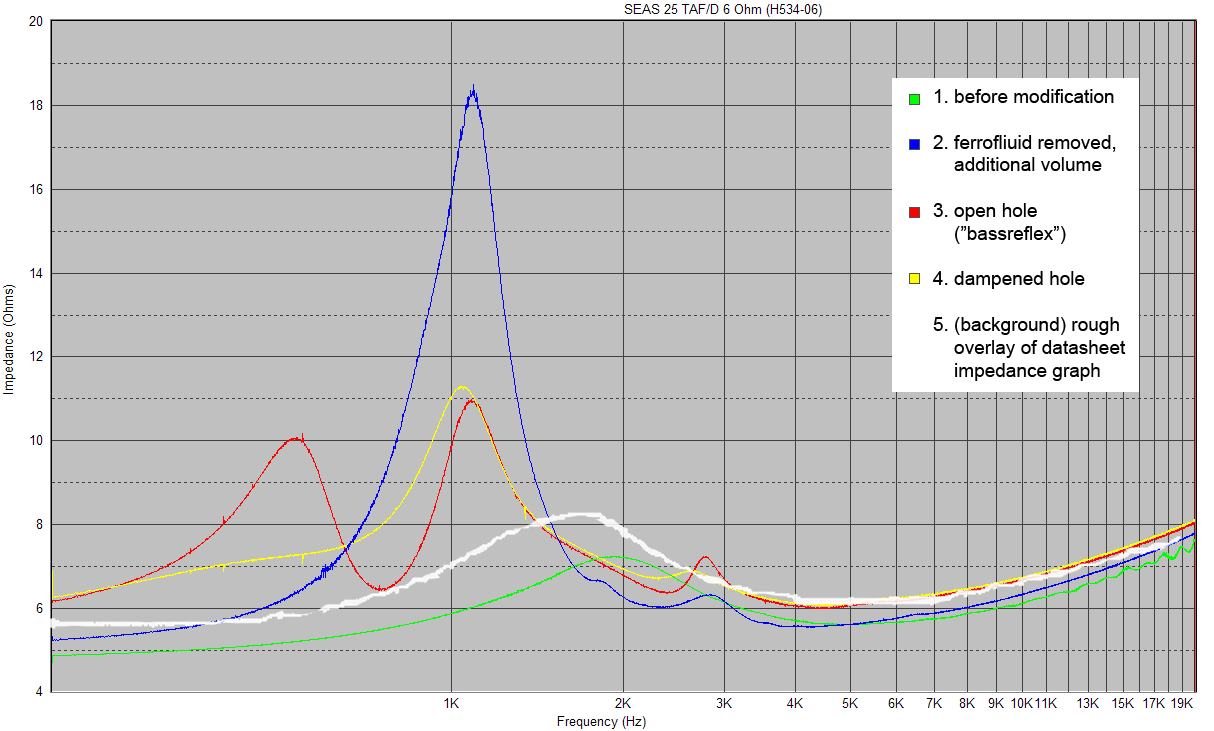

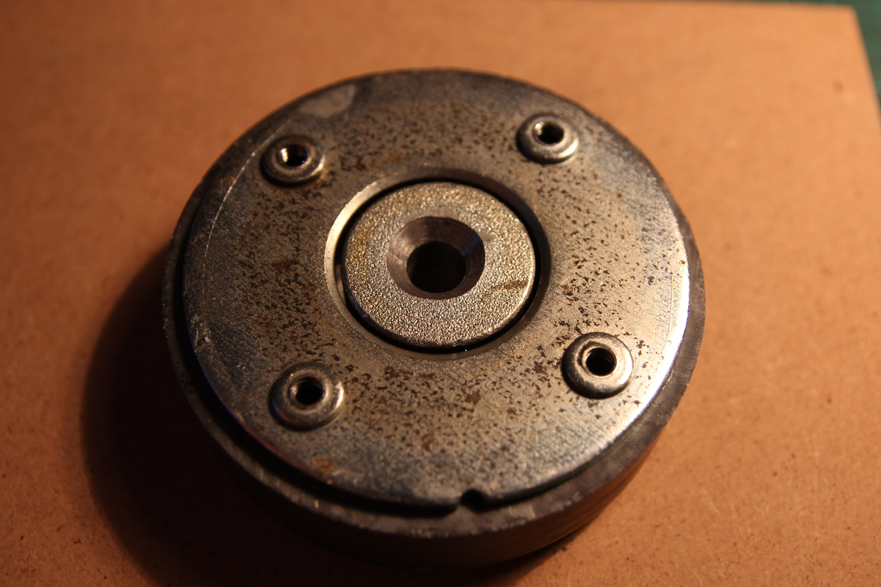

... after a long break:

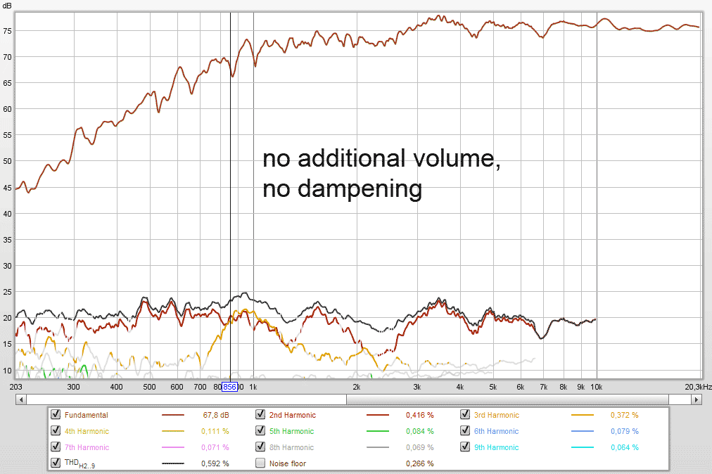

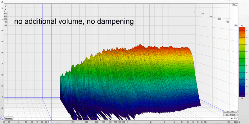

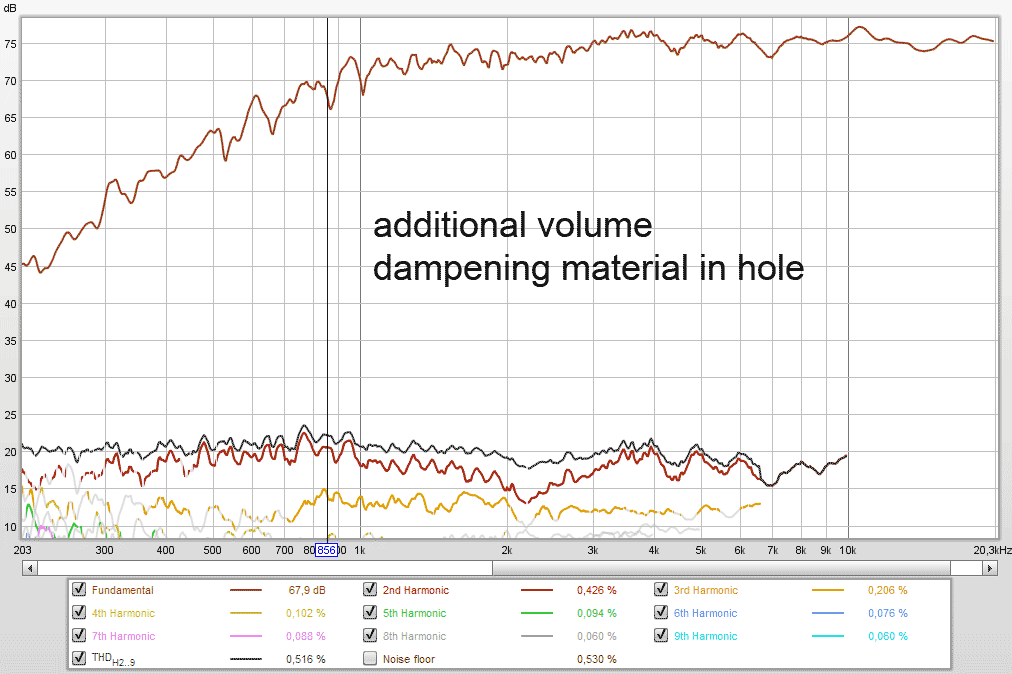

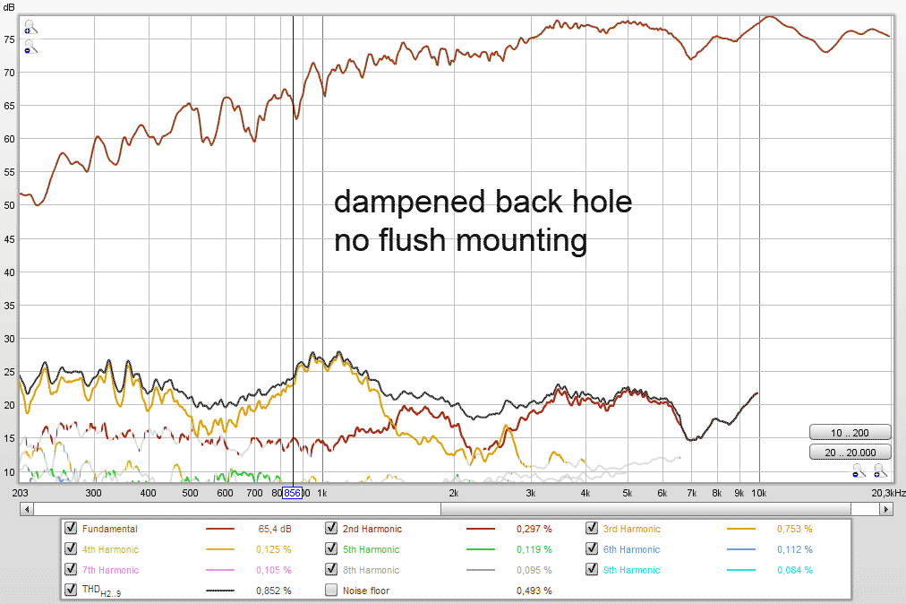

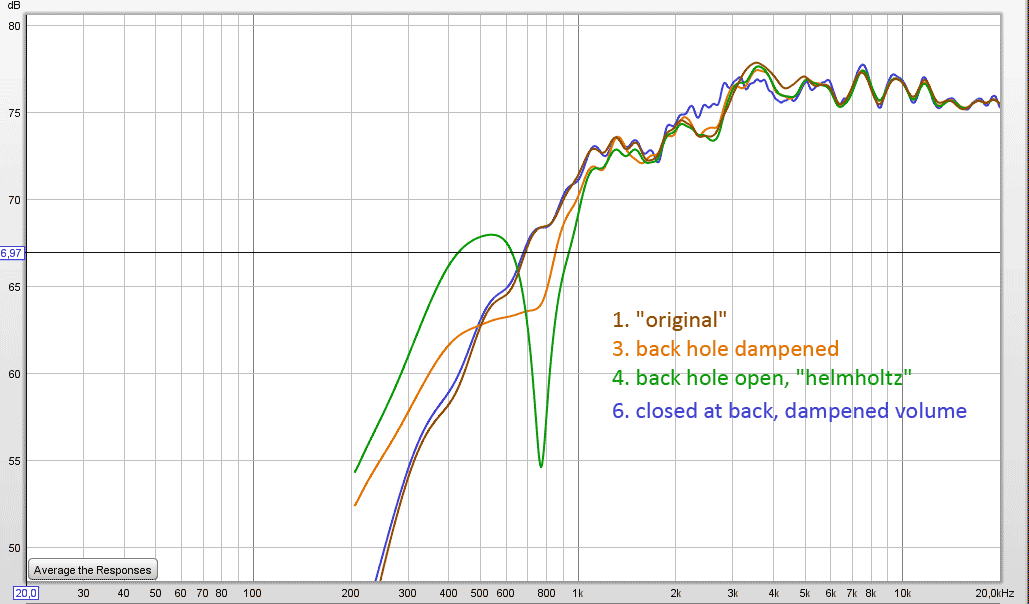

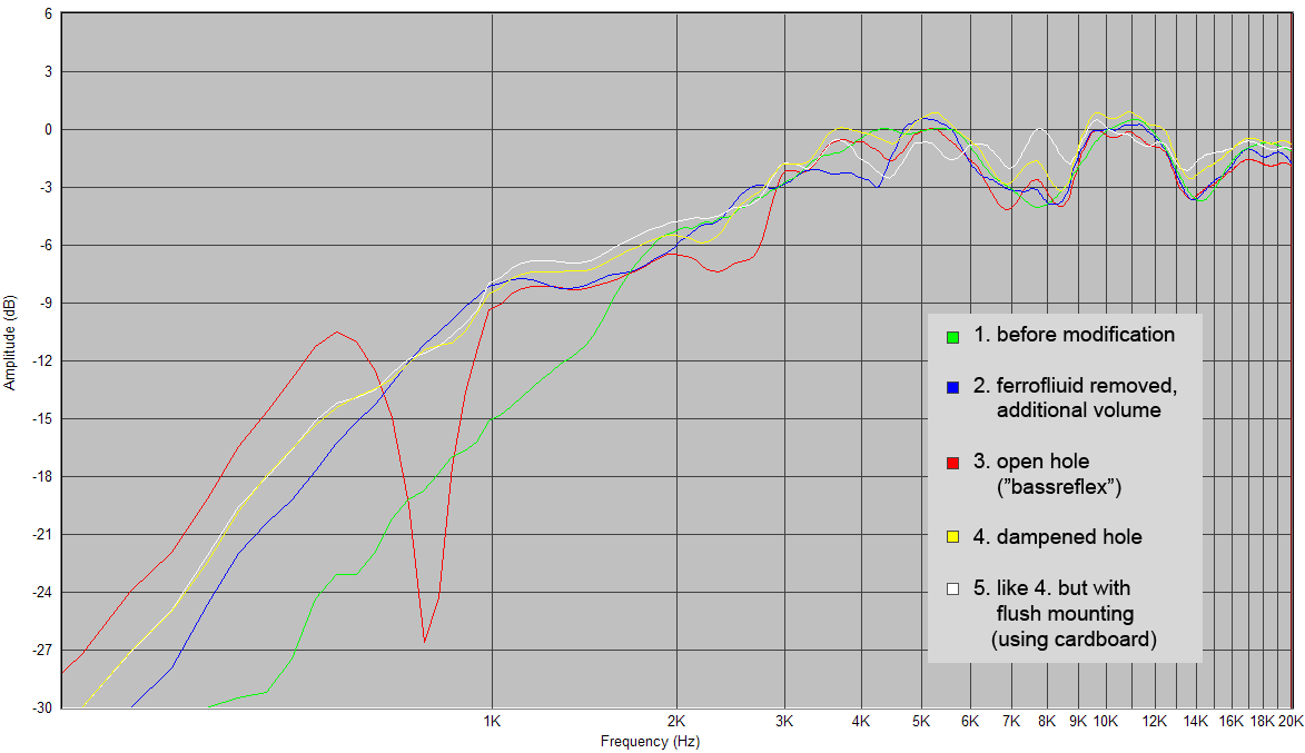

what to do with these tweeters that have a drilled pole piece?
add a 3d printed long (aperiodic) back enclosure, of course!
the graphs are quite self-explaining.
just opening the drilled pole piece hole has a "bass reflex" effect. not very good (mostly for harmonic distorsion).
adding the long back chamber lowers the resonance frequency but introduces resonances, see impedance blips and response wiggles.
filling the long chamber with melamine foam (the magic secret ingredient) removes those resonance effects. it also reduces the resonance frequency peak. the chamber was not stuffed entirely, so the remaining wiggles in the response graph will probably be reduced with added melamine foam.
(response graphs taken on axis with 1 V rms input and 25 cm microphone distance, tweeter mounted not centrally on a flat 50/100 cm baffle)

By the way: the dip of driver output at the tuning frequency of 850 Hz is where the "port" on the back side has it's max output, of course. Still not useful ...just opening the drilled pole piece hole has a "bass reflex" effect.
