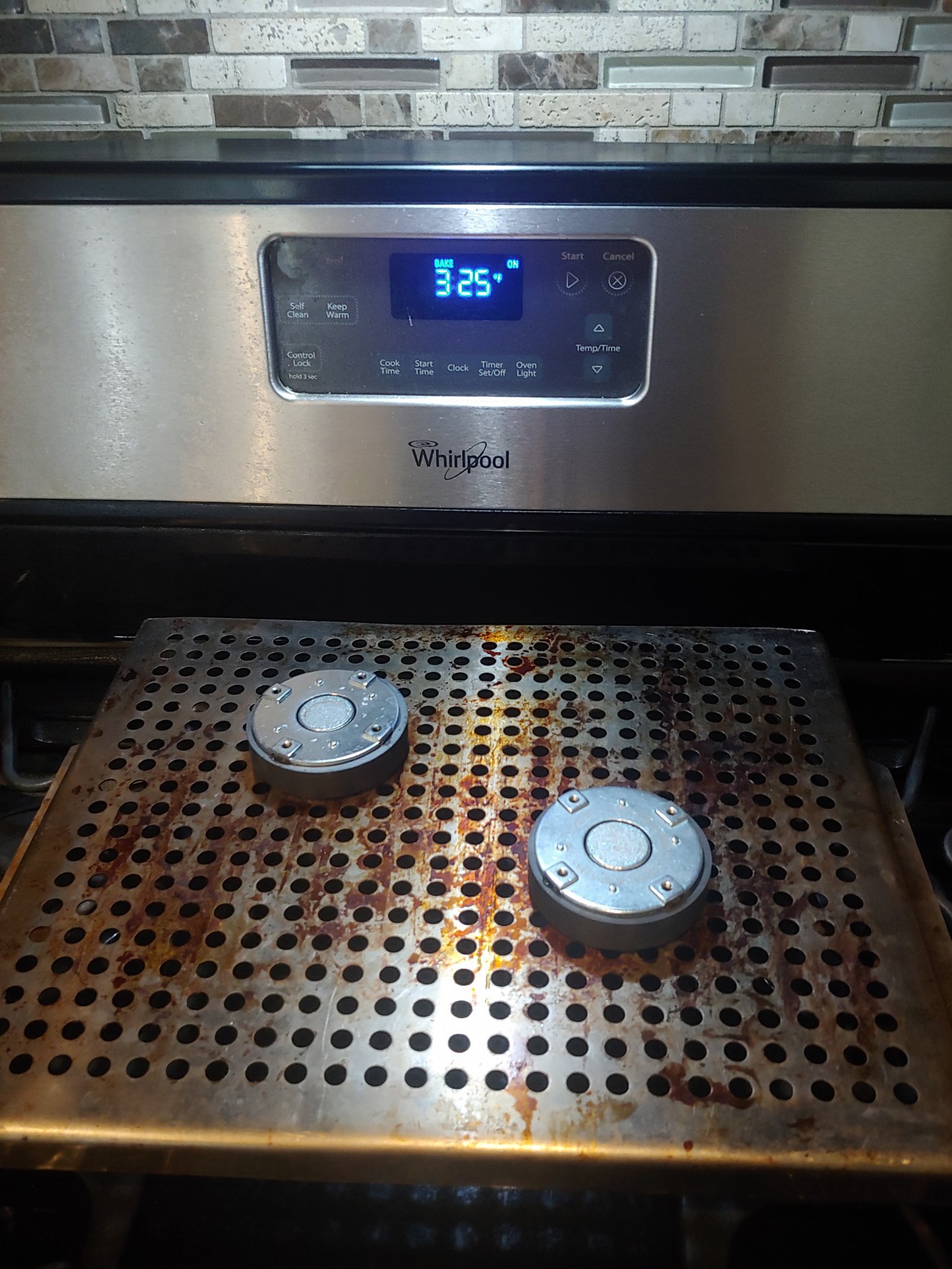

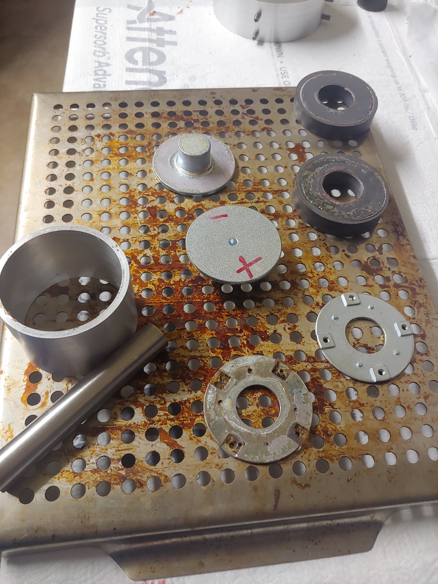

I can report back with great results and share my technique for magnet disassembly of the most stubborn glue to date. Polk used some sort of Polyurethane glue on these instead of regular Loctite type.
Thanks to George for the tip of not exceeding 180 deg C. to prevent any gauss loss. I brought them up to temp for 20 min.
I just had to lightly tap them with a hammer and punch to dislodge.

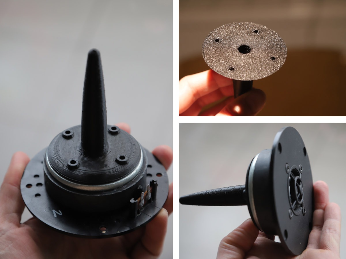

what to do with these tweeters that have a drilled pole piece?
add a 3d printed long (aperiodic) back enclosure, of course!
the graphs are quite self-explaining.
just opening the drilled pole piece hole has a "bass reflex" effect. not very good (mostly for harmonic distorsion).
adding the long back chamber lowers the resonance frequency but introduces resonances, see impedance blips and response wiggles.
filling the long chamber with melamine foam (the magic secret ingredient) removes those resonance effects. it also reduces the resonance frequency peak. the chamber was not stuffed entirely, so the remaining wiggles in the response graph will probably be reduced with added melamine foam.
(response graphs taken on axis with 1 V rms input and 25 cm microphone distance, tweeter mounted not centrally on a flat 50/100 cm baffle)

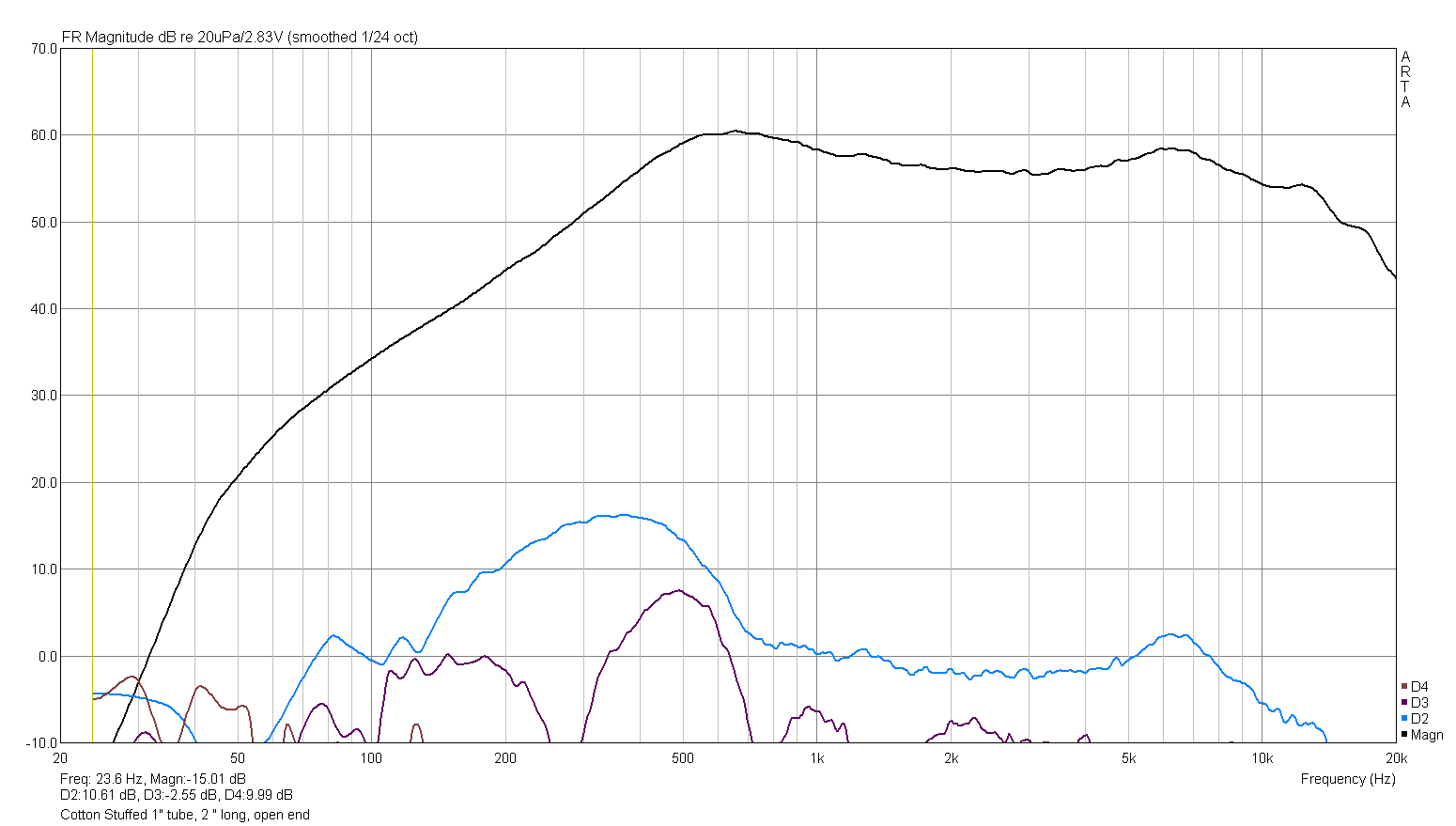

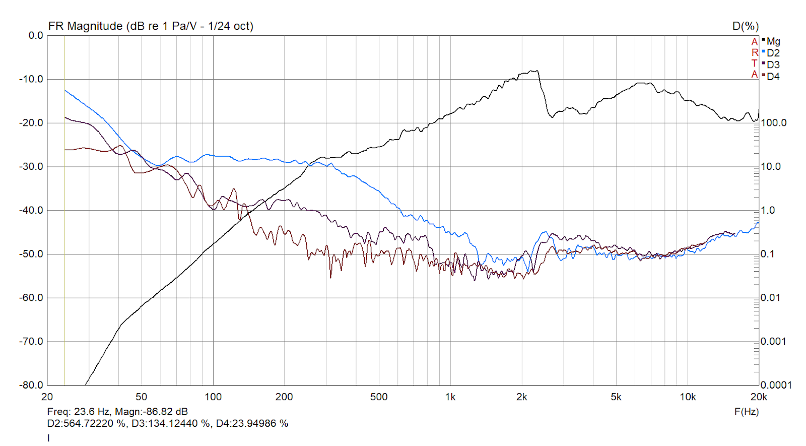

I don't have such nicely organized documentation as STV in the previous post, but I found a few graphs from experiments with PVC pipe.
The driver was close mic'd and not on any baffle.
zGqwZzSShqG_IhNASg_cTuI4iMImdeUAjZvG8Pll-J_8Gw9n_3GUVNlZ7rRDUi4QLTQhr83qDbFFu1q470iDMl90NYfc6oueIszT0Kr0EAj1vtc2enCQ15CoSueihSA9tDXRzmMA44kAG8tWaIYySQ
Figure 1. Aurasound Cougar with empty 1" ID, 2" long PVC pipe attached to rear as enclosure.
Vz--5wqdsZh1CNgEzJmXVQW2YICRFIU1Vy0EAHBmOdLA0F_m4DjrsDRbpg1cuEuakm3pW5A8m6dwUxoTXu2v-gQpuD8nHzrhgbDCFg0N5sZuzFxHCCPVLQAwIv8LRoMuhCFPRuZLxov01nJr8_G85Q
Figure 2. Aurasound Cougar with cotton stuffed 1" ID, 2" long PVC pipe attached to rear as enclosure.
Note that the reflection / resonant peak at 2.3 kHz is gone and the distortion is 55 dB down.
Suu91T6GXbJvWYuGmvPICnfGkGKce8GMNM22Sha2eZHq-Vh9d3myqIwytR_5tVJNfe0DPnbuIJKy9FAE9HfQfQwx-Rnz5joP9nuZqEPkEk0AiWYlw1oSoC5wc16QgK2cRxJkgNQ6ZHJ74spTgJGL28s
Figure 3. Aurasound Cougar 1" full range close mic bare driver with no baffle and no rear enclosure. It measures very poorly this way as it is open baffle, so the rear wave is coming around and the lack of enclosure leaves just a truncated tube behind the dome with reflections.

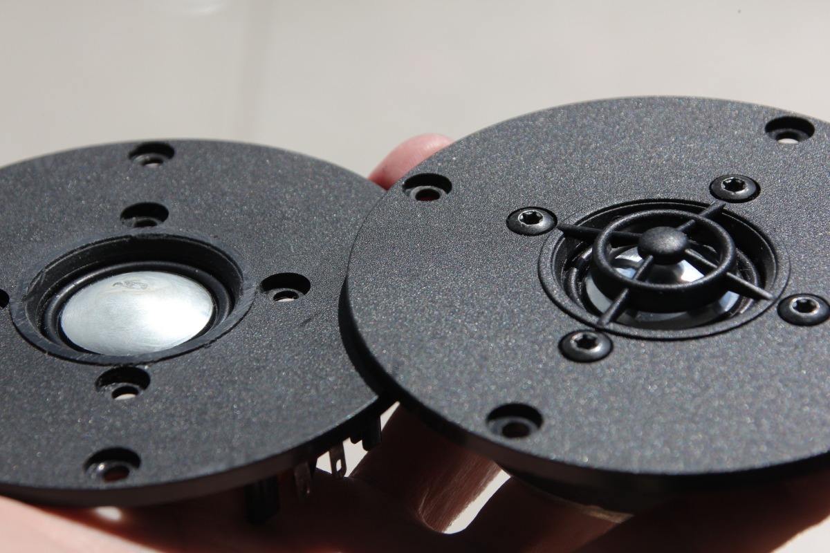

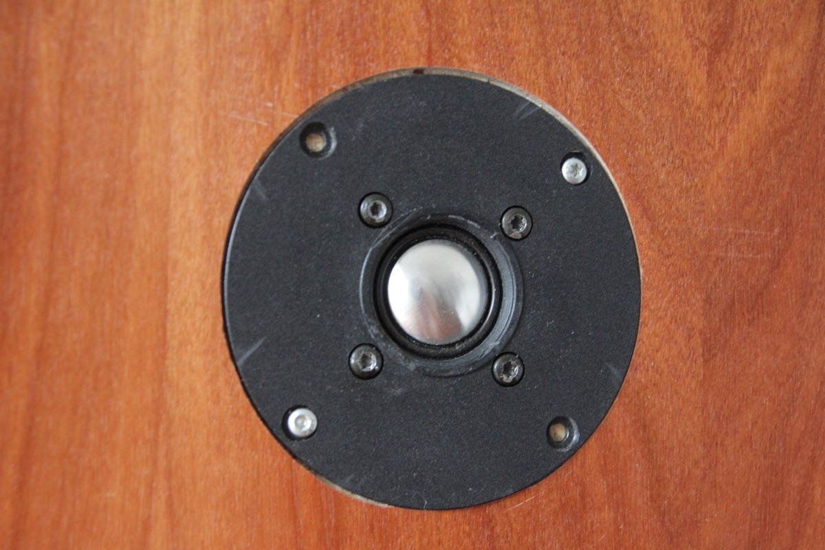

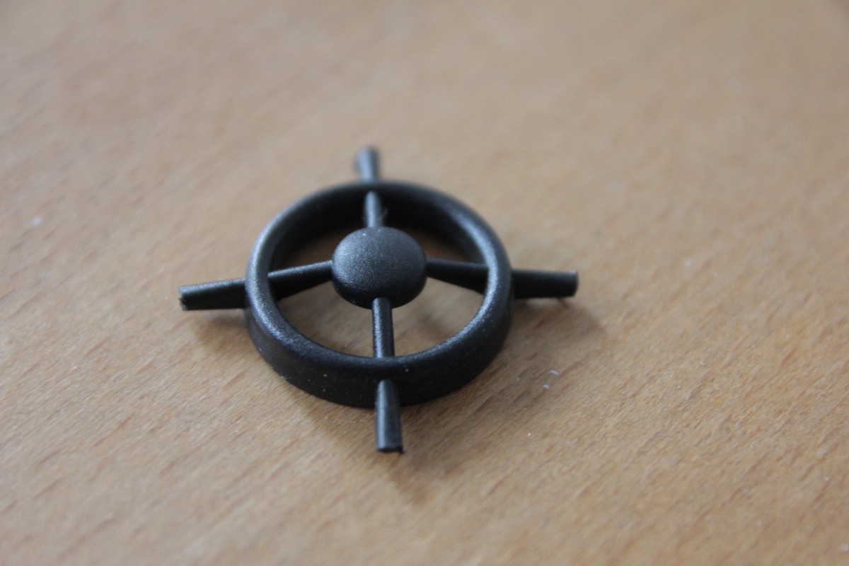

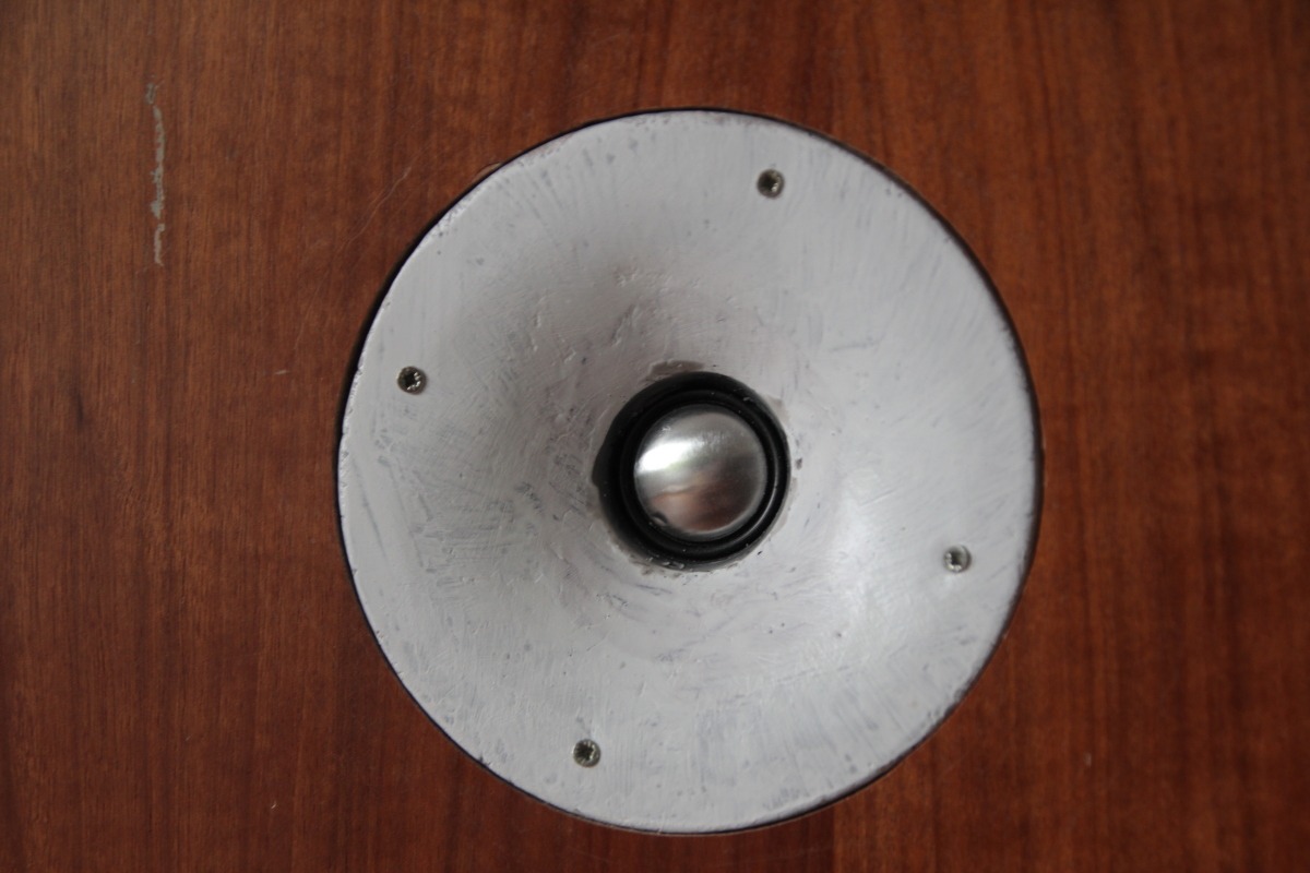

what happens if I (partially or completely) remove the tweeter's phase plug?​

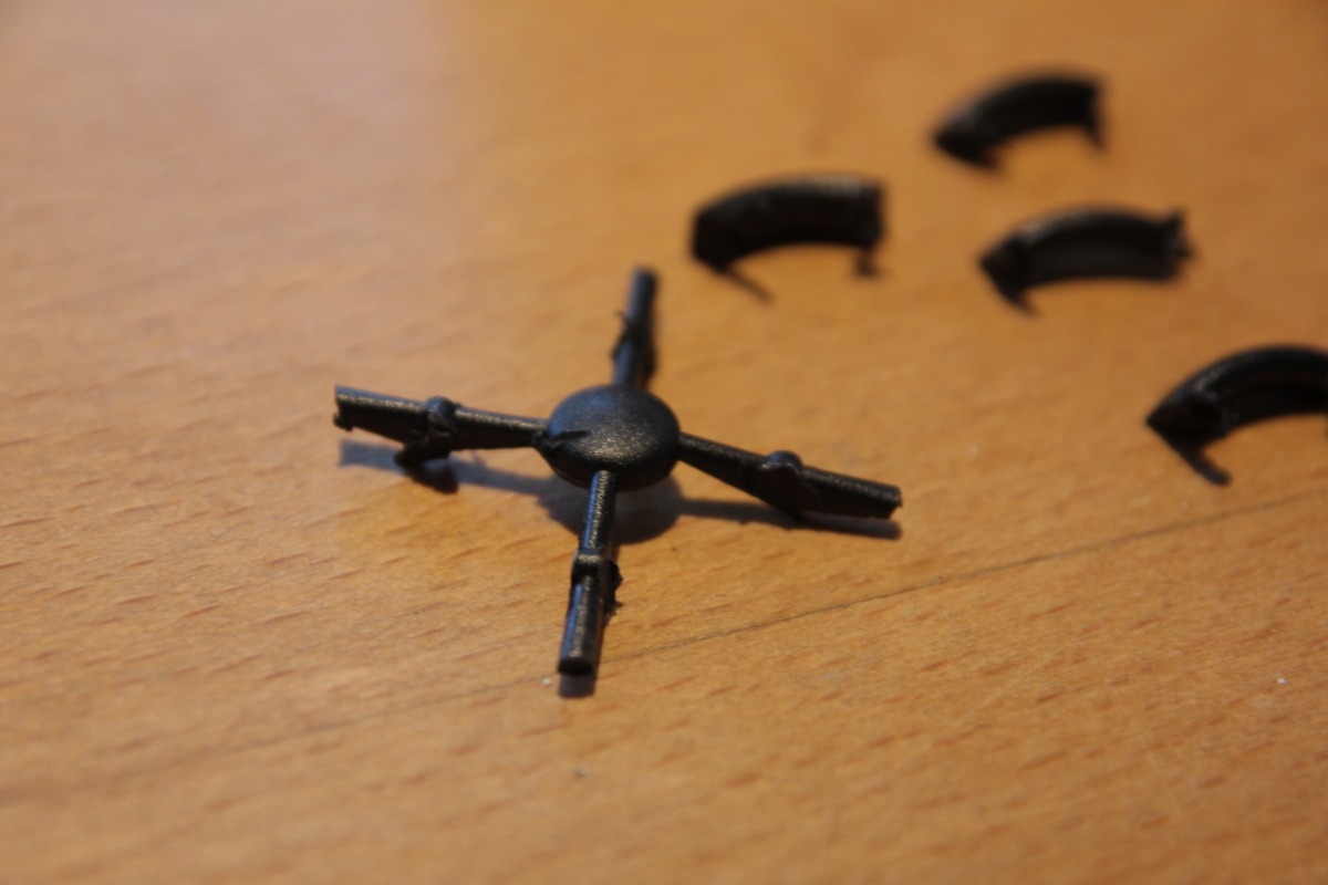

I cut the plastic supports with a small dremel cutting tool:
this exposes the very delicate aluminium dome, the SEAS 25TAF/D dome material is a very soft alloy.
eventual dents can be pushed out from behind, but it's better not to make any!
I removed the outer phase plug ring to also test only the central piece:
tweeter without phase plug, installed flush into a big (100/50 cm) baffle, in a small, handmade (non very optimized) waveguide and in the WG with cenrtal phase plug:

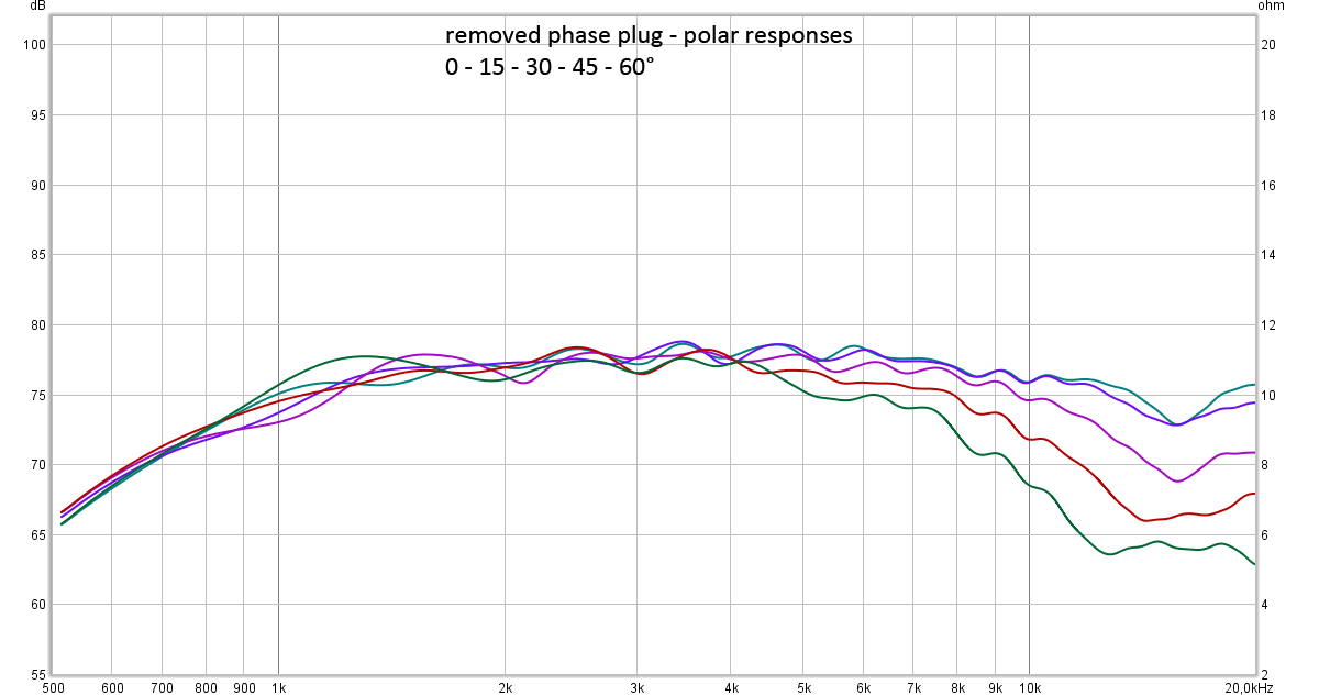

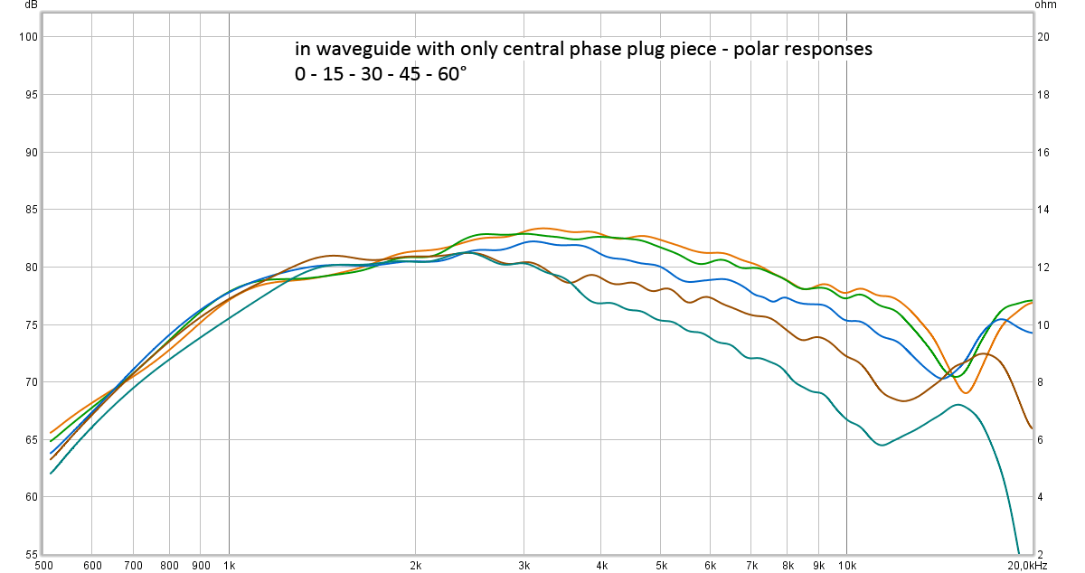

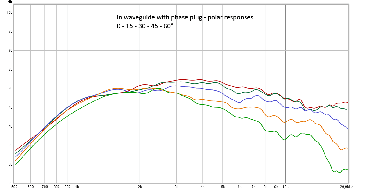

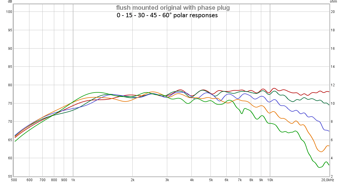

here are the frequency responses (gated, at about 40 cm distance, low voltage - not 2,83 V!):
1) installed flush in the baffle with the original phase plug (not shown in photo) ...
2) .... flush in the baffle without any phase plug construction ...

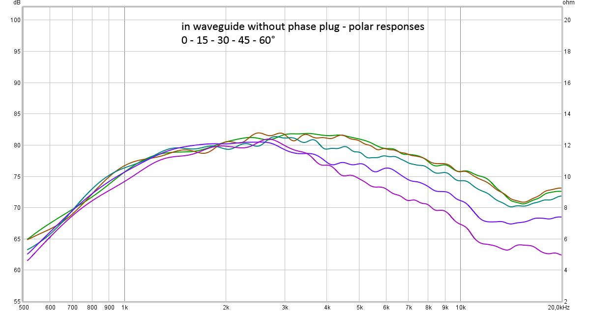

3) .... now in the WG with original phase plug (note that the falling response slope is inherent to uncorrected WG) ...
4) ... in the WG with only the central phase plug (not advisable!) ....
5) ... and in the WG without all phase plug elements:
the last response shows that the non-phase plug version may eventually be better suited for a wave guide, but the WG still needs to be optimized, mostly the transition from dome/surround to the WG shape. covering the surround or making a small step at the WG throat may solve the on-axis dip at 15 kHz.

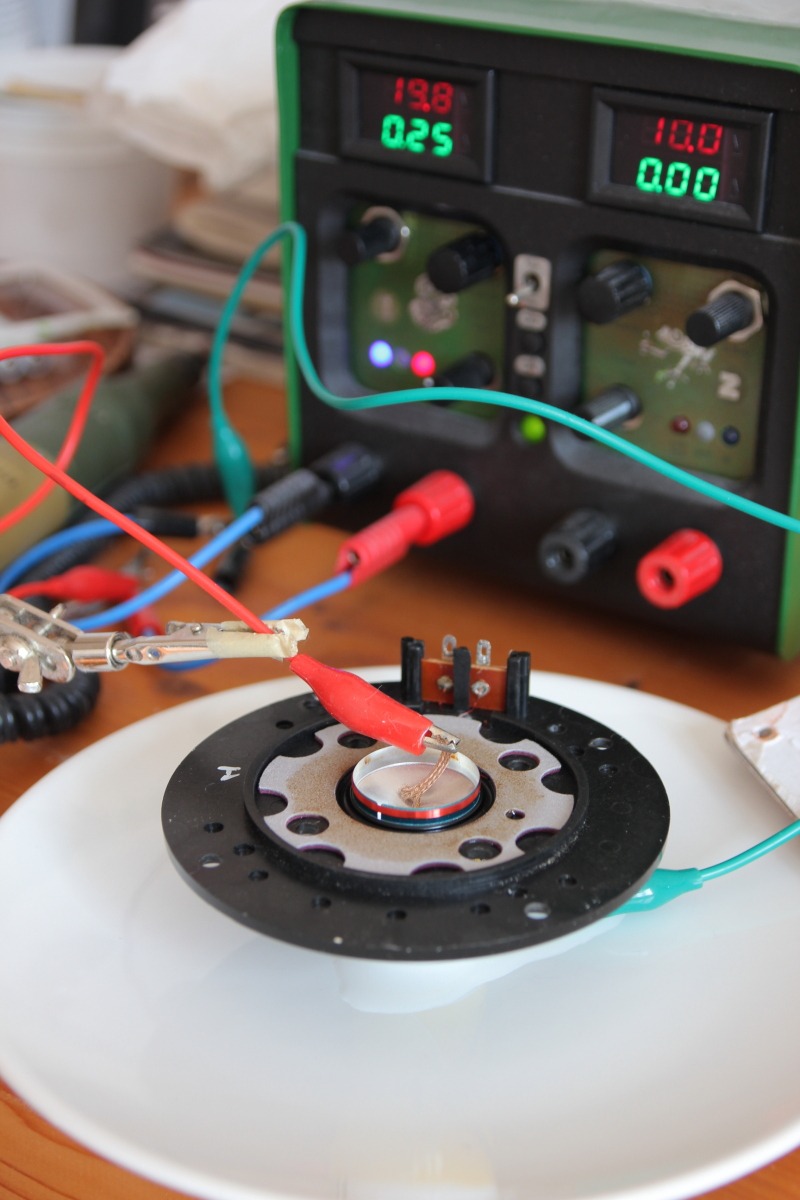

So how to solve this problem in case we don't want to have the protecting phase plug?
Right!!!

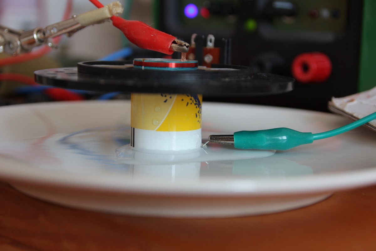

Let's anodise the dome and turn it into a super hard ceramic material (at least the surface)!​
(yes, I know it's crazy, but my curiosity was stronger!)
anodising is not a completely harmless process, so do it at your own risk and do a thorough research.
gloves, safety goggles and a ceramic container ... you know.

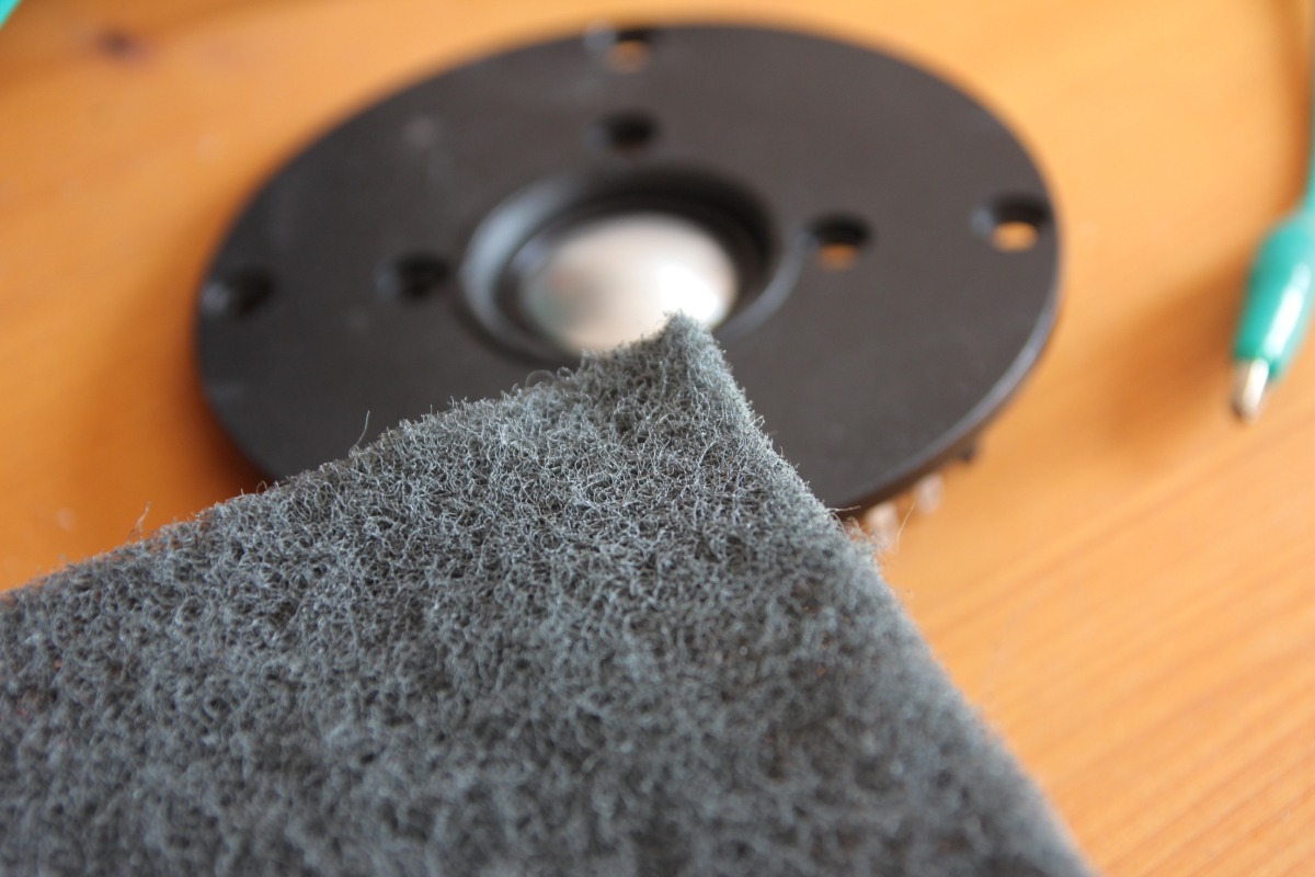

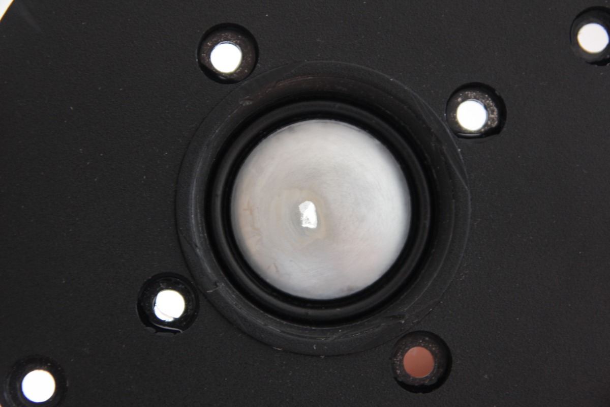

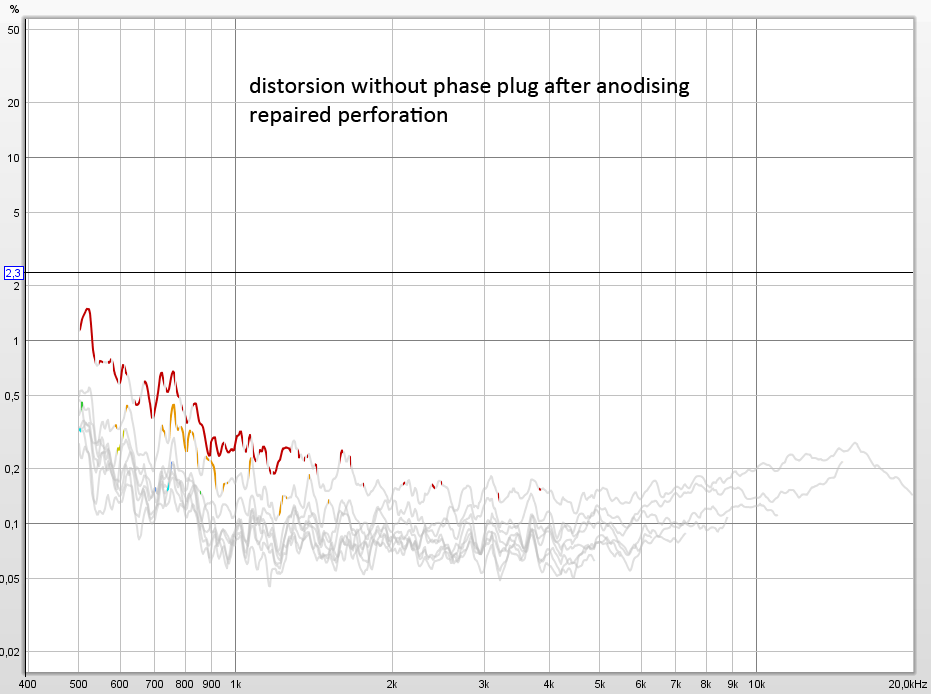

very gently sanding the dome for a smooth surface:
a plastic container just big enough for the dome to dip into a ~15% sulfuric acid (more than 15% is not generally available) and using a lab supply with around 20 - 30 V DC, negative plug connected to a base metal cathode in the acid (piece of soldering wire), positive plug connected to the dome:
I really would not do that again, but if I did, I would turn the whole construction by 180°.
The current flow was not evenly spread over the dome and the transformation from metal to ceramic material was not even at all.
In fact there was a small spot where all the aluminium turned into extremely brittle "transparent aluminium":
this spot disintegrated at the first touch and I had to "repair" it by gluing a small piece of aluminium foil from the back.
But still, the rest of the dome got a matte light grey anodised surface that is in fact quite resistant to scratching.

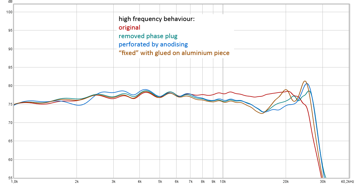

Here are the resulting on-axis response graphs, this time done with high sample rate to capture the ultrasonic effects.
This includes:
  • original dome with complete phase plug element.
  • original dome without phase plug element.
  • anodised and perforated dome withoug phase plug
  • repaired anodised dome without phase plug.
you can see a small perforation effect between 2 and 4 kHz.
the graph also shows that the phase plug reduces the resonance peak at around 26 kHz.
anodising increased that resonance peak - so it seems the guys at SEAS did indeed know what they were doing when chosing the soft low resonance material!
repairing the perforation evened out the audible range, but amplified and lowered the frequency of a second breakup resonance at 20 kHz.
anodising for less delicate elements does work quite well, but it heavily depends on the specific alloy.

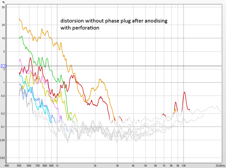

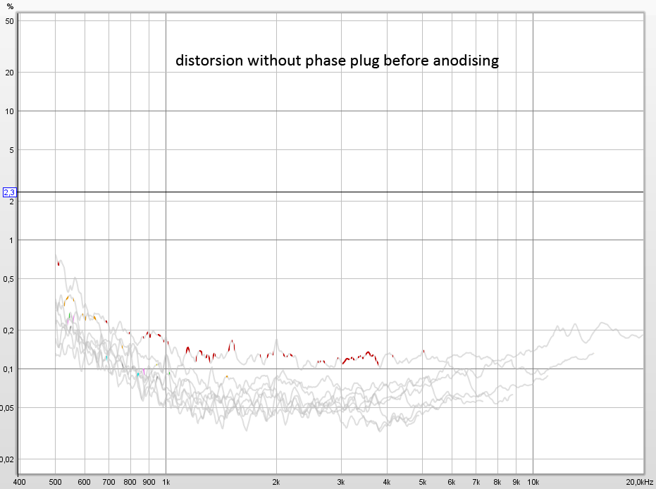

distorsion graphs for the original dome (without phase plug and waveguide), for the perforated "version" and the repaired one.
apologies for the distorsion graphs mostly buried in noise, this is just for comparison!
it was to be epected that the damaged, perforated dome would have lots of distorsion due to uncontrolled edge vibration and maybe even some sort of helmholtz resonance.
but I am quite surprised that my rudimentary repair job worked so well!

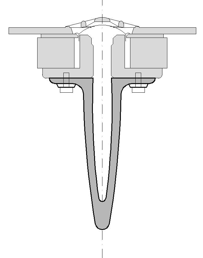

... after a long break:

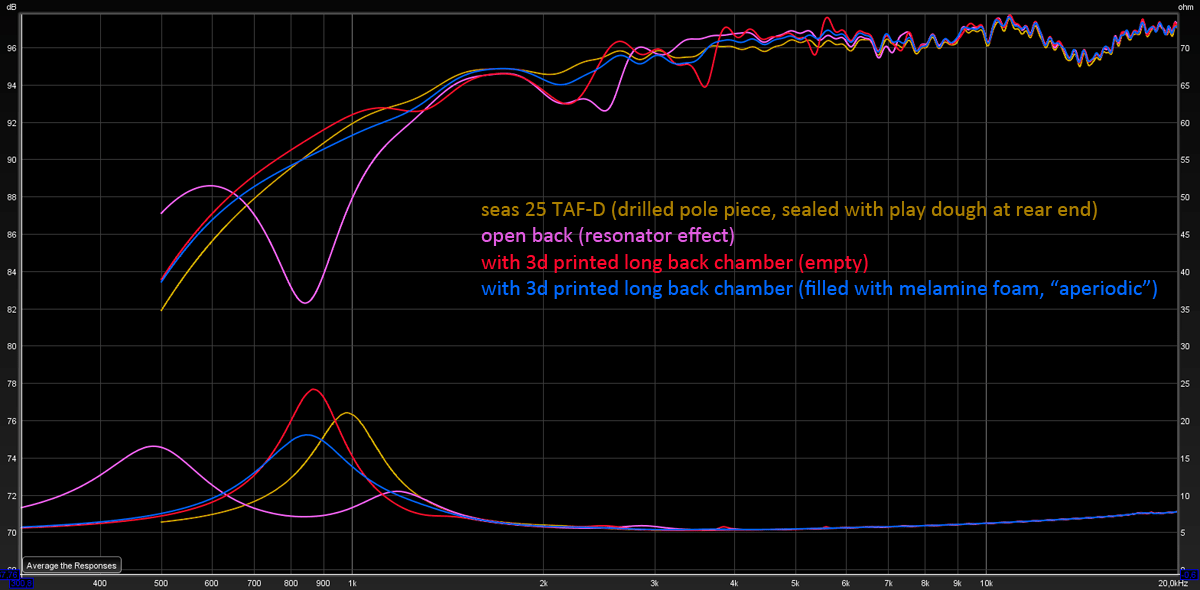

Very nice work/addition of the backwave chamber. How did you come to conclusion/calc of the backwave chamber shape?
I experimented with back-chambering some older Polk tweeters with their factory silk domes and inexpensive aftermarket silk replacements. It indeed cleared/smoothed the cheap aftermarket silks using lamb's wool in the chambers.
no calculation, it was just a shape and dimension that felt right.
I had the pole drilling diameter and wanted to make a slightly curved converging back chamber, considering a potential first resonance to be below potential crossover frequency around 2 kHz.
but anyway the resonance will be mostly absorbed once the back chamber is completely filled with absorbing material.
making the aperiodic absorber tube even longer is probably better.

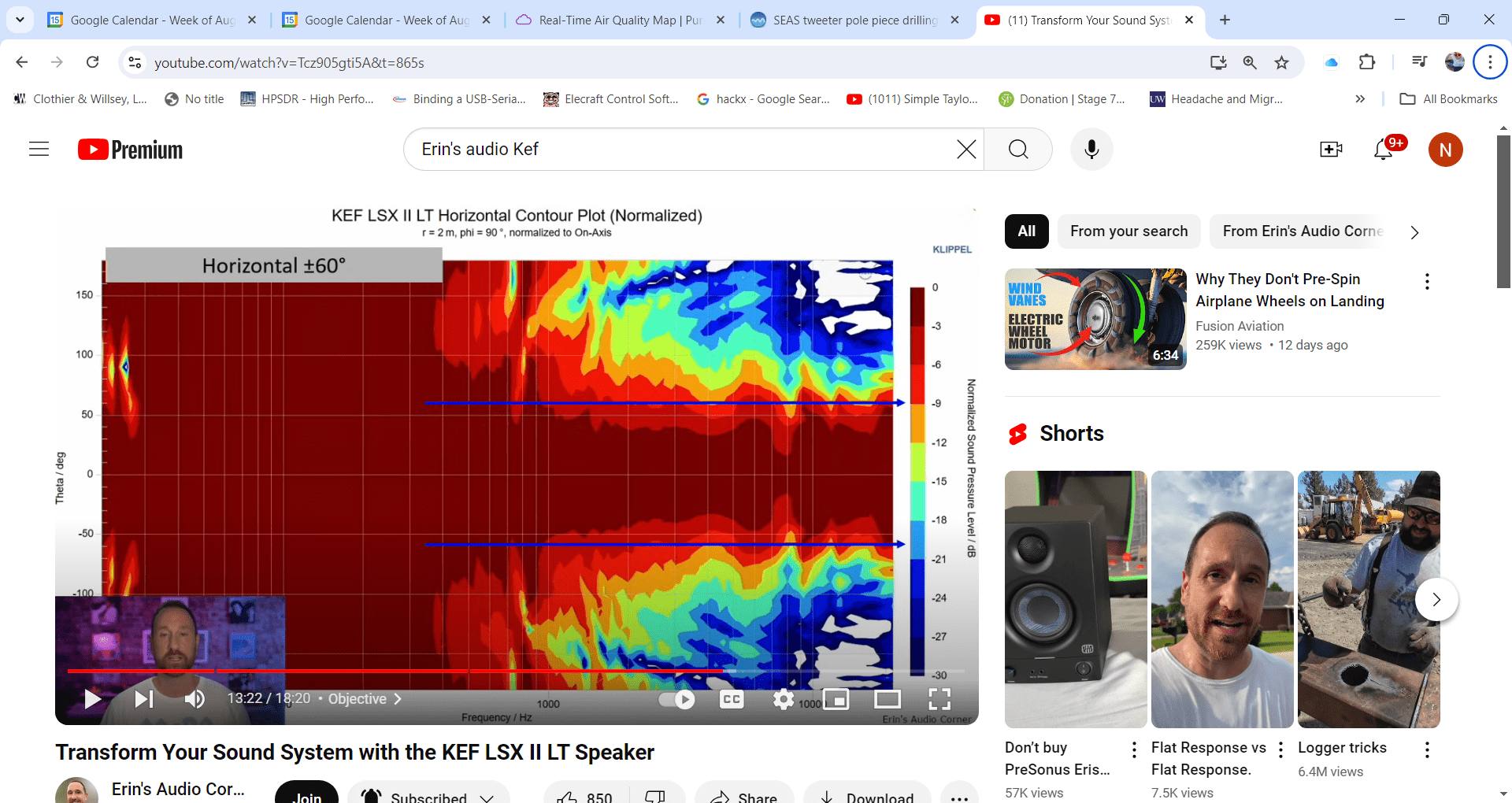

Really great work and documentation. Bummer with the hole in the dome. I have been looking at the five fin phase plug sort of almost a tiny segmented horn that KEF puts in front of their dome tweeter. I assume it is responsible for the very wide dispersion that they get from a 1" dome all the way up to 18 kHz or so according to tests by Erin's Audio Corner youTube channel. I don't recall seeing such a wide high frequency pattern from any other 1" dome. I hope to 3D print and test something like that in the next few months when the weather isn't so nice.
Reactions: stv
