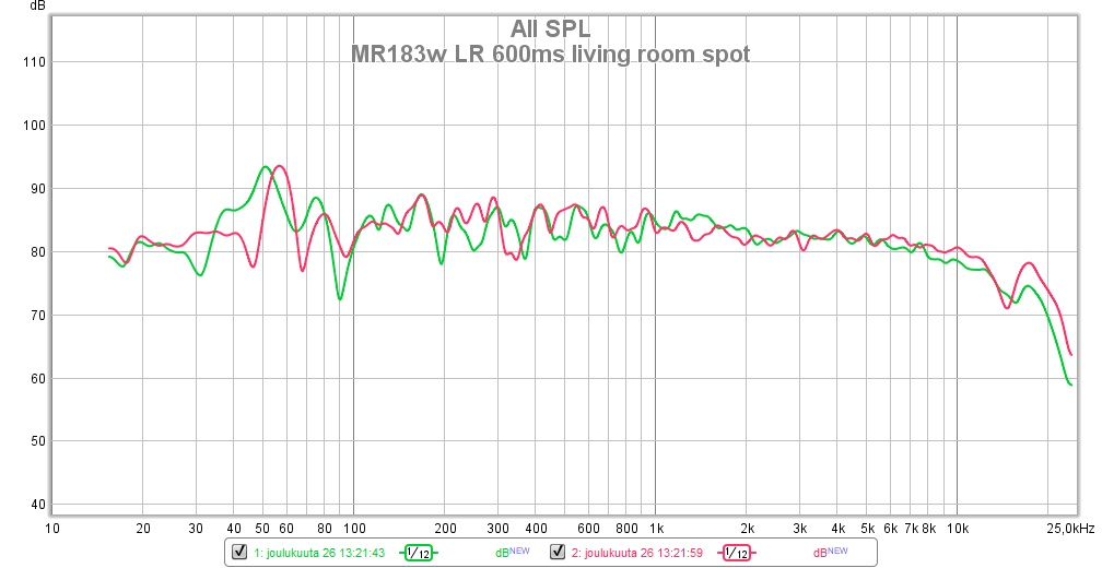

Room response at spot without room-eq
MR183w active by Juhazi - specifications:
W SB Acoustics 29NRX75-6, sealed 40L, downfire
M SEAS MR18REX in 7L aperiodic ball, loose polyfill.
T SEAS T18ACG (replacement) with serial 8.5mH Jantzen Cross-Cap
Hypex FA123 dsp and Ncore 2x125W, 1x100W
-crossovers acoustic LR2 at 300/3000Hz, eq 3 biquads per section, 544us delay for MT section, gain adjust
MT enclosure form 2 IKEA Blanda bowls
W enclosure from Biltema cardboard casting tube, plywood bottom and top plates
-furniture cloth sleeve, 3 furniture legs/speaker
Total BOM for a pair appr. 1600€ (I used second hand drivers)

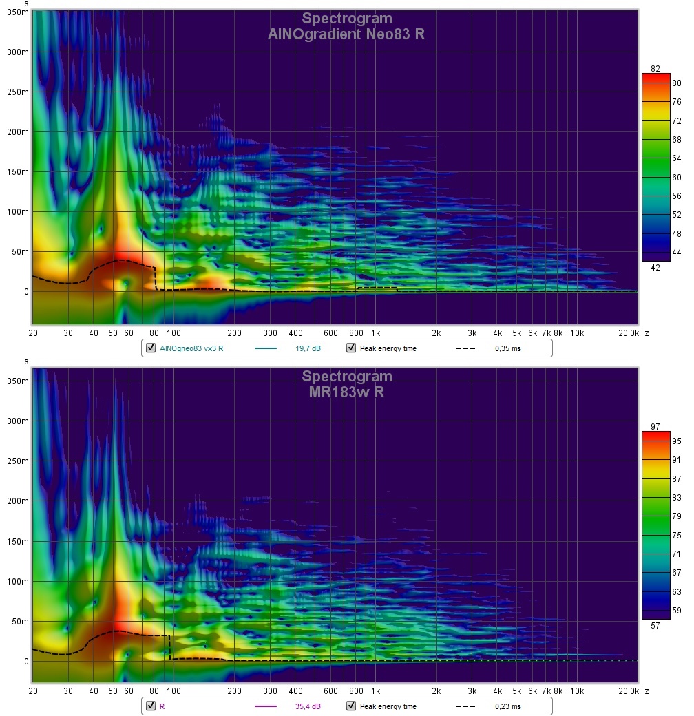

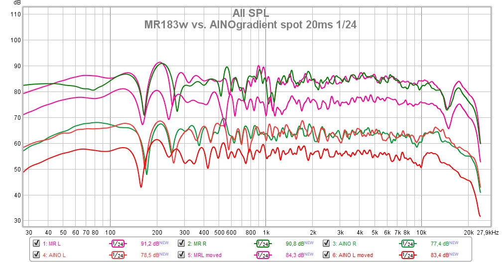

Listening impressions and some comparative measurements
So, I have for more than a week listened to MR183w sitting next to my AINOgradients in my living room. Impressions verify my initial thoughts, but it was about five years from previous side-by-side comparison of dipole vs. monopole! I have adjusted settings in dsp by listening and measuring, several iterations. I have bad hearing of high frequencies, and sound changes every time I swallow or yawn. This and challenges of taking measurements indoors are making this stage a bit frustrating and time consuming. Naturally my dog and other family members have been asked for opinion.
Frequency balance - a matter of eq settings, but the different directivity proflile of speakers makes MR183w more difficult to set - measurements and audition don't go so much hand in hand as with AINOs. Treble balance changes more off-axis with MR183w.
Frequency extension - par because both have closed box downfire 10" bass. Room response within 6dB 15-15 000Hz for both.
Definition, imaging, clarity - MR183w wins here. Bass notes and harmonics sound very good and punchy. AINOs are cardiod around 100-300Hz and obviously changing directivity affects room response making it less uniform. This can be seen in spectrogram too. In midrange MR183w sounds accurate and more "like loudspeakers", AINOs sound more diffuse/lifelike specially with classical music and speech. With eyes closed it is easy to hear that dipoles sound more 3-dimensional.
Conclusion - MR183w sounds like very good typical monopole co-axial speakers, with precise imaging and are good for people who listen mostly pop/rock etc. music recorded in studios. For classical and vocal music dipoles sound more natural and sound tonality doesn't change hardly at all off-axis or when walking around in the room.
In attached measurements neither speaker is exactly as they were set for listening, so they are not directly 100% comparable.

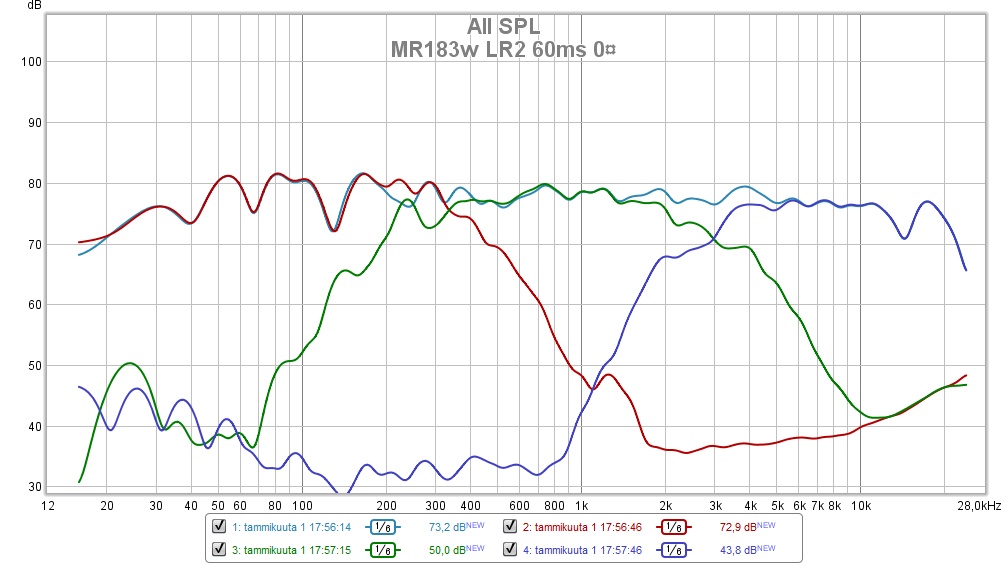

I wasn't totally happy with the duelundish crossover topologies, so went to textbook LR2. Clarity of treble improved and now I think that these are ready to be delivered to my daughter!
These responses were taken at 1,7m in-room so they contain reflections around WM xo. Eq and delay were set based on several better measurements for each purpose.

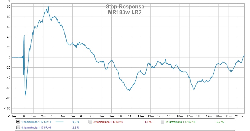

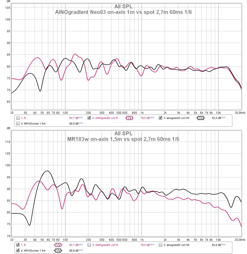

I had a day off from work so some more tweaking and measurements. Woofer-mid timing has been very tricky, but now I think they are on same cycle, mid has 436us delay and tweeter only 322 to woofer. The alu tweeter sits deeper than the original.
I tried to match response to AINOgradient, but still in these measurements the mid blows too hard between 200-400Hz and tweeter 3-5kHz. I adjusted those afterwards, now their sound signature comes from different radiation patterns. Speakers were side by side and I also moved left speakers 10" closer to see how response changes. MR183w measurements show a wiggle around 1kHz and it comes most likely from my laptop near the mic, because it disappears when I moved the speaker and moved the laptop too. Dipole speaker is less affected with positioning and has overall less wiggles in response despite being relatively close to front wall!
One major finding is again, that small wiggles in response are artefacts from reflections. 1/3 octave smoothing tells best how the speaker sounds.
