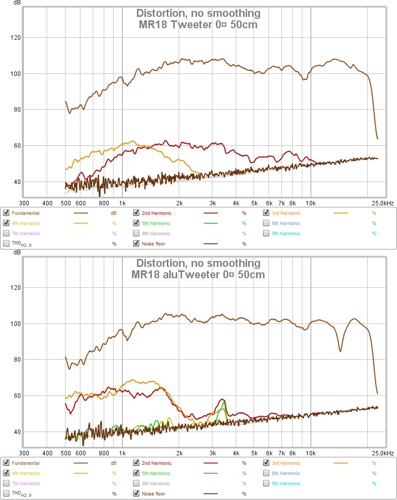

SEAS alu tweeters ordered for testing Seas T18 koaksiaalielementin vaihtodiskantti, alumiinikalotti (mitataan ennen lahetysta) - Hifitalo

Oops, I broke the unattached tweeter when trying to get the copper sleeve off. Must try to get replacement drivers... Aluminium T18 tweeters have less distortion but more ragged response obviously because the membrane sits more deeply in the throat of the cone.

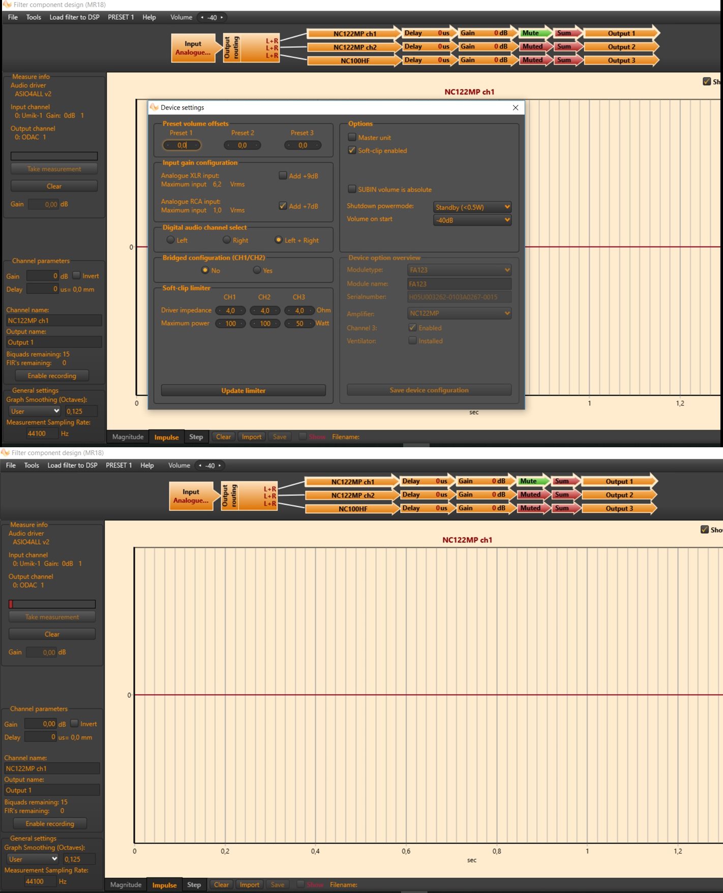

I found the mute button and I tried to make sweep, there was a red line growing a little but no sound, the it halted. Had both L and R RCA-cable connected and RCA input forced.
Nice to know that there should be flat responses downloaded! I will try it again before disconnecting, after I regain my normal mental status... This learnig process is very exhausting anyway and whole family suffers, including my dear dog Willa!

^Add one biquad which does nothing, for example BoostCut with gain=0.0 dB and Q=1 at 1000 Hz. Connect usb cable and load filter to DSP. Lift volume from -40 dB to 0 dB. You may need to check 'Master unit'. My amps are in the box so can't verify exact settings which work.
I'm not sure about this anymore. I got sound after adding one dummy flat biquad. It's kinda logical but disturbing.

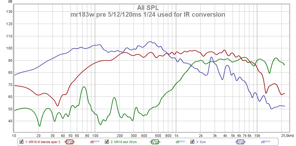

I took some quick and extremely dirty measurements to be downloaded to HFD. Bass spl level is not comparable to M or T and I didn't even check polarities. All have different IR gating. I converted impulse responses as .txt so let's see what happens next!

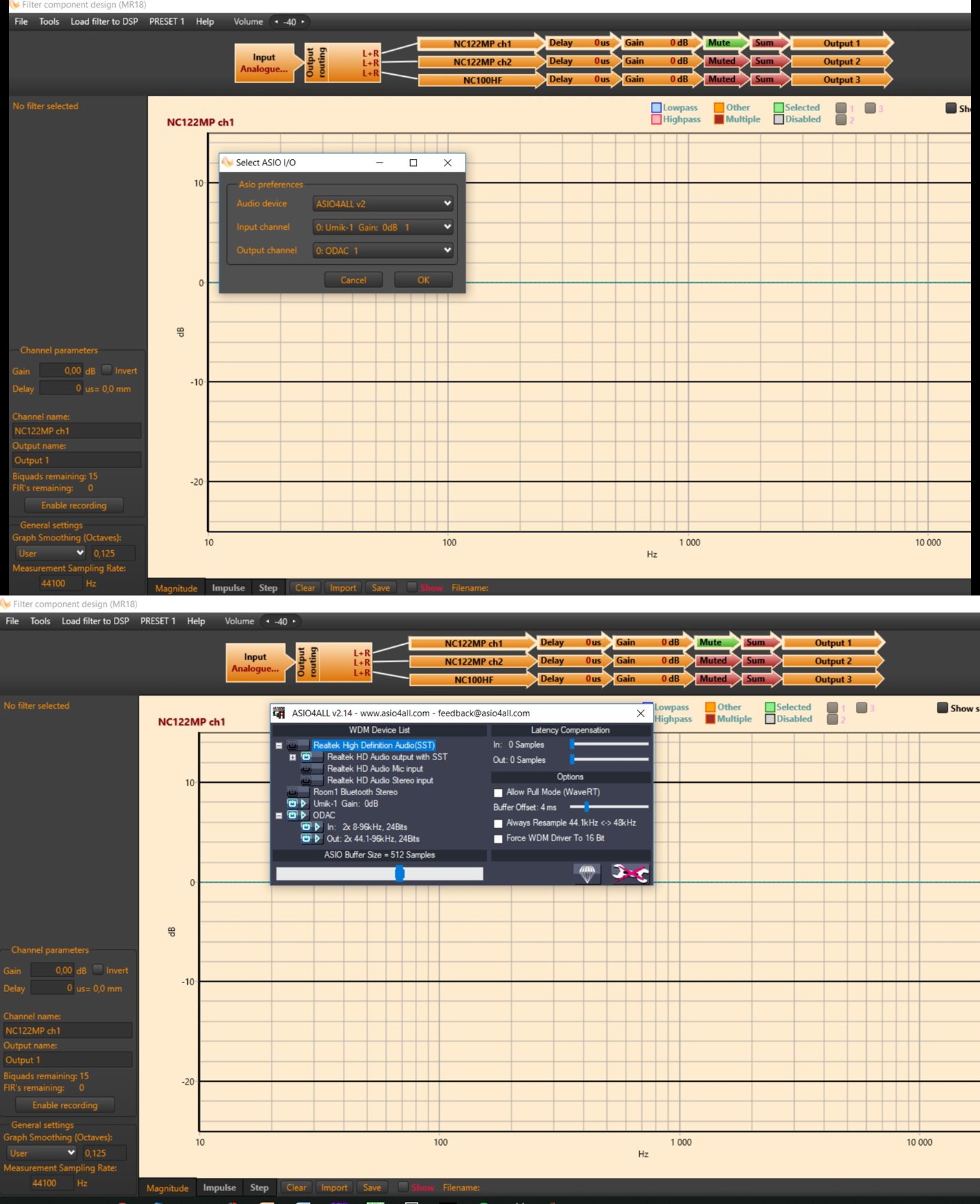

First, to get HFD to accet the IR from REW I had to edit .txt files, cut off all info on first 10 or so lines so that the file started straight from values. Then I downloaded the files as per instructions, loaded the Preset1 settings to the board and it started working! The led on the right upper edge of the board settled on Left speaker while on the bad board it went blank ater running all the lights.
I set ASIO4ALL settings correctly and started takin sweeps and settin biquads for eq. It seemed to work and I downloaded the better settings and save the project several times. The after fes measure-eq periods the HFD screen started to show asio settings and biquad settings overlaid, some biquads stopped from working and even after deleting all bq settings, the measured response showed highpass for the tweeter.
After setting biquads and measuring, the Save command from upper left corner wanted to save only the impulse response measured last. All settings coul be saved only by closing the whole HFD.

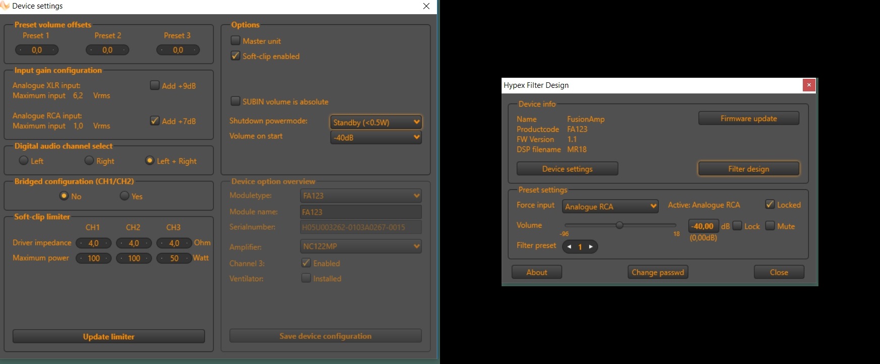

DannerD3H gave me some valuable peer support and I celebrated the evening of Independece day with beautiful sounds from both FA123 plateamps!
I don't know what it exactly was, but main points were:
- set as Master, Full power
- set forced Analog RCA input
- load flat.dat response to all channels
- use different computer to feed audio and for measurements
- remember to toggle Upload settings to board after every change
- Live update doesn't work, all biquad changes must be uploaded to FA. Only mute, Delay, Invert and volume settings work directly. Using mute makes it easy to measure each channel/way separately.
It is not possible to download present settings from board to HFD program. This is nuisance, because later on I must remember which saved setting was uploaded. I put a note sticker on the board, marked with settings directory name. The actual config file is always named plainly config.xml.

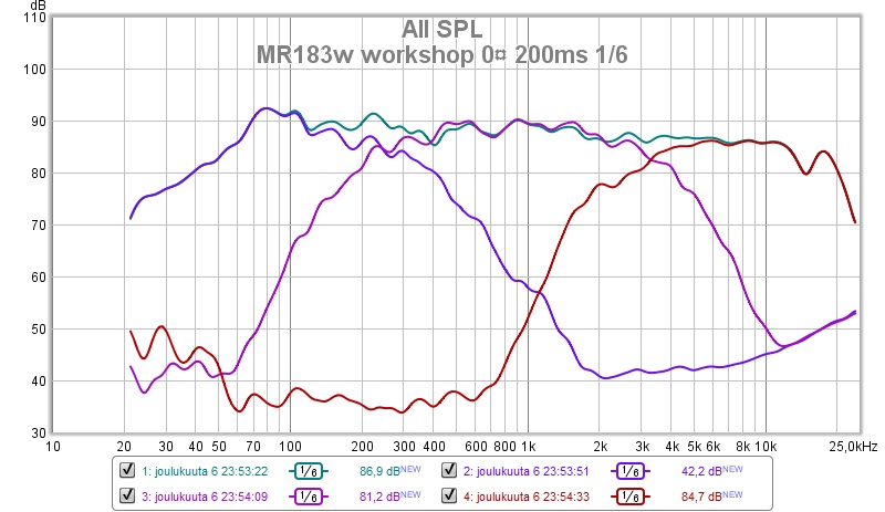

Here are 200ms responses measured at 40cm distance from ball. So, this is nothing final yet, mid plays too loud, but usable in this stage. My off-axis measurements show that 6-9kHz has almost no directivity. But now they seem to work and I can go on finishing the boxes!

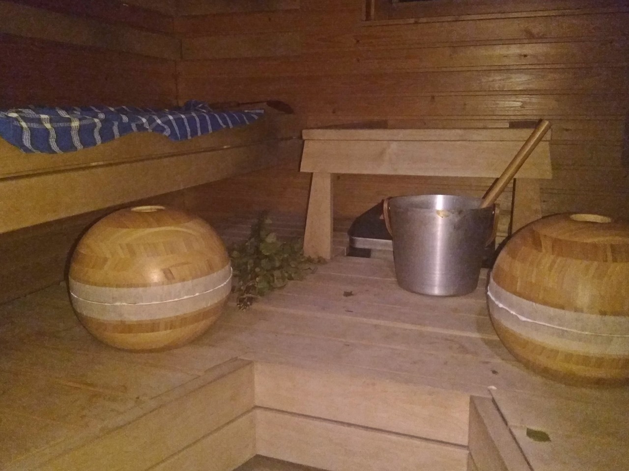

Having a sauna and shower room with heated floor helps a lot! Boxes and balls are in the owen now! I decided to use aperiodic vents in the balls. Original Gradient 1.4 has obviously several small perforation covered by backside grill. Backside radiation is basicallly dipole in low registry, in opposite phase to frontside. The 900Hz peak in backside measured response presents the internal standing wave leaking out.
