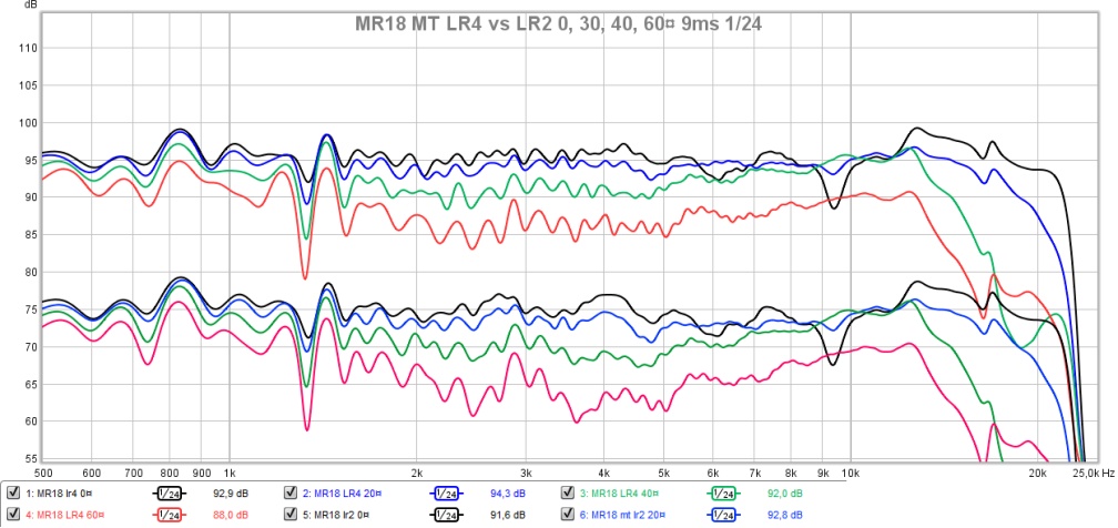

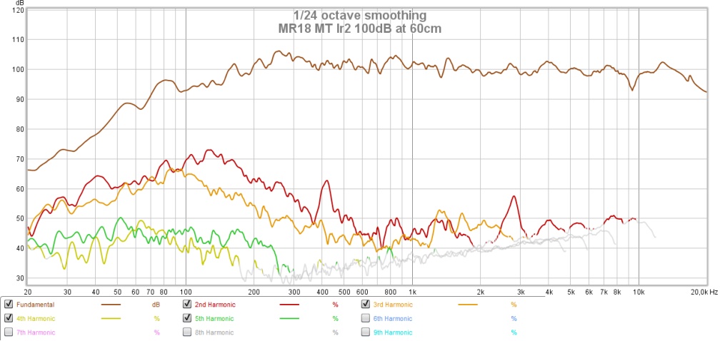

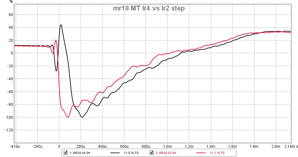

I have a test box for the Mr18, it is rectangular closed box, sharp edges 185x290mm baffle.

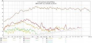

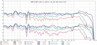

First I used some leftover coils and caps to try passive xo, but with poor results. Also the 3-5 kHz peaks of the midrange require some attention. I have minidsp 2x4HD so I used it to make MT eq and xo. Here are results form evening #1, measured on stand inroom at 60cm. 1,4kH is either floor or edge interference.
Looks like LR4 at 2400Hz gives smoother response, but I can't hear a difference... requires longer listening? Distortion rises below 200Hz, easy to xo with woofer!

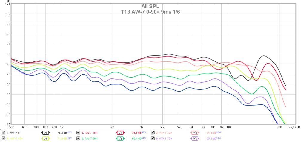

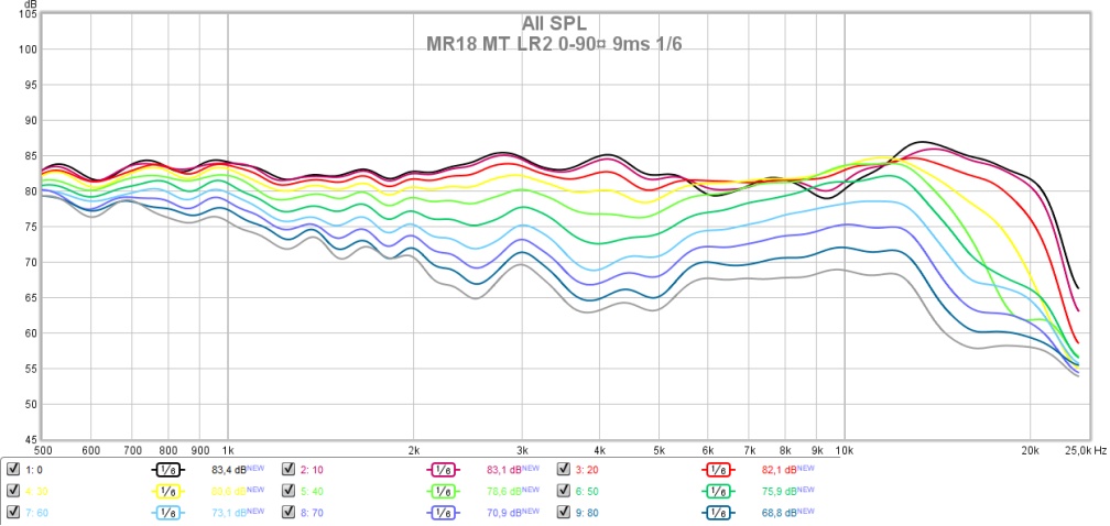

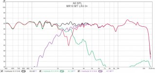

Measurement session #2 accomplished!
this time distance 100cm. Some more eq and delay set to 0.08ms for the tweeter (yeasterday -0.06ms).

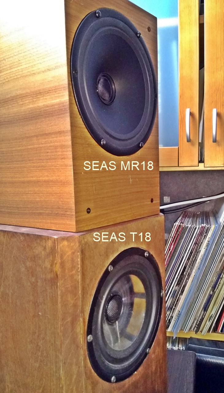

Here individual and summed on-axis responses. Off-axis to 90 degrees horizontally, with 1/6 smoothing. All graphs here with 9ms IR gating.
The MR has shallower cone than T18, which is obviously causing the peculiar directivity pattern (low DI 5-12kHz). The MR behaves much better around 10kHz than T18, because of better matching of tweeter to cone - thanks to cone's lower Xmax/shorter voice coil.

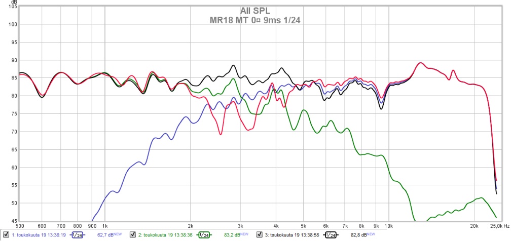

Those are cone resonance peaks, check the link in post #1. Lr4 xo attenuates them so much that summed response is smoother. I fail to hear them so far... Needs more listening.
Because of eq needed, this will turn to 3-way active design. Fortunately Hypex has released new plateamps the Fusion series.

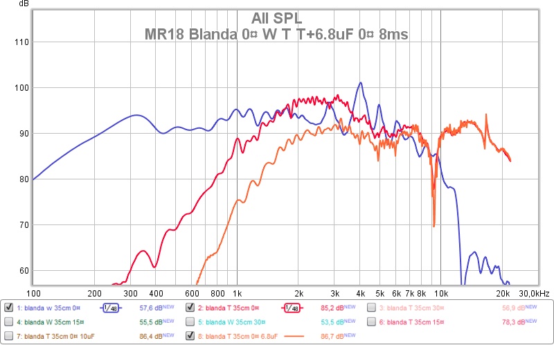

I installed the MR18 on a cut IKEA Blanda Matt ¤30cm bowl and took some preliminary measurements. The woofer has nasty 4kHz spike that must be attenuated by cone treatment or with eq. Serial 6.8uF cap makes tweeter's response easy to eq and protects it from pops.

Here is a link to album of this project, photos and measurements
