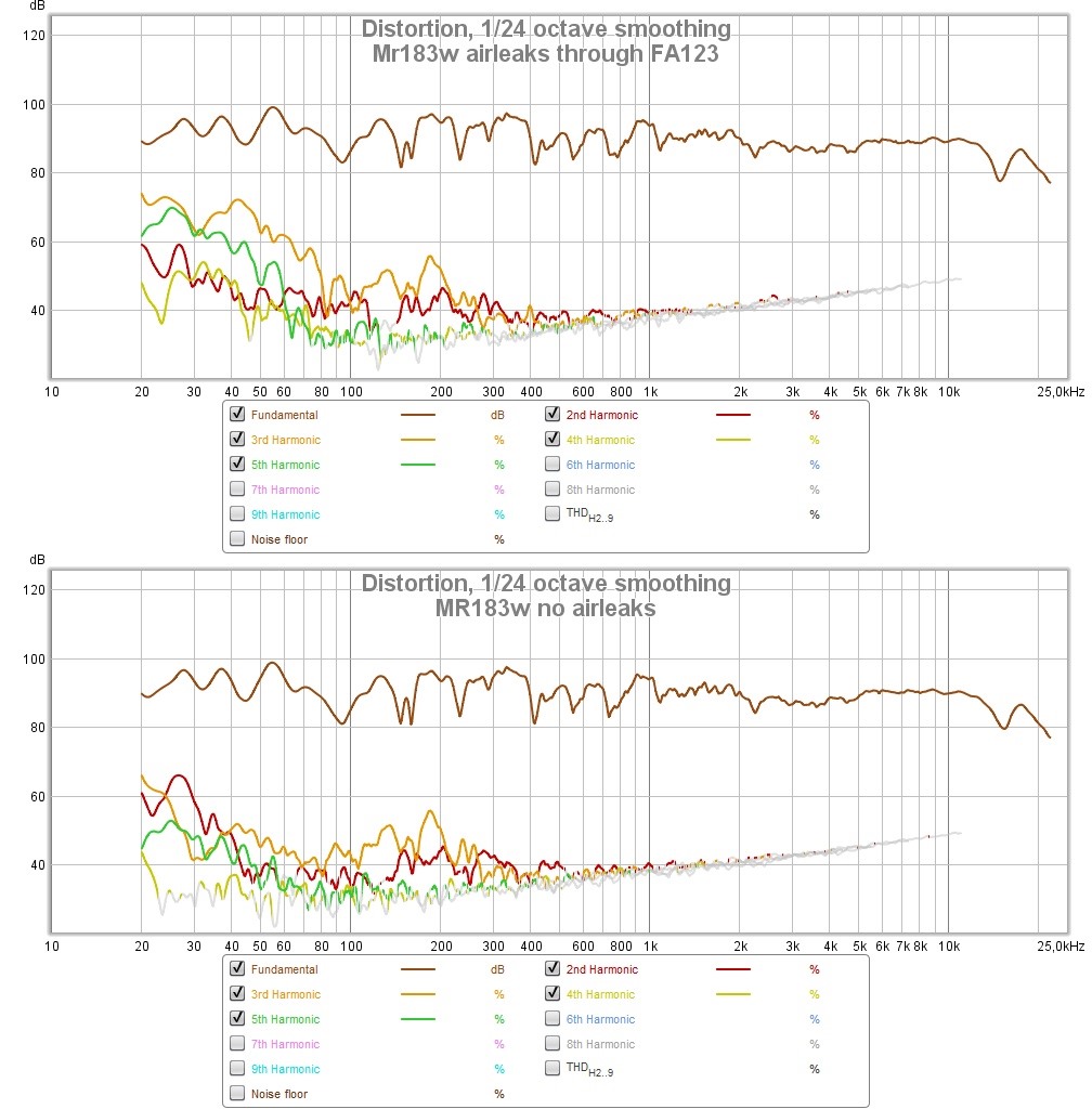

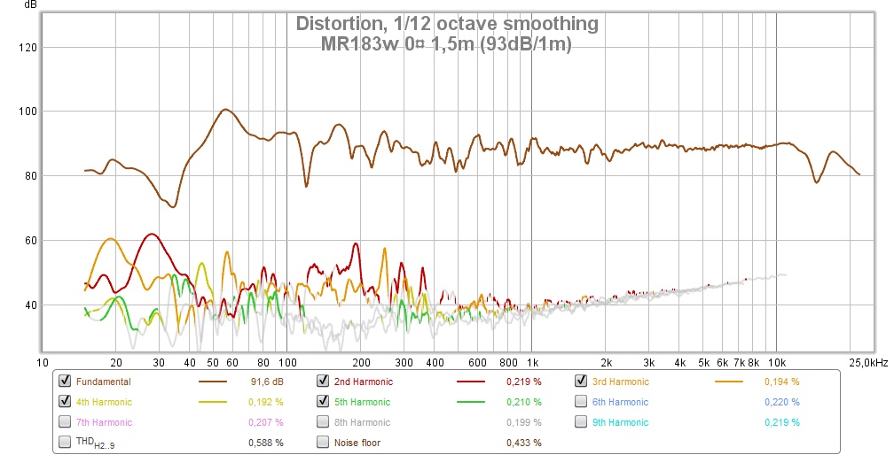

Now they are almost ready, I'm cutting wires and fixing details. One problem is that I didn't make a closed compartment for the amp and now it leaks bass pressure - nice tremolo whistle at 16Hz! I taped unused inputs and now it's almost ok and looks very pro with those duct tape strips! Perhaps I should buy a plastic basket and glue it inside over the amp...

You might want to be careful with that ducttape.. I suppose you are blocking the cooling holes in the plate amp as well? Pretty sure they are crucial for the convection cooling to work properly!

I believe that the 40 liter of air inside and infinitely outside is enough for cooling 😀 Ncores are very economical, I can't feel the amp plate getting even warm.

I might as well make a plywood box for the amp to be glued inside, I have lots of 24mm stuff left. It is not so difficult or time consuming task either.
Here are distortion measurements of the blurping and whistling vs. duct-taped version. Response in not final yet. After these measurements I shifted WM xo to 350Hz and lifted treble below 5kHz.

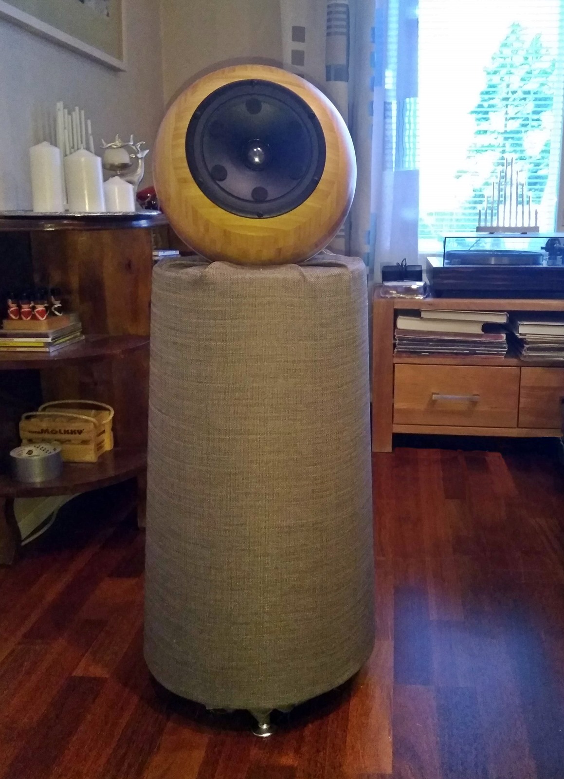

I happened to have a day off from work, so I tried to finish the speakers while listening to Linda Ronstadt's canciones from Spotify. Sadly the high heels haven't arrived yet but otherwise we are ready for final tweaks with dsp settings! Temperature of the plate amp after being connected for 2 days was around 44¤ Celsius, not too much. I can see two thermistors as overheating protection.

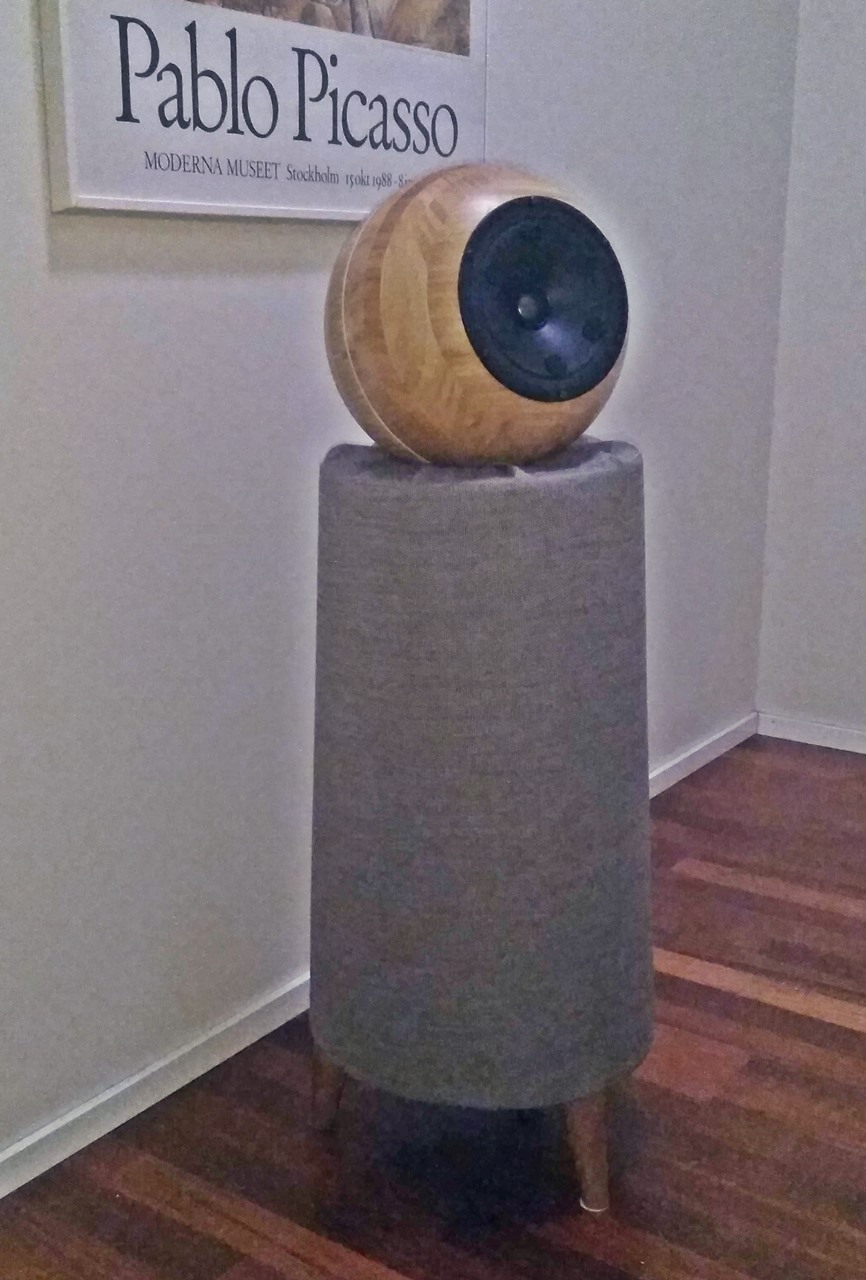

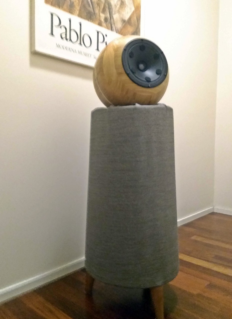

Legs arrived later in the evening - ready, set, GO! Legs are 12cm high and tilted, total height is 98cm, weight 17kg. This has a bit '50s look like some models of B&O from Denmark. Me happy!

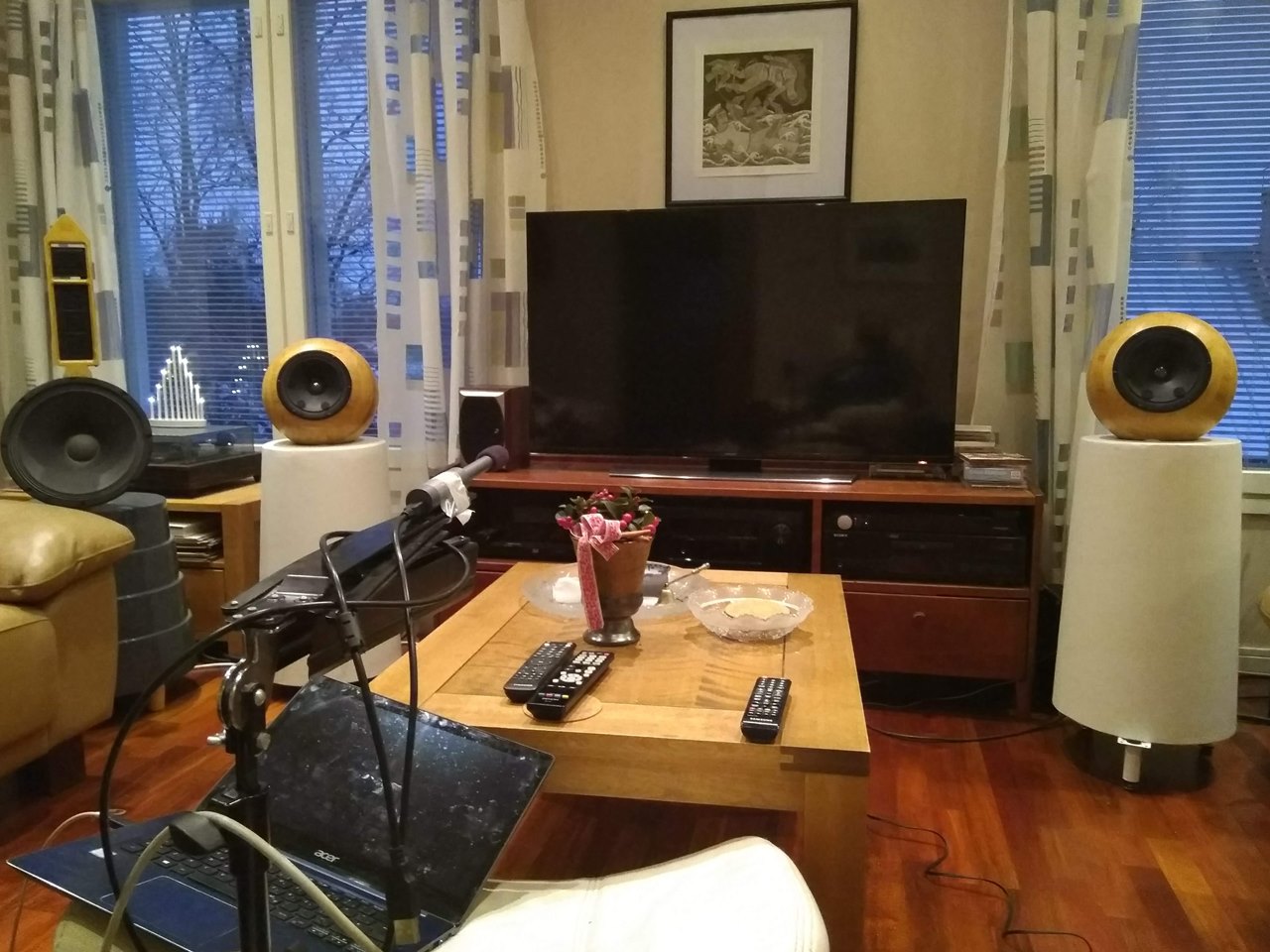

Measurement session, speaker in the middle of the room on a stand (directivity) and on the floor, distance 1.5m.
Sounds pretty good now, but perhaps I'll tame the tweeter 1-2dB and fiddle with some delay for MT section. WM xo is very difficult to measure indoors because of reflections. Reflection-free enironment wold be needed to get slopes and timing right. Still, low bass level must be set in the actual room placement. Easy in principle with dsp, but takes a lot of time and listening! More graphs in the album linked in previous post.
