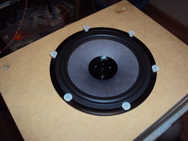

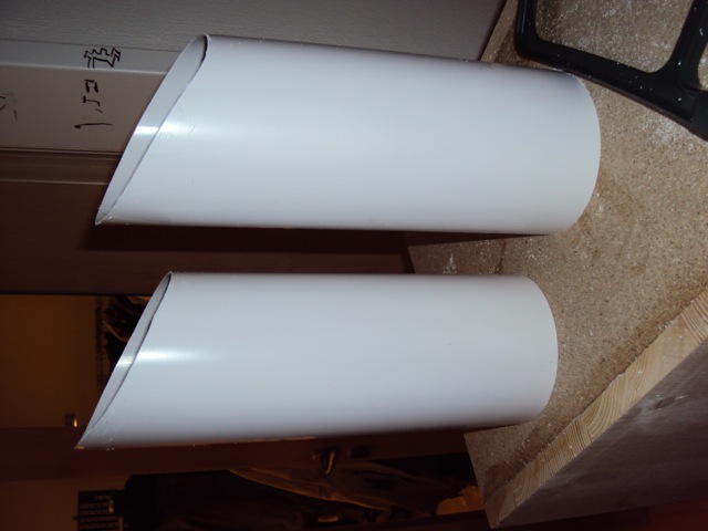

Here is a picture of the modified SEAS wideband, a view into the multichamber cabinet and the reflex tubes.
Hello Gerhard,
thats very intressting a kind of horn with reflex tunnel!?

I would follow the same basic recipe as for the FE167 here. The only change would be to move the rings to EnABL2 locations.

Karsten, i call it a multiresonator. I am still working on it. At first i put the reflex tube on the top near the driver. That created something like an anti resonator so there is little energy under 70Hz. I will now try to put the reflex tube at the bottom in the last camber and see how that works.
