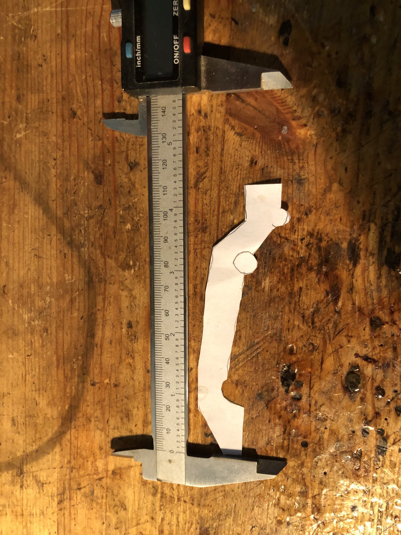

Yust because it is still lying on my desk, here is my gauge for bulding the appropiate carrier, perhaps it helps. Better is to measure by Yourself with an distance of ,6 mil or whatever you propose as X-max or movement of the cone to surface of the driver structure. Don't forget to add some surplus on the right buttom side of the gauge for an install structure with 90 degree bend. I added a 30 degree bend at the structure at frontal view projection to get a nearly horizontal placement in Front of the Driver for optical purposes, some degrees out of horizontal axis are in long terms disturbing ( see
BPTS1590.JPG from last Post).
