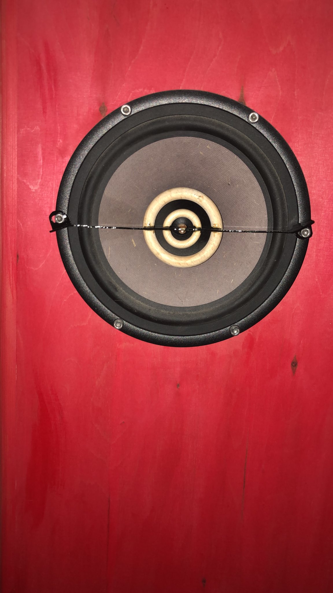

Finished mine a couple of weeks ago and I'm pretty impressed. Ended up with the 1.5mH // 15R series filter and I think it sounds really good. I don't have any fullrangers in the same size to compare it to though, but I do like the FA22s.
Yes it is. I made my project with them some 6 years ago and I still like them. But they were better bargain then, I payed 109,90 EUR a piece.

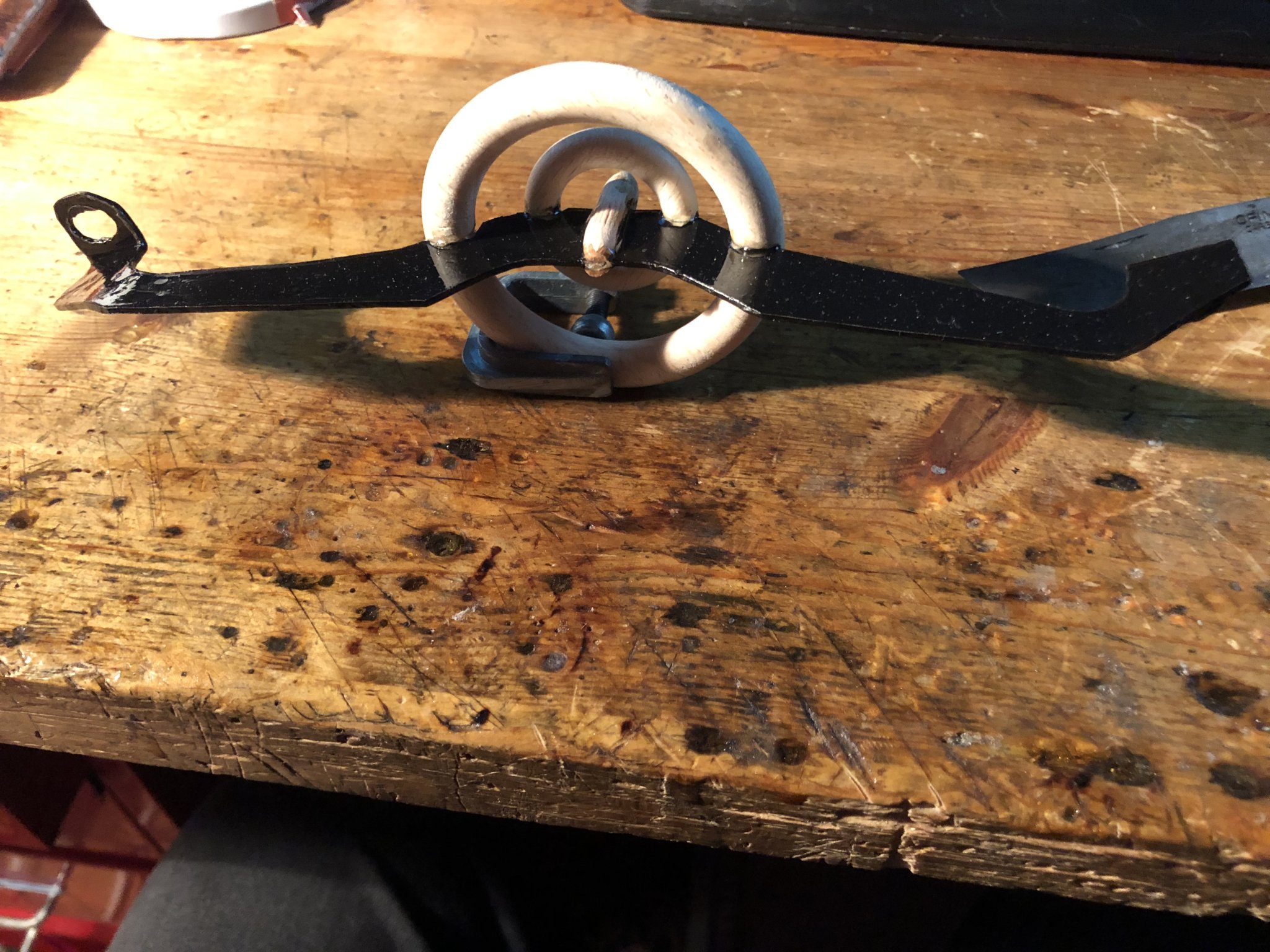

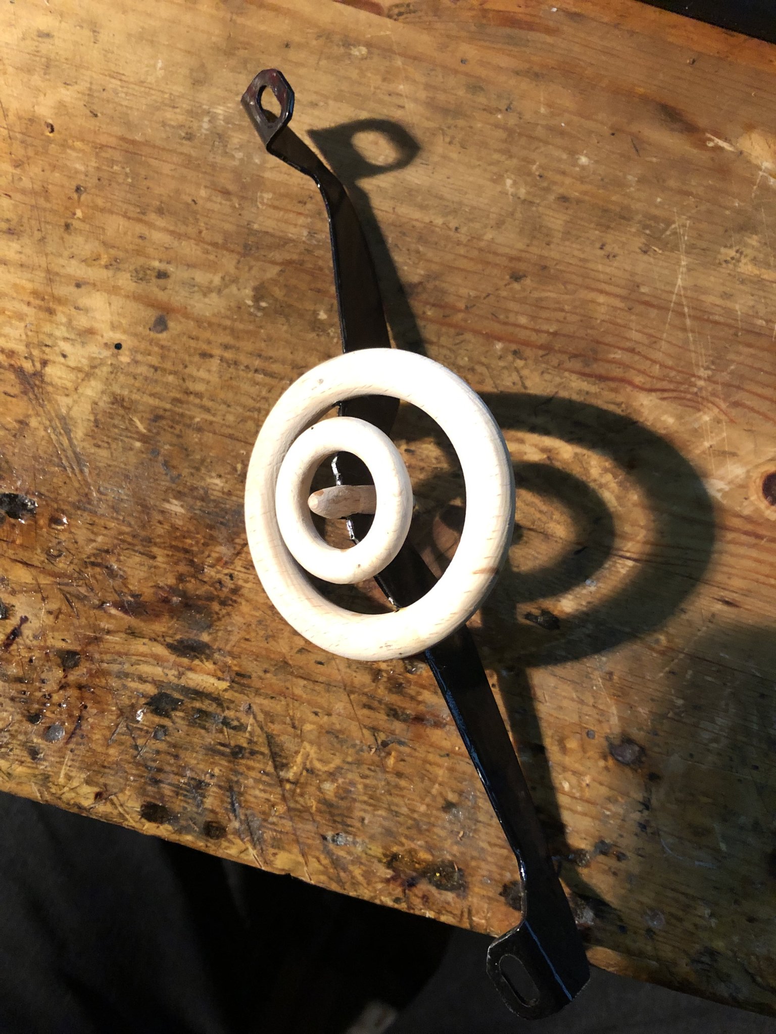

Many of the HF issues disappear when you install phase plugs.
http://www.planet10-hifi.com/downloads/B200-phase-plug.pdf
dave
dave
