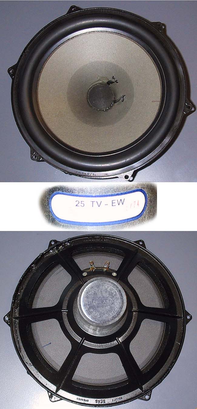

You got a lot of variations with that paper cone. I got the Seas TV-21-EW's in stock, that use the same type of cone and surrounds, and an alnico magnet. But those are smaller cones.

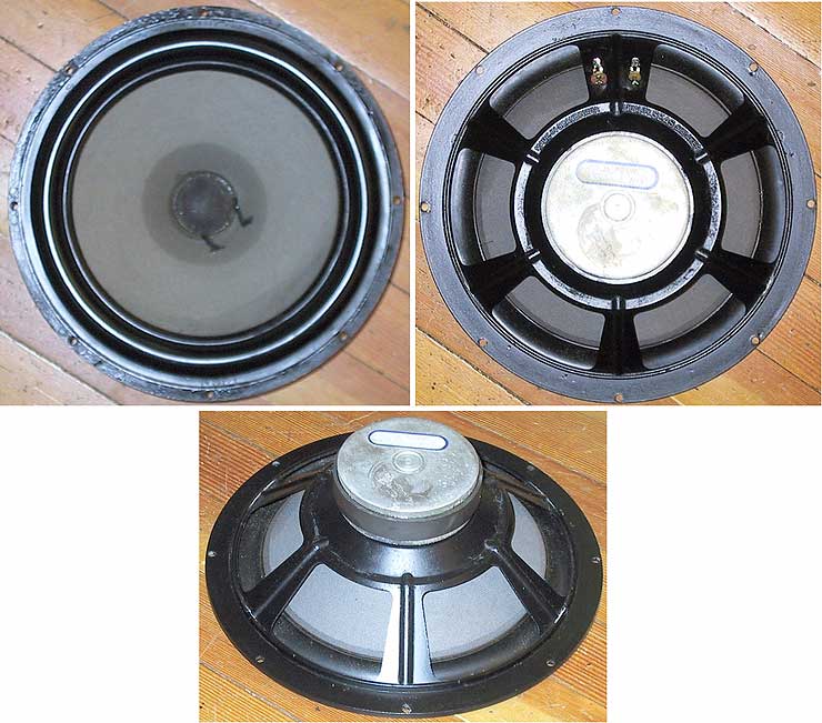

The Seas A25 with a ferriet magnet that you post looks different than the one i saw when i restored a Dynaco A25 speaker for someone i have to say. The one i had in my hand had a magnet to size of the back for the frame, while yours is smaller. The sticker said Dynaco A25-XL (but everybody knows it's a rebranded Seas TV-25 variation). The Tweeter was a rebranded (as Dynaco A25 tweeter) Seas H087 domes, exact the same as i have in my Goodman Mezzo SL's.
I wish i made pictures then...
Over a million A35/A25XL/A35 et al were sold, made by at least 2 different manufacturers, so i would not be surprised to find that there were more than 2 woofers used. The ones i pulled feel into the 2 types i posted, but those would have all been those shipped to Canada.
The pics are from drivers i pulled form the cabinets (6 A25 cabinet smade a nice packing table). I do have a set of A25XL drivers downstairs i could take a picture of.

I looked back in my documentation, and found back that it was called the Seas 25F-EWX. I only got a datasheet from it that i found (see attachment)
having owned a recapped pair of dynaco a25 and the A26, the A26 is miles better then the originalAnd the Devore driver looks like they are using the ferritte magnet of the old Seas A25XL, the second version used in the Dynaco A25 (first was with a Seas A25 H336 with the Alnico magnet).
The modern A26 has a much better magnet i have to say. It's lower distortion and more powerfull than the big old A25 ferritte magnet.

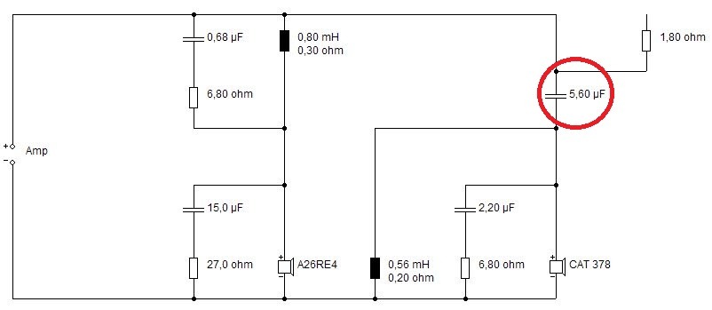

http://www.dibirama.altervista.org/...-makako-2-vie-bass-relfex-8-ohm-300-wmax.html
Another project to the theme of the title, uses a CAT376 so another example XO. Can someonevet it?
dave
dave
Ive been curious about that one also. None of the crossovers in the pdf include baffle step correction right?
