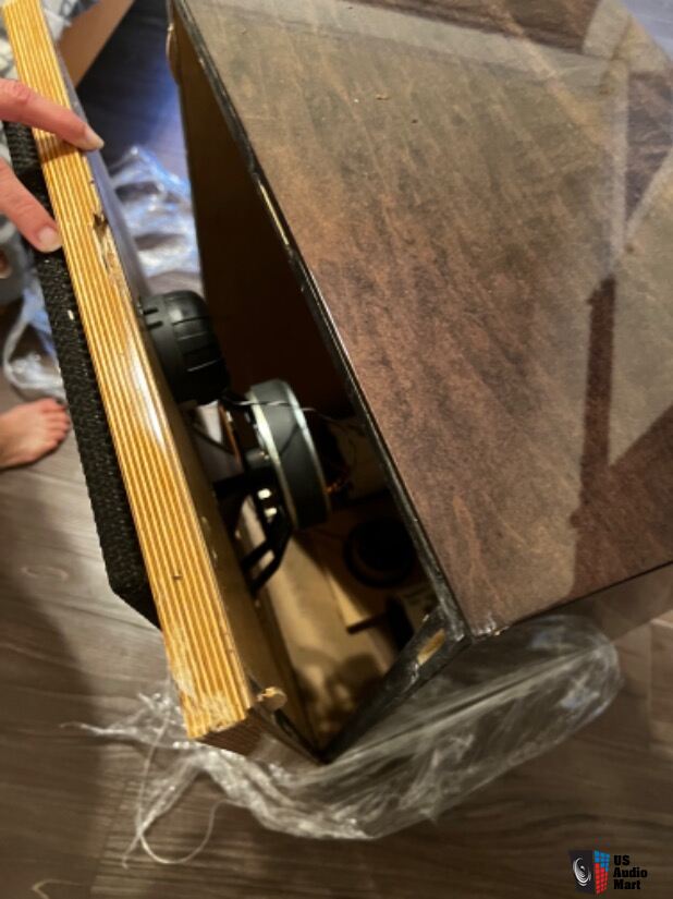

I looked at this listing for the O/96 damaged in shipping. One can't see all the way inside the cabinet in this photo, but it does answer a couple of the questions asked earlier:
1-the A26 looks to have the regular magnet
2-it does appear to be the Morel CAT 378
Also, interesting to see that there is no visible damping material at all, nor any bracing.

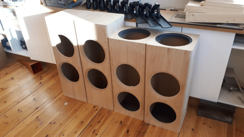

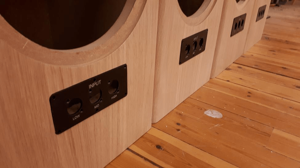

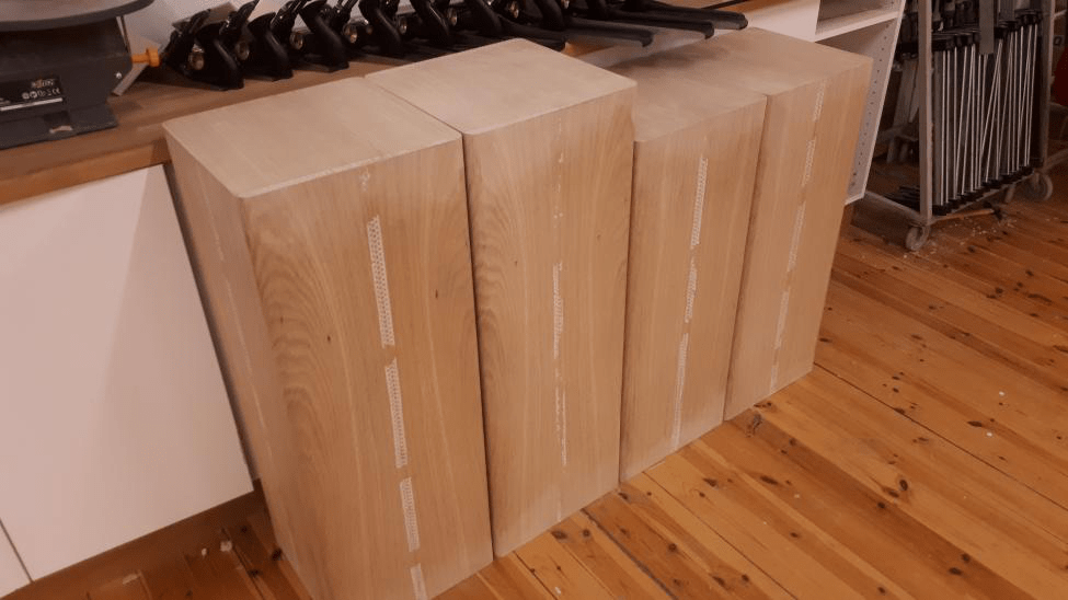

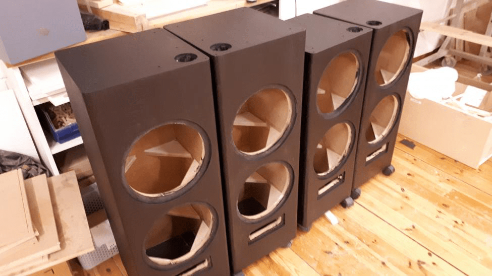

I just scored a sealed cabinet in MDF for 100 bucks locally, and another pair of W26FX002 for 200 bucks from OllBoll in Stockholm. The W26 is like L26’s slightly stronger and damped bigger brother, as they measure so similarly. I plan to use them a not so monstrous subwoofer, playing 40-80Hz with second order crossovers. I might add a sub-subwoofer for 20-40Hz if needed.
Typo: I meant A26, not L26.
Borrowing some photos from the very skilled carpenter that made them, with alias OB-BB. It is the taller cabinets. 65L is on the small side but since I don’t need 25Hz I think they will be fine. I think many people kid themselves when they think A26 or W26 should be used all the way down to 25Hz.

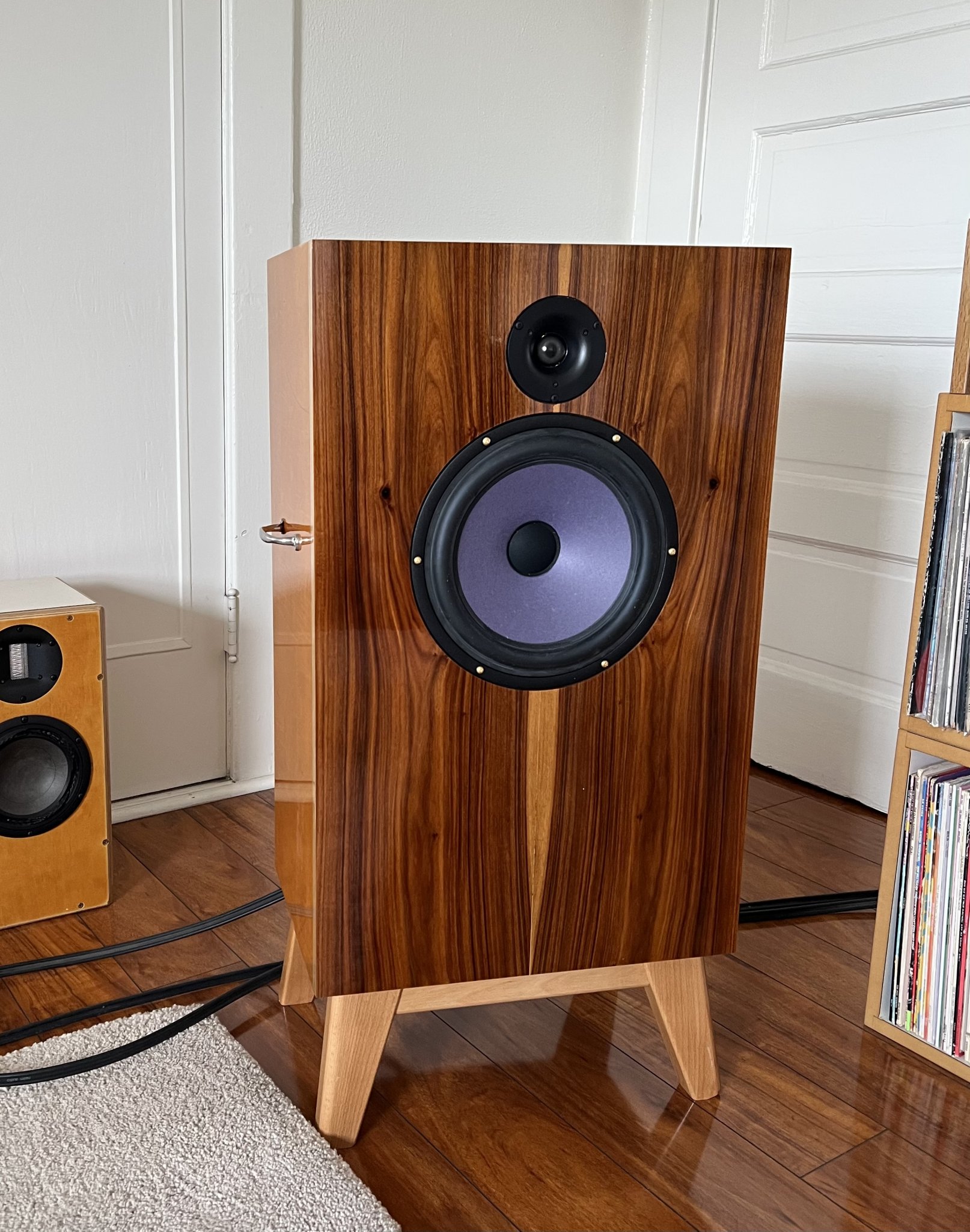

I built these and have been listening to them for a week or so.
I copied the Devore in as much as there is no bracing, and I am only using a 2” thick piece of rigid fiberglass insulation on the back for damping.
Running the woofer full range, just a cap and resistor on the tweeter.
They are a very fun listen! Very good detail and dynamics.
For ~$700 in parts, I am quite pleased. (I have lots of scrap wood, and already had the fiberglass)
