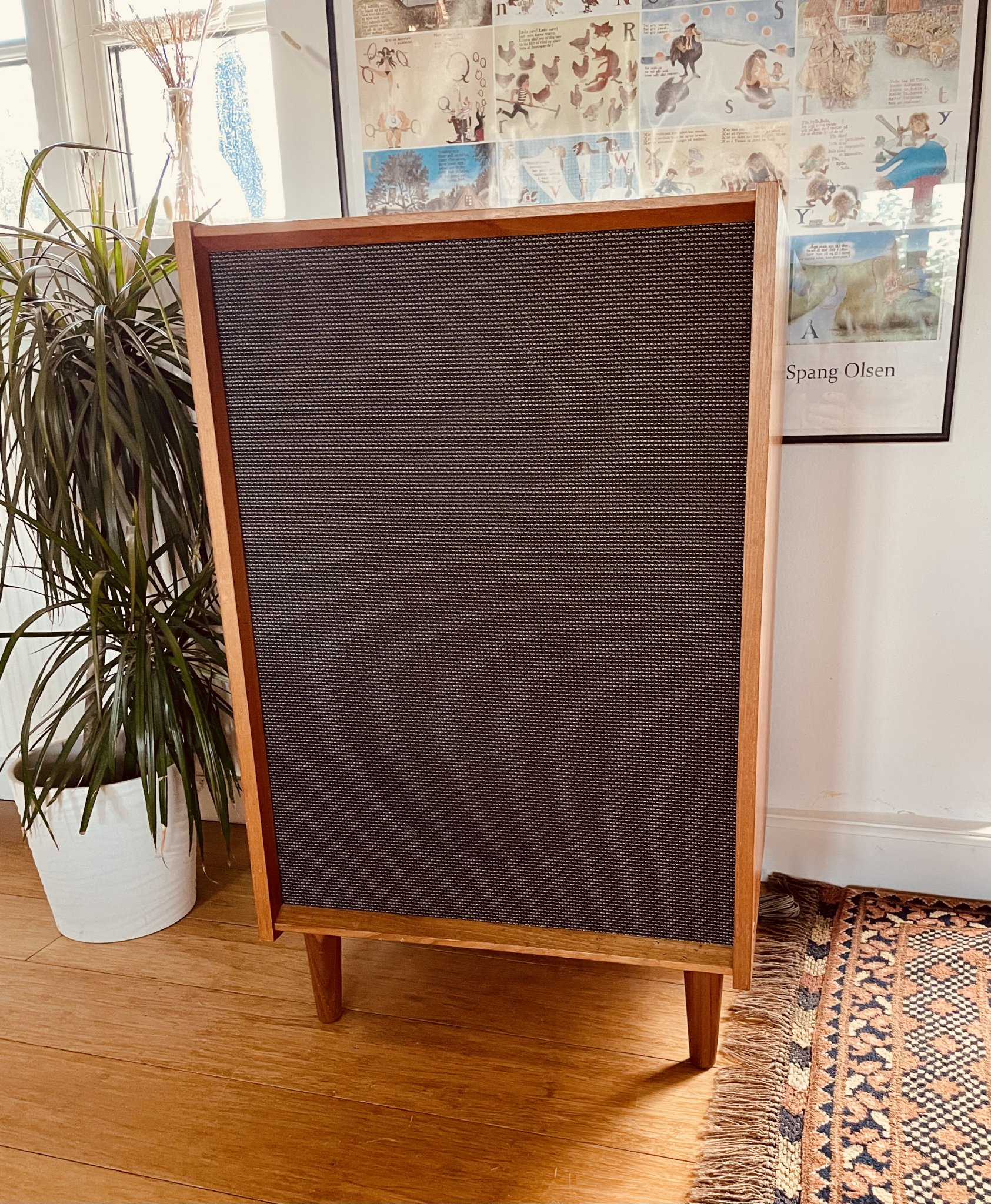

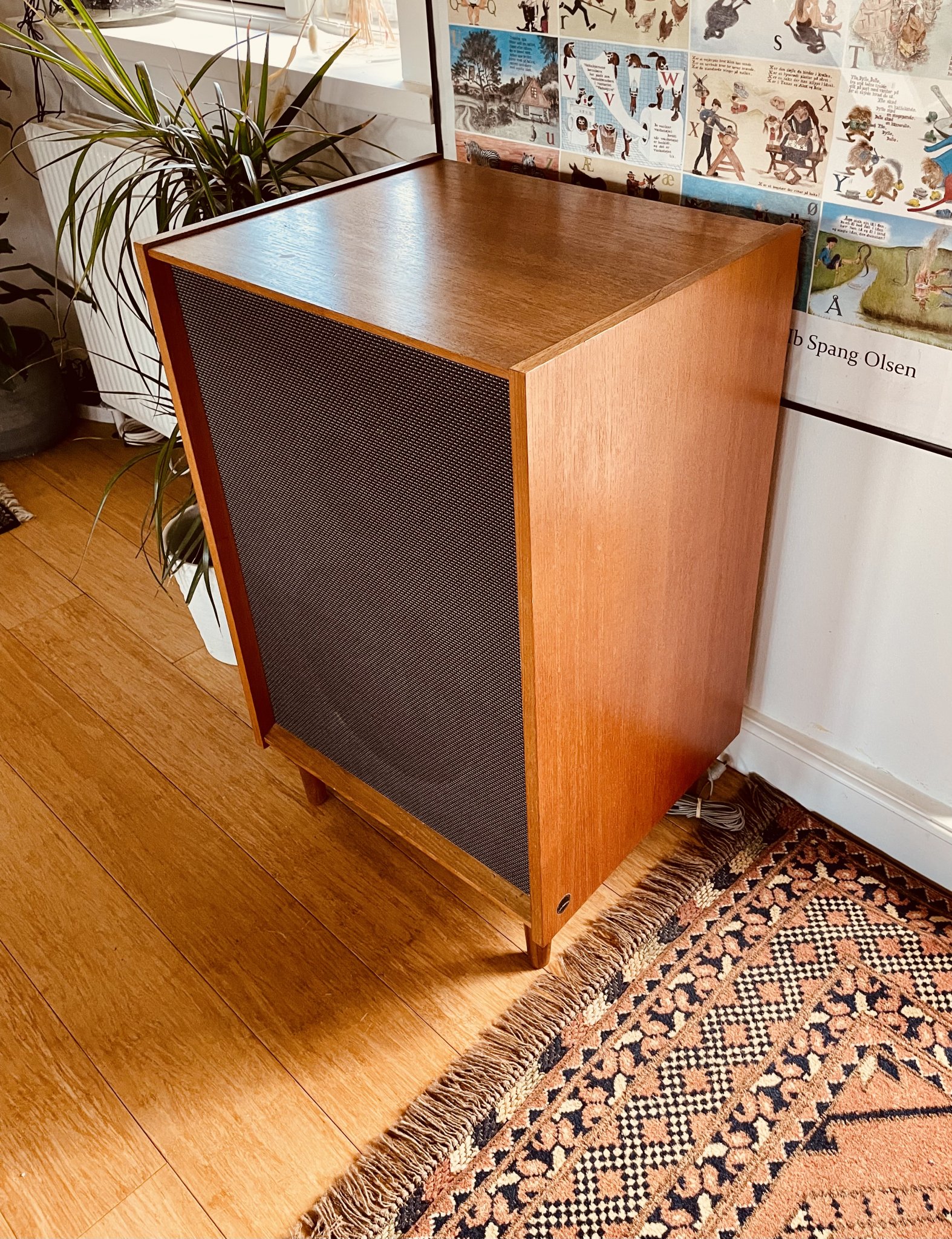

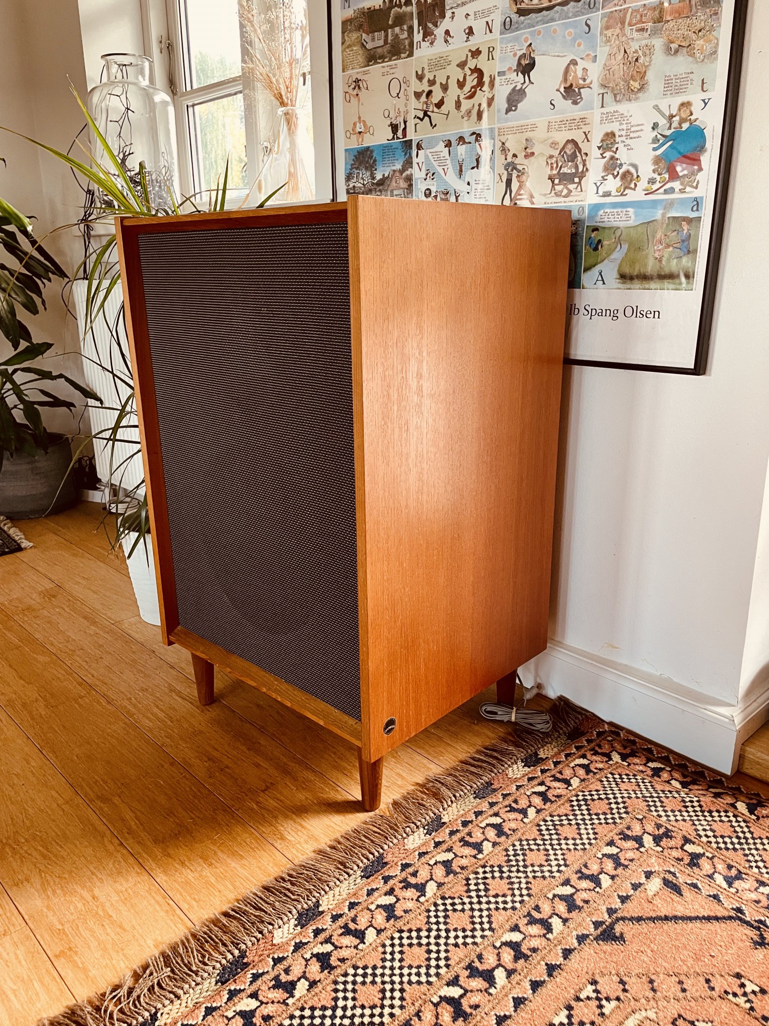

Okay, so I just bought a pair of Bang & Olufsen Type K speakers. They're from the sixties. I haven't plugged them in yet, but they are in fine cosmetic condition. Which was the most important part for me. My idea is to use them for a build with the Seas A26.
Outside dimensions are 40x48x65.
Is this a feasible project?

They are really quite beautiful, could they not be refreshed to stay original…….imo it would be a shame to alter them.

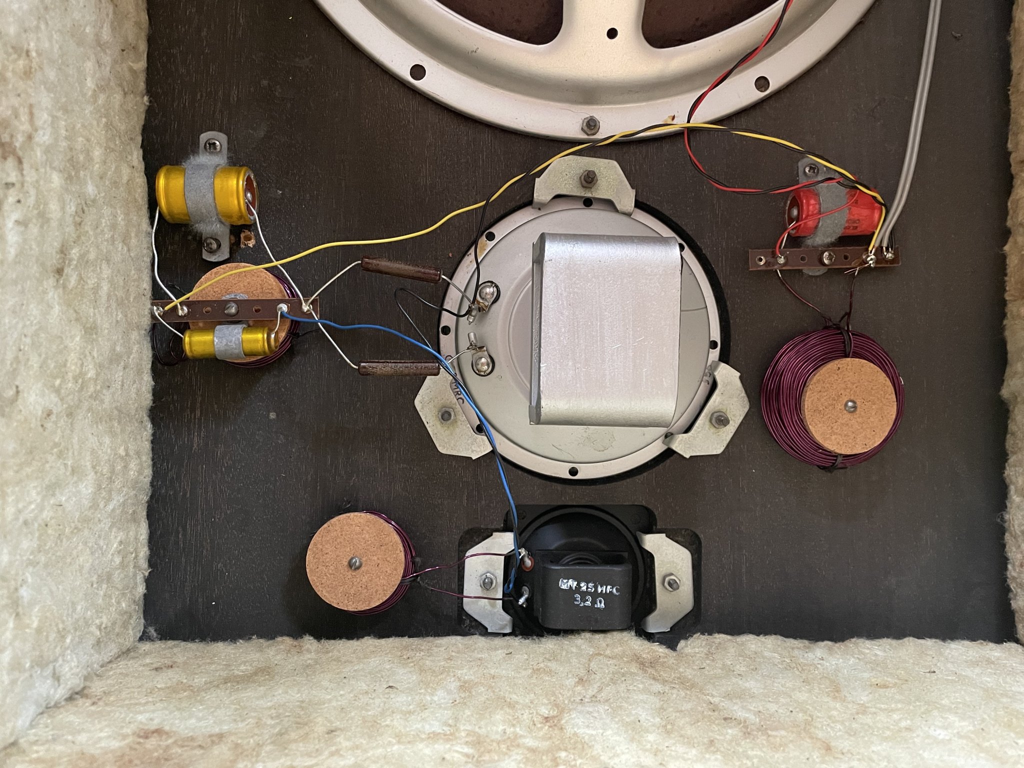

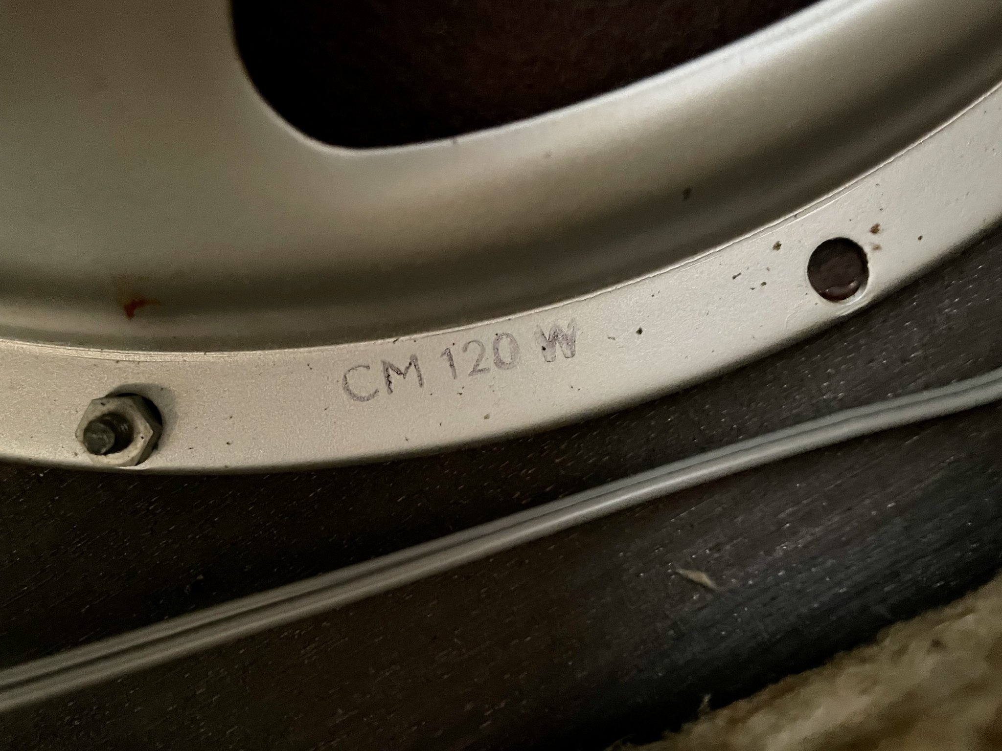

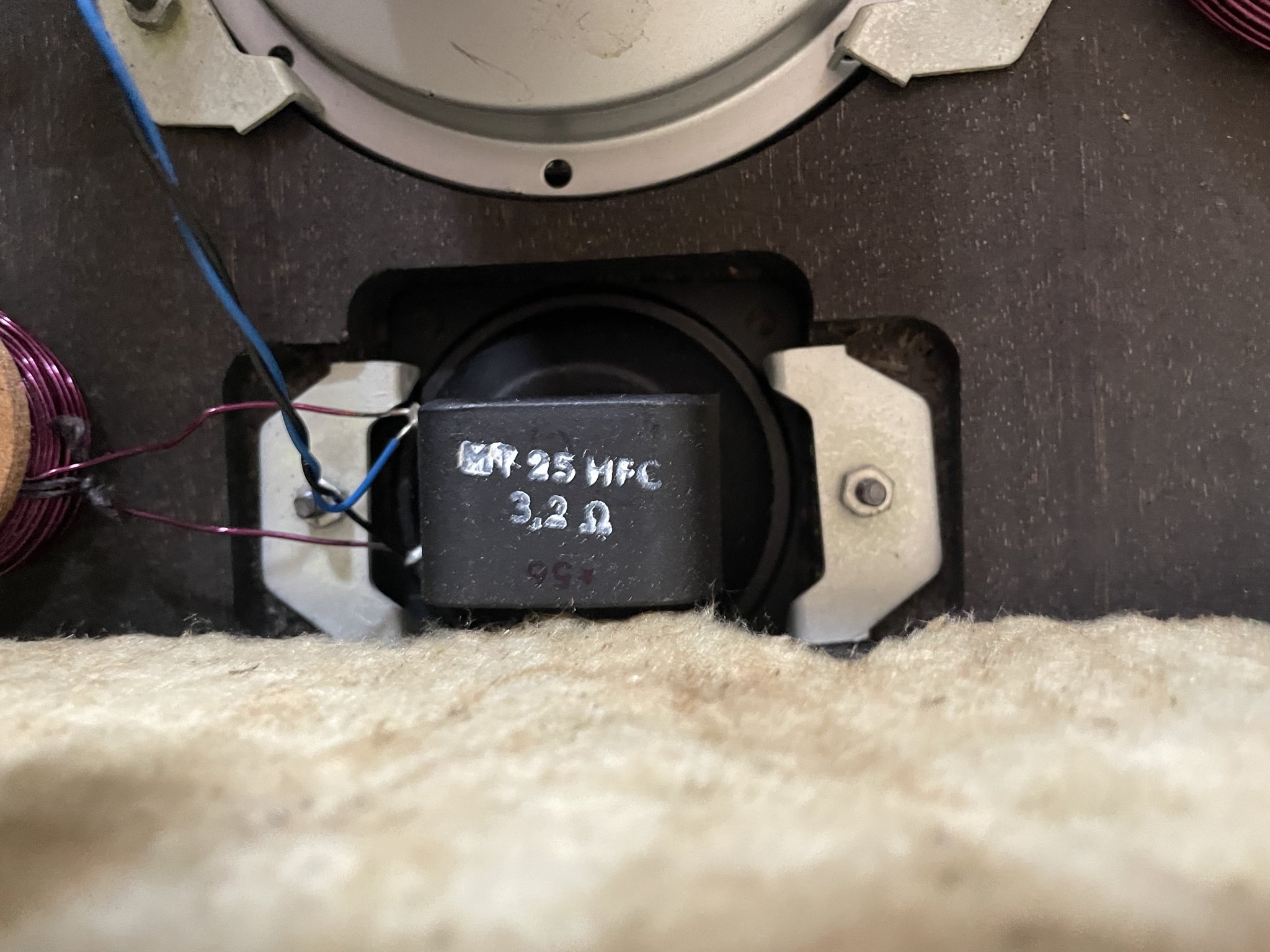

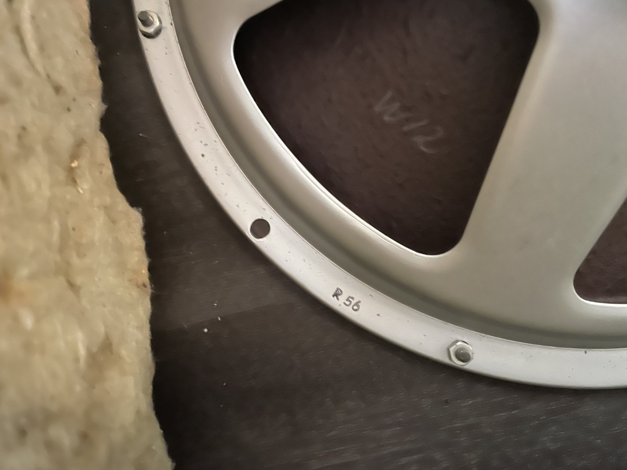

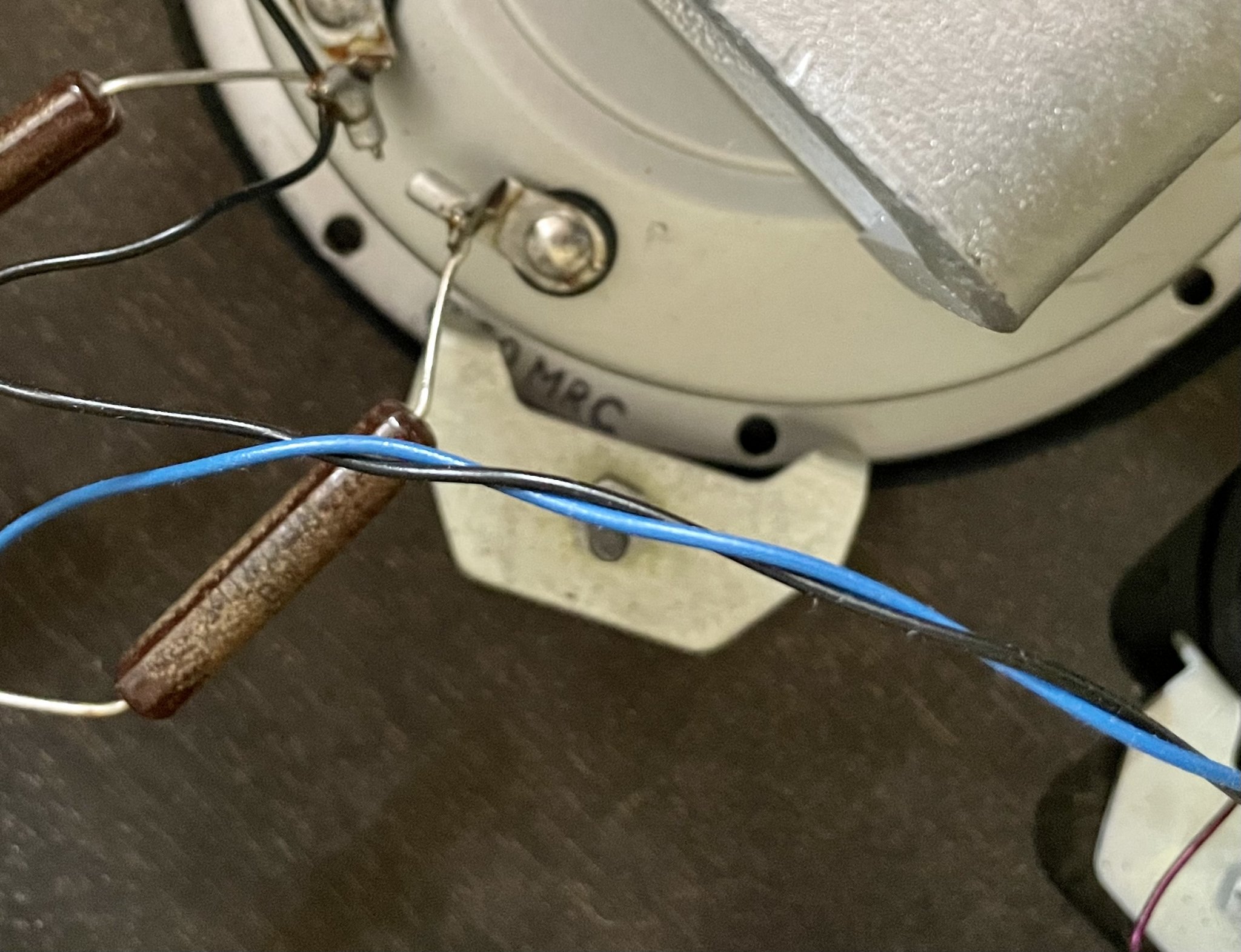

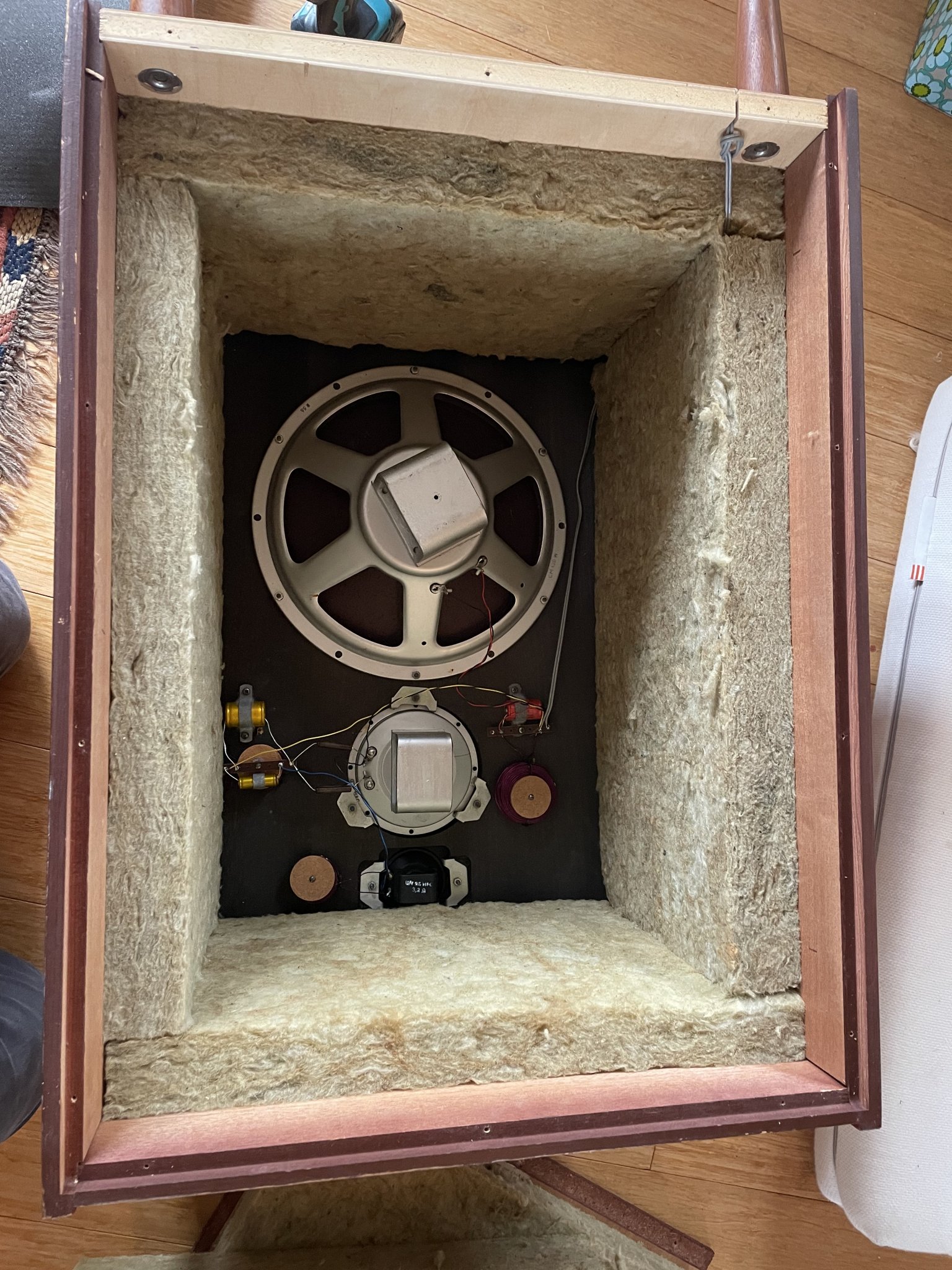

Does anyone know these drivers? Are they original?
And does it look like I could put in the A26?

Those in your picture look like very different speakers. They are the Peerless PA3-25 speakers. The tweeter is the (very sought after) Peerless model MT-225 cone tweeter. the mid is a Peerless B65MRC and the woofer is the CM 120 W. These were used in a 3 way diy kit from the late 1960's and early 1970 and your's look like a build from that kit. The only thing missing is the original crossover, but that is not bad as it's far from optimal, and will be so aged it needs replacement anyway... I don't know if they were sold as (rebranded) B&O speakers, but i know that kit. I restored a few of those in the past and they are great vintage speakers if you rebuild the crossover.

The images of the speakers and drivers shows that they are in really good condition. The horseshoe magnets could be alnico as well. Possibly keep them as original and sell on. Especially if you do not find the sound to your taste.
Possibly the original Bipolar capacitors have past their sell by date. In fact, does one of the large yellow capacitors show some deposits at the endcap seal to the body. You also have some kind of furring on the semi-circular mounts. So that could be time for a precautionary face mask and gently cleaning wiping that away and dispose of the brushes and rags.
I would not try to use an airline to attempt the cleaning as this could distribute the deposits inside the whole speaker.

Malm7913, please keep the classic Beovox speakers as they are! A26 kit will be much worse in many ways! At that time B&O engineers were top, hardly anyone else understood so much about loudspeaker design.
Boxes look perfect too. They most likely perform better than the Peerless kit linked above. I would like to see measurement too, and if you or some of your friends has time, it would be interesting to see on-and offaxis measurements too, and for one driver unit at the time.

Thank for all your replies...The images of the speakers and drivers shows that they are in really good condition. The horseshoe magnets could be alnico as well. Possibly keep them as original and sell on. Especially if you do not find the sound to your taste.
I have missed the point on why you want the A26 so much and have you heard a pair to know that is the sound you are aiming for. Apologies if you have posted this earlier.

But with the cabinet you have, i would not change the drivers, just fix the crossover that looks too old to be still good. It's a valuable piece of speaker history that in good shape should sound good. I think you should not change it.
One way to go would be to save original front plate (baffle) with drivers and xo, detached from the box. Then the new design has all freedom to select drivers and xo, even to go active. Original looks will be saved and speakers can be reversed to original condition.
