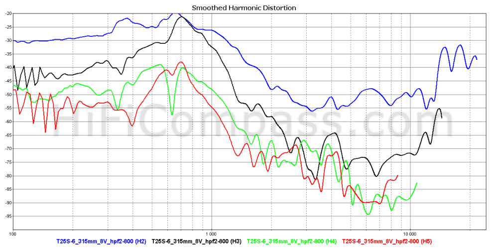

THD at 8V - that's >100dBSpl. <1% at 2kHz, H3 rises steep at about 1,3kHz. At the filter frequency you already are a few db down, less stress for the driver there.

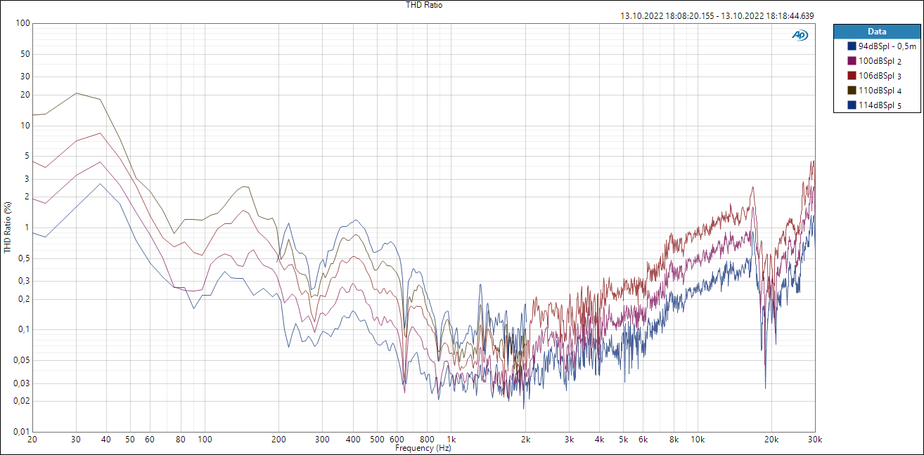

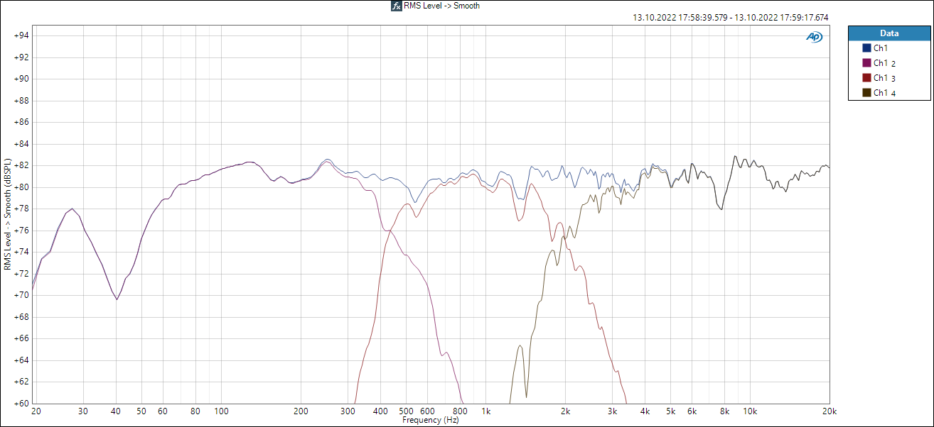

Here a speaker with T25B:
No THD rise in the 2kHz area. In fact that's incredibly low, no signs of stress or restrictions.
