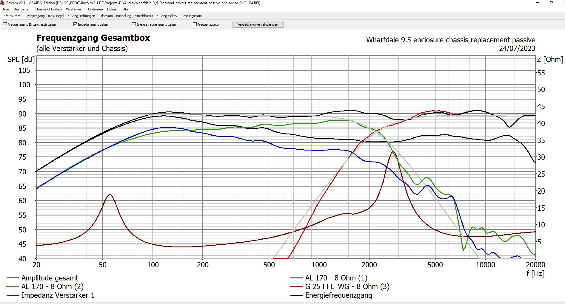

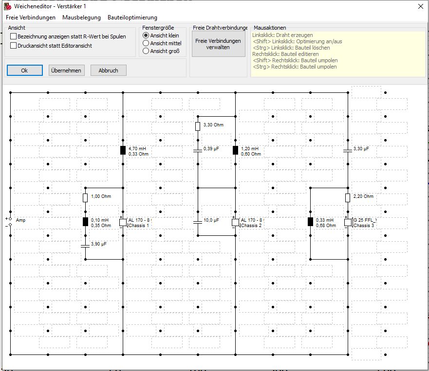

Ladies and gentlemen, i think this is my last try for a proof of concept of the original demand to change the drivers and the passive crossover, again hope it helps the thread opener to come to some kind of intelligent conclusion to have a benefit and some fun to do it on his own.
Changed target function from Bessel 2nd order 2500 Hz to Linkwitz-Riley 4th order 2200 Hz with nearly the same number of components and mid-woofer and tweeter with waveguide with the same polarity
